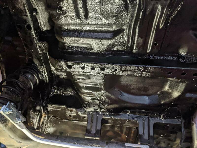

This is the area above the fuel tank which is utterly unaccessible once the tank is on, so was a priority. I had previously rubbed down and vactan'd this, though the metal wa actually mostly sound under here.

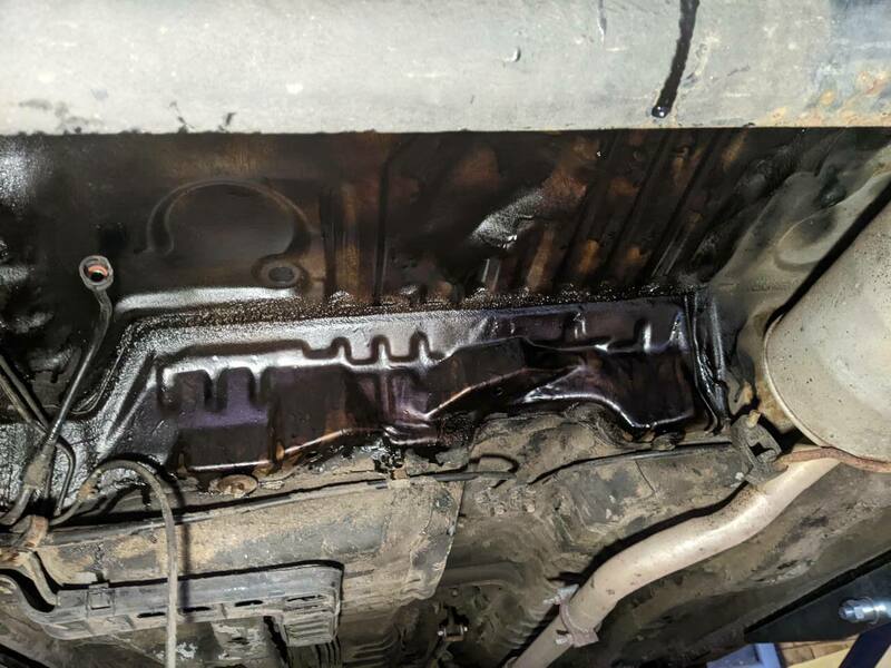

I got a bit of overspray on the exhaust which I shall clean off with some old rags and petrol because I can imagine it smells lovely* if allowed to burn off naturally!

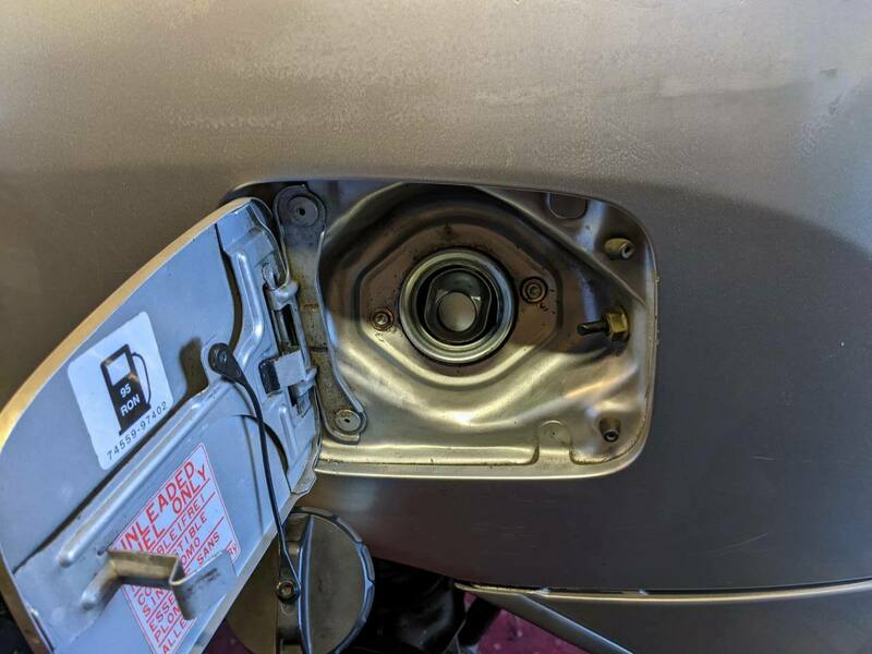

This is the view up inside the passenger side wing where the fuel cap fits to the (new) filler neck. Again, this is 100% inaccessible once the filler neck is on, so was worth cleaning back the surface rust, vactan'ing and waxing the whole lot thoroughly.
I also gave a light coat to the top of the fuel tank/crushing weight of death - its probably fine after being cleaned back with a wire brush, vactan'd, zinc primered multiple times and painted with several layers of black enamel paint, but it was out anyway and easy to blow over.
I'll let all this dry for a couple of days - the solvent will evaporate over time, leaving a self-healing layer of brown wax everywhere which will stop it corroding more, and also inhibit any rust that I missed with the vactan session. Once its dried off nicely I'll wipe the overspray off the exhaust with a petrol-soaked rag, then refit the fuel tank and filler neck, plus all the connectors and slop some petrol in and make sure it works still!
I'm pretty pleased with all of that, the wax made a giant mess again and I had to clean my hands and forearms with petrol and a rag but its a good job out of the way.

With the tank refitted I could then fit the new filler neck, I put a tiny smear of silicone grease on the inner edges of the fill and breather pipes and wiggled them onto the metal ends of the brand new filler neck, then wiggled the filler flap end into position with the gasket already fitted and did up the 2 brand new fine thread bolts that hold the top of the filler neck to the inner wing
from underneath i could then do up the 12mm bolt that holds the neck to the car, about mid-way along. This is the underside view
Then finally tightened up the hose clamp where the filler neck meets the rubber joiner for the tank, and the same for the breather hose and we're done I think?

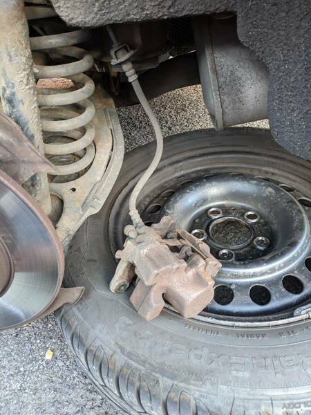

The caliper I ordered duly arrived and I set about fitting it, getting as far as having removed the pads and retaining pin, and disconnected the brake flexi from the old caliper before realising the new one was wrong. Specifically, it was for a 278mm rear disc, whereas my C180 has the SPROTS 290mm ones. Bother.
So swapped it all back to the original caliper and fitted the new retaining pin since the old one was a bit grotty. Duly enlisted my neighbour to do the pedal end of bleeding the air out. This was going swimmingly, right up to the point this happened
Bother again. Well thats that fucked isn't it? It sheared off as I tightened it up, so the stub was at least preventing the brake fluid from escaping, but I wasn't confident enough to drive it like that, so off to the local Motor Parts Direct for a new, correct caliper. Mercifully they are only 20 minutes walk away, they relieved me of £98 + £53 surcharge and gave me the right caliper.
Back to HQ and knowing what was required I quickly swapped over the old caliper for the new one while my wife was out at work
Old one off, flexi undone and swapped to the new one
Pads swapped over as they still have loads of meat left on them and they're worn to the discs anyway (which are also fine). Used the new slide pin and retaining clip thing to keep it all where it ought to be.
When my wife got home I got her to do the pedals as I carefully bled the caliper end (without shearing the bleed screw this time). But the important question - did it fix the sqeaky noise after a motorway run?
No, of course it didn't. FML.
So, i think the only possible option now is that its the other (drivers) side. The fronts are fine, and have had the sliders lubricated twice in the last 2 years, the noise is definitely coming from the back, but only after a run, followed by braking, then moving again at <20mph speeds. Its a constant rubbing noise, so I'm fairly sure its not a warped disc, and is a caliper piston thats slow to retract. I'll have to buy another caliper for that side, but it won't be this week.
I did get my £53 surcharge back though, and have returned the wrong 278mm caliper for a refund so I'm only £100 out of pocket.
Also I can't find where the rattle is coming from, the engine bay heat shields are fine so it must be further back. I'll have to get it on the lift and see if anything looks iffy.

Have you considered running the piston in and out a few times to see if it frees up?
Its odd, it doesn't seem to bind much, the car will roll normally on the slightest incline, and i can push it easily by myself with the handbrake off, even after a run. its done it for at least 18 months now and no mention was made of any brake issues on the last 2 MOTs, despite me mentioning both times. Neither rear wheel gets noticably warm either?
Its more of an irritation than a problem really - its just it can make a bit of a racket sometimes if the journey is wrong. A great example would be going to Southsea from here - stop start to the M27, then a ten minute 70mph run down the motorway, then slow stop-start through portsmouth. By the time I'm looking for on-street parking in southsea, its making a bit of a row from the back end. Give it ten minutes of being parked up through and its fine again? Even when its making noise, it rolls pretty much normally though so the bind can only be very very slight?
I had a problem recently which was sort of similar and turned out to be a wheel bearing.  Yours does sound more convincingly brake though.  Might be worth taking the pads out and running the piston in and out, if you don't want to splash out on another caliper.  Just an idea.
I'll give it a blast - I'm fortunate with the setup of the rear brakes, the handbrake actuates shoes on the concave inside of the disc, rather than conventional ratcheting calipers, so the piston should* push back into the caliper using a g-clamp; I won't need a proper wind-back tool I don't think.
I have a wind back tool if you need it.  I don't like using it much though.  Rear discs always seem a bit complicated to me.
You say there is plenty of meat on the pads, but you could try a new set which would force the piston to work in a slightly different position  in the caliper, which sometimes helps.    Plus of course retracting the piston to fit the new pads will tend to free it off anyway.
It does seem a bit overkill on a car with just 130bhp and weighing 1400kg. Drums would have been entirely adequate and a lot less fiddly.
Are you sure the noise is not from the handbrake?
Test by pulling it on very lightly…….similarly test if noise on foot brake by touching brakes while it is noisey
The issue with the 'hand' brake on these is that its foot operated. Its a 4th pedal to the left of the clutch. There is virtually no feel, and fine control is impossible - it releases via an equally numb pull lever above your right thigh.
From what I can tell, the HB is working normally. The noise starts after the first few presses of the foot brake on a journey.
