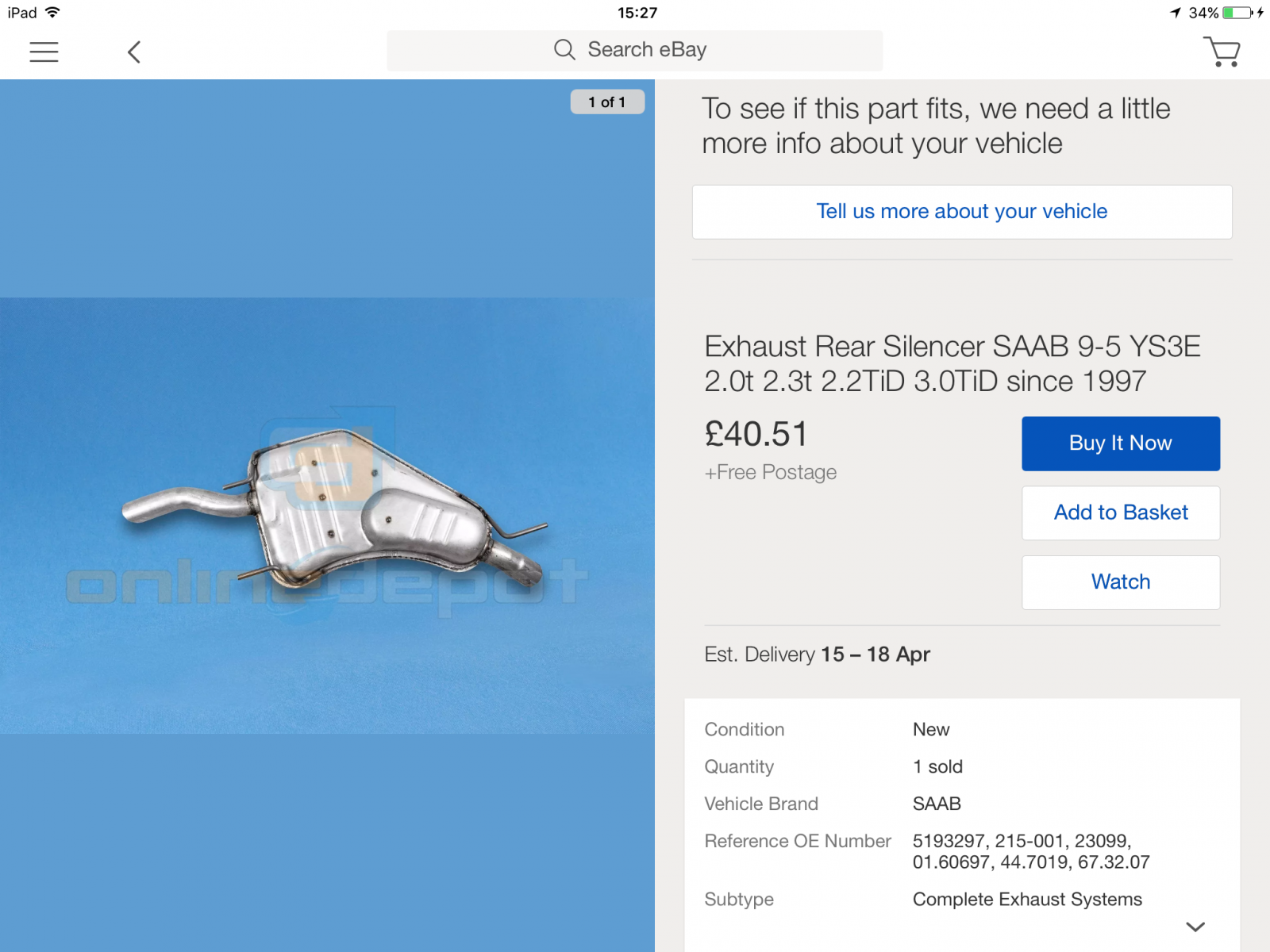

The pattern coil pack has arrived and is now on, and oh boy does the thing run better!  This afternoon I bought two part-worns for the back wheels.  They are different makes, which spoils the matching-Bridgestones it had, but never mind, Michelin and Fulda are still good tyres.  Tomorrow morning it's going back to Martin for a back silencer.  I could see it clearly when the NSR wheel was off, and it's abundantly clear where the blow is!  That thing is more hole than silencer.
Houston, we have a problem.
Martin's been trying for a week to get a back-box for this beastie.  Yesterday he found one, at a supplier in Kendal, but was sharp enough to ask the price before confirming the order.  £150.
Have you recovered yet?  I haven't!  Obviously now I need a secondhand one, so if you know of one lying about without a car round it, please shout up!  Even better will be if we can arrange a Shite relay to get it to me.
That looks ideal!  Thank you kindly sir, I'll order it when I come back on Monday.
Happy to help Eddy. Hope it fits!
