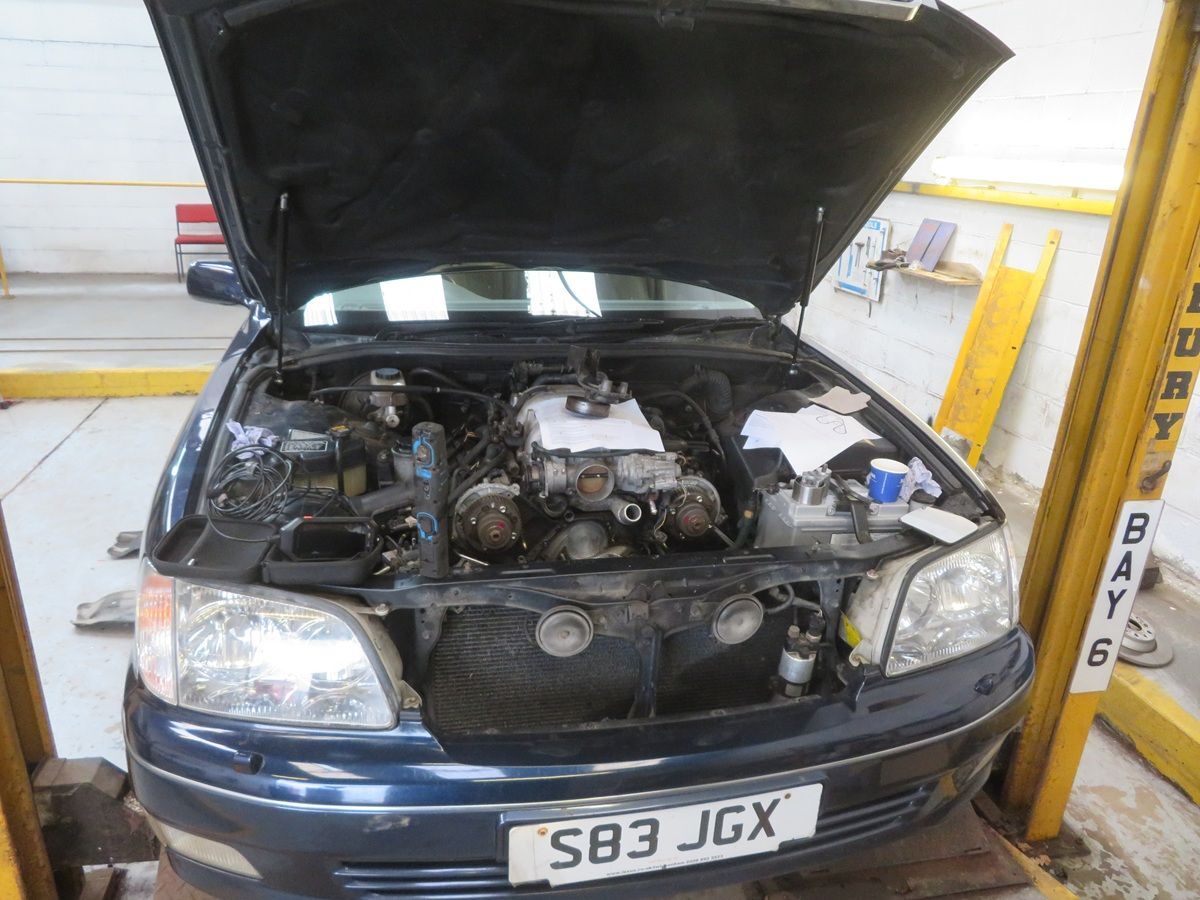

I haven't had a great start to life with the new LS400:
As previously reported the battery light was on and of course it was the alternator and not just it needing a new battery. That's now been rebuilt by a local company.
Mission creep! The lack of heat and low coolant level was from a leak, where an O-ring on the water pump wasn't fully sealed. But investigating that led to the discovery of a previous bodge which could have been the cause of it coming off the road a few years ago. I think it's the tensioner (or a pulley?) that bolts in where circled above, which had been repaired with a thread insert that was installed at an angle so nothing lined-up. The pulley was throwing the belt off line, and someone had given the bolt a whack to get it as straight as possible! It's beyond drilling out and having a new insert fitted, but mercifully it's in the oil pump housing and not the block so they've managed to source a new one which should be fitted next week.
What is interesting/mildly concerning is that the last cam belt change shown in the paperwork was undertaken by a Lexus main dealer in 2019. Surely they saw this problem then, or did they cause it? Or is there some paperwork that's strategically missing?.....
Anyway, one good thing is that they checked the PAS pump and at least that previous repair seems to be doing its job. Shame that the alternator failed again after just a few years and relatively modest mileage (they were both rebuilt in 2018).

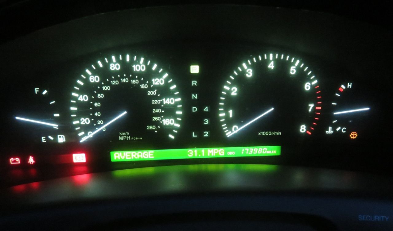

After several road tests and making sure it was all good they were happy to hand it over.
Made it back home with no warning messages and the temperature gauge sitting where it should, now need to put some miles on it!
