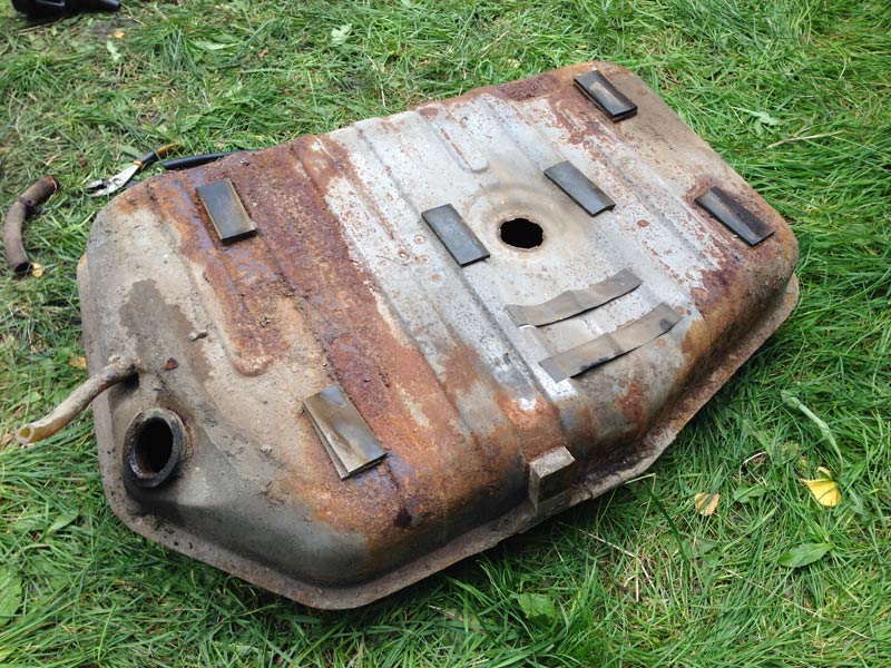

Anyway, today we removed the tank, after we removed the towbar (and brought it to the gypsies straight away, so it can never ever deface a car again),
which turned out to be much easier than anticipated. So sorry for that disappointment.

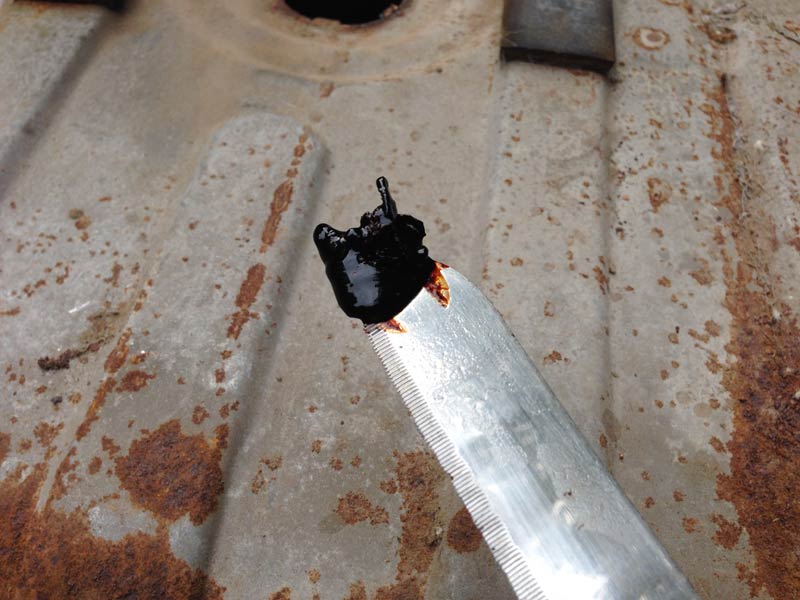

However, there is an at least one inch thick layer of treacle at the bottom of the tank. It doesn't allow any petrol to reach the outlet.
At the moment, I have no idea how this can be dealt with and by whom, but I'll ask around tomorrow.
Could do with a steam lance or hot water pressure washer in there. It looks like tar!

I got the tank back from a company cleaning tanks a while ago.
Today it was re-installed together with a new fuel pump and filter. Sadly, no fuel pumpage enginewards ensued. There is still no petrol coming out of the bottom of the tank,
which makes me assume there is some kind of baffle down there that's still clogged up. Poking into the outlet with a big screwdriver yielded no flow of the precious liquid either.
However, the pump pumps perfectly fine when sucking from a jerry can so that at least is fixed.
Petrol consequently does arrive at the fuel distributor and also at the start valve, but neither at the joints going to the injectors, nor to the warmup regulator.
This means, that the lower half of the distributor works, but nothing goes through to its upper half, north of the membrane. Which is shit.
