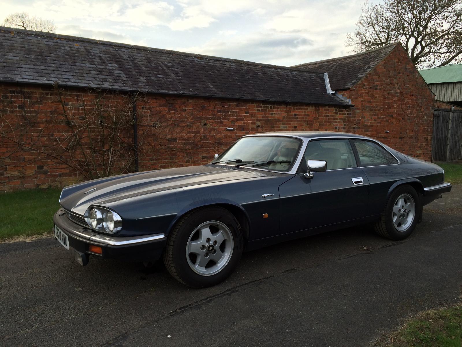

So it's been a VERY long time for updates. I needed a battery, and I needed to get into the engine stuff so getting a battery seemed like a low priority, but having realised the CX was carrying the battery I needed it seemed silly not to try. The car had dust from sitting in the garage and needed a rinse down - it's impressive how well the tyres have remained inflated etc.
Anyway, battery on, dump a load of deionised water into the cooling system and fire up. Fires up like... well. I can only assume like new. Flick, purr. No fuss. Wait for steam from back, no steam, but the bonnet is open and there's a fountain.

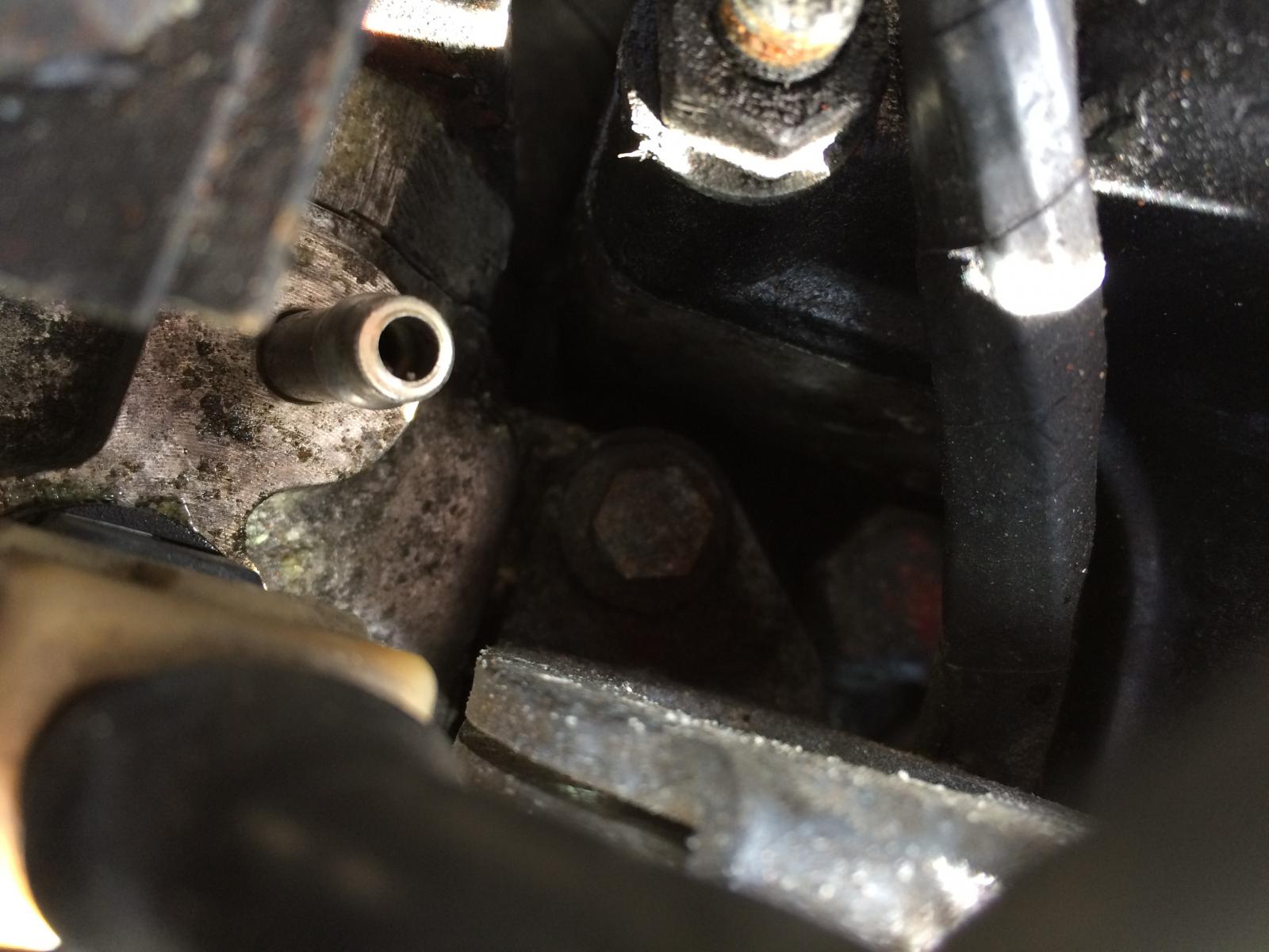

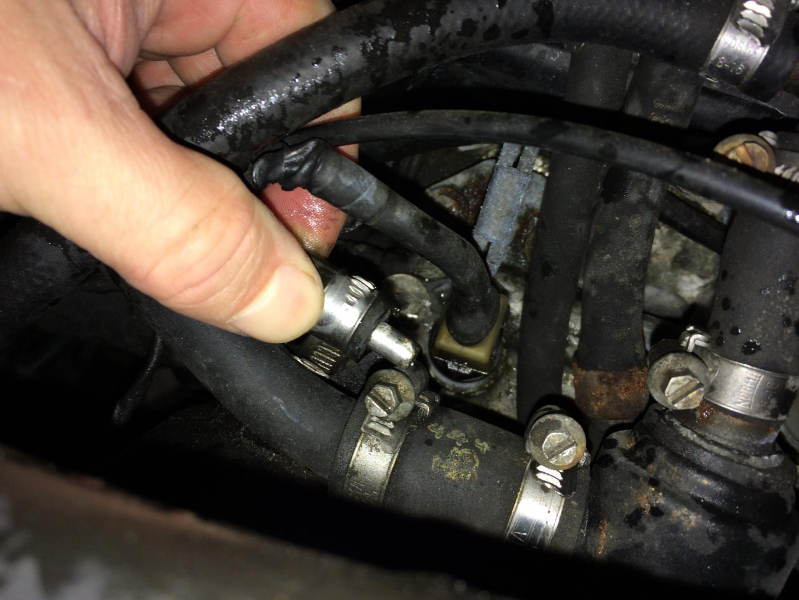

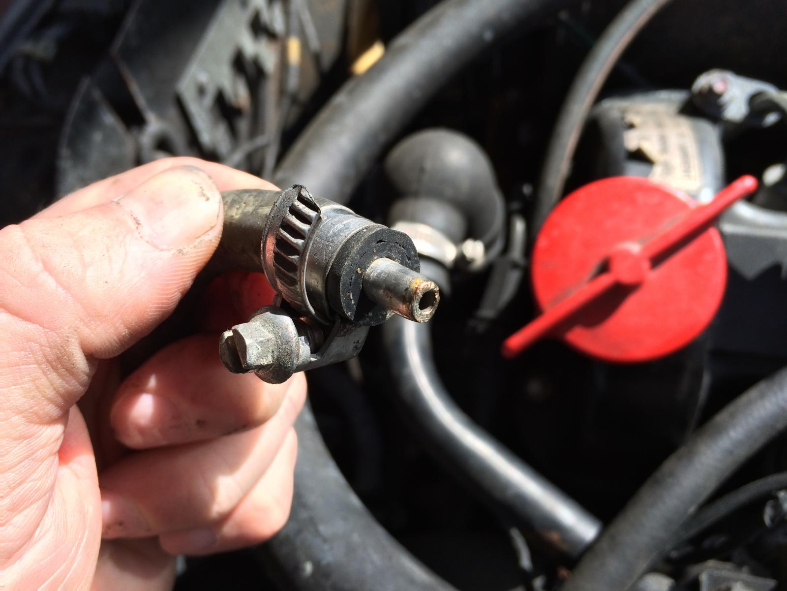

So. The head gasket may or may not be duff - I'm thinking not, from how the car starts - but theres a pipe union from the thermostat housing to the overflow/balancing pipe that has seemingly cracked in the water pipe and come out. It dumps the coolant incredibly quickly via this hole.
Now on the hunt for a waterpipe or thermostat housing to fix it with, then the radiator can be reverse flushed and checked for silt, then the car can be refilled, carefully and properly - and we'll see where it goes from there. If you look to the left of the sensor and above the pipe I'm holding, you can see the hole where the union would have been installed and water coming out of it.

Today involved a bit more checking. Removed the metal pipe from the rubber hose, and found it was completely intact, not cracked or broken as I had thought. Cleaned, checked, and then got a drift to tap it into the water pipe - theory being if I whack it too hard I needed a new housing anyway if the pipe didn't seat.
Tried to remove it with pliers. Wouldn't move.
Reconnect balance pipe, refill water slowly. Raise front of car on a slope, more water. Start car. Let water settle. Caps on. Let car run. No leaks. Let car sit. No leaks. No steam from exhaust. Temperature sits bang in the middle. Let it sit until oil is up to temperature (idle pressure from full 8 down to the centre point on the gauge). Still no steam. Still no obvious leaks.

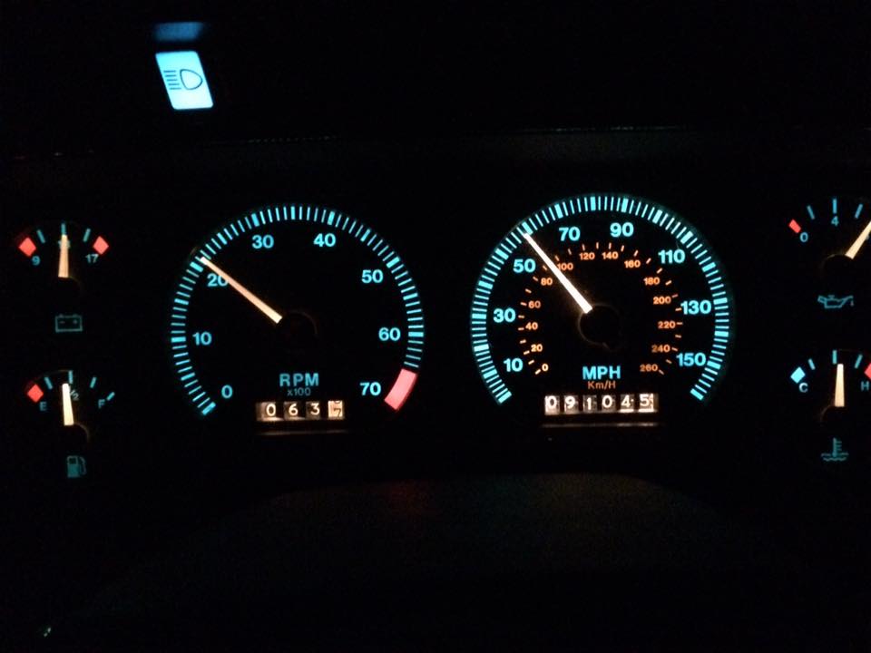

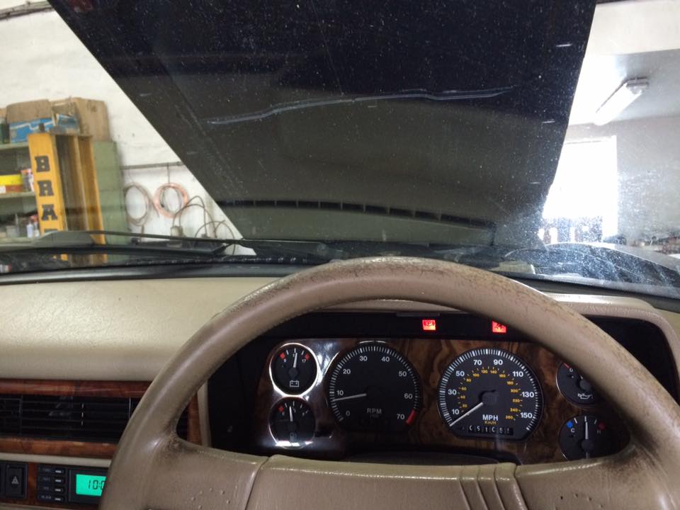

Last night I took it for a cheeky drive around the village. No overheating, no problems, up to 60 and no glitches.
Well, apart from the standard issue horrors...

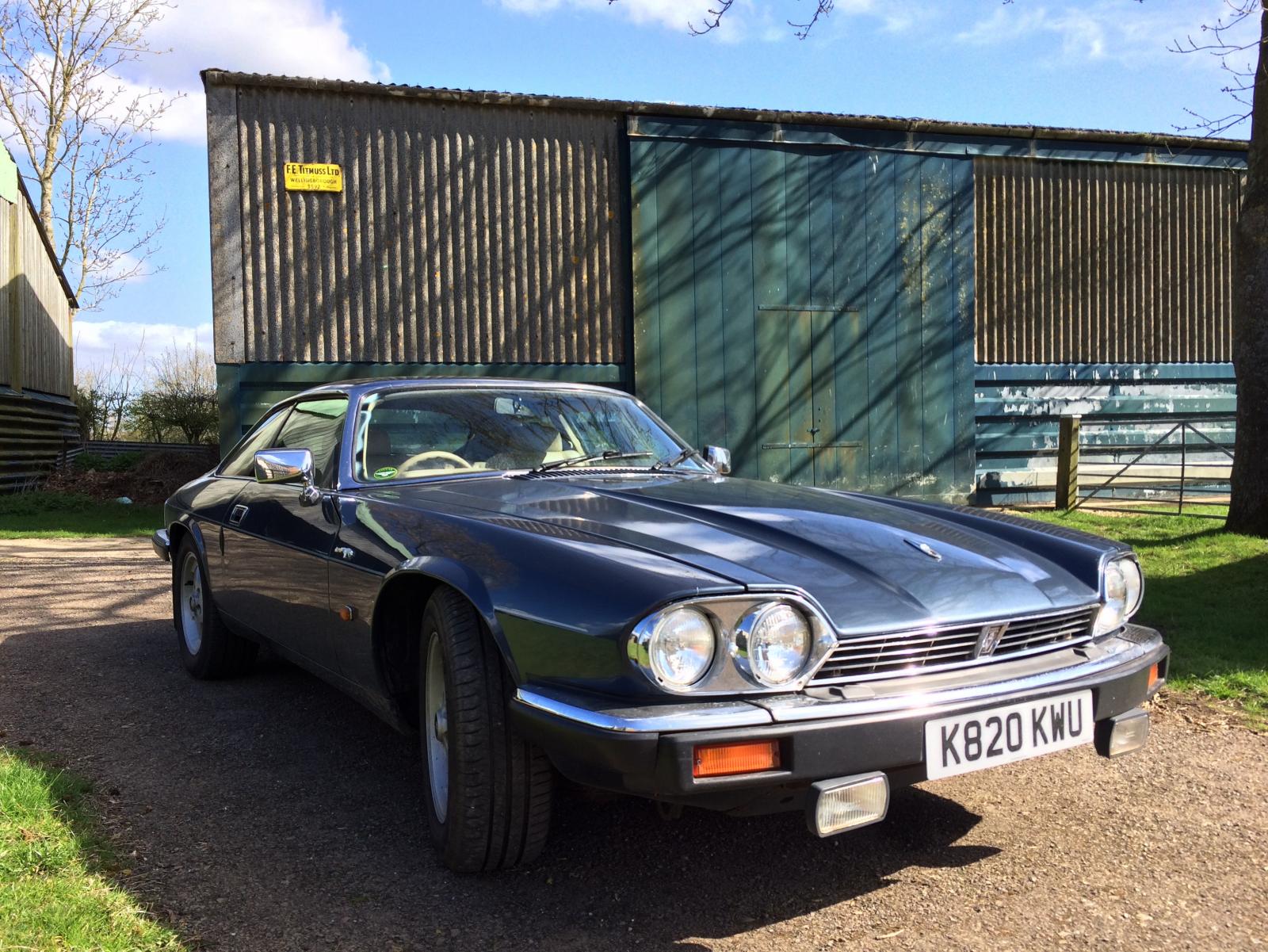

So it went for the MoT today...
Emissions, amazingly, spotless...

Obviously, it's a BL-era Jaguar design, with extra Ford-era faffery, that hasn't been on the road for well over a year.
So.
Back to the
Road, once I've insured & taxed it.

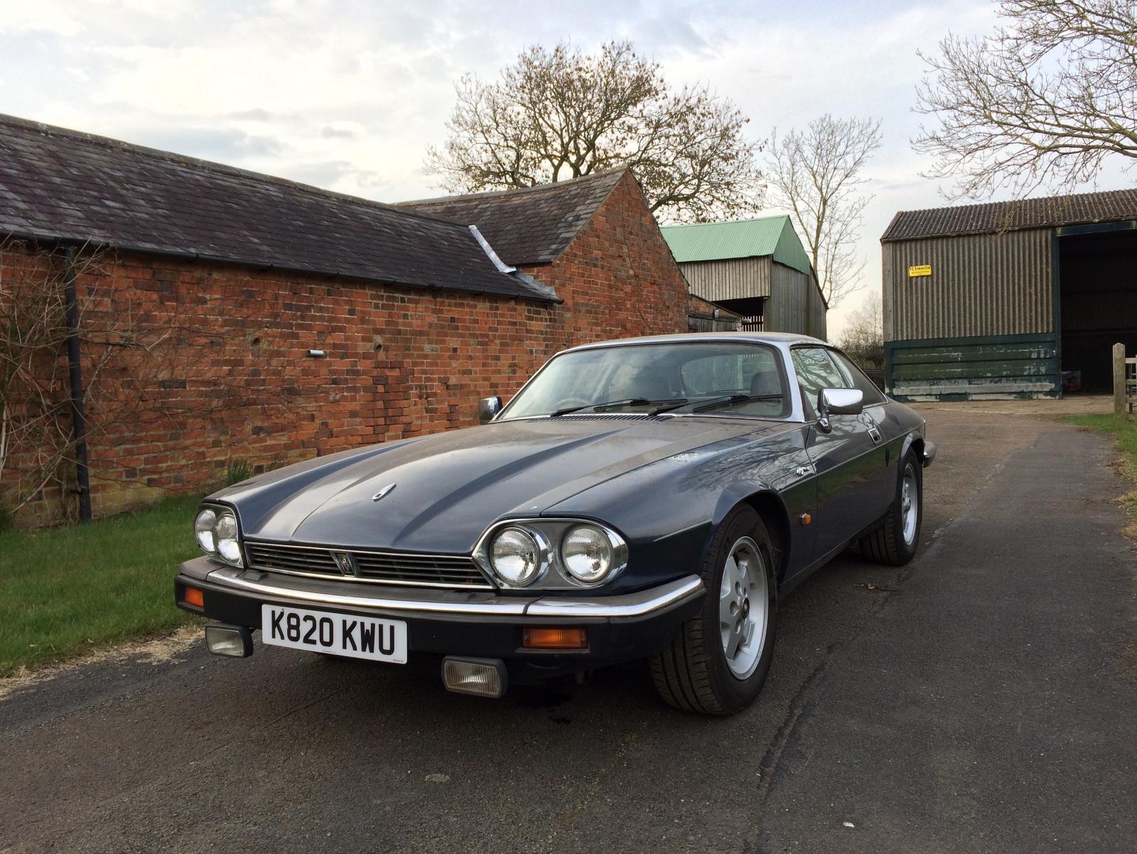

Nice work on de test but fuckinell, those Yank spec quad headlamps look as offensive as ever.

It's missing the lower spoiler at the front. That's quite important for high speed cooling and stability.
I like them. Plus they're really bright :D

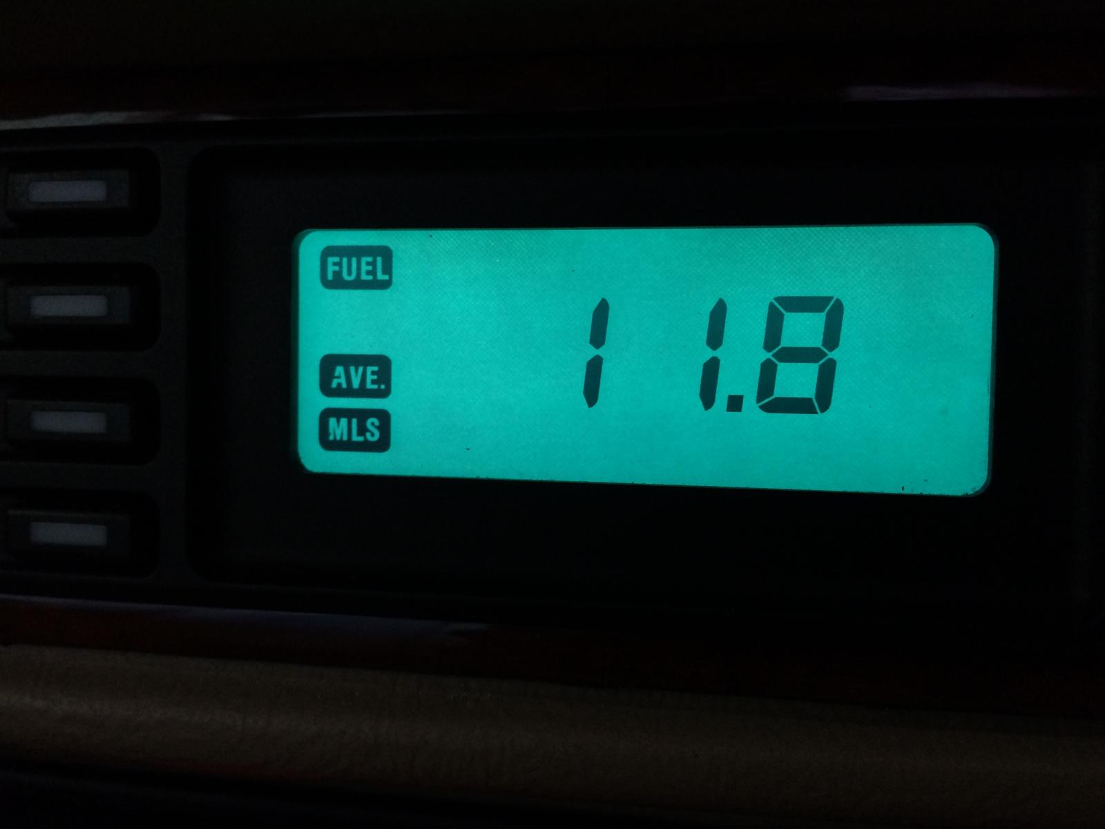

Amusement. The idling/tests burned through £30 of fuel...
