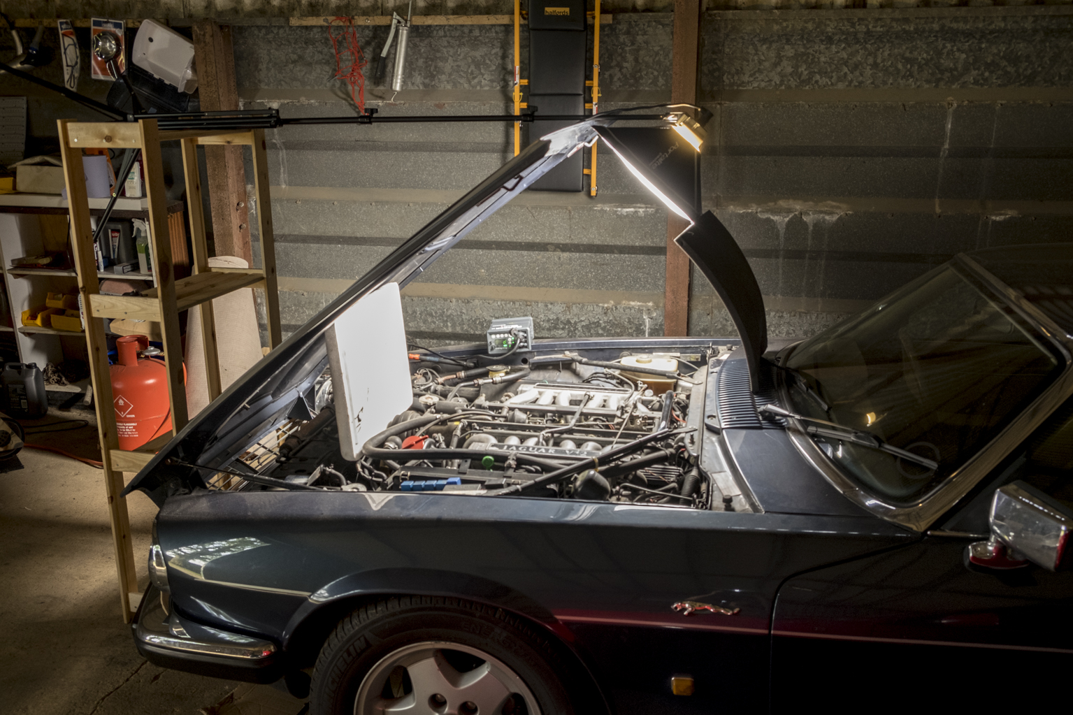

It's been a very interesting handful of weeks (and I realise I still haven't emailed Pete about how the car is getting on, need to be more organised!) and so far, not a lot has happened with the XJS. But, as I was testing a camera (Fuji X-T10 if anyone's interested - I use an X-T1 fairly often, currently have a graphite model with grip which is really comfortable to use, but the X-T10 is a much cheaper camera. Strangely they've not taken any of the 'meat' out of the X-T1 spec - same sensor, processing, Wi-Fi, almost imperceptible EVF lag - it's just a bit smaller and trades direct ISO control for extra bracketing/filter positions) I figured I'd have a bit of a play.
Great picture.
Not sure if I'm looking forward to your updates on the head change or dreading them...
