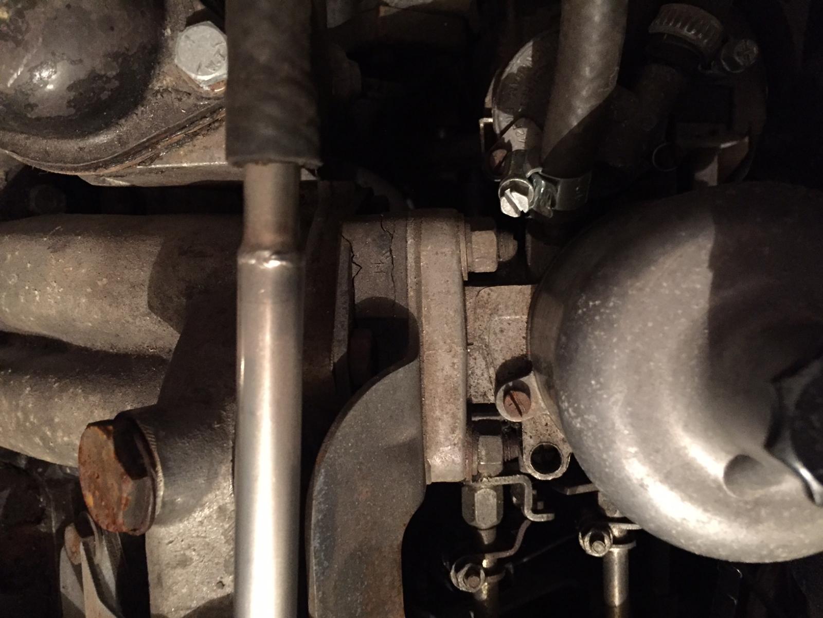

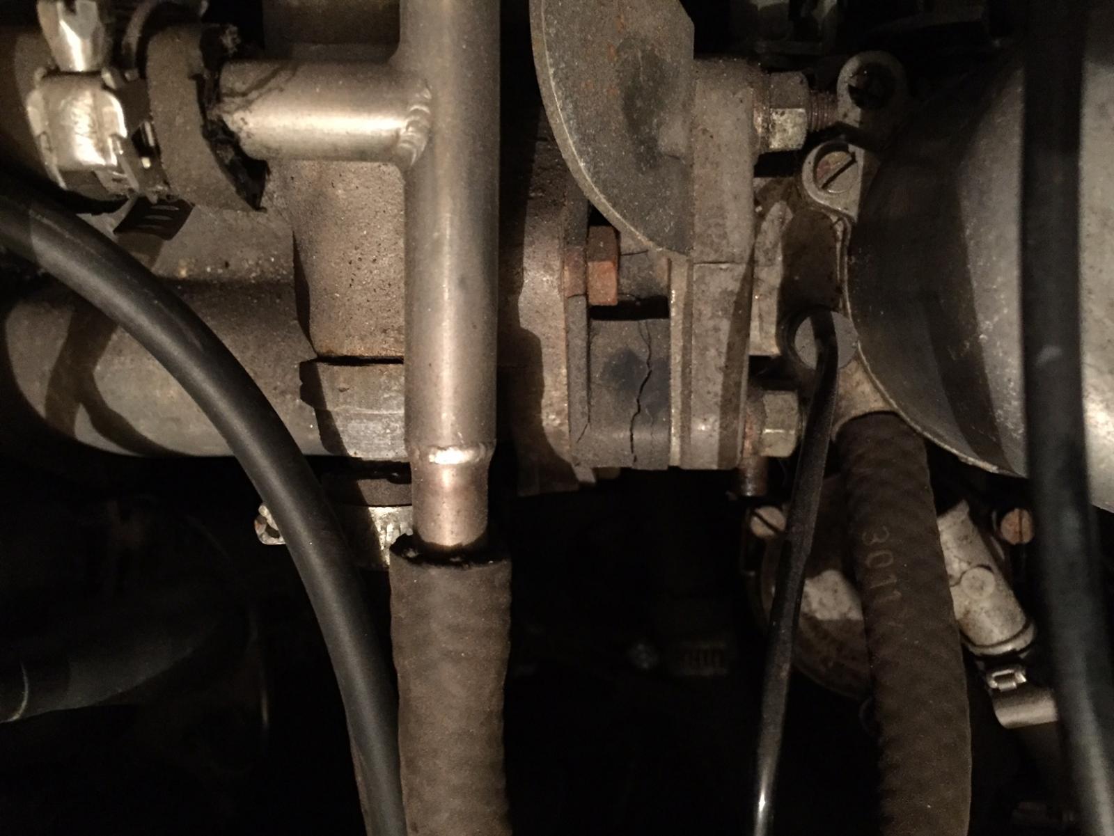

Issues with running when warm might be caused by this:
Both carb mountings seem to be cracked.
That's annoying as they were all NOS when the previous owner fitted them. new rubber or indeed solid ones will be going on.
I'll do the spray some wd40 on them and see if I can eliminate them being cracked all the way through or whatevs.
I will bloody regret this....
I already do.
