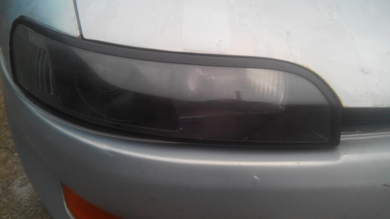

6:30am on a Sunday morning what do you do, go out and polish the headlights of course....
I enquired as to what to use on the stupid question thread and advised by "Sorn me" that autosol or silvo should be good for the job. I couldn't find autosol in Sainsburys last night but did find T-cut metal polish, meh, near enough.
Before, a bit milky around the top, most likely due to being in the sunlight a bit more.

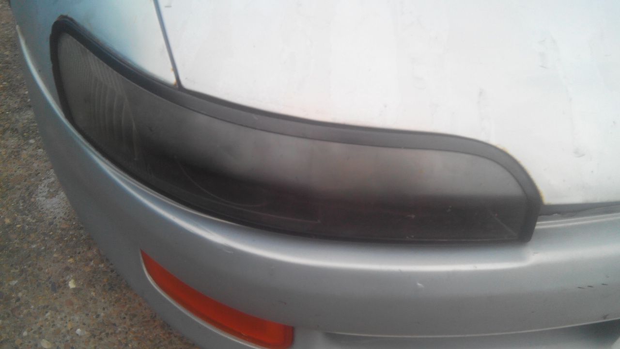

After less than 5 minutes the headlights are much better, so easy to do, polish in, job done.

I've tested some headlight renovation kits recently and if you can get it separately, look for headlight sealer. The 3M sanding/buffing kit worked well on my crappy E-class lights, but they stayed looking milky - the T-cut kit is just rubbing compound in theory, though it worked a lot better than silver polish or normal T-cut, but the real finishing touch was the sealer - which gave the light a nice, clean and bright finish.
Those lights look oddly dark. Have they been dismantled and painted black instead of the dark metallic grey?
