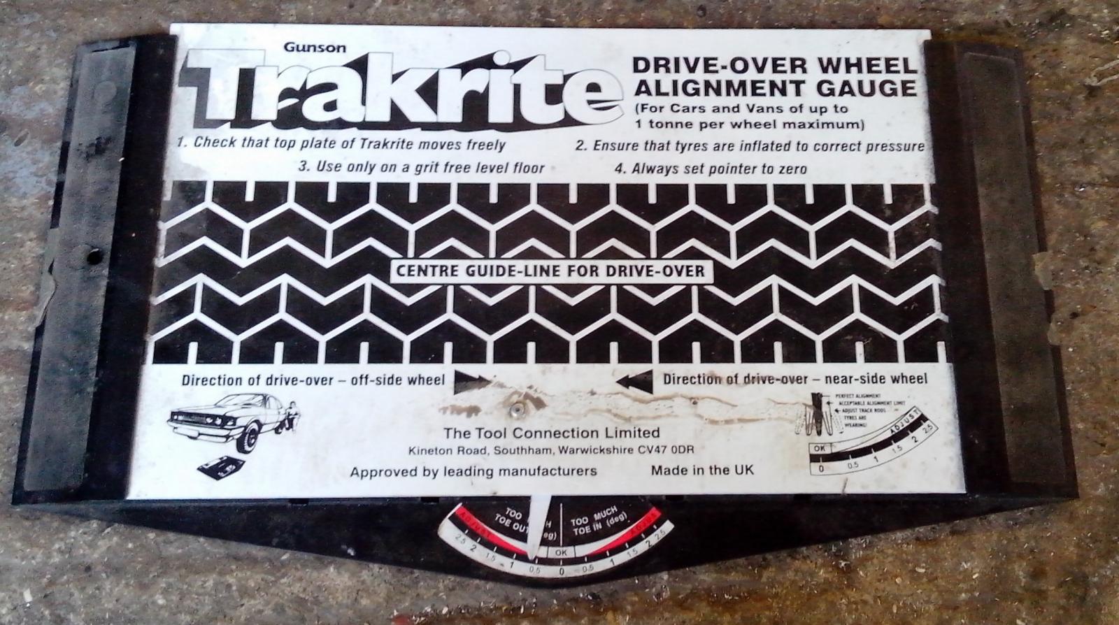

I use a simple Gunson trackrite gauge and though very cheaply made it works great. Just drive over the crappy plastic thing and the needle tells you toe in or out in mm's. Actually better to gently push the vehicle over it for best results.
I've had mine for 15 years and done modern stuff, 4x4's, tractors, and small lorries. I got it when a bloke at ATS used a similar device outside because the bays were full. He mangled up the trackrod with his molegrips, so as with tyre fitting I thought why pay someone to fuck your car up when you can do it yourself at home for free?

I like the idea of those drive over gauges as they are making a measurement dynamically, ie when the suspension is under at least a bit of load.

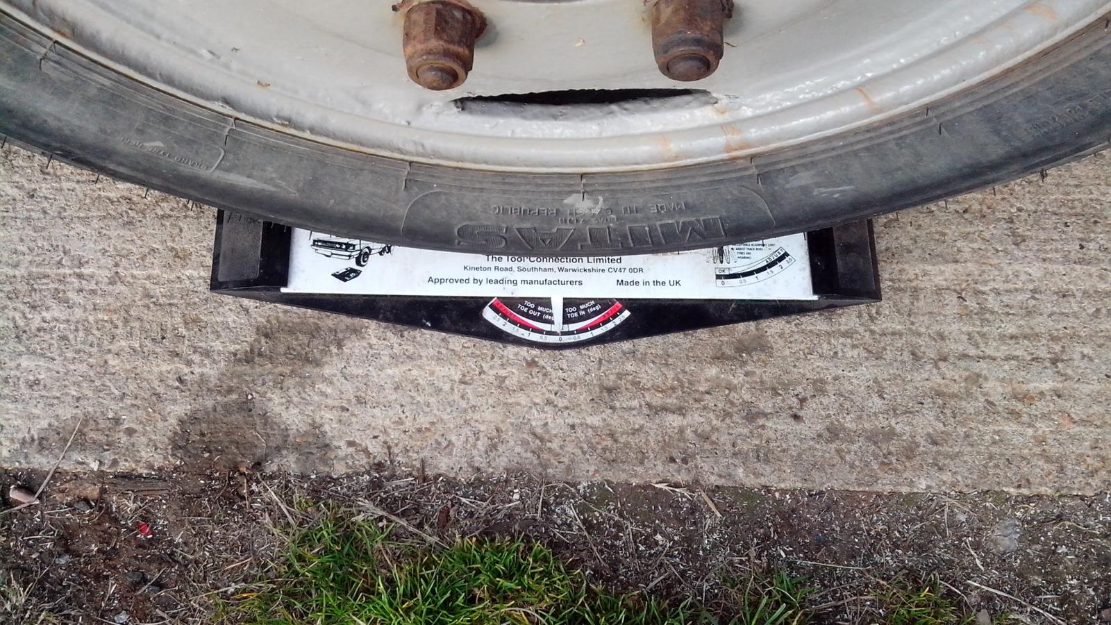

Heres one I drove over earlier. Tracking is spot on. Anyone remember when you used to see poor old tipper lorries driving down the road crabbing so bad the rear wheel stuck out a foot wider than the front? Lazer that.
