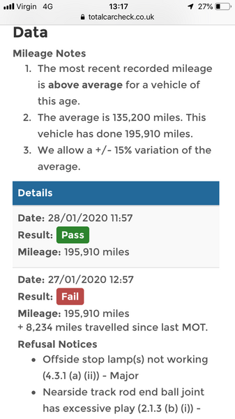

(DIY Service?) CRV MOT success!
Doesn't seem so big or fat to me!
yeah -  just unexpected.
It's strange how springs often lose a piece without any obvious sign that it's happening.

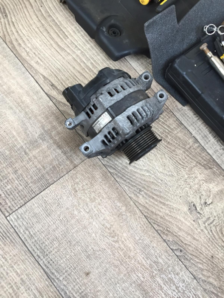

I had to say something, We have been greeted with the battery light on the last couple of days and the alternator sounds like a super charger from a cooper S, out with the volt meter and we seem to not be getting any charge @ the battery. still had a 20 mile drive home with the trailer. I suspect the alternator bearings as every now and then it stops grumbling and we have charge!
the alternator is buried on this engine, cant just be nice and accessible..
Pop the bumper corner off and take the headlight out . I’m assuming it’s a petrol one
it's the diesel, it died the weekend, nearly 7 years and my actual 1st ever FTP, Started okay and then as I rolled back about 5 various fault lights lit up, thought I'd just do the old windows reset, turn it off and on again, dead.
Started taking bits off to get to the alternator yesterday, what a pain in the arse. I think I need to buy some extra long spanners, 12mm for the bottom brackets, you can just about get to them from under the car, but not enough to get any purchase on to crack the bolt. I can see why garages have quoted over £300 for the job, I can also see why decent cars get scrapped for a couple of jobs.
Well the YouTube videos clearly tell lies, 'I'll just wiggle' this out, utter utter bollocks. the alternator is free from the car in the sense it's no longer connected to the car but it's well and truly trapped , radiator off would be helpful, but there's still a A/C pipe in the way, I think my easiest option is to remove the EGR valve and pipe, started to take this off last night and managed to round a nut, picking up this later https://www.screwfix.com/p/erbauer-bolt-nut-remover-set-6-pcs/6083d#product_additional_details_container very very good reviews so hopefully I'll have it off and get the alternator taken to be refurbished.
Small update,
The nut remover from Screwfix is by far the best £13 I've spent on tools lately. Cracked it off with zero issues. Once the EGR was unbolted I still had to move another bracket that was in the way of the EGR coming out! Thankfully this was just 3 more 12mm bolts.
New alternator slotted in, and bolted up, belt back on and the other million nuts and bolts and we have a running car again. Total time spent is probably 5 - 6 hours, FFS, but I reckon I could do it in half that now I know where and how things go.
I'm sure it's in my mind but the car does seem much quieter while running.
This is the only picture I have from the swap, hats off to you good folk who work on cars, take pictures & document it for us all to read,

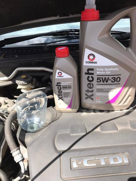

Treated the Honda to 5 and a 1/2 litres of fresh 5w30 oil, new oil and air filter the weekend. approx. 192k.

New Hengst filter, not used these before, made in Germany and seem well made.
My funnel was no where to be found so I improvised. 5.5l of 5w30.

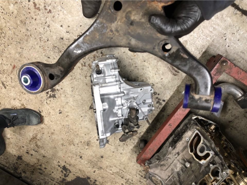

I'd finally had enough of the clunk and with a decent bonus from work in the offing I decided to have some super pro bushes and new ball joints fitted, Super pro were recommended by the garage. I don't generally recommend a garage but the guys at https://en-gb.facebook.com/hondarhq/  really do deserve a shout out!
Picked it up Saturday and it feels like new again, like when I got the car, the Honda is my favourite car to drive again, ZERO clunks, and more than anything I 100% trust the work that has been carried out.

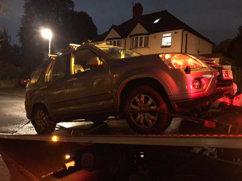

Yesterday on the way to the Dr's I had my first actual breakdown, clutch just hit the floor and no pressure behind it, popped the bonnet and clutch fluid squirting from somewhere and made a bit of a mess, thankfully I'm in the RAC so it was recovered. I did tell the call centre staff that it was a 4x4 so needed a flatbed and would not be able to fix it at the side of the road, they still sent a  guy in a van, who after 20 mins decided it needed picking up.
RAC cover was pretty good TBF, taxis, onward travel, drop it off at my garage of choice, I even have the option of a hire car for 24 hours if I wanted, I've opted not to take that as I'm not sure it worth the hassle, great if I was hundreds of miles from home but I was 3.
Car is now on it's way to Honda HQ.
Posted (edited)
The guys at Honda HQ pulled it out the bag, car was dropped off to them yesterday and I picked it up this morning, fixed.
2nd hand clutch master cylinder fitted, clutch feels like new and the bit is lower than previous, i nearly put it into a nice TypeR!  it must have been on its way for a while, thankfully it happened close to home and not in a couple of weeks when I go to Scotland!
