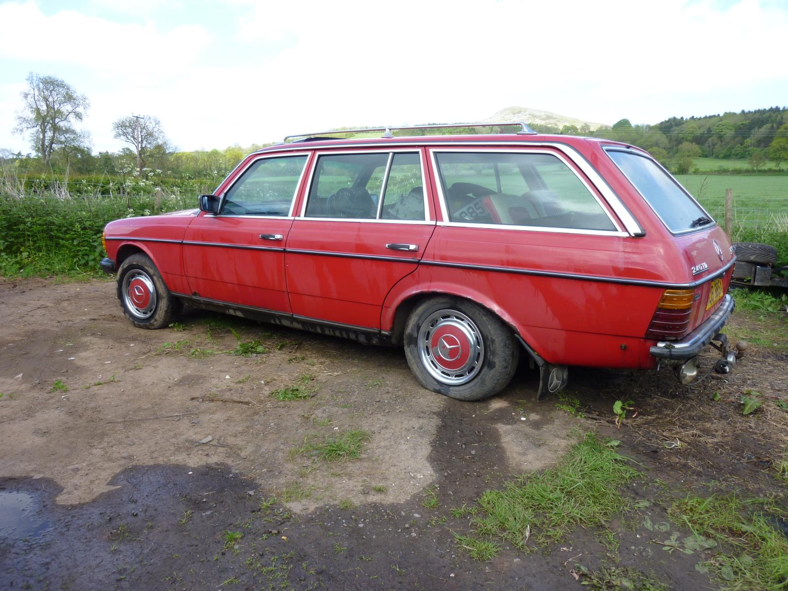

well today I bypassed the rear suspension so as not to ruin the pump and have actually driven it for the first time in a year of ownership!
its only temporary don`t worry, but it drives ok even if it is a little low on the rear...

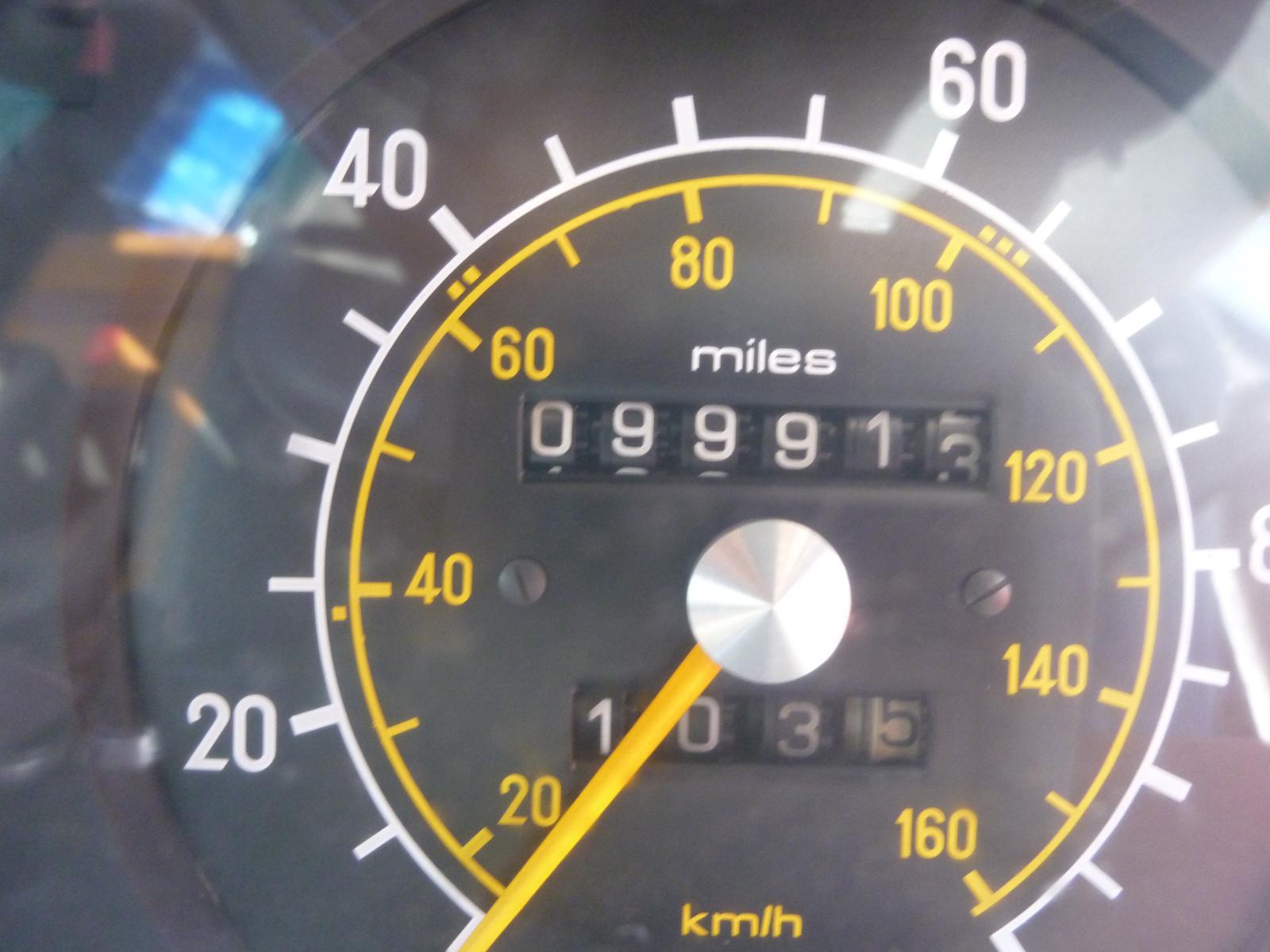

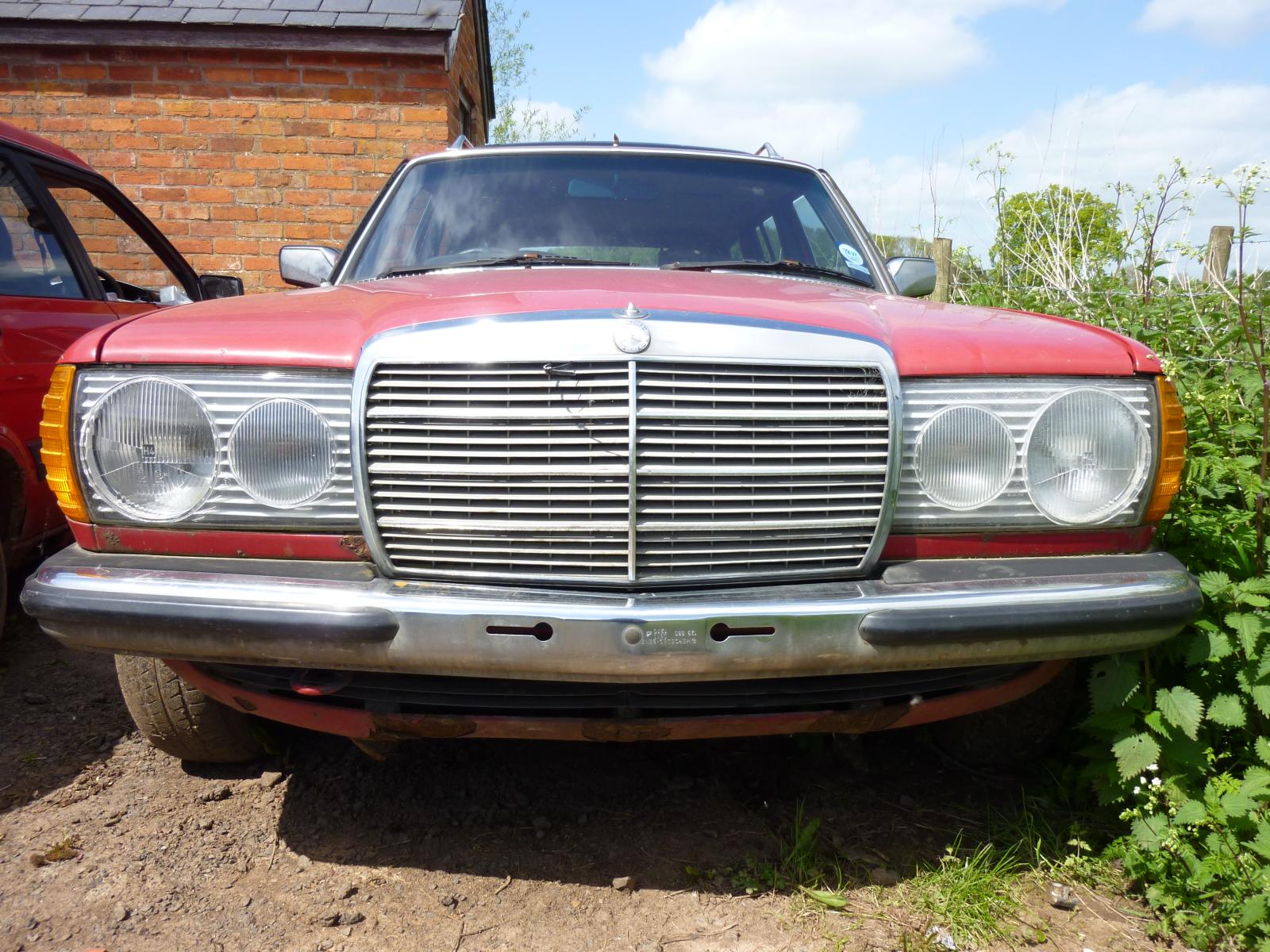

Pretty sure after all the comments and helpful advise I shall keep it hydraulic but here have some pics as requested...post-19511-0-88707400-1431808801_thumb.jpgpost-19511-0-68224300-1431808871_thumb.jpgpost-19511-0-04084500-1431808948_thumb.jpgpost-19511-0-38624000-1431809006_thumb.jpg
Lowest mileage 240d?
Been around the clock. Just run in. Probably.
It looks horrid. Total liability. It should be given to me to be, er, disposed of.
*hides the T-cut and Inchcape parts dept. speed dial*.

Simply slam the front suspension to match. Sorted.
I did see a slammed saloon on the road not long ago and it did look really cool apart from the people inside were jiggling over the bumps as there was no suspension travel left on the poor car. Seemed bit daft really. I`m not into modified stuff, although the merc does need a bit more power. I shall leave it standard though
