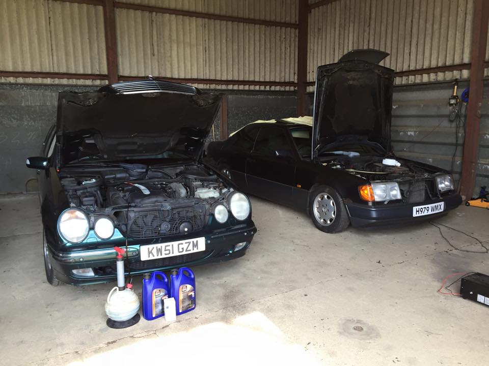

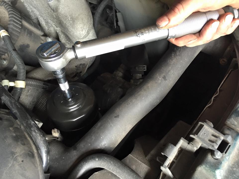

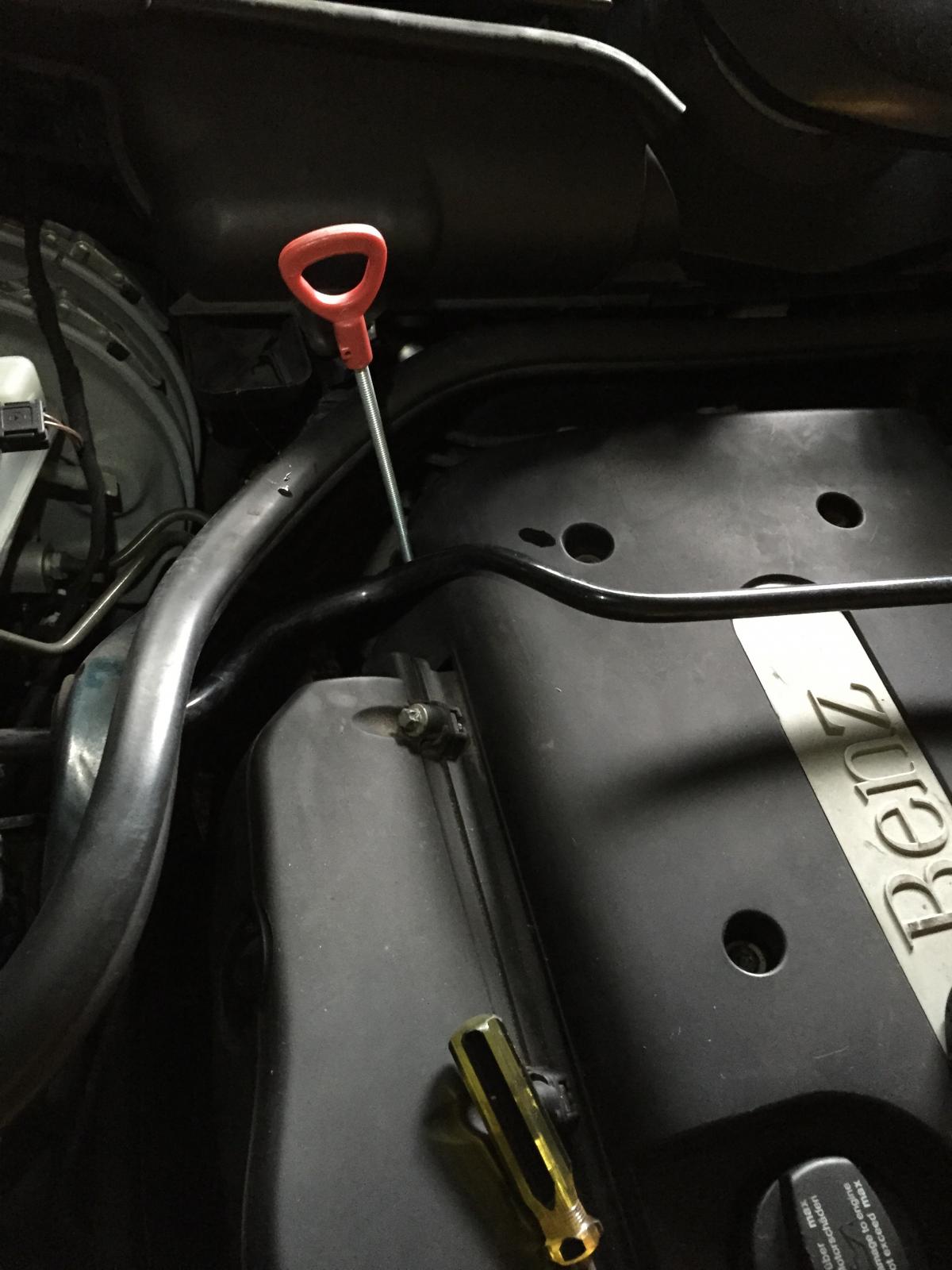

Bear Posted May 16, 2015 Author Posted May 16, 2015 Big Mercedes tells little Mercedes to fuck off out of the garage so I can get the car on level ground for oil-checking. (I like to imagine that this is just the start of a clown-car parade of Mercedes escaping the shed, and at some point a red W113 will join in that I didn't know I owned). Well, oil & filter change done - got the beast nice and warm driving to collect two gallons* of Millers Trident fully-synth 5W40 of the right spec (man, that stuff is cheap for fully synth - £44 for the two IIRC), set the vacuum pump off whilst getting the Laser 76/14 socket and spinning off the filter cover. All very good - filter was not manky, air filter was equally in decent shape (but now the car has genuine MB ones. Is it bad that I want to flatten the boxes and put them in the history folder? Too late for the oil one though, I put the old filter insert in). E-classes, old and older. Pleased that the W210 also has an "open wide!" setting. Must get the 300CE back to being roadworthy. Looks like I am missing part of the undertray. I can see ground around the front end. Also the fan shroud, which is held on with clips and wedge-shaped teeth between the shroud and mount, had been pushed down and ground off on the AC pump. AC pump is working fine, but I bet that made a racket for a while; realigned it and here's the odd thing - the temp, always sat constant, was always a couple of degrees over the midpoint of 80 on the gauge. I am a fussy bastard and use a torque wrench for the filter housing. After I put the shroud where it belonged, the temp sat bang on 80 even when left idling for ages. Also all the fans are working. Mild diagnostic socket confusion. It has what looks like the 38-pin but smaller in the fusebox, and despite it being a Dec 2001 build I can't find the OBD-II socket. To Google! gordonbennet 1

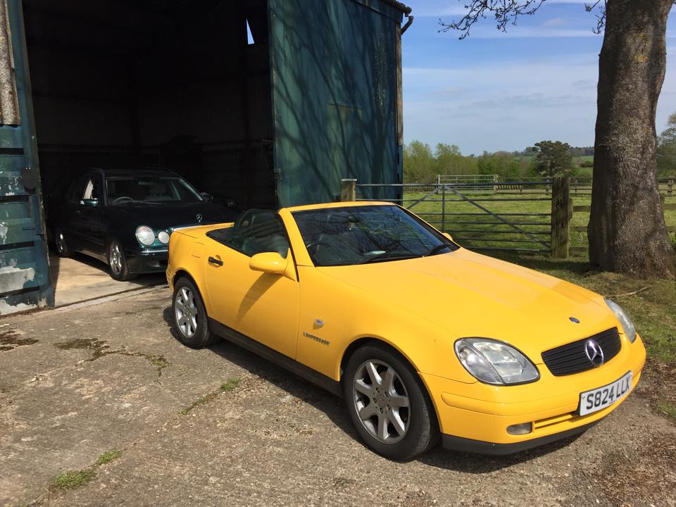

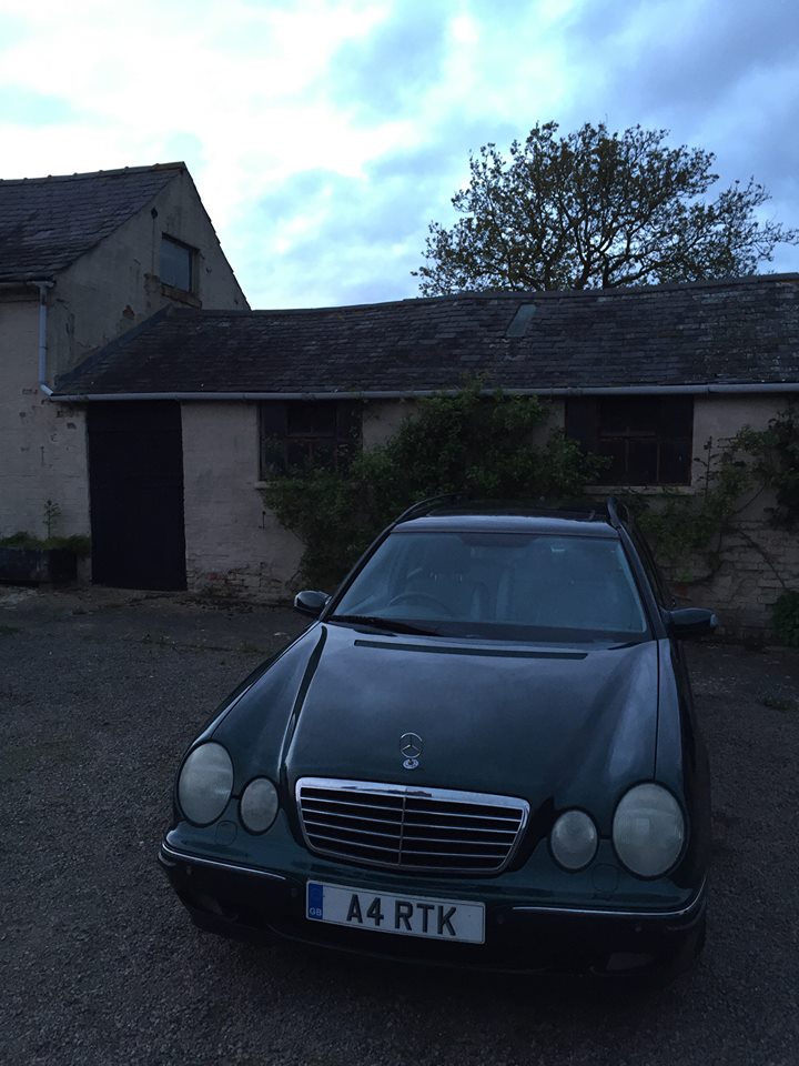

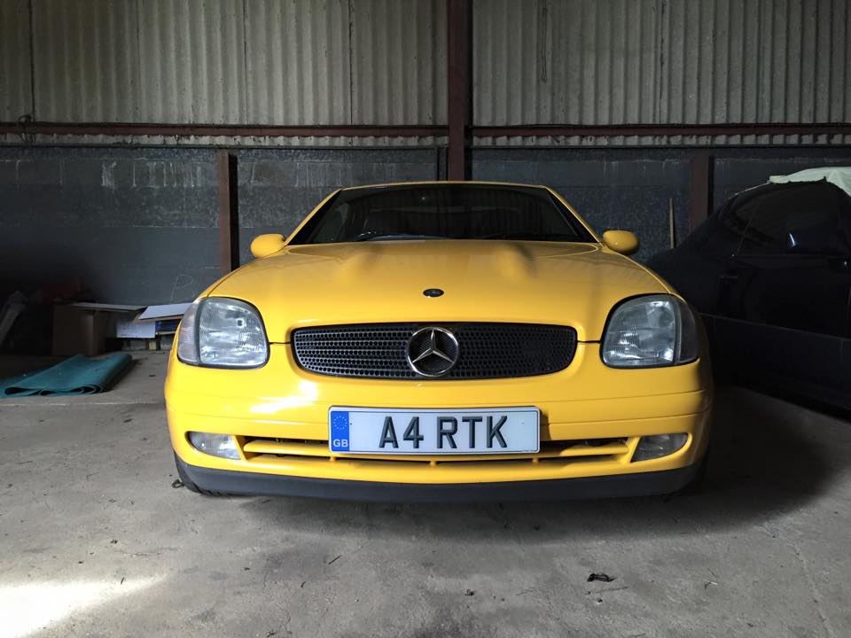

Bear Posted May 16, 2015 Author Posted May 16, 2015 And a dilemma. I took the plate off my 300C, and now I am not sure what to do with it. I was going to put it on the SLK. But the E320's number plate looks shit. I think this makes it look a lot neater. Really can't decide. I'd be less hesitant if the E320 were tidier, but equally if the E320 had a plate like AN51 ASC or something - just, better typography damnit - I wouldn't care. Wonder if W210 RTK (or R170 RTK) is out there...
Ghosty Posted May 16, 2015 Posted May 16, 2015 DVLA has W21 ORT for £399 and R17 OTK for £250...'plate looks nicer on the E320 I think. Bear 1
Bear Posted May 16, 2015 Author Posted May 16, 2015 Heh, close, but I won't mis-space them. It'd have to be W21 ORK or R17 ORK and I'd worry people might think I was into Warcraft or LARP or Hobbits. Jerzy Woking 1
the judge Posted May 17, 2015 Posted May 17, 2015 On the 320 thankuplease. Warming to the yellow on an slk now. *opens ebay app,moves out of swmbos spying range onto chair* gordonbennet 1

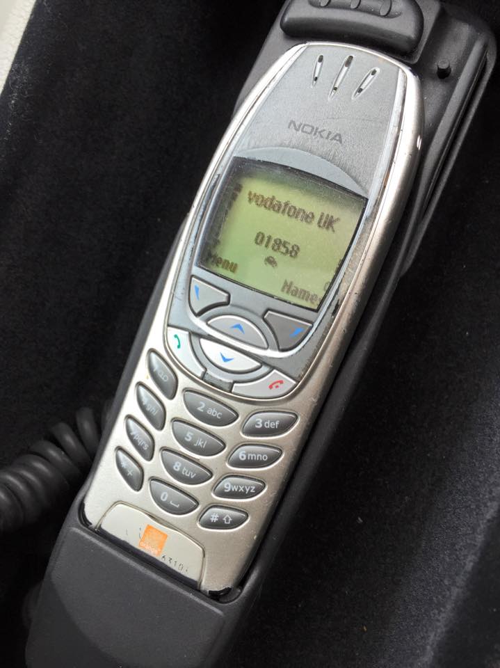

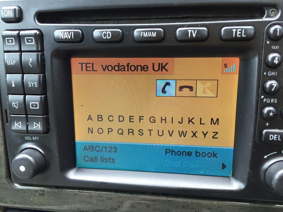

Bear Posted May 23, 2015 Author Posted May 23, 2015 And now, I can use the phone! It's like being a busy executive in 2002! This phone isn't actually the one in use - nerds will notice the later firmware carrier ID with Vodafone UK and lower case. This handset, one of the pair from Ben (thankyou!) was unlocked with a good battery, but wouldn't charge for some reason yet to be determined. So the other handset is now unlocked, charges fine on charger or car, and displays VODAFONE in capitals! It also seems to have a better loundspeaker in it. Either way, I got to see COMAND working for the phone. And the dash display! It works very well - phone book accessed via steering wheel keys, nice clear SMS display on the head unit, easy navigation, and good signal as you'd expect from these old, unkillable phones. Tempted to strip down the non-charging one and spray the shell the same green metallic as the car, but I probably wont.
nacho man Posted May 23, 2015 Posted May 23, 2015 There is just something MEGA about them old nokia's I used to love them, especially the little 8200 which was the phone to have when I was 16 or so. Bear 1

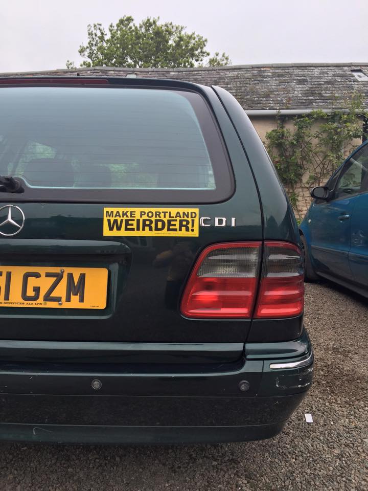

Bear Posted May 27, 2015 Author Posted May 27, 2015 Popping out to visit Marvin, so stickered the E320 accordingly. The spacing annoys me now, oh well. 'Thanks' to my friend's eyes for words and the cropping of the plate, the car also now has a new name. Mugwump. Shep Shepherd 1

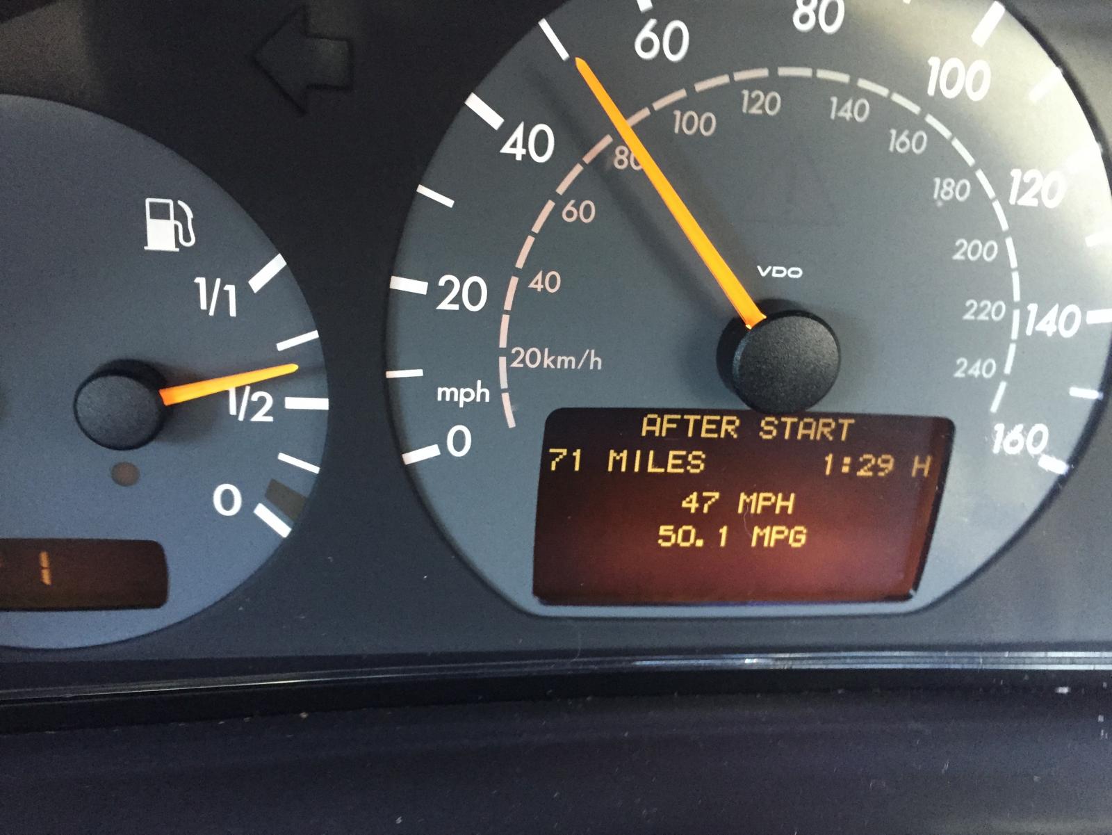

Bear Posted August 2, 2015 Author Posted August 2, 2015 Forgot to mention - the MPG claims I've seen for these... On the run to Heathrow, without dawdling but naturally stuck with M1/M25 traffic and roadwork limitations: 50.1mpg. Current typical average, which is including a run to Scotland (where I naturally kept it trotting along at a good pace on familiar roads) and a run down south: 43mpg. That'll do pig. That'll do.
Pete-M Posted August 2, 2015 Posted August 2, 2015 50 mpg? Mine won't get anywhere near that! 39 is the best I've ever seen.

Bear Posted August 3, 2015 Author Posted August 3, 2015 50mpg, I should grab the picture I took! Most guides say leave the ribbons, but shove a spacer in to force them down. That's what I did on Jen's Saab SID display, and it's worked really well - one line that seemed stubborn has come back over time, as well, I guess it all had to bed in. I'll try that before ribbon replacement.
