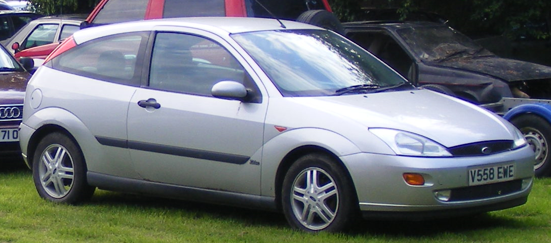

Now for sale  too many cars means stuff has to go same old story i know
Mot until 18th October
£595
Boston Lincolnshire
Focus  1.6 Automatic
Car runs and drives fine  and has been no fuss at all in the last year since ive converted it
Bodywise its a typical Focus   front doors are a bit grotty at the lower edges and the tailgate has a few scabs too but the main bodyshell is good and never been welded .
Reg is  V558EWE
Will add some more pics later
