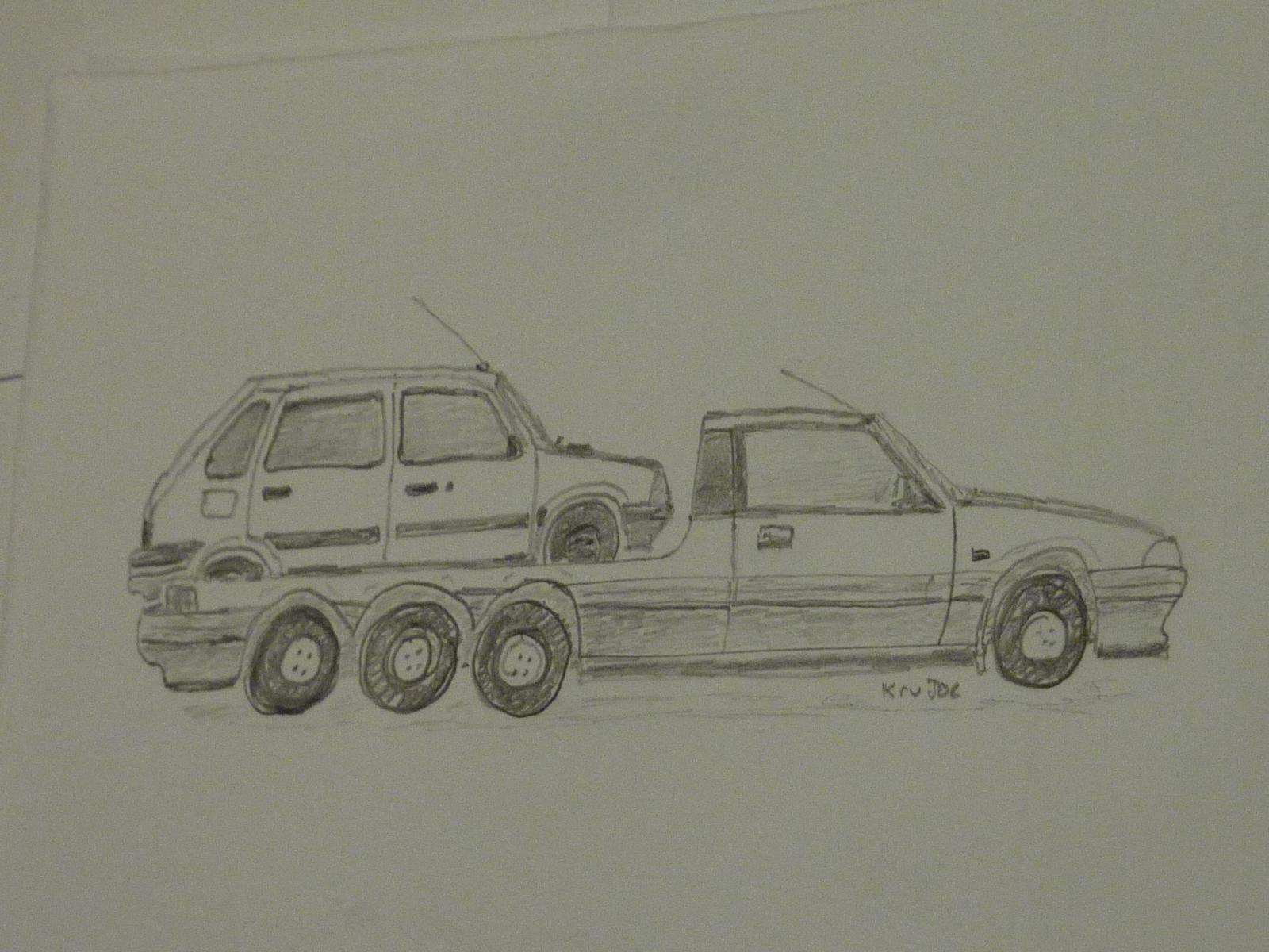

^^^ Good idea. I want to see a multi-wheel Rover R8 ASAP please. If that doesn't test a head gasket, nothing will.
Love the idea but it'd have to be running a T-series turbo engine really.
Less HGF worries too! Unless you count the oil seeping out of it.
If I find myself with a spare half hour when I get home I'll have to try drawing one now just to see what it'd look like.
Sorry Phil, I couldn't wait.
Vulgalour can sleep easy.
Ha ha, I have the blue rear half from the Bollox sawn-off too, I'll need all three back ends to make that. Will you give me a Rover Metro to go on it if I do?
Yes, I will find one and donate it to you if you build a roadworthy car transporter out of an R8!
Deal! :)
(Though I don't think it's gonna happen any time soon, fret not.)
