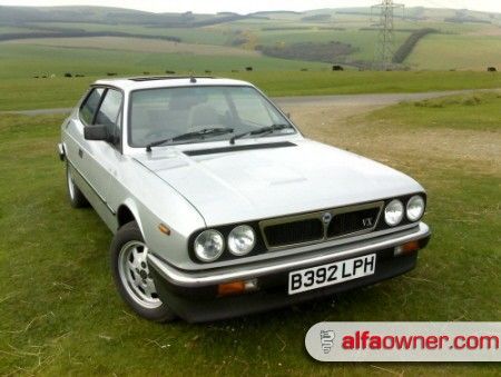

Get yourself a Lancia VX & be done with it!
Just like this one which is mine.
