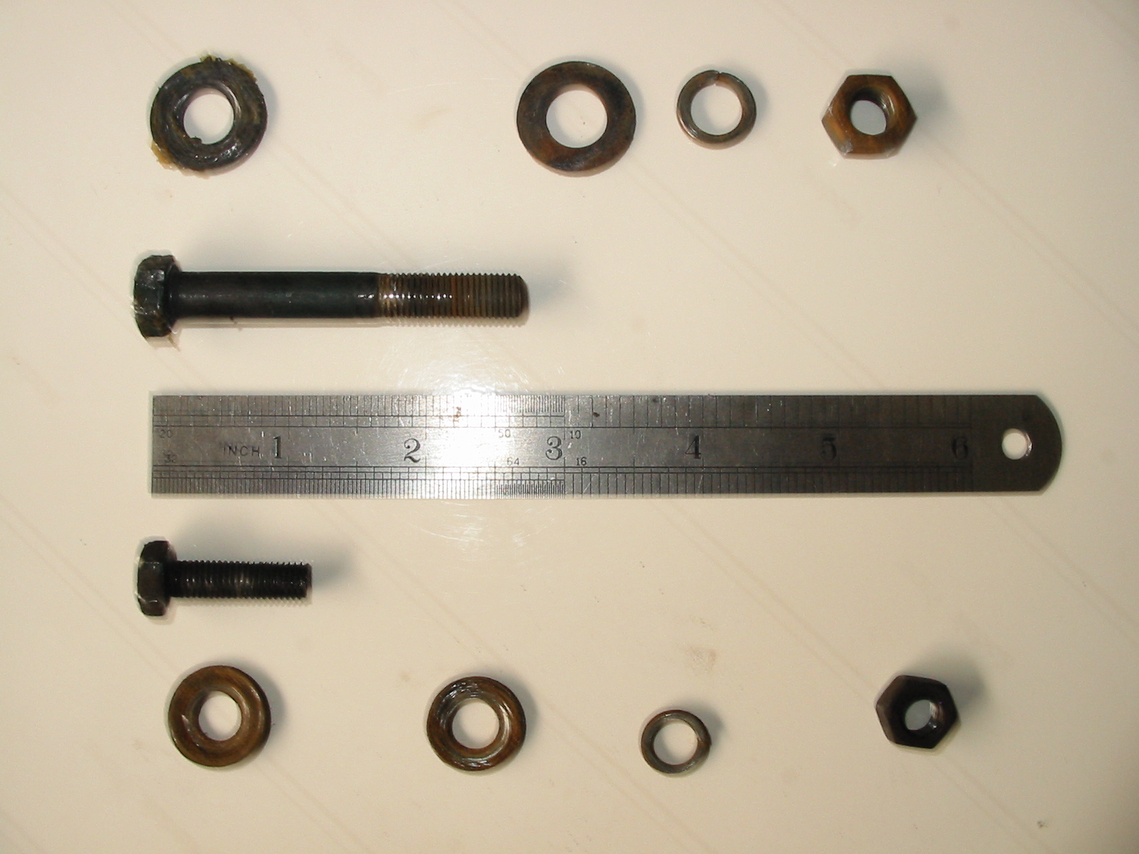

LC Torana Posted June 25, 2015 Posted June 25, 2015 It seems to be a sized between m10 and m12 but I've no idea what it is and it's difficult to guess. I would expect that would be 7/16" UNF. Very much a standard size in the P6 era. You would know that as "the wheelnut thread" - try a wheel nut on the bolt to confirm, but I'm 99% sure of this anyway. (Incidentally, I'll be pulling my back bumper off my own P6B and remounting it soon, to fix the damage from when I got loose-shunted last year (or was it the year before? So I will share your pain, vicariously like.) cort16 1

LC Torana Posted June 26, 2015 Posted June 26, 2015 That's really odd. (I assume B&Q is a big-box hardware store, something like our Bunnings). Over here, I buy UNF nuts & bolts from Bursons/Supercheap/Autobarn/Repco - so perhaps try a Halfords? I've just looked in the parts manual for the 2000 and that shows the bolts as 3/8" UNF - perhaps the V8 has a larger bumper? - I'll pop under the car in the morning just to make certain. cort16 1
cort16 Posted June 26, 2015 Author Posted June 26, 2015 That's really odd. (I assume B&Q is a big-box hardware store, something like our Bunnings). Over here, I buy UNF nuts & bolts from Bursons/Supercheap/Autobarn/Repco - so perhaps try a Halfords? I've just looked in the parts manual for the 2000 and that shows the bolts as 3/8" UNF - perhaps the V8 has a larger bumper? - I'll pop under the car in the morning just to make certain. That'd be great if you could.
LC Torana Posted June 27, 2015 Posted June 27, 2015 Well that was embarrassing. I was wrong. The four bolts (two each side) that attach the brackets to the body are 3/8" UNF The four bolts (two each side) that attach the brackets to the bumper are 5/16" UNF The picture below shows the appropriate hardware. cort16 1
cort16 Posted June 27, 2015 Author Posted June 27, 2015 Hold on does that big bolt on the chassis have a nut? I thought it was captive !
LC Torana Posted June 27, 2015 Posted June 27, 2015 The big bolts are fed through from inside the boot - on the offside you will find this below the battery; you will need to peel away the vinyl boot lining from the sides a little to expose the holes. The sequence is:Bolt head / large flat washer / boot sidewall / suppport bracket / flat washer / spring washer / full nut. cort16 1
