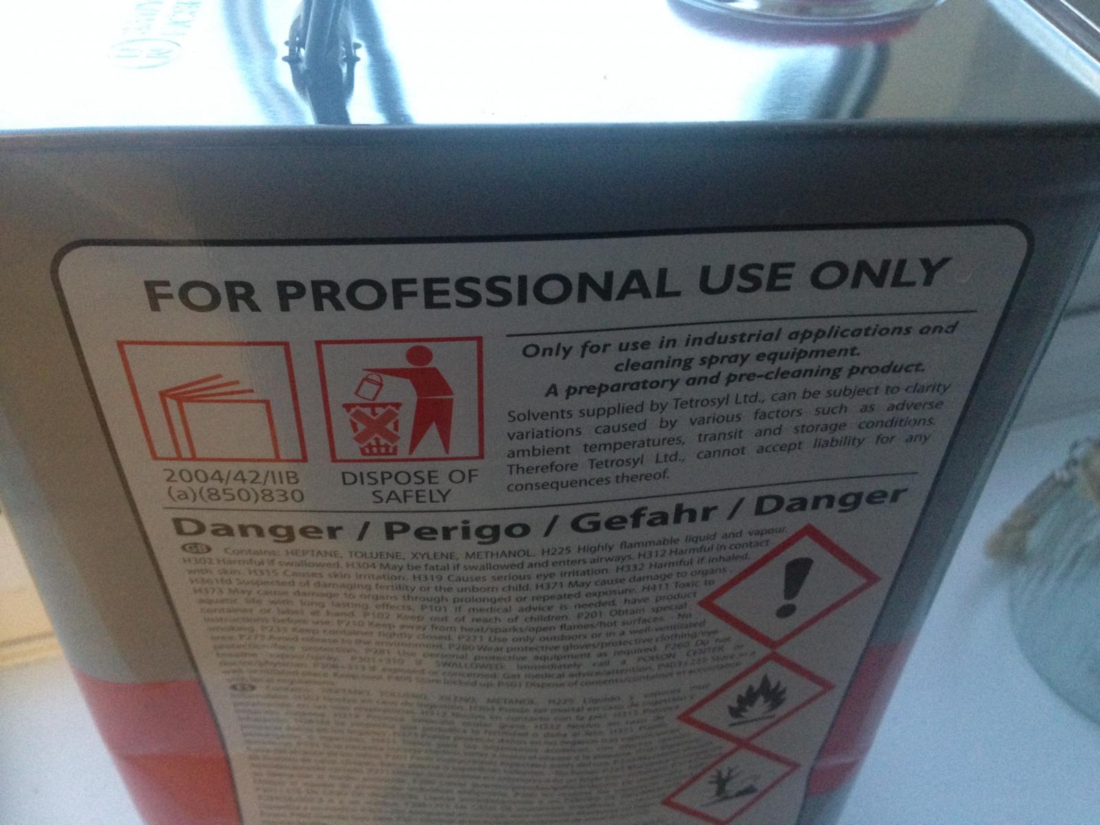

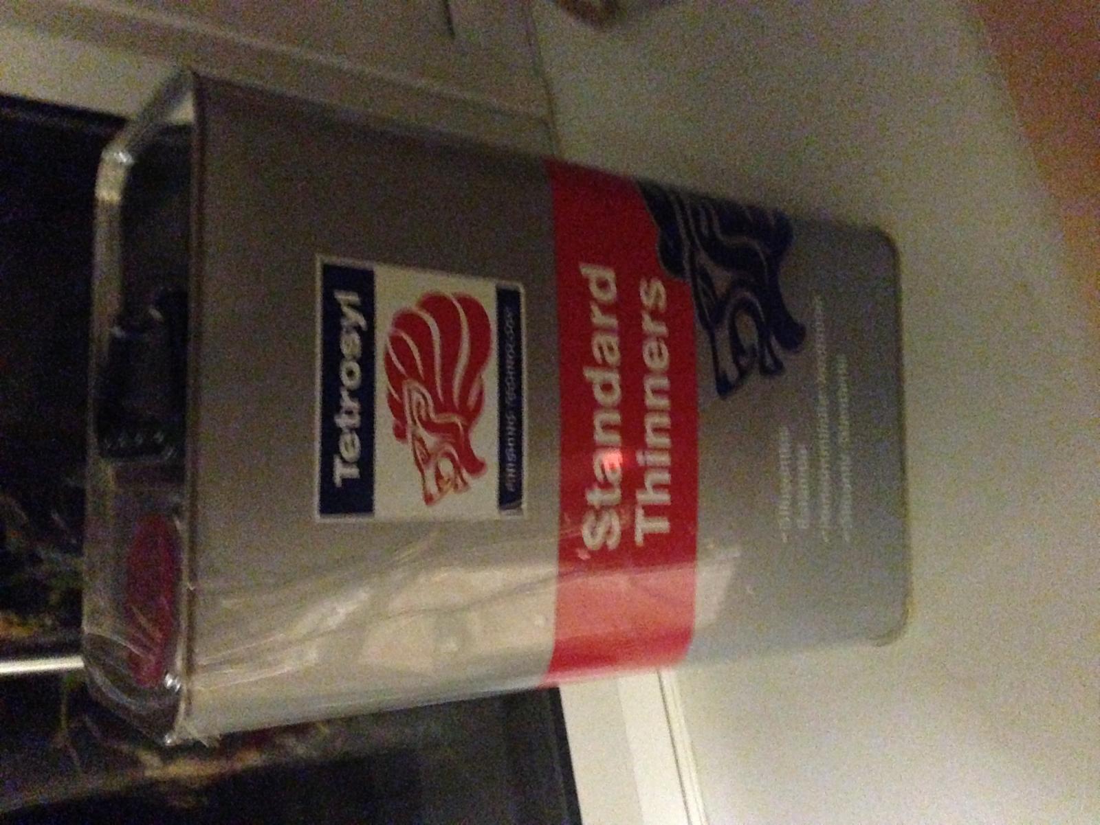

Well have been doing some "research" on the world wide web. The internet experts reckon that a dosage of thinners in the petrol gives some more ooommmppphhhh. Its meant to raise the octane rating.
Its pretty pricey, £13 for 5 ltrs and I put 2.5 ltrs in to half a tank of pez.
Dont worry I am a professional alright.
So in went some.
It was a cold night when I tested it, so that helped the turbo. Also I have been driving a transit for three weeks, but it did feel faster. Who knows if it is......
It didn't blow up so that was good.
Treated it to a service anyway to keep it happy.

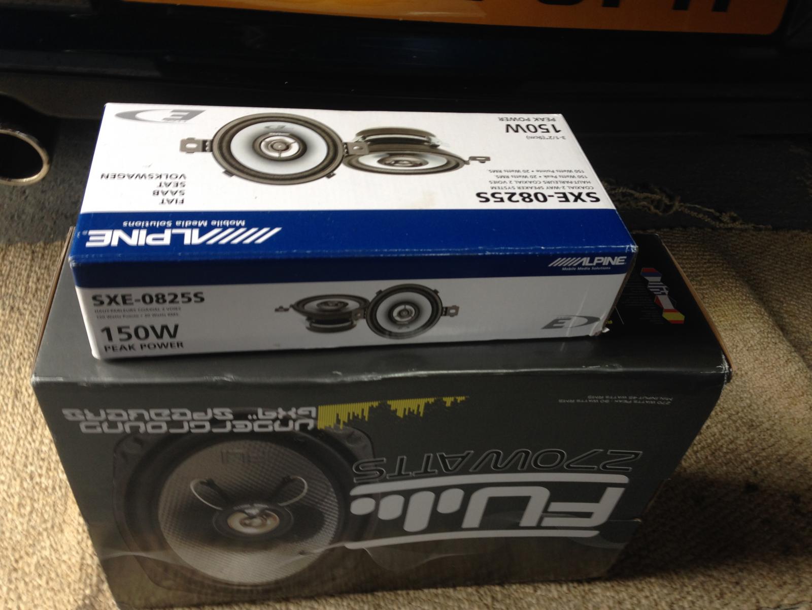

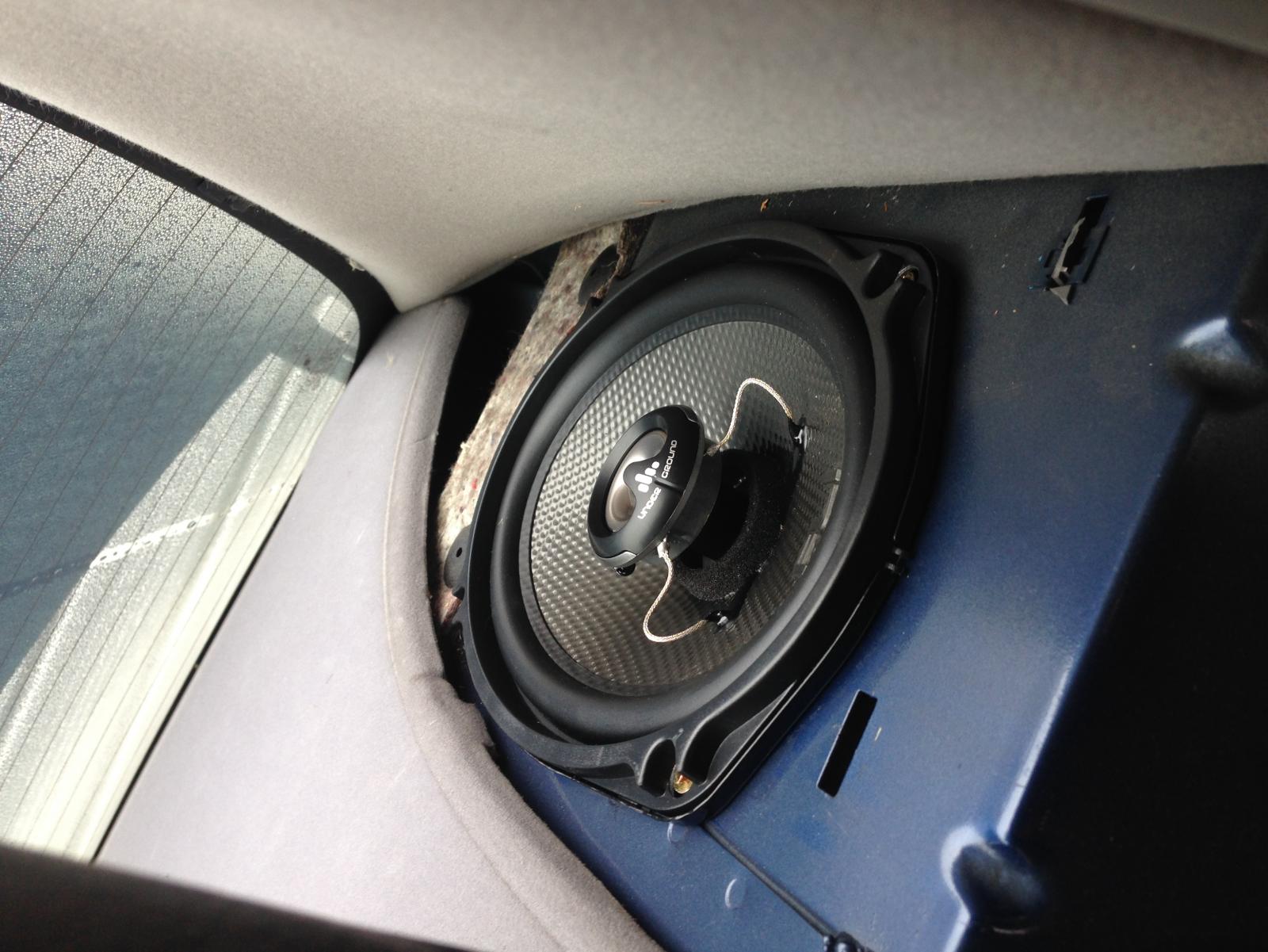

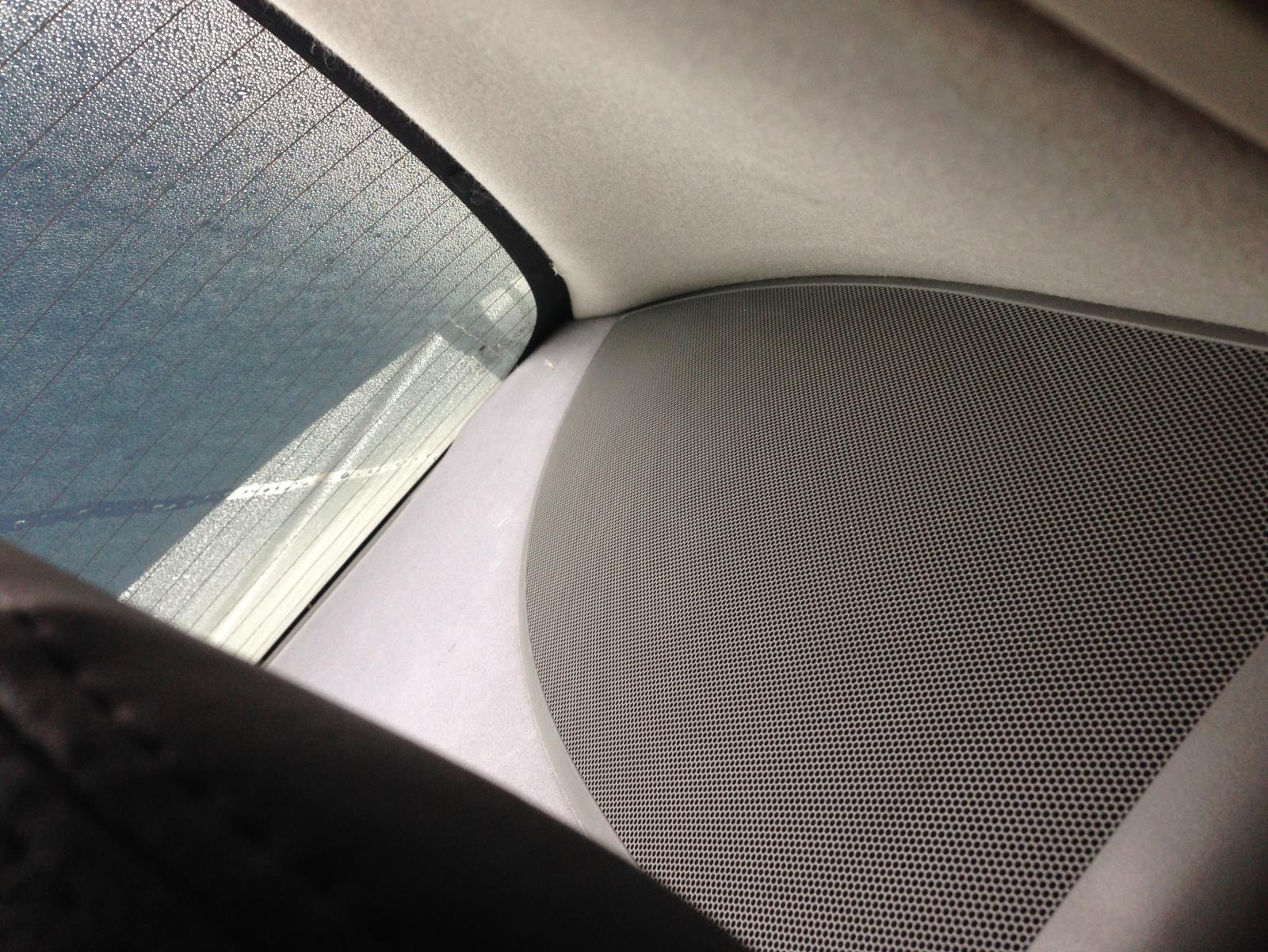

I also replaced some speakers, the 9-5 came with a variety of stereos from standard, mine came with the worst of them all the 4 speaker bottom of the range, it's crap. Plus one of the rear door speakers had gone.
Luckily in the parcel shelf there are factory slots for 6x9's, so I sacked the rear door speakers off and used the feed for the 6x9's.
A bit better but still not head banging. But will do.
Thinners is full of aromatic hydrocarbons; toluene, xylene and suchlike - the stuff that the turbo racing cars used in the 80s (sometimes referred to as the"Wintershall fuel" that was used in the 1983 Brabham BT52 with the BMW engine).
Go easy on adding it to petrol, as it also has the effect of thinning fuel pipes and fittings as well as thinning paint. ;)
I think saabs are pretty safe to put thinners in because the fuel lines are all made for e85 biofuel which is pretty nasty on rubber and plastic too .I used to put it in mine when I had the tuned ecu in it . It helped that , with trade discount , it was cheaper than petrol at the time.

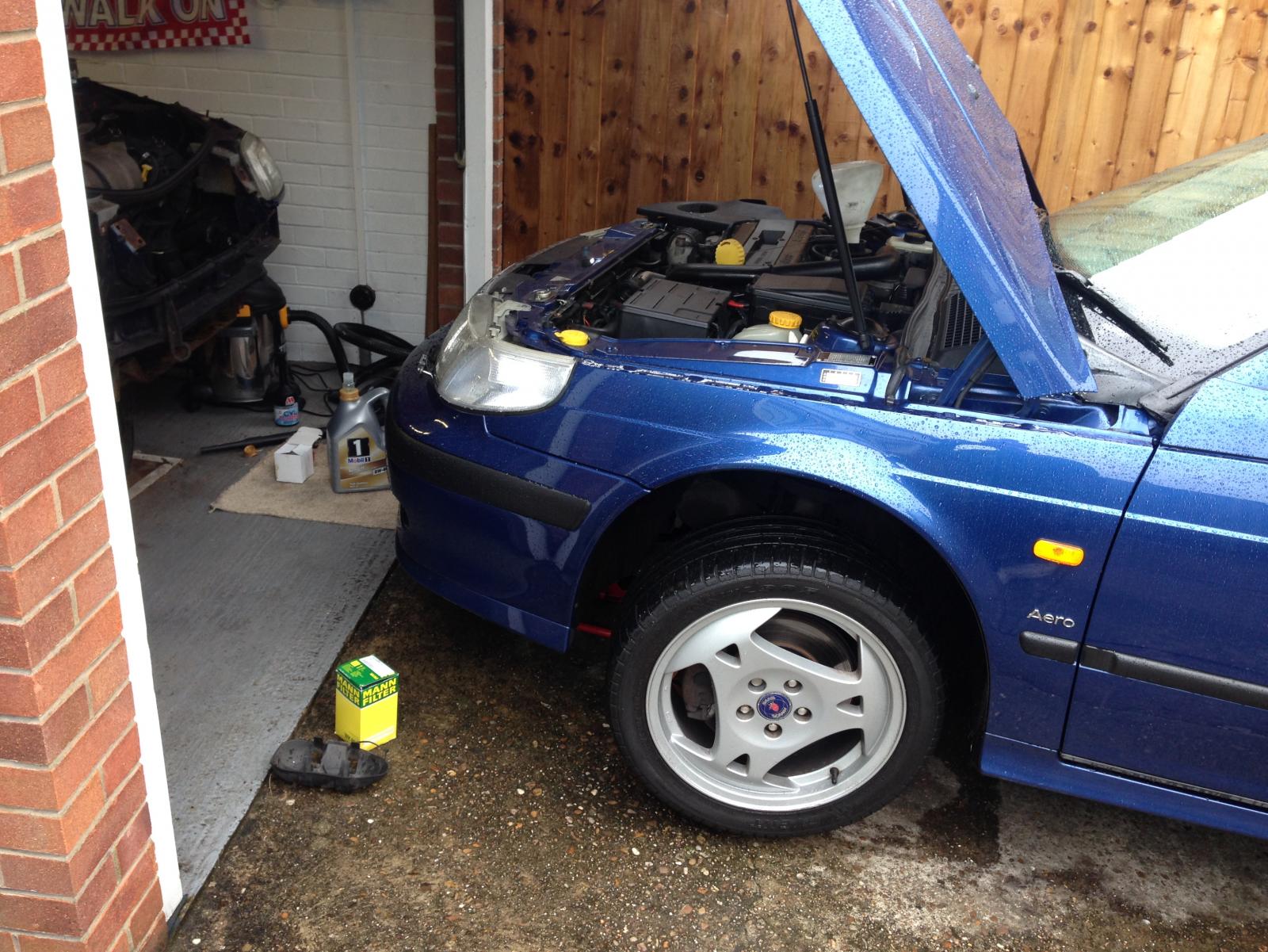

So this has been getting some loving lately. It was spluttering again which was doing my nut right in.
First up was a new MAF as I got an original for £40 new, new plugs, cleaned the throttle body. Still the same.
Got fed up and sent it to a garage, Nottingham Saab. They fitted a secondhand di cassette and its perfect. I assumed as the one I fitted was new and there was no cracks or eml lights on that it was ok, but it wasn't.
While it was there he showed me that my intercooler had ballooned out as the end tanks are plastic and when the boost is turned up they can balloon out.
Therefore I spent half the car's value on a intercooler from sweden.
Ordered today so should be with me in a few weeks.
Two new Hankook Ventus Evo went on the front so she runs a full set of good tyres now.
My Sid was also sent of for repair and I now have no more missing pixels.
A new uprated fuel pressure regulator was also ordered. I am gonna buy a 3" downpipe when funds allow and then with another remap it will be at stage 3.
To summarise, I spent far too much on a car not worth very much.
