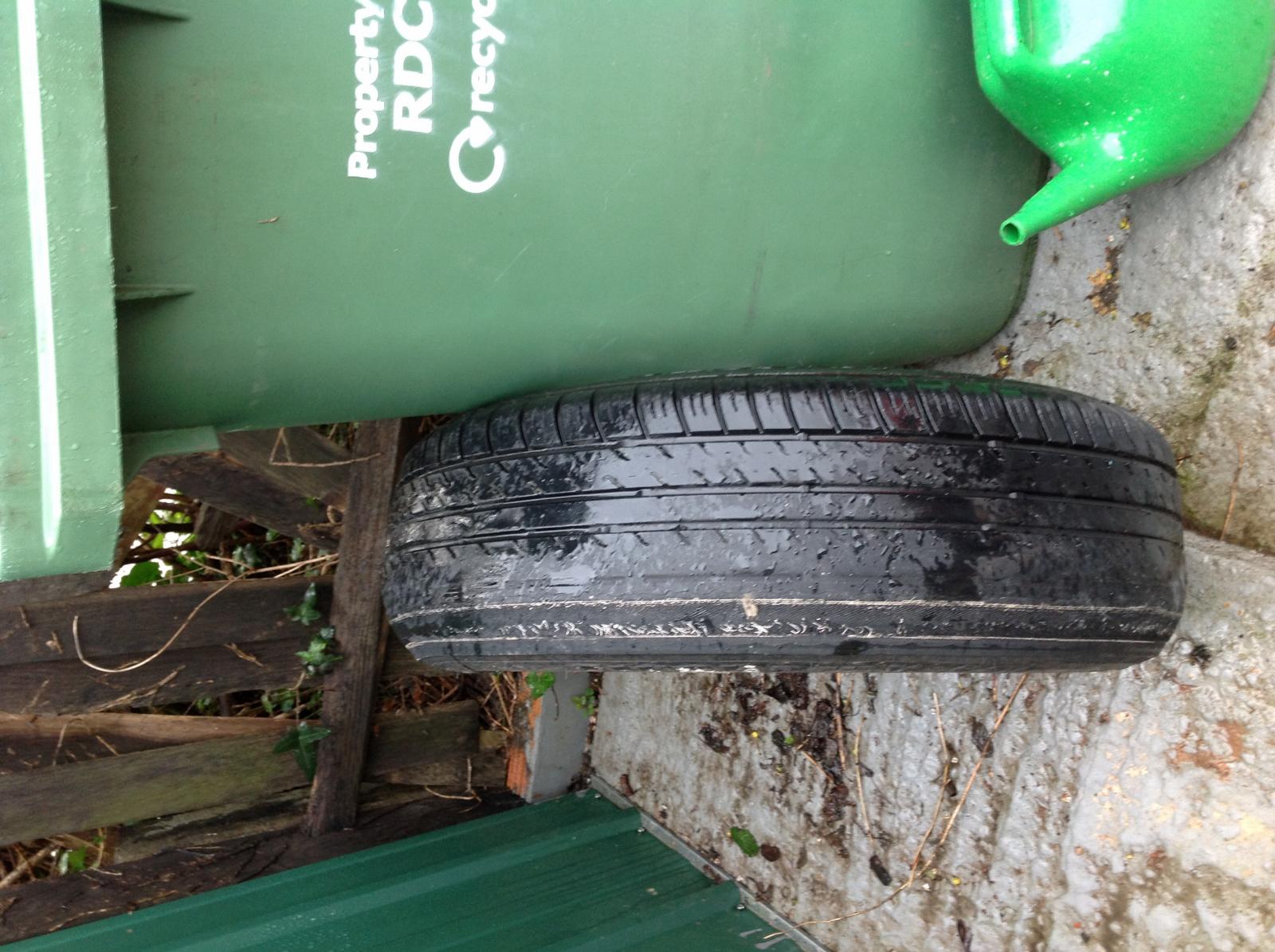

Over the last couple of days I started to notice that the steering on my car was acting rather strange (more strange than normal) in that I had to hold the steering wheel to the left to steer it in a straight line.
I always knew the car had taken a bang in the OSF wing as it had been badly repaired before I bought it but just put it down to the tracking being out but also when reversing this week started to get a grinding noise on full lock.
Then on the way home from working away today I got a terrible shake through the steering and was greeted to this.
The sidewall and alloy also look as bent as a banana so lucky for me I went on eBay and found the correct alloy with a brand new tyre on it for £44 delivered so I decided to put the spare on for now while waiting for the new wheel.
Now this is where the big problem is as when I fitted the spare I noticed that the gap between the wheel and strut is only about a cm and on the other side the gap is about 4/5cm also it looks like the wheel has been touching the inner wing as paint has worn off on it (I guess from when on full lock sometimes).
So would you think it's going to cost a fortune to fix..
I always thought the steering was rather heavy on this car and it also kind of jumps rather than grips when going around corners.
I'm not to optimistic about the outcome...
It's a shame really as its low mileage and the engine is a real gem.

with luck it would just be the strut that is bent, but it could be more especially given how the wheel is rubbing on the inner wing. could be that the front end is all out of kilter making the car a real plonker....
Yeah you might very well just need a new strut or suspension arm to sort that.

I've just got back from my local garage and the news is good as it looks like it just needs a top mount and wishbone arm and he did comment that there's an awful lot of play on that side.
So it looks like the old wheel and tyre must of taken most of the impact,
I did notice that the car did steer better than it's ever done with just driving on the old worn out spare while driving to the garage.
