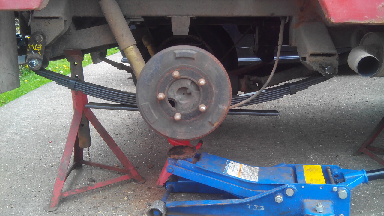

Umm spring removal time, so I've found a place in Rotherham that can  make/repair springs, and as I catch the train to work from Sheffield most mornings so it's not too much of a diversion on my way in one day.
Spring removal ... well, all the nuts were loose enough to remove, but unfortunately the bolts were seized in the bushes meaning a bit of grinder action would be needed to remove them.
A little while later we had this:
and this:
The spring with one snapped leaf is safely in the boot of the car for me to drop off at the menders one day next week, and the 3-legged Umm is left like this until the spring comes back from the spring menders.

Honestly, it was relatively easy, it could have been a lot worse. It was just the bolts being stuck in the bushes that were the issue.
All 6 nuts, a mix 21,22 & 24mm came off with little trouble. It took about 30 mins and 3 cutting discs to get through one bolt.

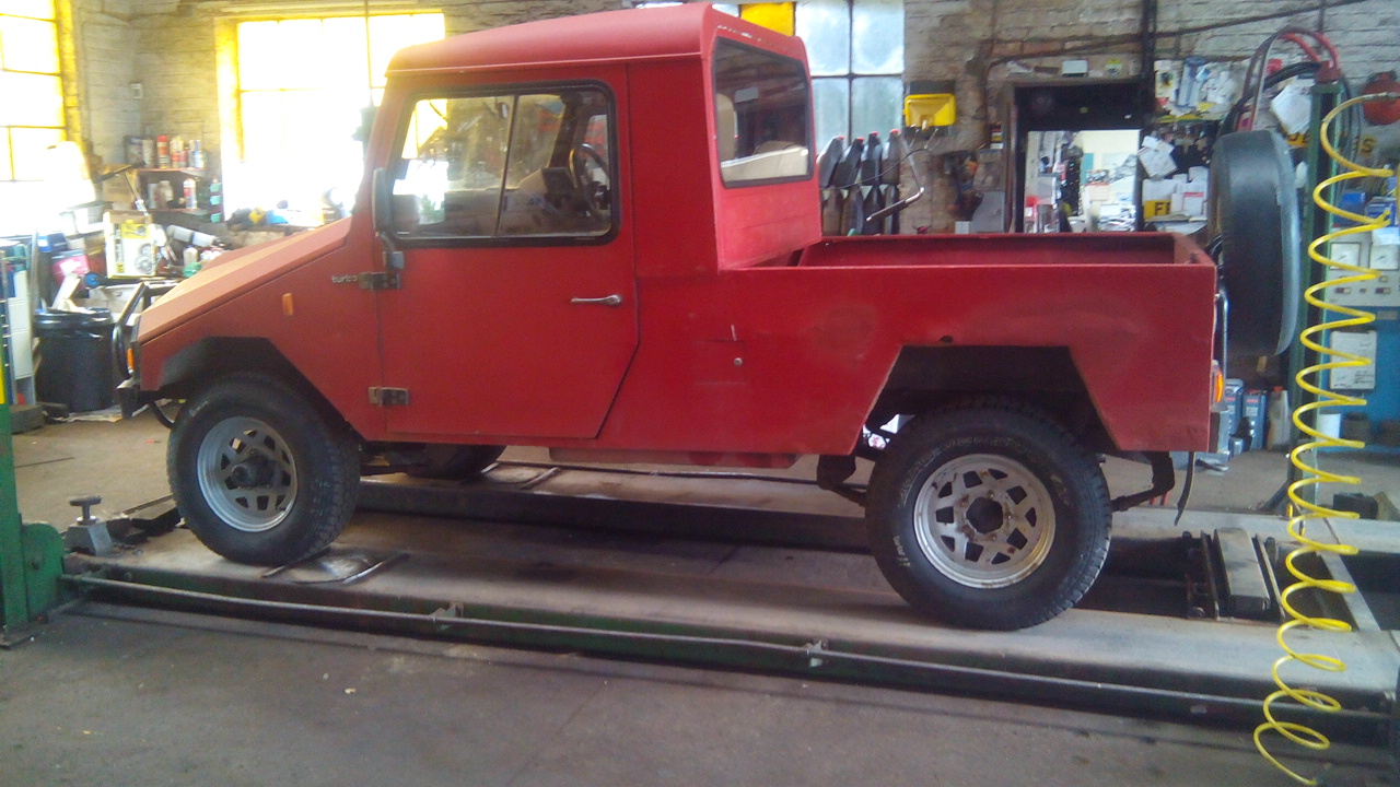

Here it currently stands in all it's glory
