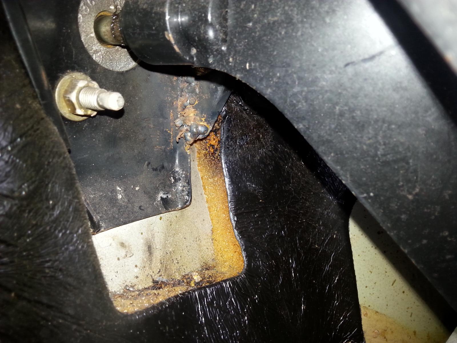

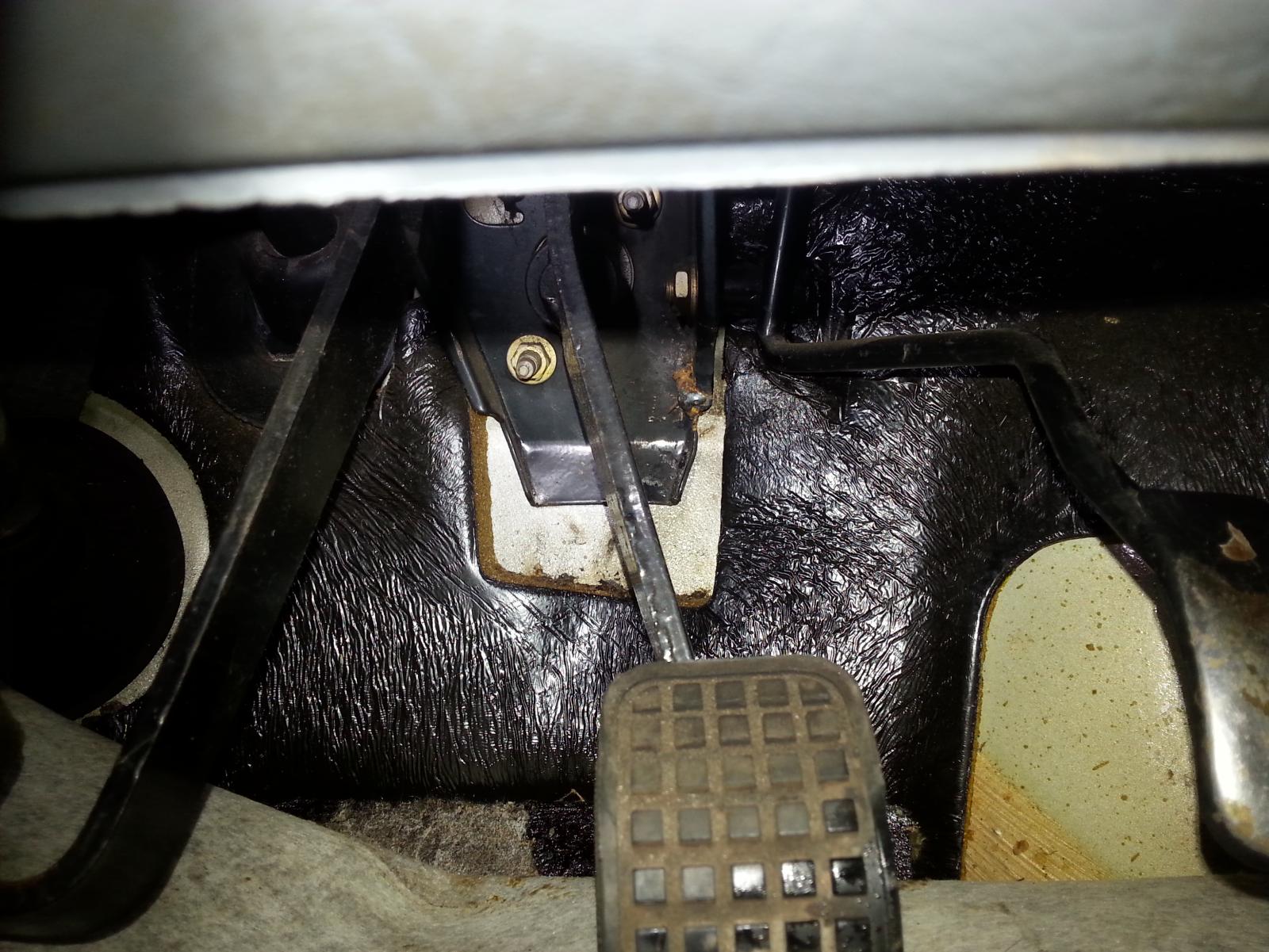

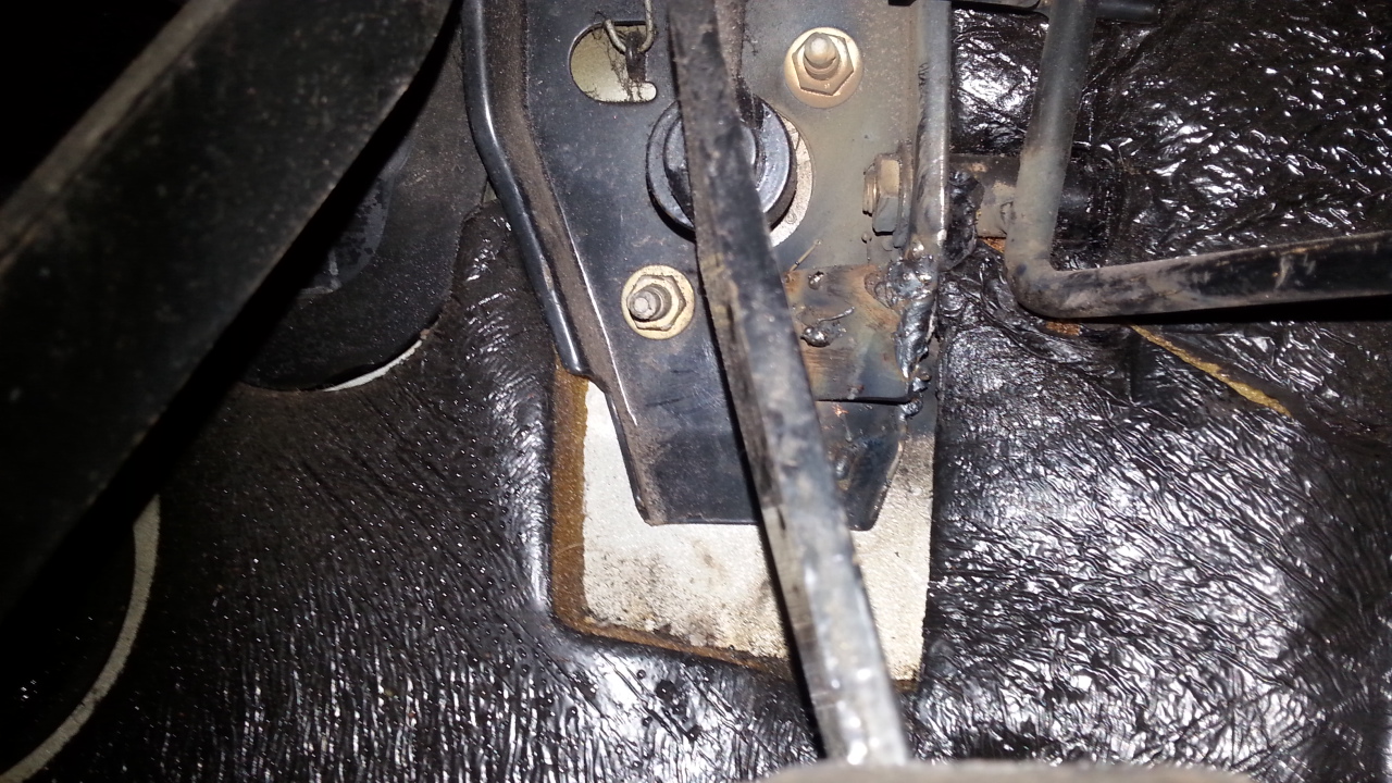

M'coli Posted January 6, 2015 Author Posted January 6, 2015 "What's that you say, Pipkin? Someone's already welded up this pedal box, badly?" "And you say it's been done while still attached to the car too? What makes you say that? Oh, I see!" Also:Not so good.
dollywobbler Posted January 6, 2015 Posted January 6, 2015 Oh crap. That has a nasty look of front-to-rear pipe about it, though it might be a leaky return pipe from the rear sphere...
M'coli Posted January 6, 2015 Author Posted January 6, 2015 It's probably front-to-rear pipe, seeing as I had it set to wheel changing mode to give me enough height to get my heid in the footwell. Any info on a rough cost for replacement, please, and can such things be made from copper or cupronickel pipe of the correct bore? Cheap BX is cheap for a reason...

M'coli Posted January 6, 2015 Author Posted January 6, 2015 Thanks - I'd forgotten their name too. I don't know where it's leaking from - I wasn't going to investigate that today, I ran out of energy because I has a cold, and time before going to bed (I'm on nights). The major consideration at the moment is sorting the throttle out, I'll be giving it a bit of a weld in-situ and adding a bracing piece to help stiffen it up. More shenanigans when I've been to work and that tomorrow.

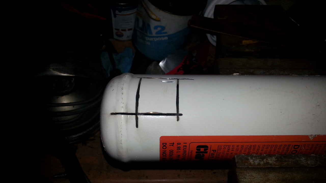

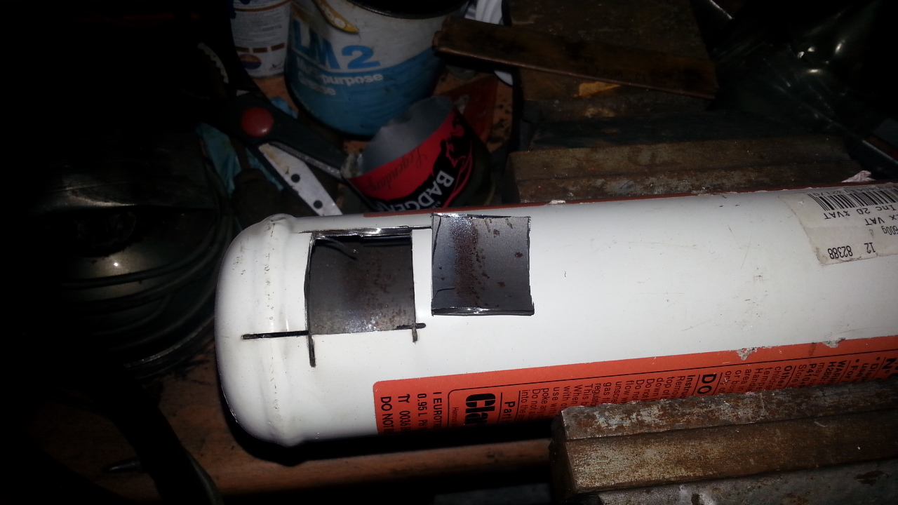

M'coli Posted January 7, 2015 Author Posted January 7, 2015 After a rather shitty night at work, I looked at welding the pedal box up on this. First job, as it happened, was to tighten the grub screw holding the ignition barrel in. Next came making a bracing piece for the box, for which I chose a lump from an empty disposable welding gas bottle After a bit of a clean up, it looked like this: Then I filled the watering can and thoroughly soaked tge engine side of the bulkhead, disconnected the battery, sprayed water over the carpets and foam backing in the footwell and broke out the welder. Initial results were, shonky, the welds cold, so putting this down to poor conductivity, I moved the earth clamp from the door latch to the repair brace itself, and turned the juice up. Success! I now have a throttle pedal that does what it's supposed to, all that's left to do tomorrow is to put the trim back. As a bonus, I put the car on "high" rather than wheelchange, and there was no pool of LHM under the rear wheel when I had finished. HillmanImp, Largactil, vulgalour and 2 others 5

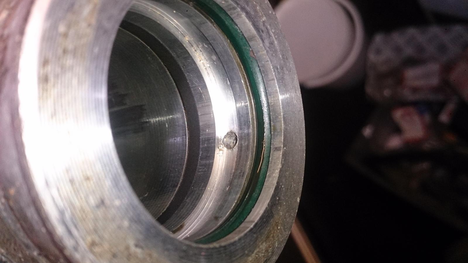

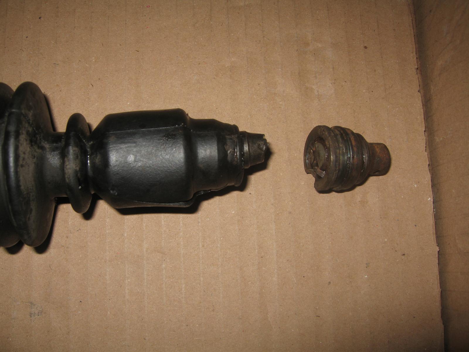

mat_the_cat Posted January 7, 2015 Posted January 7, 2015 As a bonus, I put the car on "high" rather than wheelchange, and there was no pool of LHM under the rear wheel when I had finished. Ah, if you get leakage (and a lot of it) on maximum height but next to none at other times then it may be another cause. The cylinder seals are designed to leak a small amount of LHM past them for lubrication, which returns via a drilling in the cylinder into a low pressure low volume return circuit. What can happen is that the cylinder rod can break, allowing the piston to travel further out of the cylinder than normal. On all positions other than maximum this is no problem, but on maximum the piston travels almost all the way out of the cylinder, exposing the return drilling to full system pressure which blows off the push-fitted return pipe. It makes a lot more sense when you look at the cylinder, so I'll try and dig out a spare for a photo if I haven't made much sense! M'coli 1
mat_the_cat Posted January 7, 2015 Posted January 7, 2015 Found one to take a photo of... The inner black seal holds main system pressure, but some leaks past this and returns to the reservoir via the hole in the groove, before the green outer seal. If the piston pops out too far then suddenly the groove gets exposed and off pops the return pipe! M'coli 1
M'coli Posted January 8, 2015 Author Posted January 8, 2015 So there's no real danger in running around like this? Sounds good to me. Another question: is there a way to reduce play in the wiper arm pivot point, by, for example, re-bushing it with something cheap?
mat_the_cat Posted January 8, 2015 Posted January 8, 2015 *If* that's the problem, then it should be OK. The broken end of the rod tends to embed itself in the arm in my experience, effectively locating it and preventing the piston from popping all the way out. Wiper spindles can be rebushed, but not a job I've had to do yet - I replaced mine with a low mileage part a couple of years ago. I've heard of split copper pipe being used if that's helpful.
