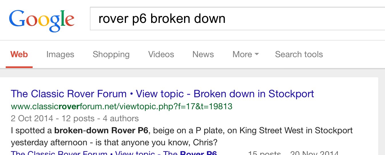

Conrad D. Conelrad Posted December 28, 2014 Posted December 28, 2014 Yep, you read right.After 5 years of standing around chain smoking for 45 minutes every time I switched it off, and the car often stalling in heavy traffic even on cold days, even I had enough.If anyone thinks this is an exaggeration, if you Google "Rover P6 broken down" or "broken down Rover P6" the top result is about Junkman's car. HillmanImp, scruff, Junkman and 2 others 5
