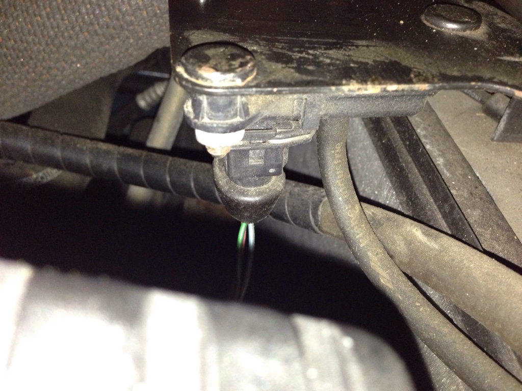

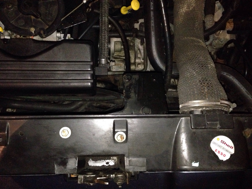

I had the same. One of the vacuum tubes came off the MAP Sensor, which is underneath the front panel, near the bonnet catch.
Push the tube back on and happy days.
If it's the same engine as I have in my Xantia 2 litre automatic I know what you're on about! Mine did that a few times recently but after a full service (including a fuel filter change) and a good belt round the M25 it's been much better! Maybe it was the belt that did it... Solid engines otherwise!
Here are the photos of the sensor Junkman is referring to:
For context, the sensor is in the centre of this photo.
