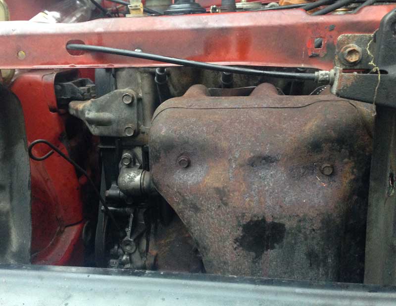

Daihatsu Disaster - Operation OMGHGF successfully completed
However, it doesn't start.
Pretty standard occurrence, following any significant work to a car. Usually leads to pretty extensive dismantling, followed by confirmation that everything is in the correct place. Which is then followed by reassembly and a further trial, during which the car fails to start again.
You must disassemble/check/reassemble at least 3-4 times, before you can realise that the car doesn't start due to some minor, unrelated issue, e.g. because you've fogotten to attach one of the coil LT leads.
Ask me how I know...
There is a spark, or rather three of them, but the distributor needed setting one tooth further towards cylinder 1.
The car wants to run, however, no fuel pumpage is forthcoming.
When I pour petrol down the throat, it runs for a few seconds with no untoward noises.
I tried to prime the fuel pump and there is petrol at the pump, but it's not pumping anything through to the carb.
Is there a fuel pump priming procedure?

Actually, there is a little pushrod that actuates the fuel pump.
Fuel pumpage much improved after little pushrod installage.

Some zorst connectage, head retorquage, and tappet adjustage was had today.
It's now running exceedingly as it should.
One tiny water leak needed epoxyage.
It was found out today, that the thermostat is stuck closed, which could be the cause of all this.
A new thermostat should arrive tomorrow lunchtime and upon installage, WCPGW on the epic trip to Cannock?
