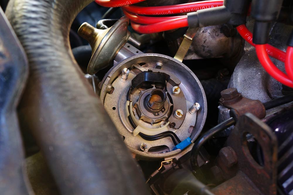

So, ignition.
The spacing between this trigger wheel and its sensor was reason this ignition system didn't work when it was first installed, so that was the first thing I checked. It was fine. The distributor cap, also fine.

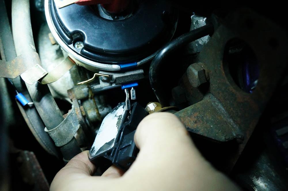

I installed a spare coil, and even a new 12v feed just in case the melting fuse box was the problem.
Then I fitted a replacement ignition module.
The upshot of all this? NO CHANGE.
