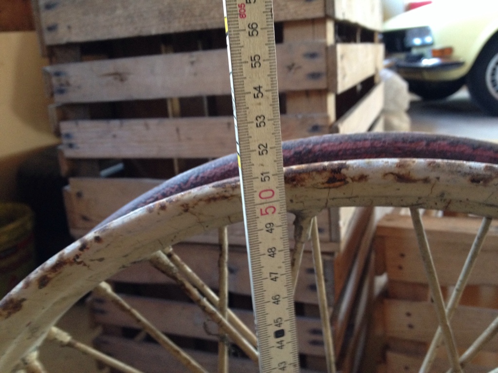

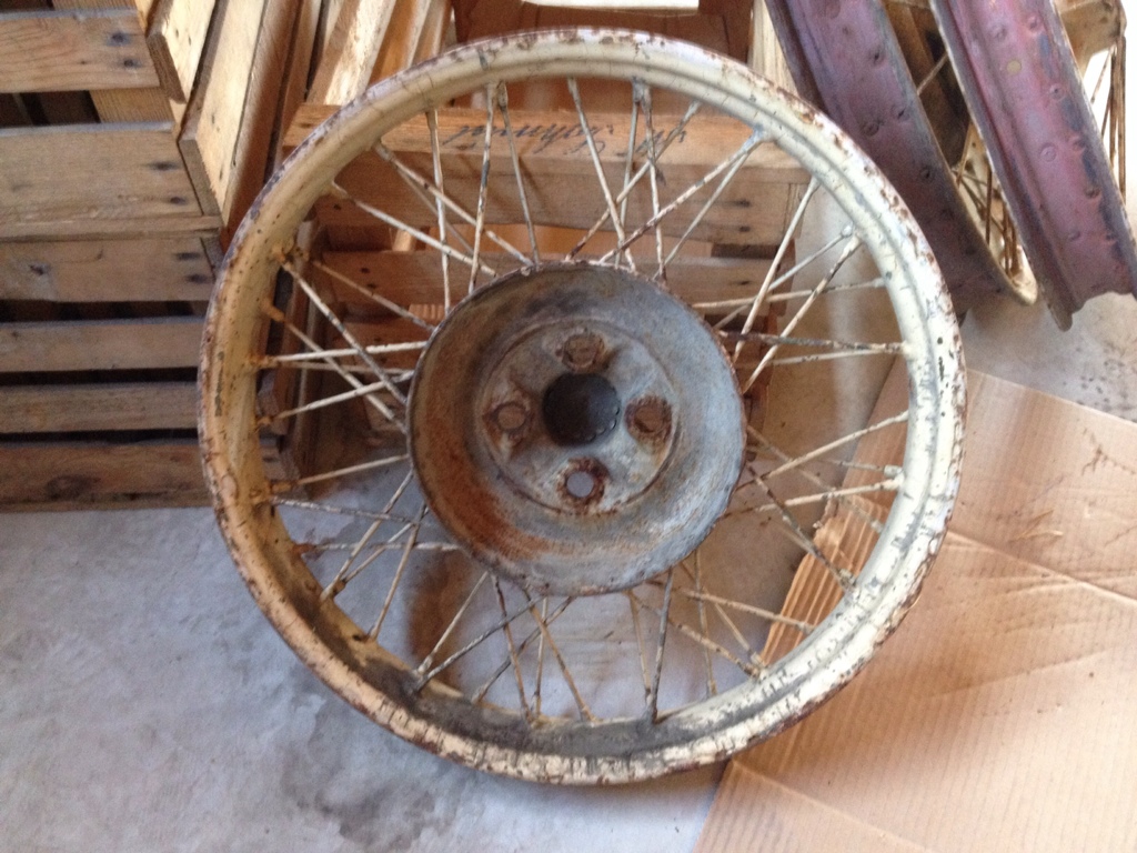

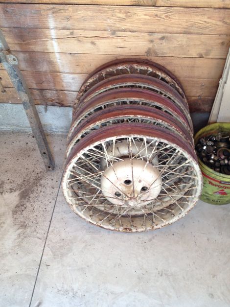

wheels to identify
Found in neighbours barn, has anybody a clue where these may come from?
Thanks!

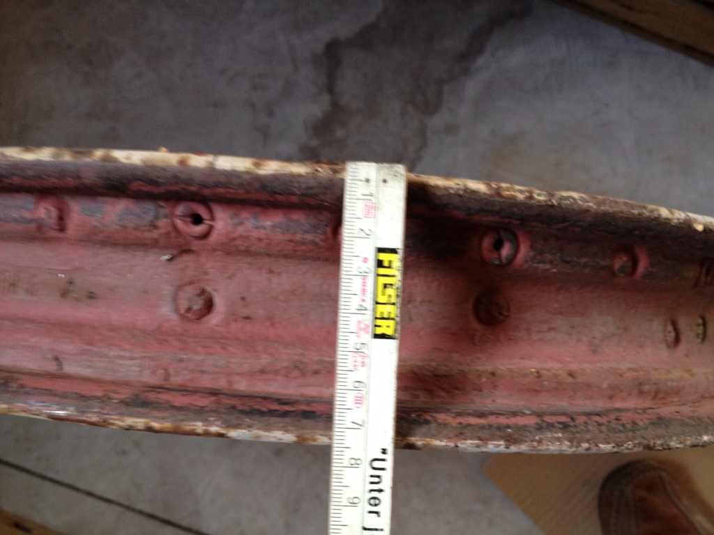

Barn find, eh?   Adds £££s.  I suspected they were Ford Y Type but they were AFAIK 5 stud and what  you have appears to be 4.    Colour would be about right for the Ford...Any stampings/marks/numbers anywhere?

Michelin surely suggests they originated on a French car? Obviously they're pre-war, and I can tell you they're not Austin Seven, as they had 'quick release' holes where you could simply slacken the wheel nuts, twist slightly and the wheel would come off.
wild guess - Rosengart (French Austin 7 derivative).  Wheel size is about right for Austin 7 although the hubs don't look correct still.....

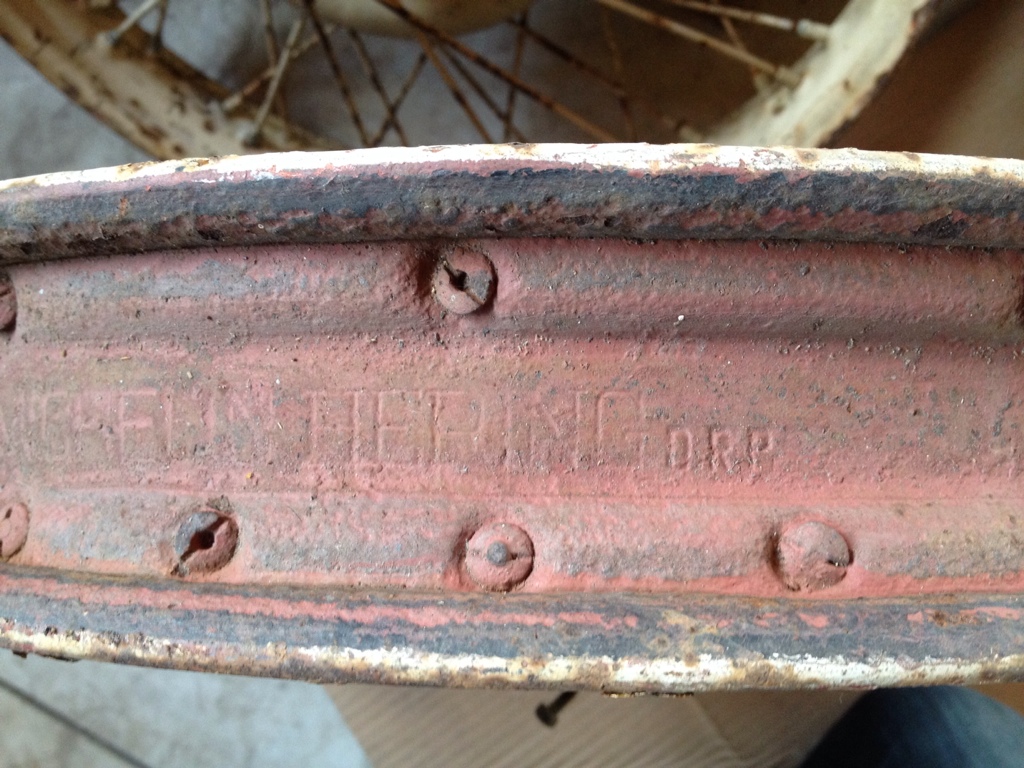

Google says "Max Hering" was a wheel manufacturer in Ronneburg, Germany.
DRP stands for "Deutsches Reichspatent", so its a german wheel, maybe made under license from Michelin.

Hubs still don't look right unfortunately, wrong shape and the BMW Dixi still had the elongated stud holes. That was my first thought too.

Michelin-Hering was the German branch of Michelin, and DRP (Deutsches Reichs-Patent) indicates they were made in pre-war Germany.
"The BMW small car [...] is delivered with Michelin-Hering semi flat shoulder rims as standard equipment"
