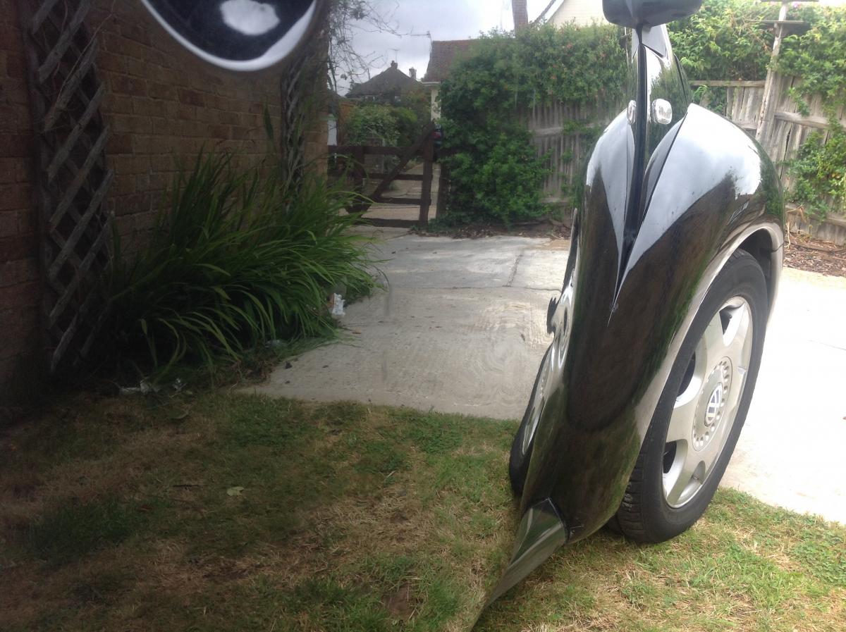

After my successful repair on the sill of my car using Halfords rattle cans I'm spurred on to do the door now. post-9282-0-56874700-1404995792_thumb.jpg
The problem I have is the door isn't to bad just a few little low spots and scrapes on it and I wondered if I would have to paint the complete door or could I get away just painting the damaged area then putting a coat lacquer over the damaged areas then give it a going over with some 1200 grade and soapy water..
The car is a standard black and doesn't contain any metallic in the paint but I would like the finish to look like its original paint.
I've got the dents out as best as I can but it's going to need a dob of filler

That's so shiny that at first glance I thought I was just looking at a wheelarch with a wheel under it, but not actually attached to a car.
Black shows up every tiny imperfection in your prep work - I would be surprised if you got a decent spot finish with a rattle can and painting the whole door with cans, while possible, may also end up looking bad compared to the rest of the car.

I'm still struggling to see any damage, although the reflection of the wheel looks a bit wobbly :? If I were you I'd leave it, just dab in any deep scratches. Unless you've done lots of this sort of thing it almost certainly won't end well. As above, high gloss black will show up everything and it's notoriously hard to match. You could just paint the whole door but you'll know, and any buyer will probably notice the door and wonder how bad the crash was...
