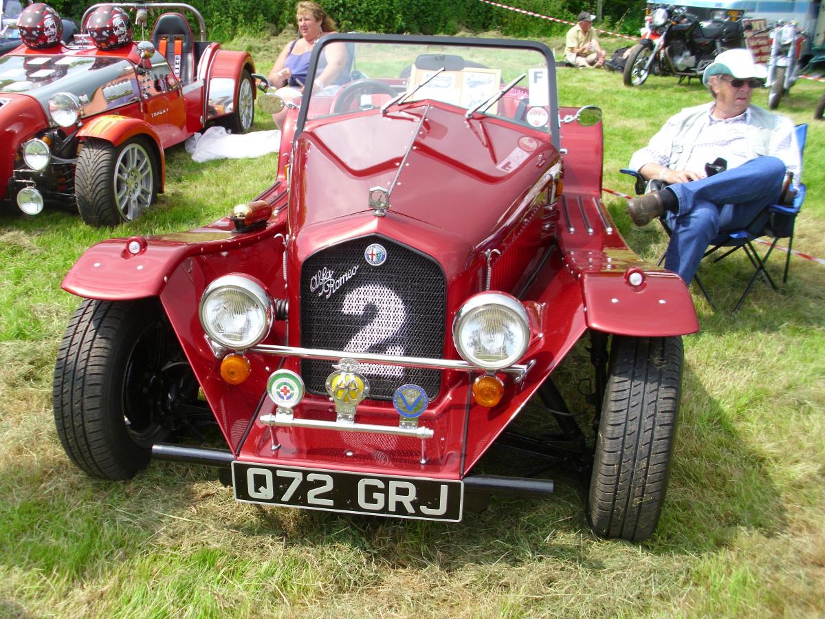

Twin sparks? GTVs? Pah...
My Dad snapped this at Louth classic car show yesterday...He thought he was doing me a favour...bless him...
Guest Breadvan72
Give us the Lat-Long and we'll call in an air strike.
