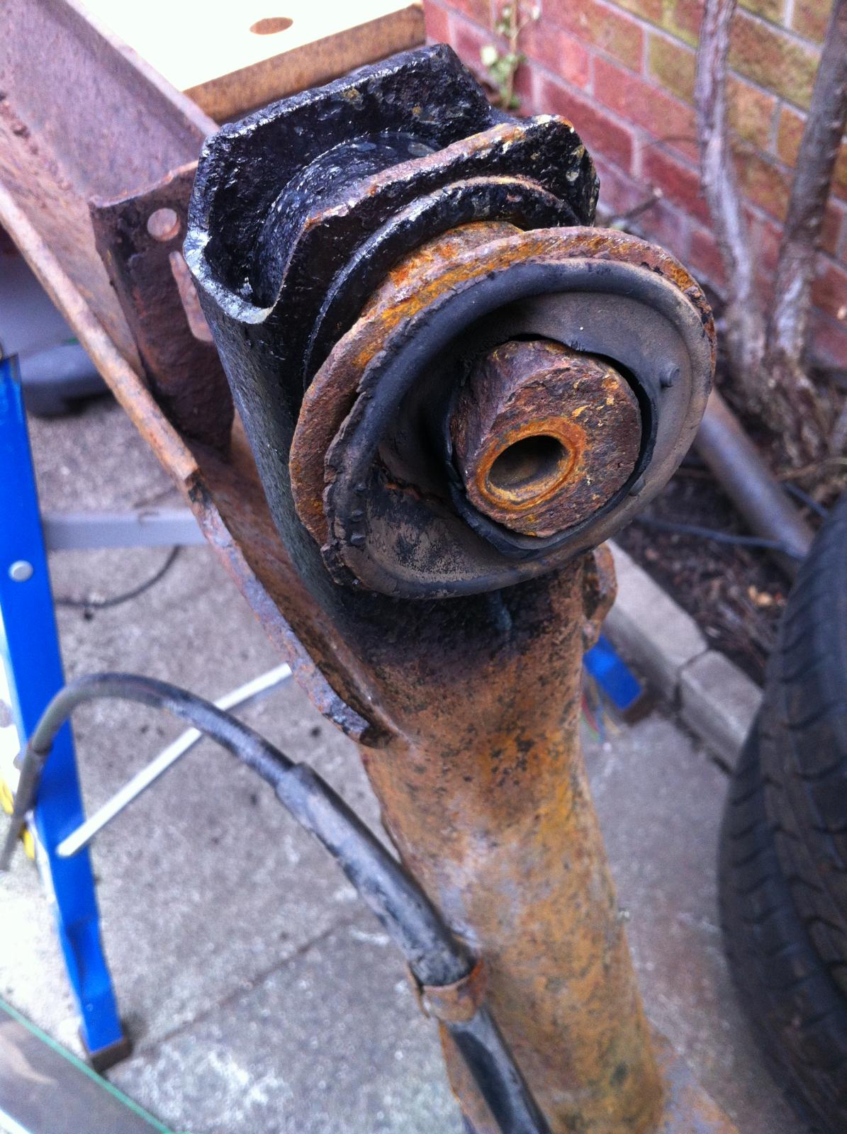

The rear axle got a refurb whilst it was off the car - a wire brushing & lick of paint

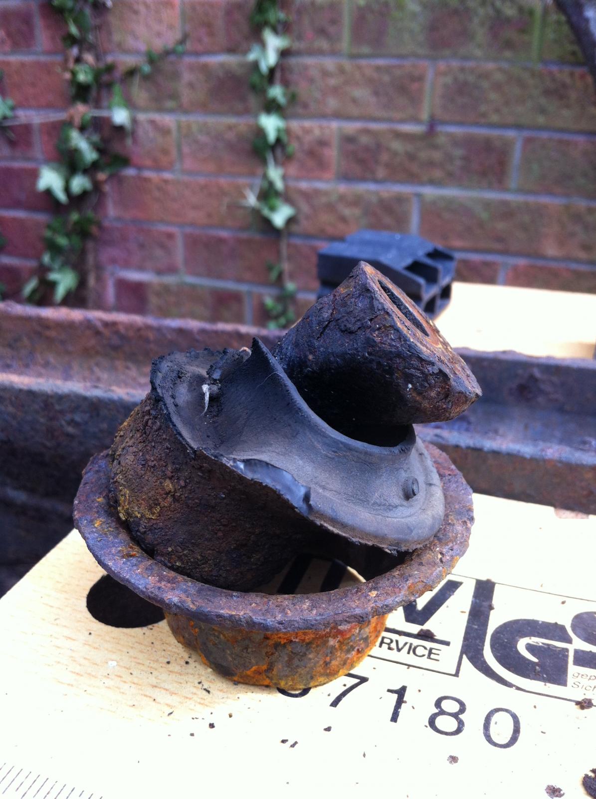

The pivot bushes were knackered & fell apart

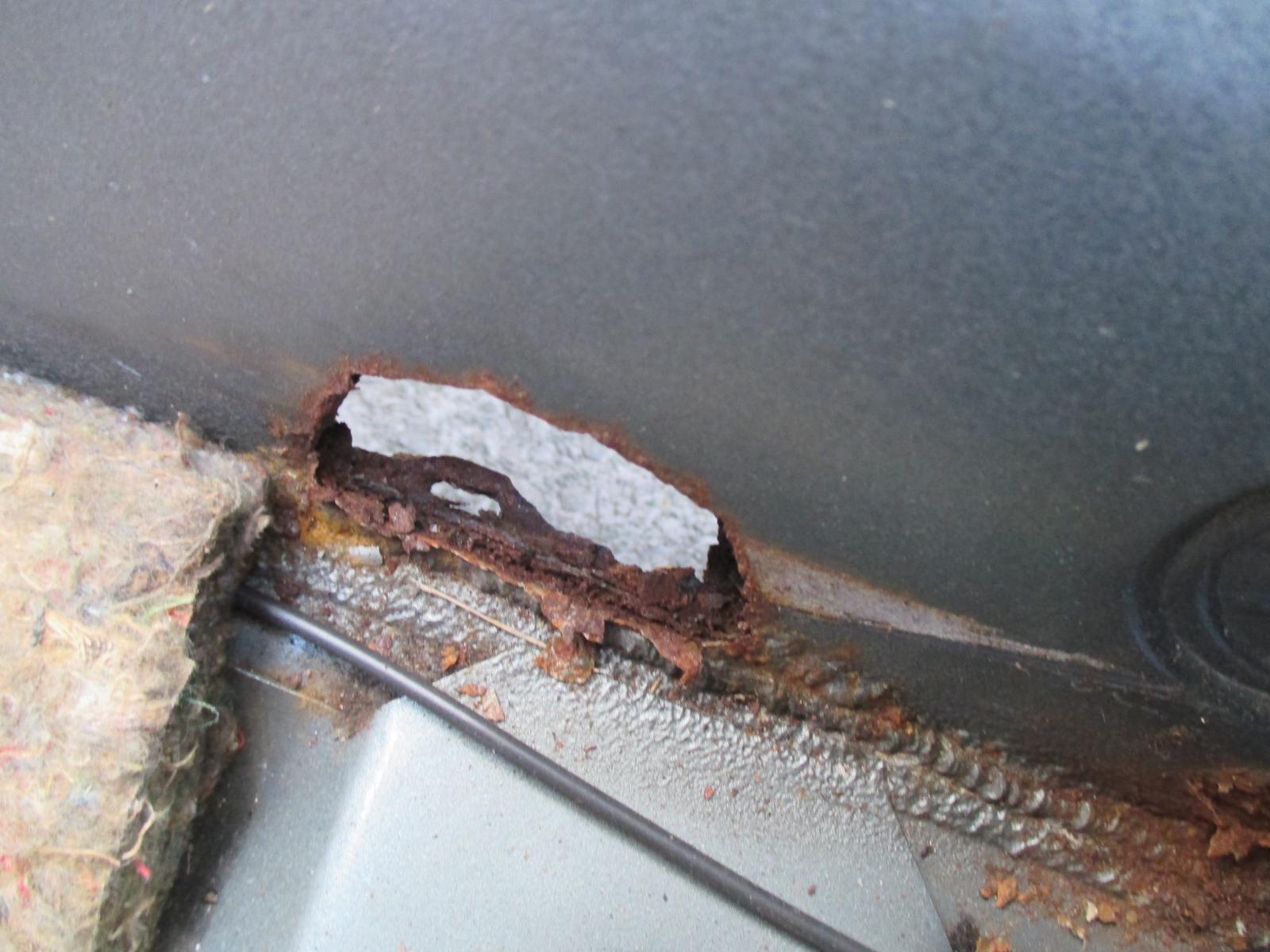

Did some more fettling on the saloon, cutting out rust & patching up -  where the fuel neck/filler pipe attaches to the rear inner arch creates a rust trap (an effective one too) the support bracket had rotted away & munched its way through the inner arch. I had been putting this repair off as access is difficult & an awkward shape (it's also next to the rear seatbelt inertia reel mount & as I unbolted this the captive nut sheared off) So working from inside the boot welded new metal in
Removed the filler pipe (which is plastic) to stop it being melted & to make a new support bracket, I cleaned up the metal bayonet bit on the end as this was rusting, painted it & the bracket with this brown paint that "stops rust dead" apparently

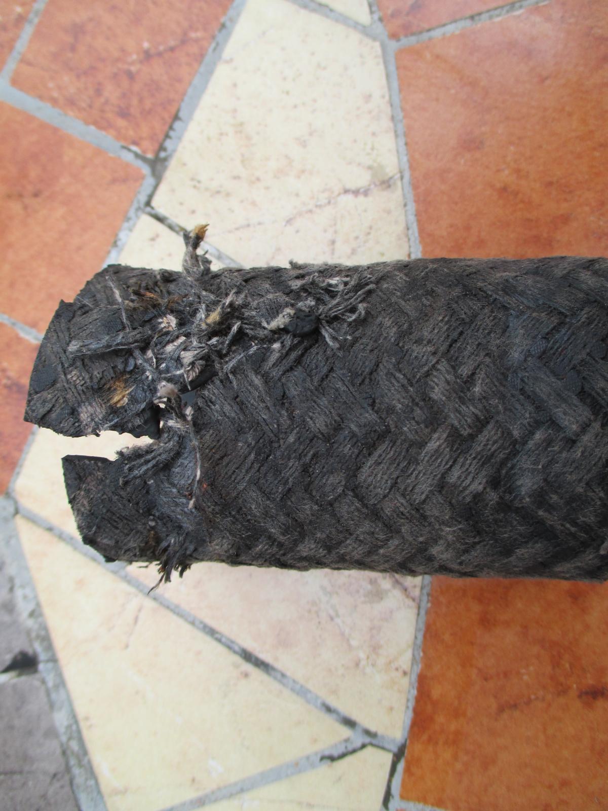

Where the filler pipe joins the fuel tank, a short rubber braided hose is used as a coupler - naturally this split when I removed the pipe

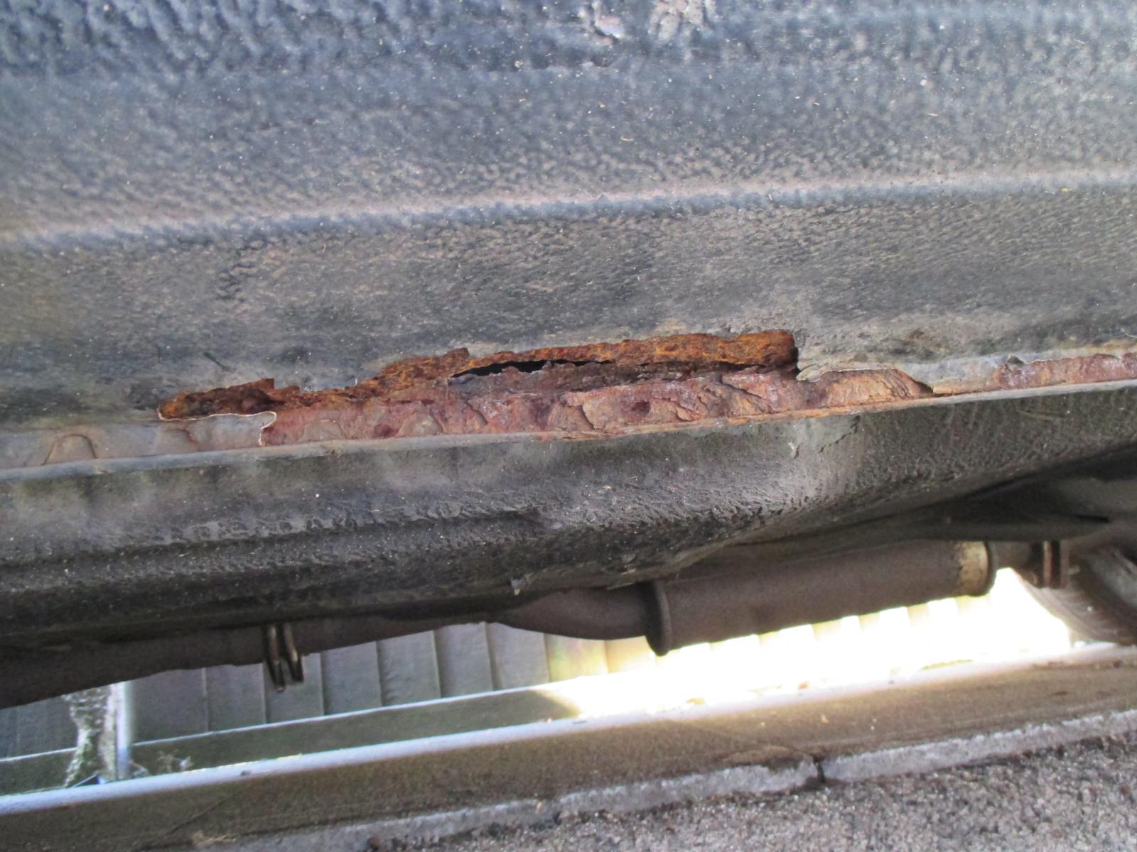

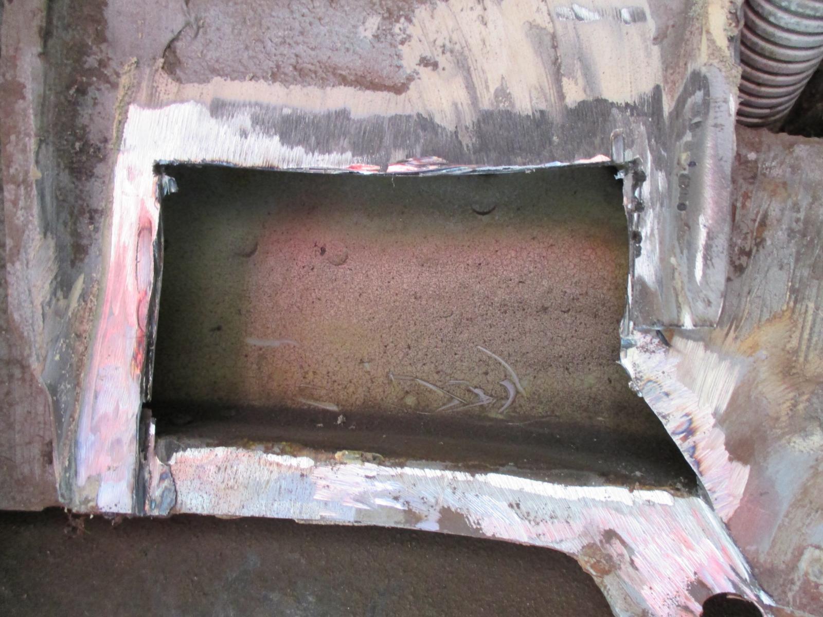

To keep Mr V & Samba company on the rust fighting front, I've been plodding on with this - I thought it would just need a small patch on the inner cill & a slightly larger one on the outer, but tin worm had eaten more than that - the rot had gone deep into the seam, so it had to be cut out
All the rust cut away

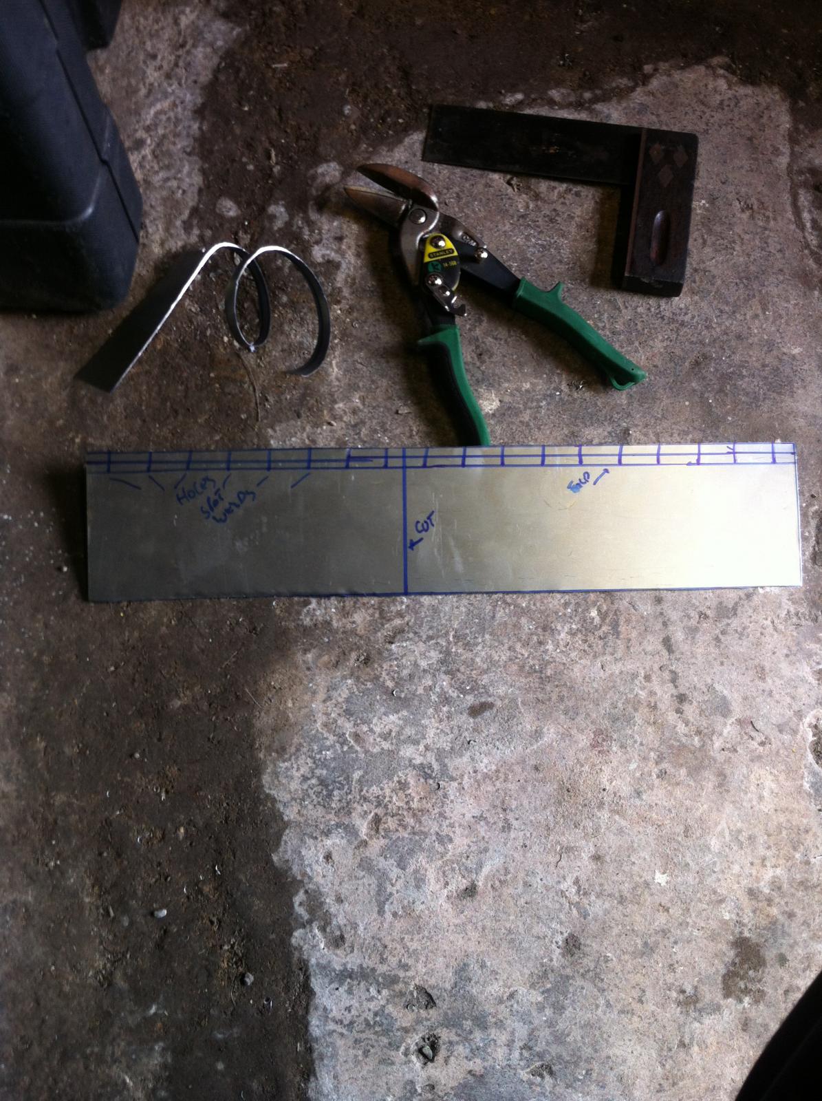

The floor pan bends down  90°, the inner cill meets it to form a sort of 'Y' shape & the outer cill curves under & all three are then spot welded together
Marked up cuts & folds on the new metal from a cardboard template
..... & welded it in place
The lot was given a spray of weld thru primmer & the outer cill was patched to finish off, but can't find the last photo
