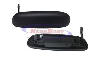

Quite a common problem both with the boot lock and especially the door locks on the mk3/4 Fiesta...
My sister in law had the bootlock problem you mention and I fixed it with a soaking of 3 and 1 oil in the lock and working the key for 5 minutes..
As for the door lock I found the key would turn on mine and the central locking would work but when you pulled on the door handle you couldn't get in..
It was hit and miss as sometimes it would work and other times I couldn't get in the drivers side then it packed up altogether so it was a climb over the seat job from the passenger side..
In the end I took the door card off and found the problem was a hairline crack in plastic door handle which caused the handle to stop operating the locking mechanism ..post-9282-0-48764300-1390424014_thumb.jpg
If you look at the picture it was the pin that sticks out on the handle which caused the problem..
I bought a secondhand handle off eBay for a fiver and it worked fine afterwards.
