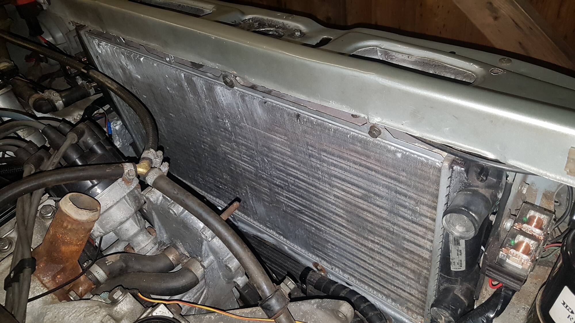

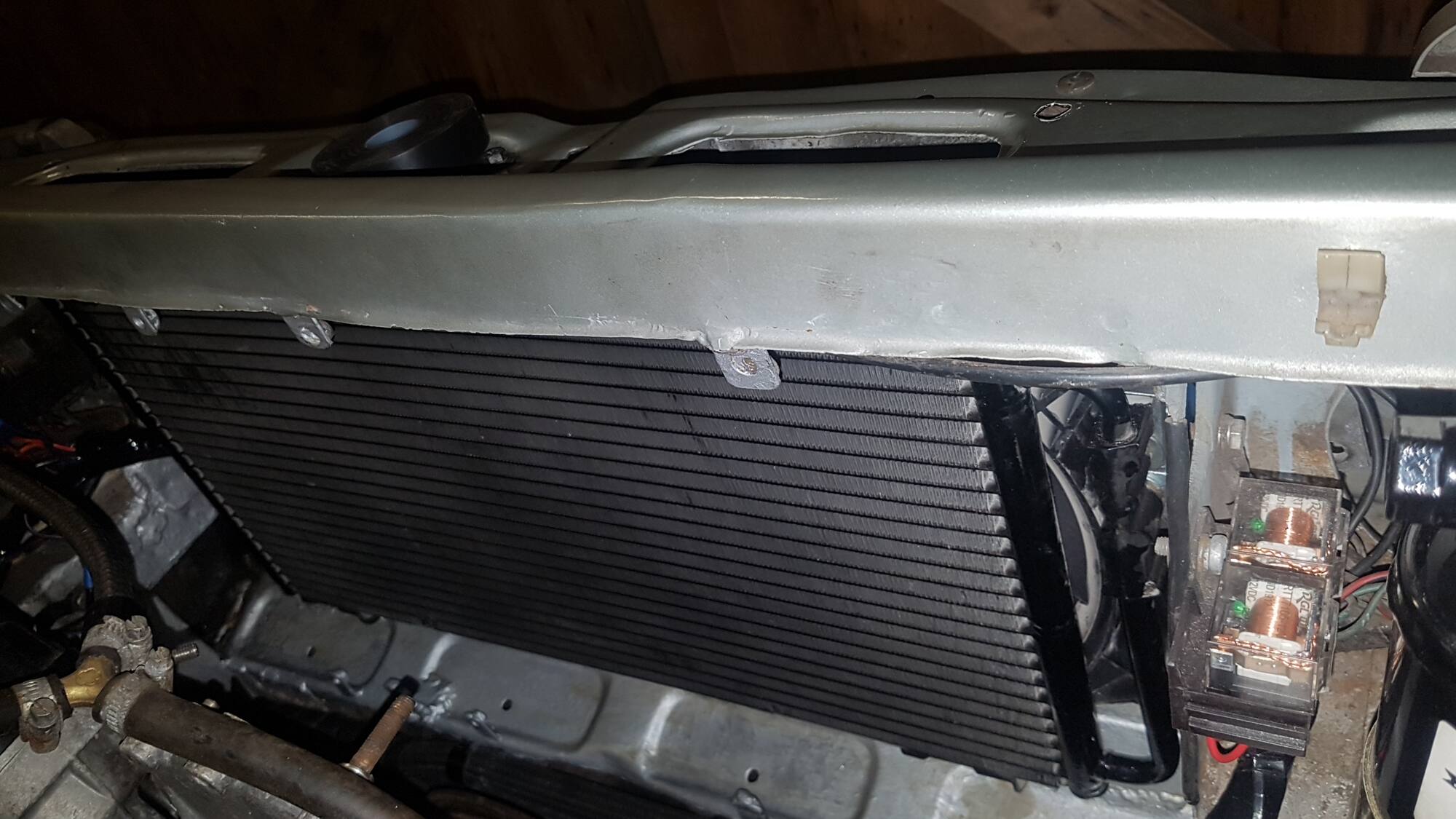

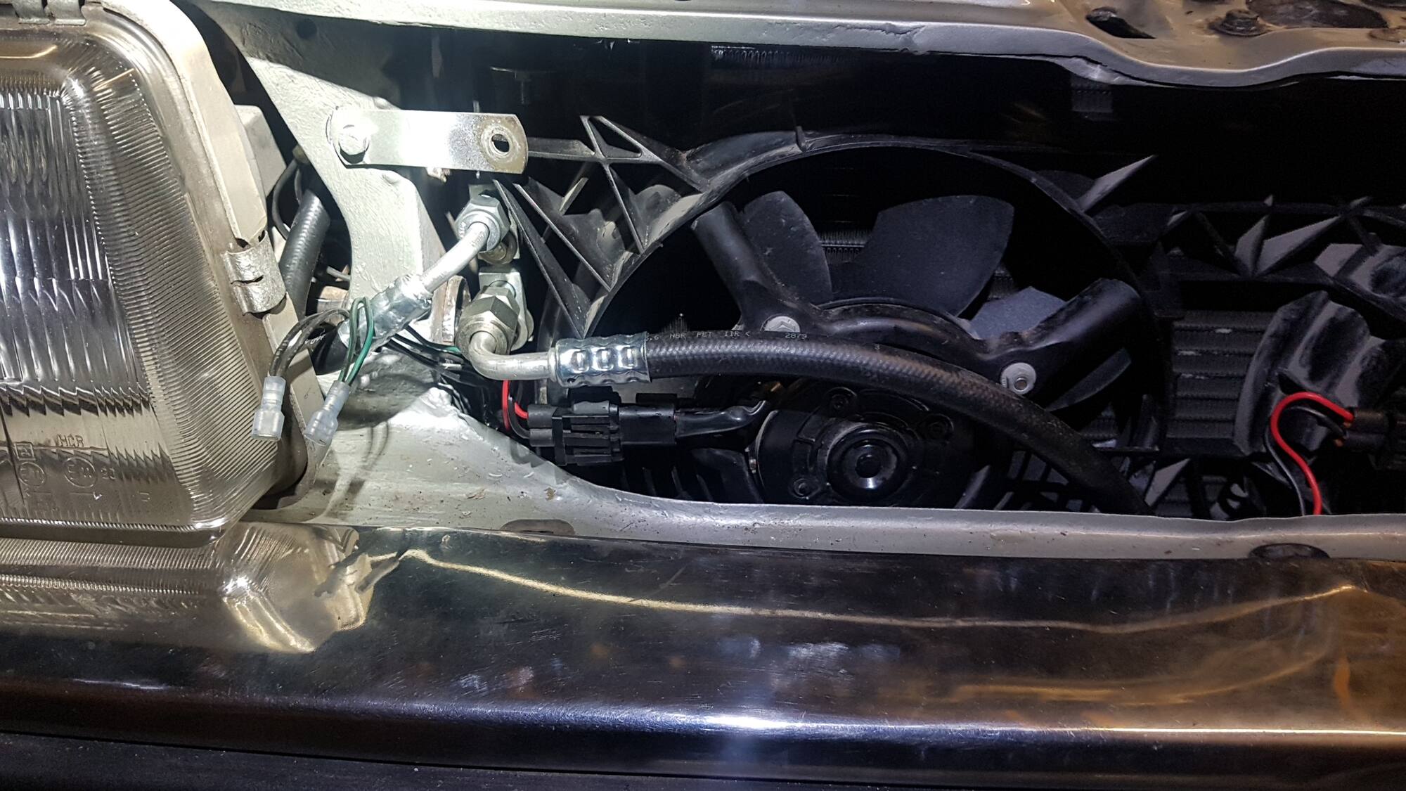

More steady progress, as I've removed the radiator, and managed to squeeze the condenser in front of it.
The wiring loom is a little tight, but I'm not relishing the prospect of splicing in umpteen lengths to extend it! But if needs be...

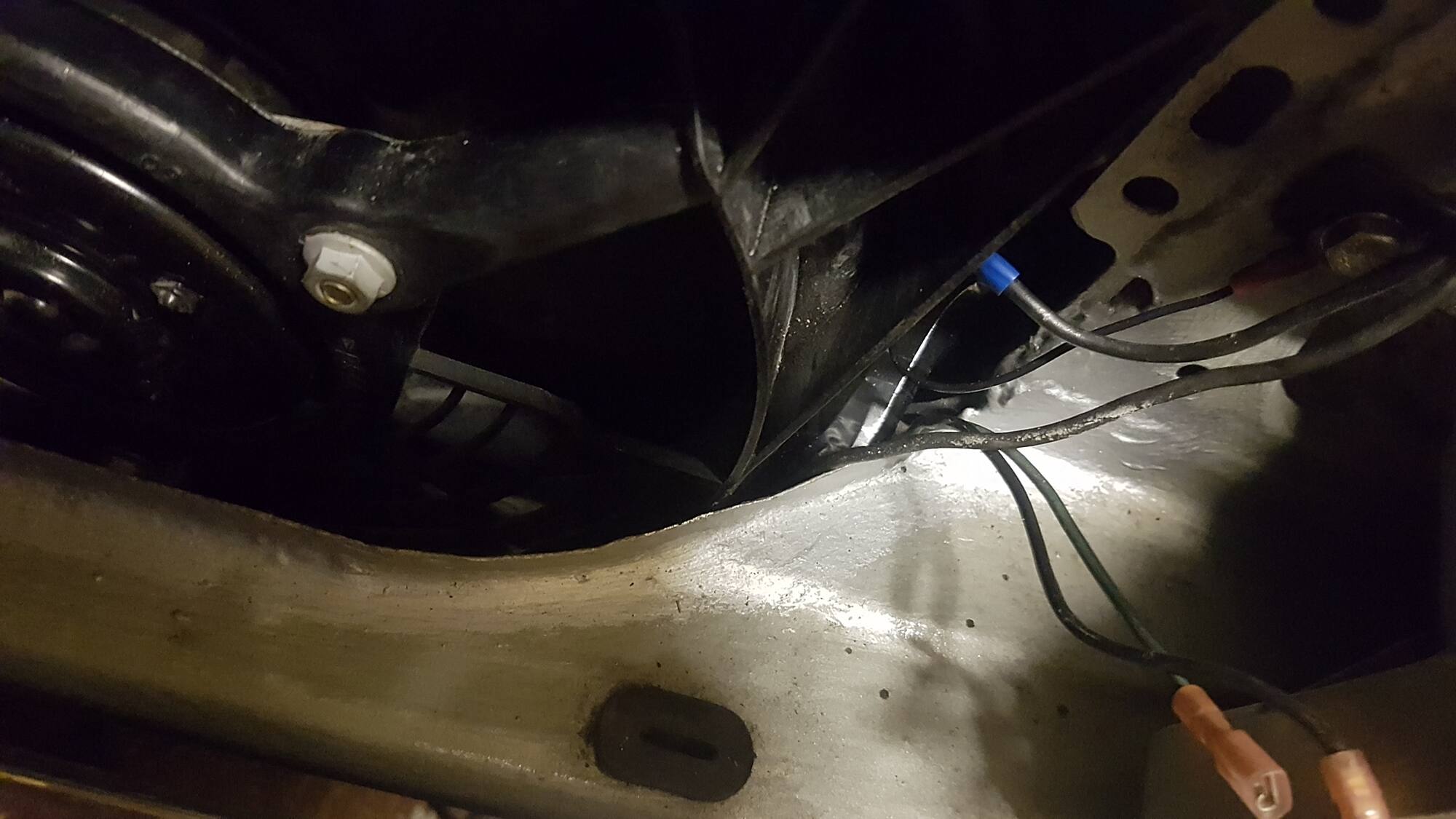

The radiator sits back in the right position, happily.
And this is how little room there is up against the bonnet release catch!
If I'd realised it would be this close I'd have measured more accurately! But luckily a Rover 45 condenser is a great fit - who'd have thought it? It's currently held in with zip ties, so next stage is to make up proper brackets.

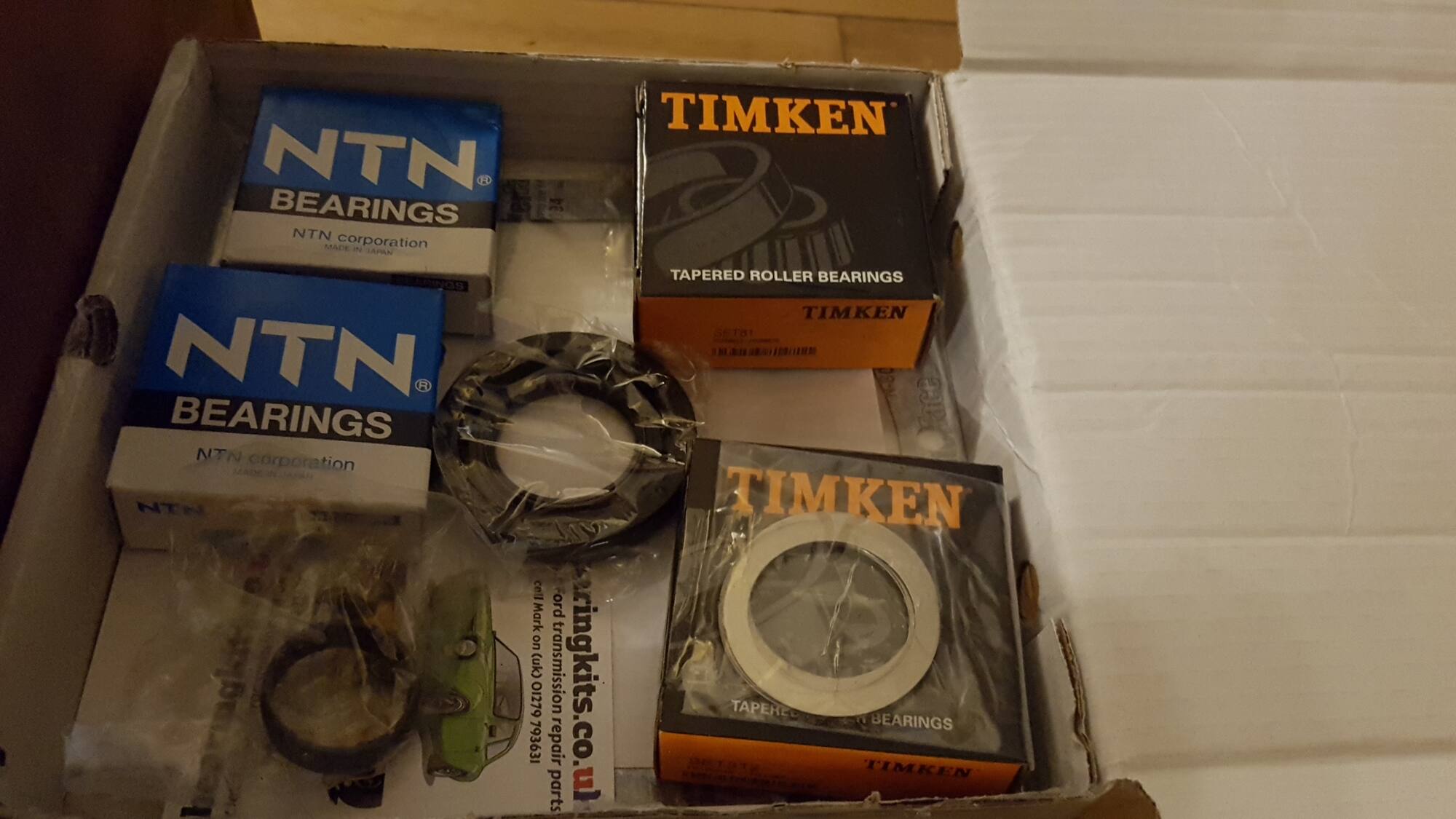

I've bought the differential bearings from a different, recommended supplier:
https://www.bearingkits.co.uk/about.asp
who I also spoke to on the phone. Same comments about wheel bearings, in fact to the extent that the only ones they can currently source, they don't want to sell! However he did say that it'd be unlikely that I'd have problems with a bearing I'd bought from Burton Power, so maybe it still is a mystery. One suggestion could be a blocked breather, so oil is being forced out when it heats up. Something to check at least.

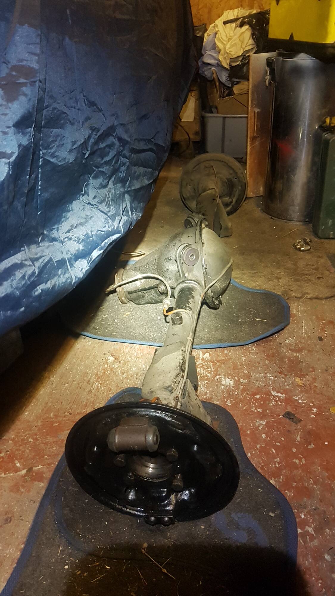

Back in 1997, on the day before New Year's eve I started my first 'big' job on the car, which was swapping the noisy rear axle for a Cortina one. I remember it well, as although daunting, went quite smoothly until I came to attach the propshaft. The flange was totally different, and I had to find a propshaft specialist within cycling distance who could do the job at short notice! They had to cut the end off, then weld on a new UJ and balance it again. It was like memory lane working underneath the car, removing the axle again.
It's now off, ready to get a new diff installed on Friday. I checked and unfortunately the leaking wheel bearing isn't down to a blocked breather, but I'll get some advice from Arwel hopefully.
Decent branded bearings to go in too :-)
While the axle was off I was finally able to work out what the clonk was from the rear while going over bumps. I was sure it was the exhaust, but couldn't see any witness marks, and couldn't replicate it by waggling the tailpipe. But with the axle out of the way, I could get my head into a position to see where one of the pipe clamps was hitting the underside.
I couldn't just rotate it, as clearance to the upper suspension arm was tight, so I fitted a different style of clamp which takes up less space. Stainless too, so should last.

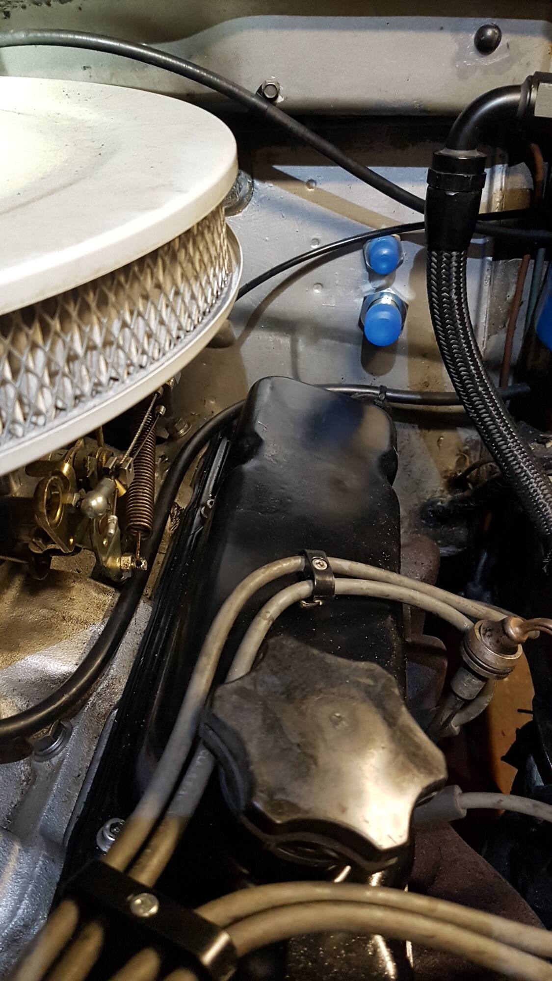

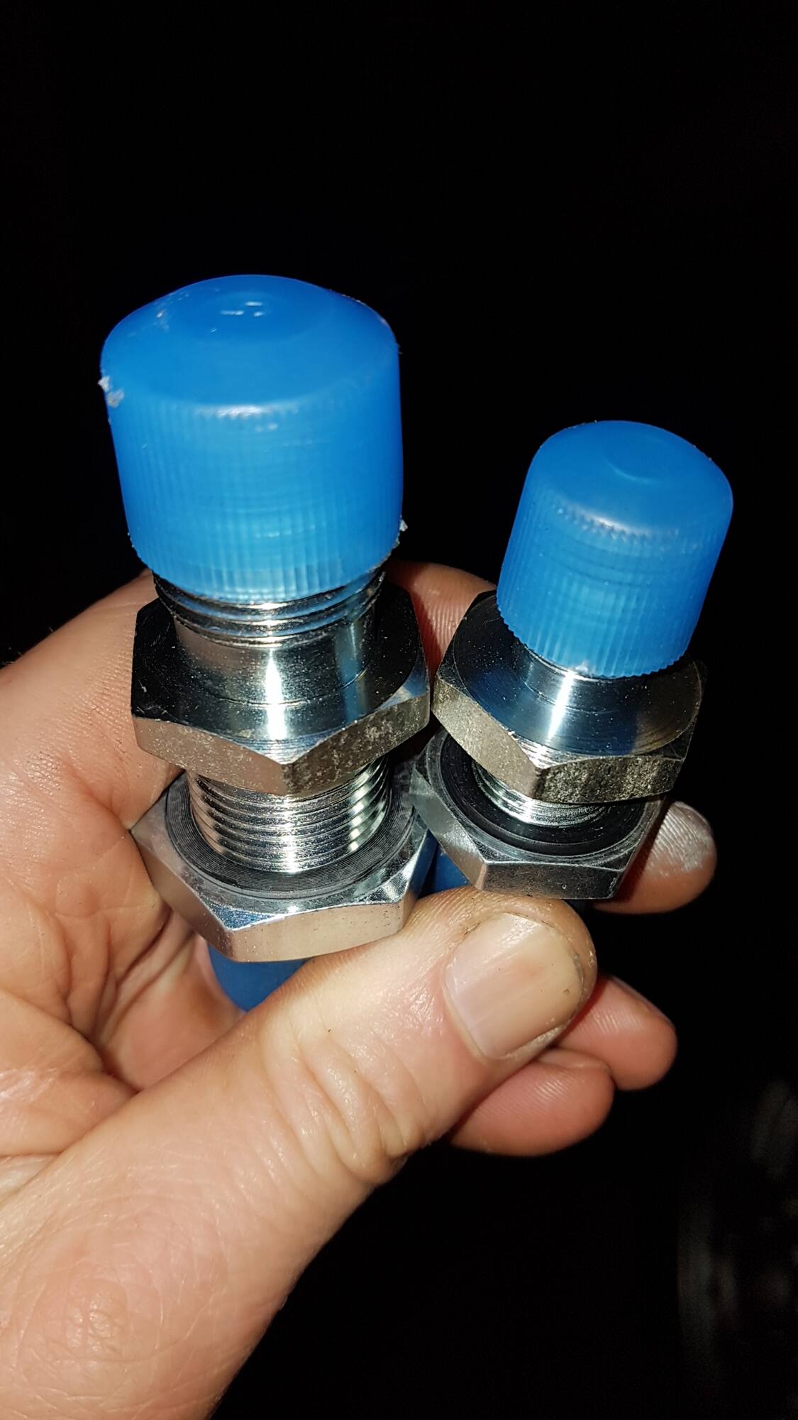

Then back to the AC installation. I've bought some bulkhead fittings, which have a neat little O ring in one of the nuts, to provide a good seal between engine bay and cabin
I drilled two holes in the best location:
Then painted the cut edges and installed the fittings.
As you can see, the location coincided with an existing reinforcement bracket, which I had to trim around the lower fitting.
Now these are in, I can make up all the underbonnet hoses, and finish that job before I start the head-scratching job of mounting the evaporator under the dashboard. Bite-sized chunks makes the overall project seem more manageable!

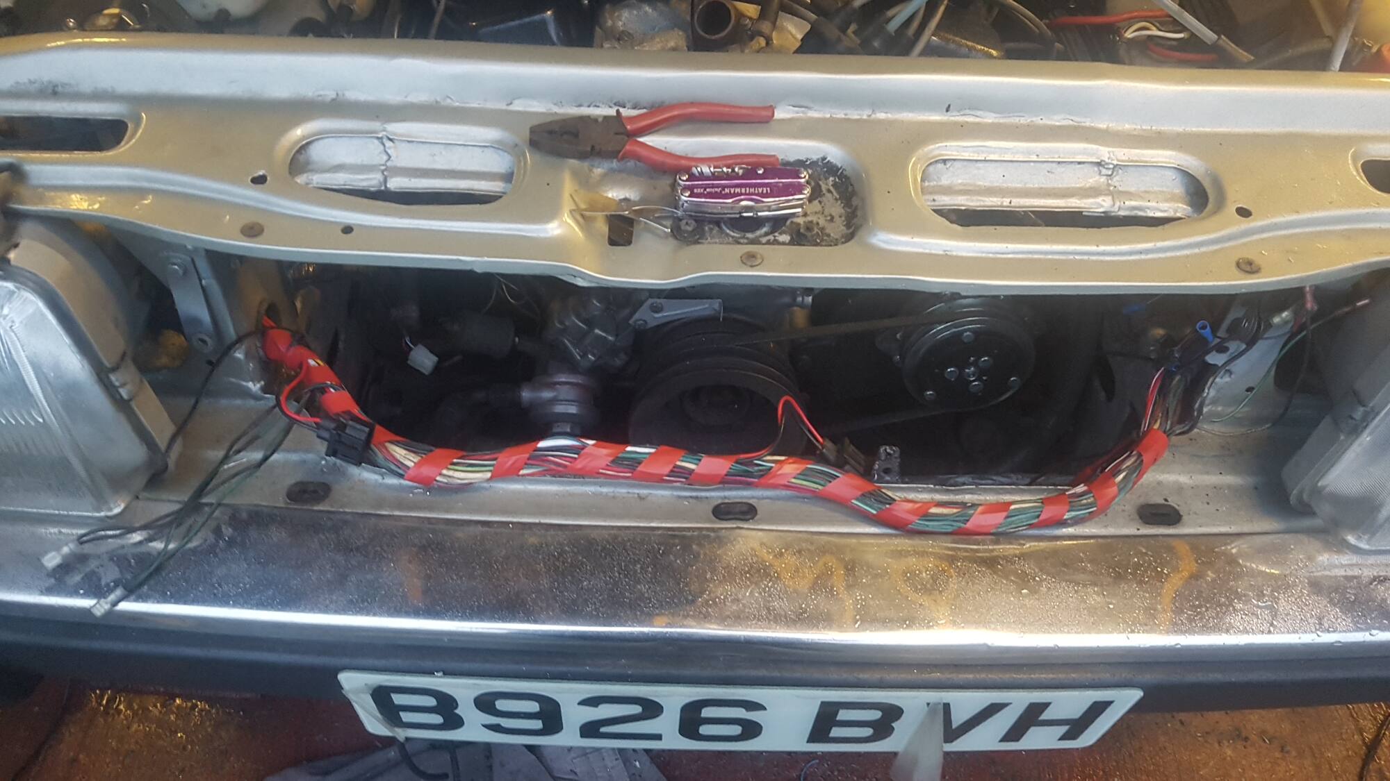

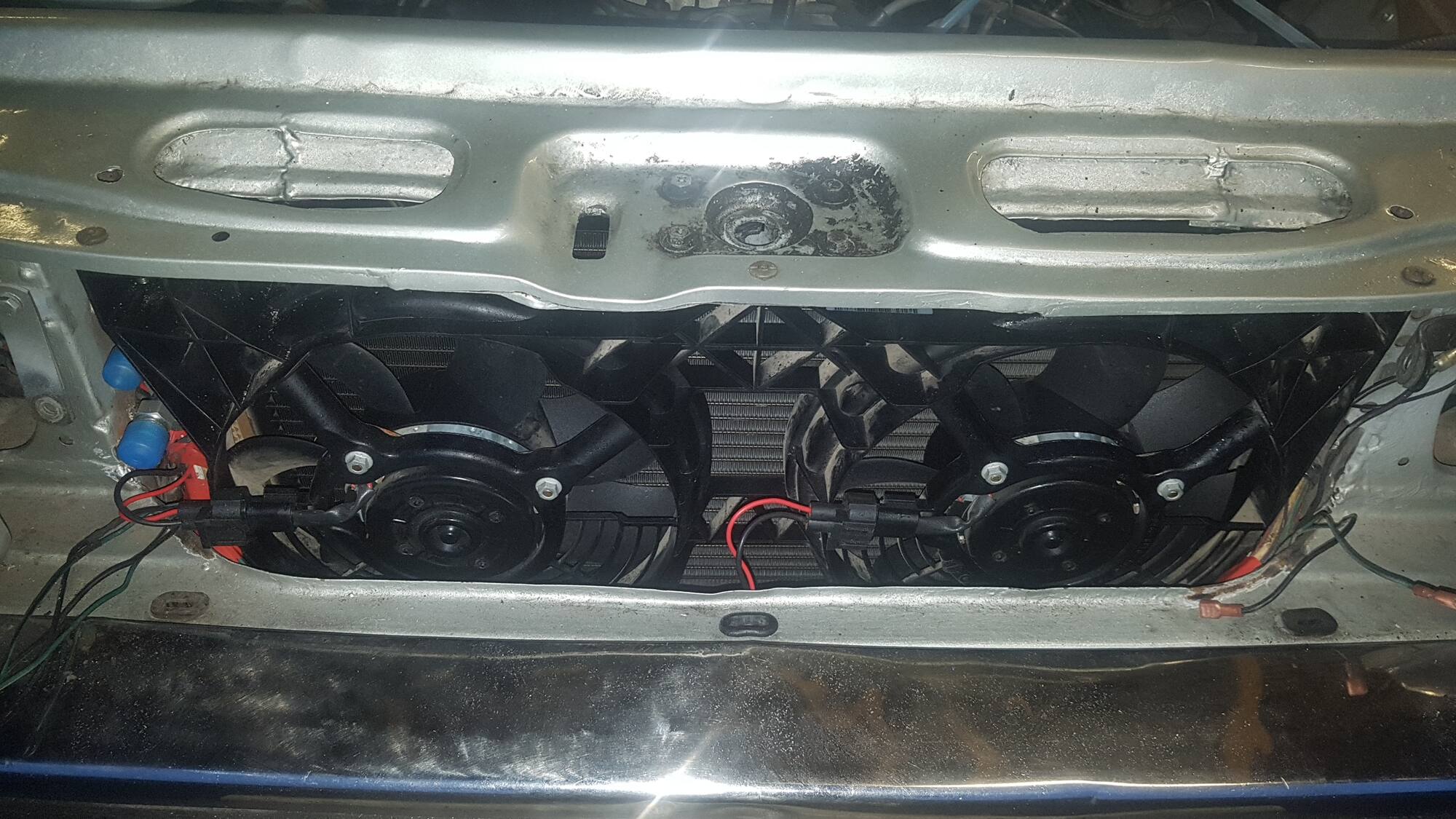

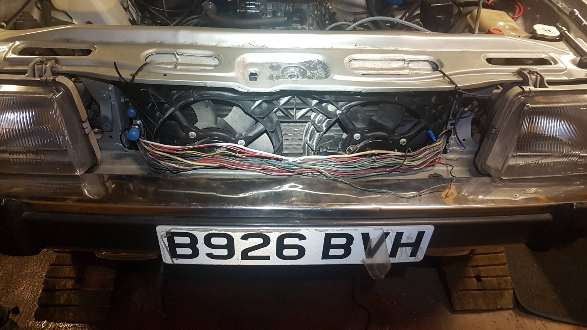

I've managed to run the loom in the U section behind the bumper, so have added the wiring for the fans, and temporarily taped the loom together.

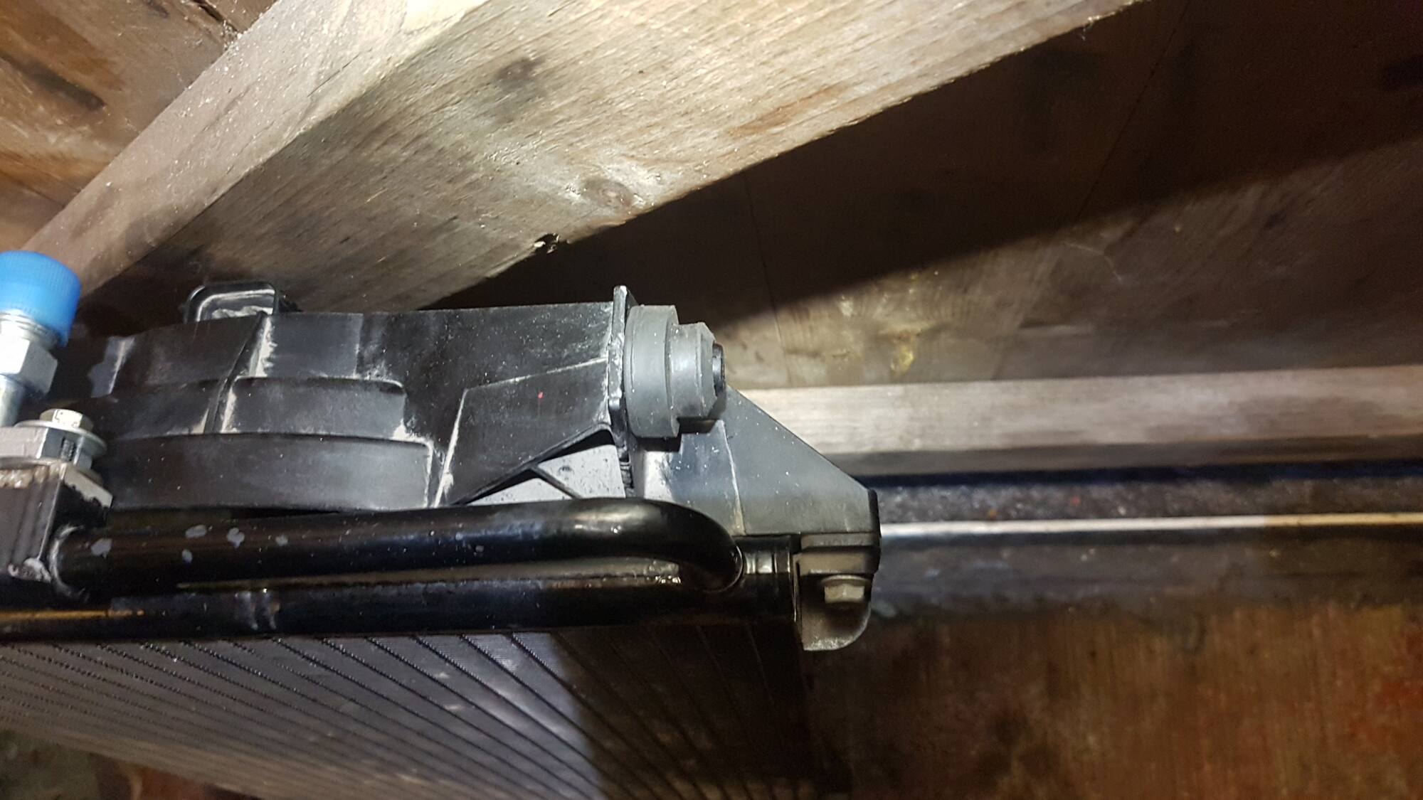

For the top mountings of the condenser I have bought some rubber bobbin mounts, with a male thread on one side and female on the other.
Now I've got the top in position I can tack some lower mounts in position, then remove it again for properly welding it in. I've recessed the bolts for the top mounts, so I can just pop a blanking grommet over the top to look as neat as possible.

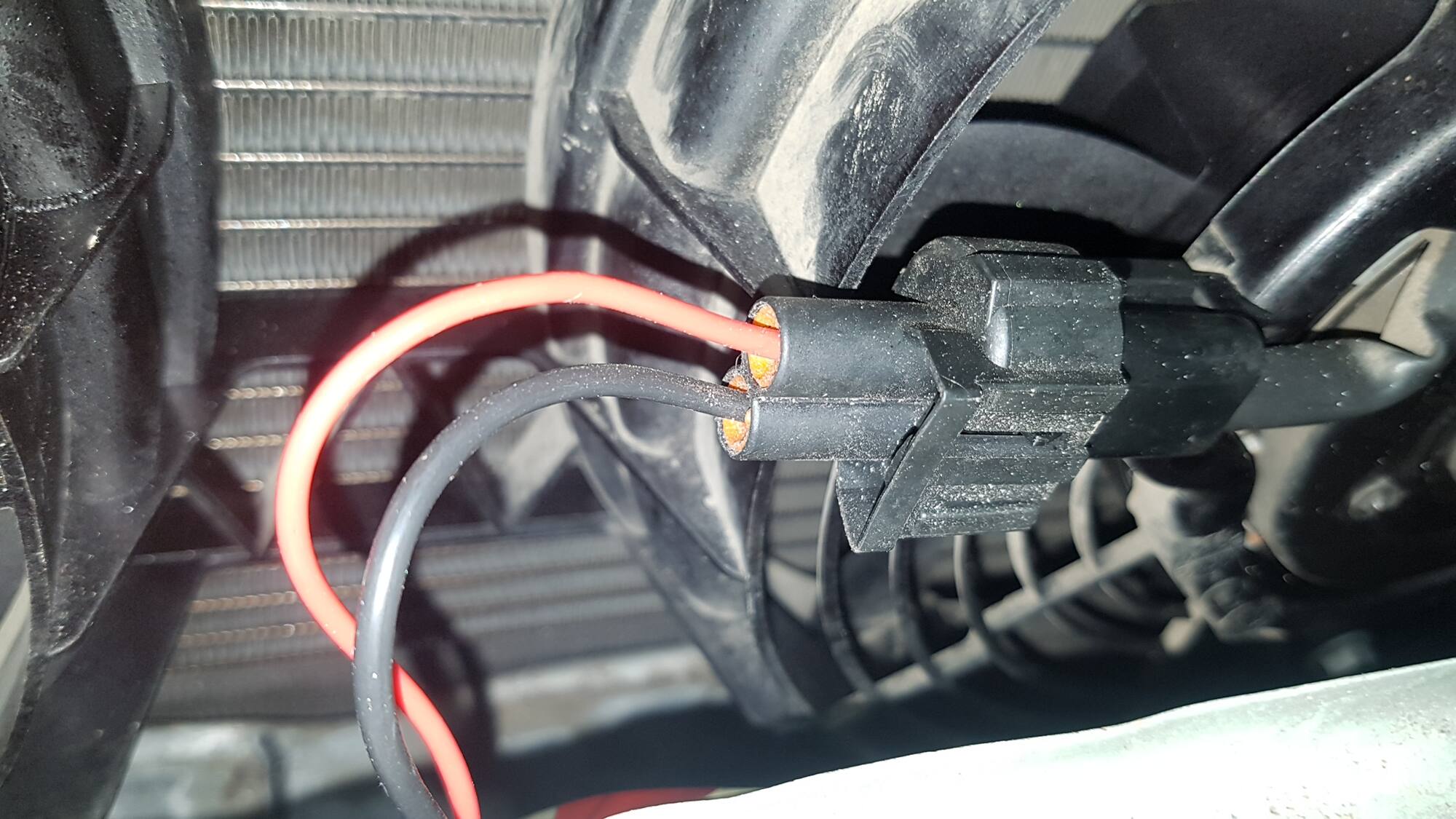

Fan connectors are heavy duty Superseal, so should stand up well to being in the line of spray.
So this is where I am up to at the moment.

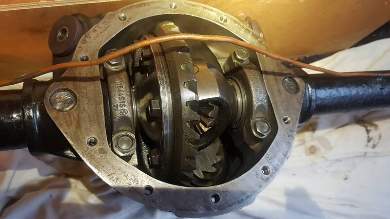

Yesterday I got an exciting (for me) message to say that my axle was ready! So I went along to collect it this morning. I'd dropped it off last Friday with Arwel, (who must be well into his 70s) who immediately spotted that the wheel bearing was a pattern type and hence not be sealing correctly. He was pretty sure he had some NOS bearings so I left it with him to set up the diff and replace the wheel bearing.
I had a look online and struggled a bit
https://www.motorsport-tools.com/ford-atlas-axle-genuine-sfk-wheel-bearing-62mm.html
Eventually finding one in France for a similar amount, so I was most pleased to only be charged £28 for an original Ford bearing! I'm not sure where he got the price from but quite possibly whatever was on the original box!

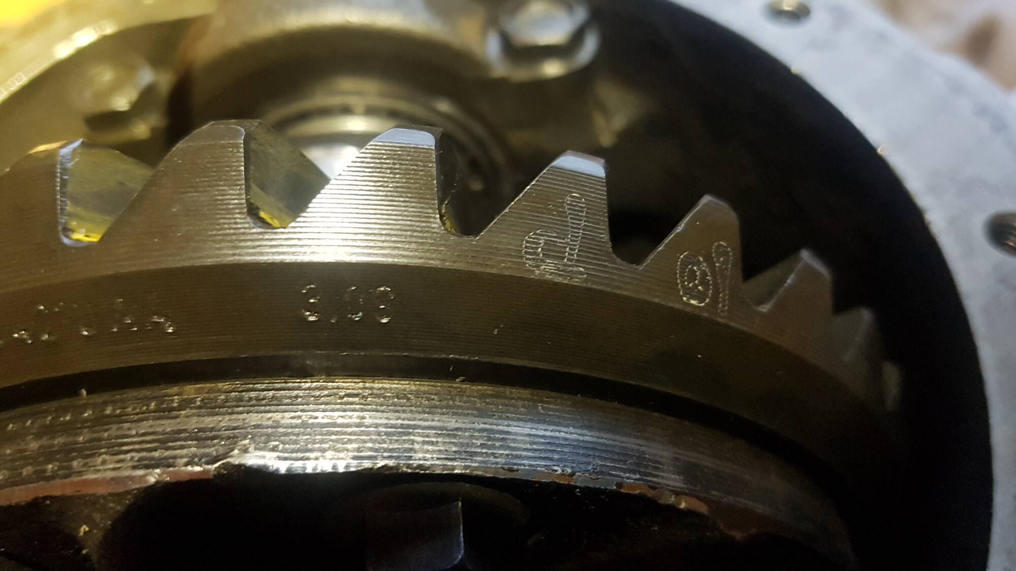

I popped off the diff cover to have a look, and all seems nice and clean, everything meshing nicely with very little backlash (the idea is that you set it up with slight clearance when cold, so once up to temperature that is taken up with expension).
The all-important ratio! Bit of historic damage to the diff carrier, but not a functional concern.
I then lightly greased a new gasket, laid than in place and squirted some EP90 oil over all the gears, to keep everything protected while the car is sitting idle.
Finally, it's on with the cover, which is fortunately still in great condition. They often rust through but absolutely no sign of that on this one.
The wheel bearing problem did turn out to be leakage through the bearing itself, which explained why seating it on silicone had no effect. I'd ruled that out after building a plasticine 'well' around the bearing with the halfshaft vertical on the bench, and filling with oil overnight. I guess that although there was no static leakage, it must have been leaking out when warm under rotation.

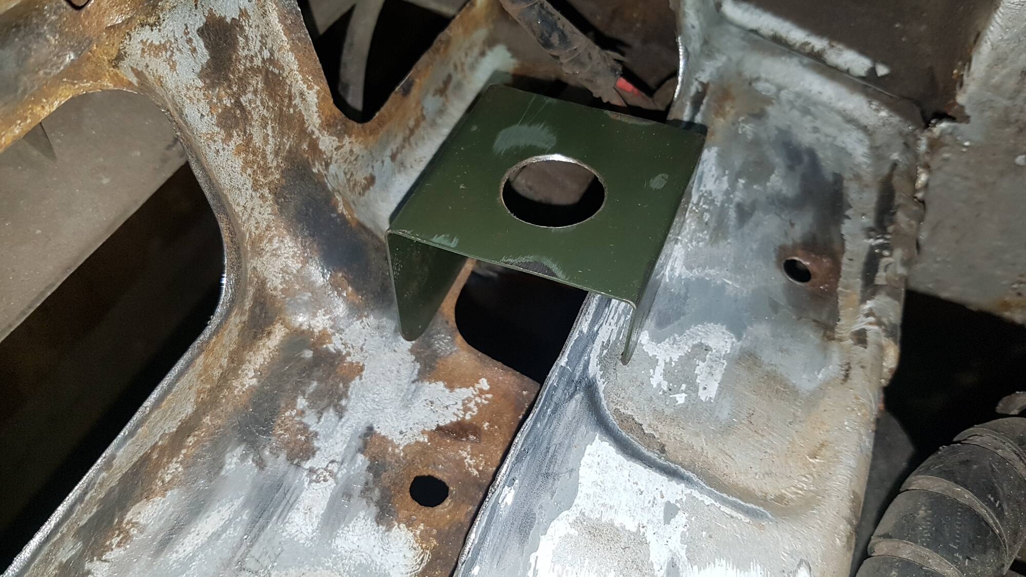

Back on with the air con install, and I need to sort out lower mounting points for the condenser. Simplest option was just to replicate the original way of doing it, so I bought a set of mounting rubbers.
These push over pegs on the underside of the condenser, like so:

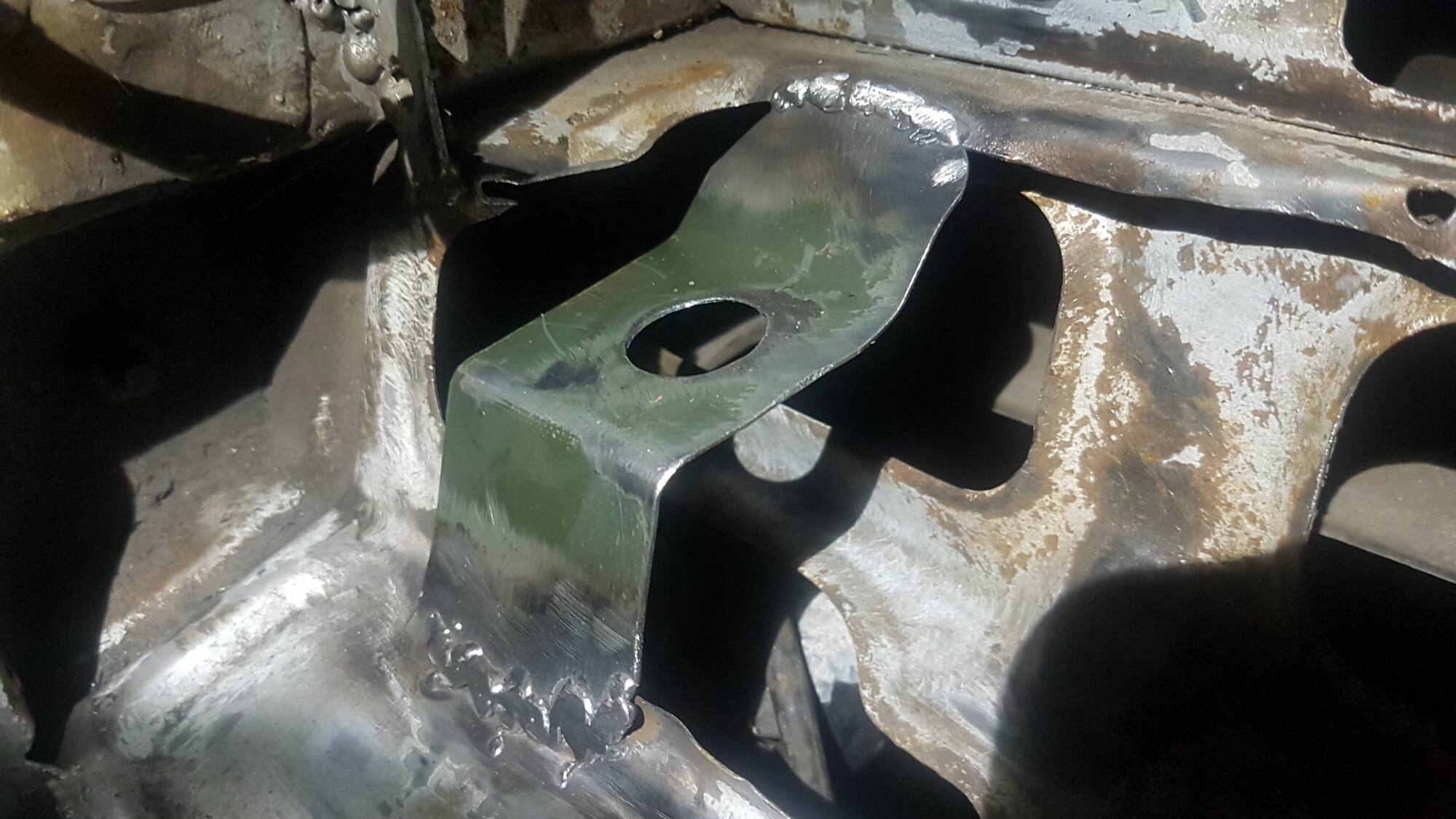

At present, the bottom of the condenser is just floating in free space, so I needed to do construct a couple of mounting points.
The rubbers will just drop into the holes like this, and then I will weld the mounts into the correct location, leaving a few mm clearance for the radiator.
Slight revision to the plan for the lower mounts.
Now welded in, and first a coat of Zinga over everything.

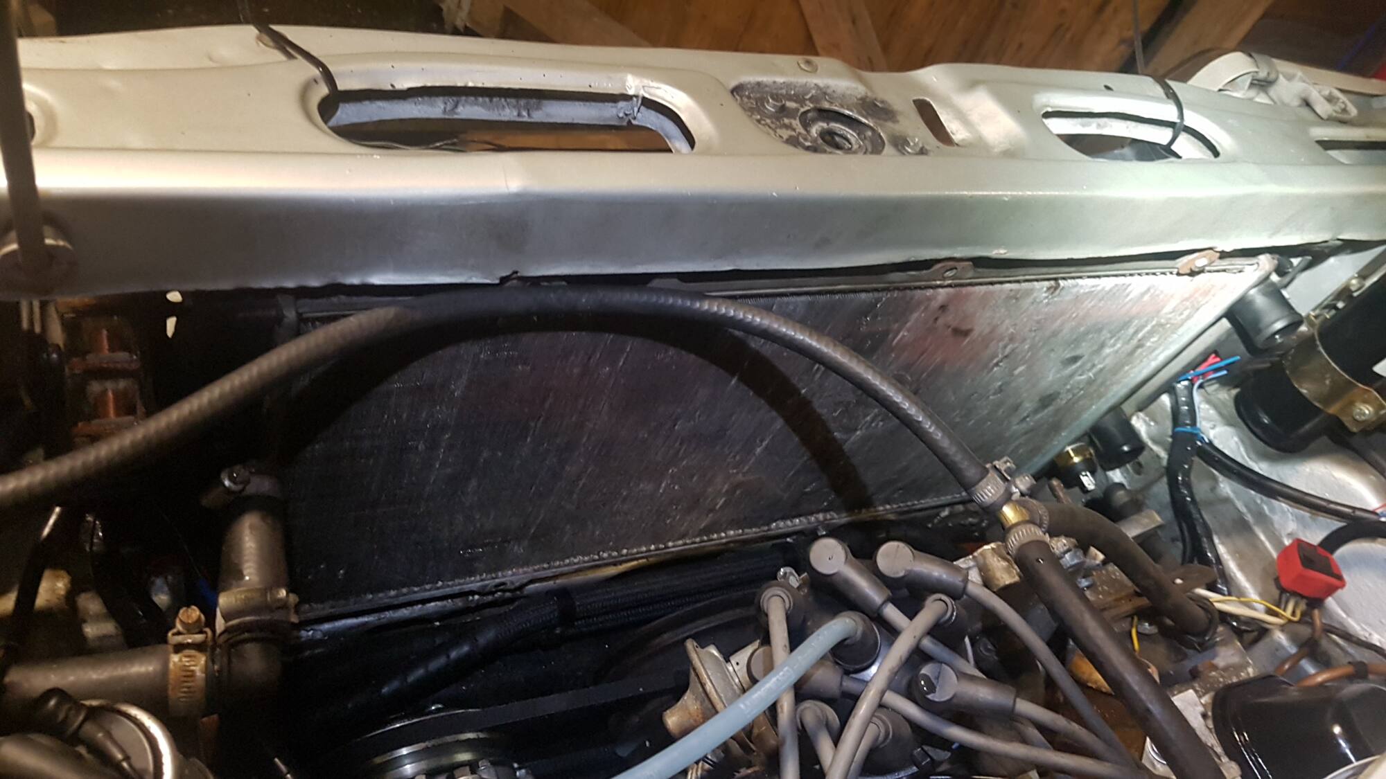

I've also added a few extra tabs for mounting the third cooling fan on the inside of the rad. Previously it was held by those zip tie clips which pass though the fins. They seemed a bit of a bodge method, and not very OE looking anyway.
Then I could put the radiator back in, with around 2mm clearance to the condenser.
It's pretty tight on the front too, although I guess I could have trimmed the crossmember if required.

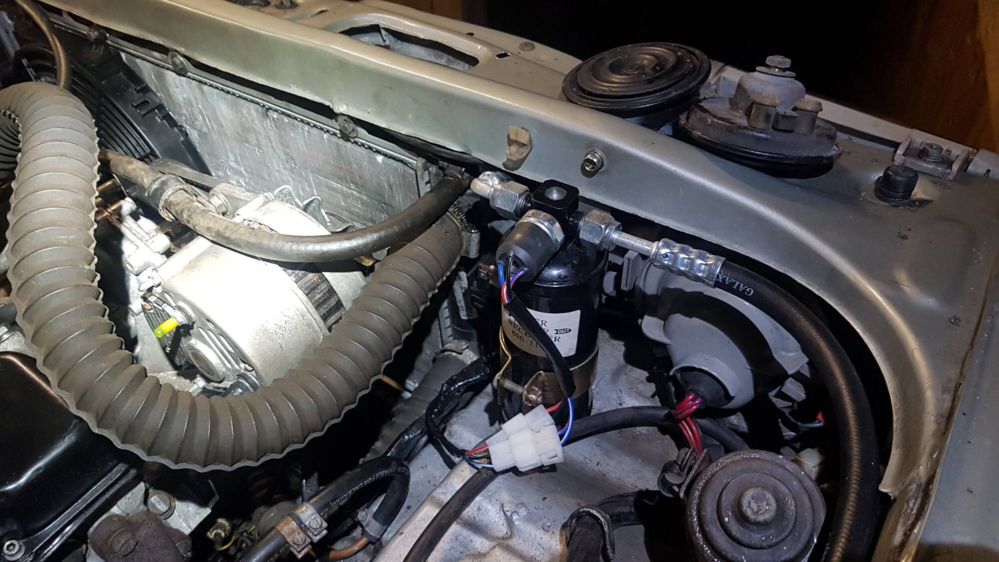

Now that it's finally mounted I can start playing with this little lot!

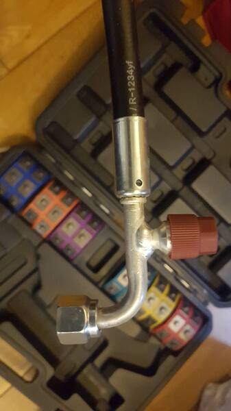

Never made AC hoses before, but it doesn't look a difficult job. Plus I'll have the tool for any other jobs on the rest of the fleet.
Made a start on the hoses in the warmth and dryness of the house! Just push the hose into the fitting, checking that it's reached the bottom by looking through the small hole.
Then choose the right size dies, and crimp away!
The hose feels very supple so shouldn't be too much of a problem to route through the engine bay. But I've got to make sure I'm happy with the route before cutting to length; I don't have enough spare to allow for cock-ups.

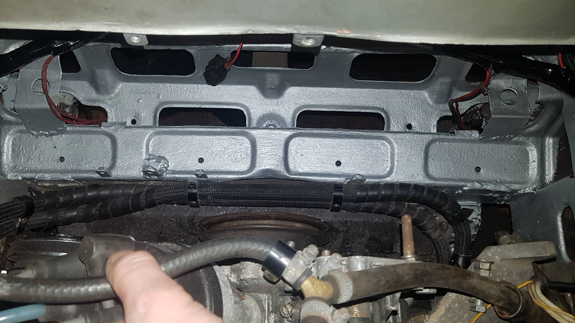

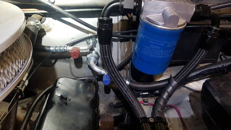

Next (mini) milestone acheived! All the underbonnet hoses are now in place. Starting from the compressor, the larger of the two goes directly to the bulkhead, where it will connect to the (yet to be worked out) evaporator.
With hindsight I'd have trimmed that lump from the head to improve access. The smaller hose travels under the radiator to emerge behind the grille and connect to the condenser.
(Horns yet to be refitted, if there is the room). From the condenser the hose winds tightly round to the receiver drier behind the headlight. Again with hindsight, I may have tried a 135 degree fitting to make the tight curve in the fitting rather than the hose.
From there the hose travels round the outside of the engine bay, to join with the bulkhead connectors. This is where the system will be filled from, so it's handy to have good access to the fill valves.
Jobs still to do are, as mentioned making up new horn brackets, routing the headlamp washer hoses, and protecting the hoses from abrasion.

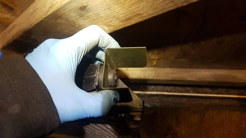

The horn brackets were easy to make up, so managed to mount them both behind the grille as previously.
And with the grill back on everything looks as standard.

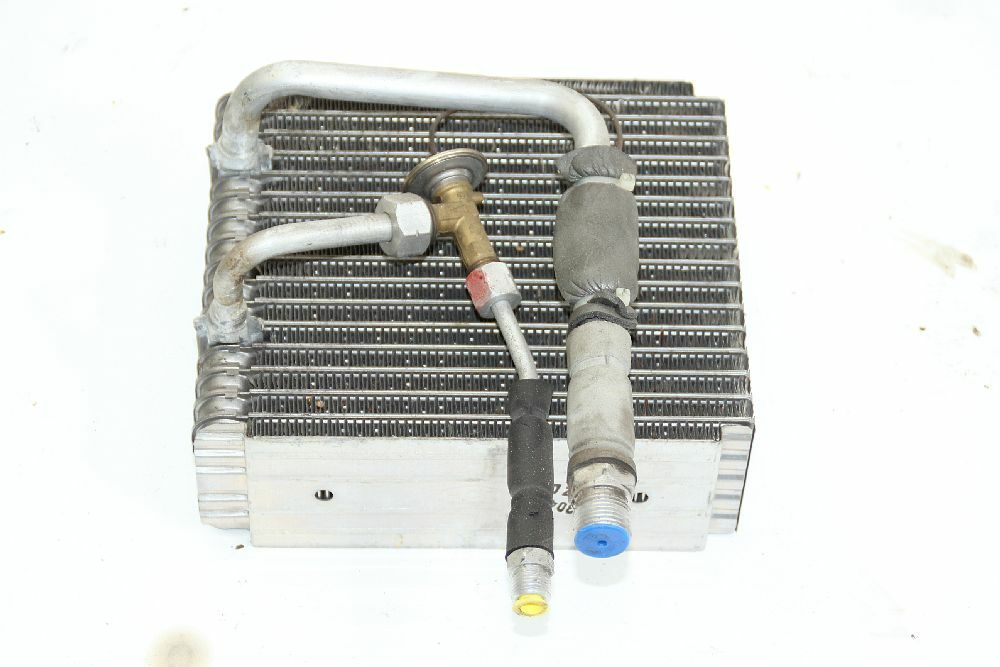

Next step is finding a suitable evaporator. I can't mount it with the heater matrix, as when cold air is selected, the air bypasses the matrix completely. So I think my best option is to mount the evaporator in the trunking between blower motor, and heater assembly, meaning I need one which is squareish and compact. For the last few weeks I've basically been searching Google images for a usable sized and shaped evaporator, then cross referencing the dimensions from the part number.
I may have struck lucky, with one from (ironically!) a Hyundai Amica.
As a bonus the expansion valve is mounted close to the heat exchanger, keeping the whole thing as compact as possible.

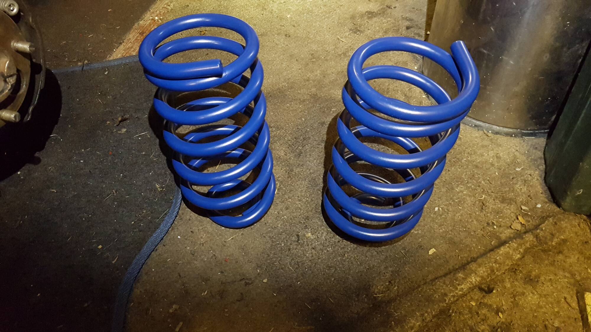

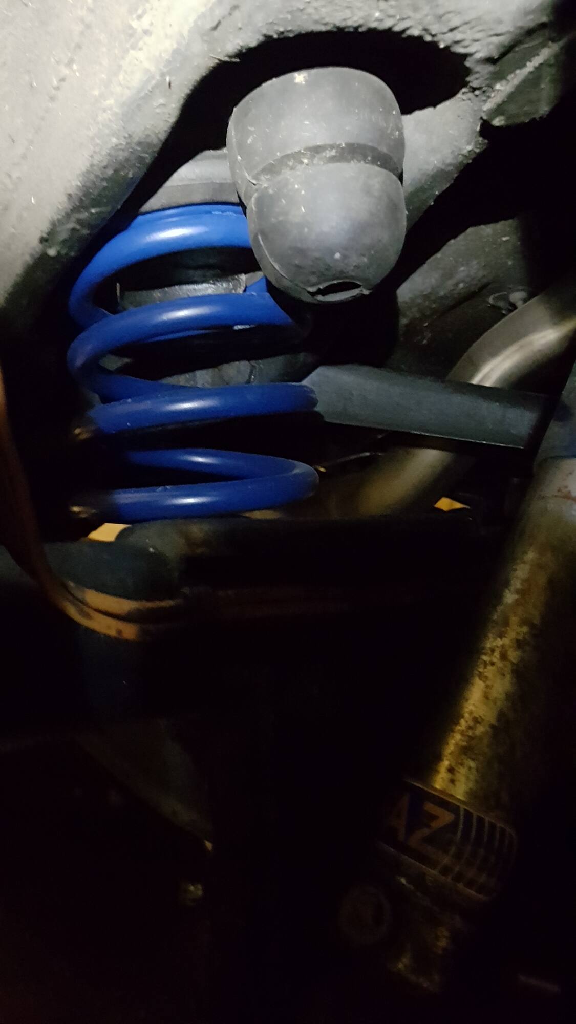

I've also been reinstalling the rear axle. It's at the stage where I need to put the springs in, but before I did that I wanted to measure them. Reason being that if you compare this old and recent photo, it seems to be sitting higher at the rear than it used to.
It turns out that comparing the lengths to the workshop manual, one is too long and the other too short! The long one is progressively wound, so will sag more and take up some of the difference but even so I'm amazed that I never noticed a difference! So I'm now trying to find springs as close to the original as possible - looking like Cortina 2 litre saloon heavy duty ones will be almost identical.
Quote
Colour code blue/violet
wire diameter 0.47/0.59in (12.05/15.03mm)
free length 11.5in (291.5mm)
outer diameter 5.08in (129mm)
number of coils 7.5
Although all I can find at present are linear rate springs. Given that I didn't notice the difference side to side though, I'm obviously not as finely tuned to the car's responses as I thought I was! So any kind of matched pair will be an improvement.
  • Like 7
I feel pretty sure that the current springs won't have helped handling...
Nowhere can I find progressive springs, so I've bought these from Rally Design.
The spring rate is identical to the 'stiff' portion of the travel for the originals, but will be a little harsher over small bumps. Lengthwise they are 25mm shorter than the originals, but will sag less so I'm guessing will end up being similar to correct height - I'm not slamming it!!!
They were reasonably priced from Rally Design, and purely on a visual basis look well made - they've been neatly deburred, and powder coating seems thick.
I've fitted them this evening, and just need to bleed/adjust brakes, and check all fasteners before I can finally take it for a drive again!

I took a punt on the evaporator, although struggled to find one listed online in the UK. But £40 posted from Germany hardly broke the bank, and it arrived today.
This is the space I've got to play with, between the blower motor and heater matrix casing.
So, will it fit? Well, just about...
I may have to move the dashboard bracket to give a little more clearance, and/or modify the evaporator to reduce the size, but it all looks encouragingly possible at the moment!

Option 2/4 is how a fair number of vehicles that have had AC retrofitted to their design work.  The example of the RRC is one I know well, but there are others.
What you might be able to do, perhaps, is mount the AC evaporator in the recirculation air, such that it is only keeping pre-cooled air cold, rather than the duty of cooling incoming warm air, but then introduce a stop or position on the fresh-to-recirc air flap that gives you 90% recirc (and hence cooled and dehumidified) air and 10% fresh inlet air.  That would give you the option for fresh air from the outside, all recirculated/chilled air or a nice blend of chilled and fresh, but with the added bonus that when you have a wet condenser and want to turn the AC off, you can just select fresh air to avoid pulling all that wet off the condenser and into the car.
Of course, it will dry eventually, but it'll take an hour or so rather than 3 minutes, meaning you're not dumping all that moisture into the car in one go.
Depends a lot on how the air does it's recirculation I guess, and whether you can get the evaporator in there or not.
5 hours ago, Talbot said:
I knew someone was going to say this.  No, it doesn't. Not necessarily anyway  The AC condensate drain only drains water that can actually run off the evaporator and pour away.  Even with completely clear drains, the evaporator will be dripping wet while the AC is working (after all, that is how it dehumidifies the incoming air).  In normal service there is easily 50+ml of water held between the plates of the evaporator, ready to drip off.  That's easily enough to insta-fog up all the windows in a car.
OK.  I reached my own conclusion a long time ago, driving a mouldy ( literally) pool-car Escort Diesel.  Probably not a good place to think clearly.
What you describe makes sense.
To be fair, you're absolutely right.  If the drain on the AC evaporator blocks, the problem will be massively worse, and you'll never de-mist the car regardless of AC on, off part on, fresh or recirc air.  Mat has a good opportunity to avoid all the usual issues with AC here.
