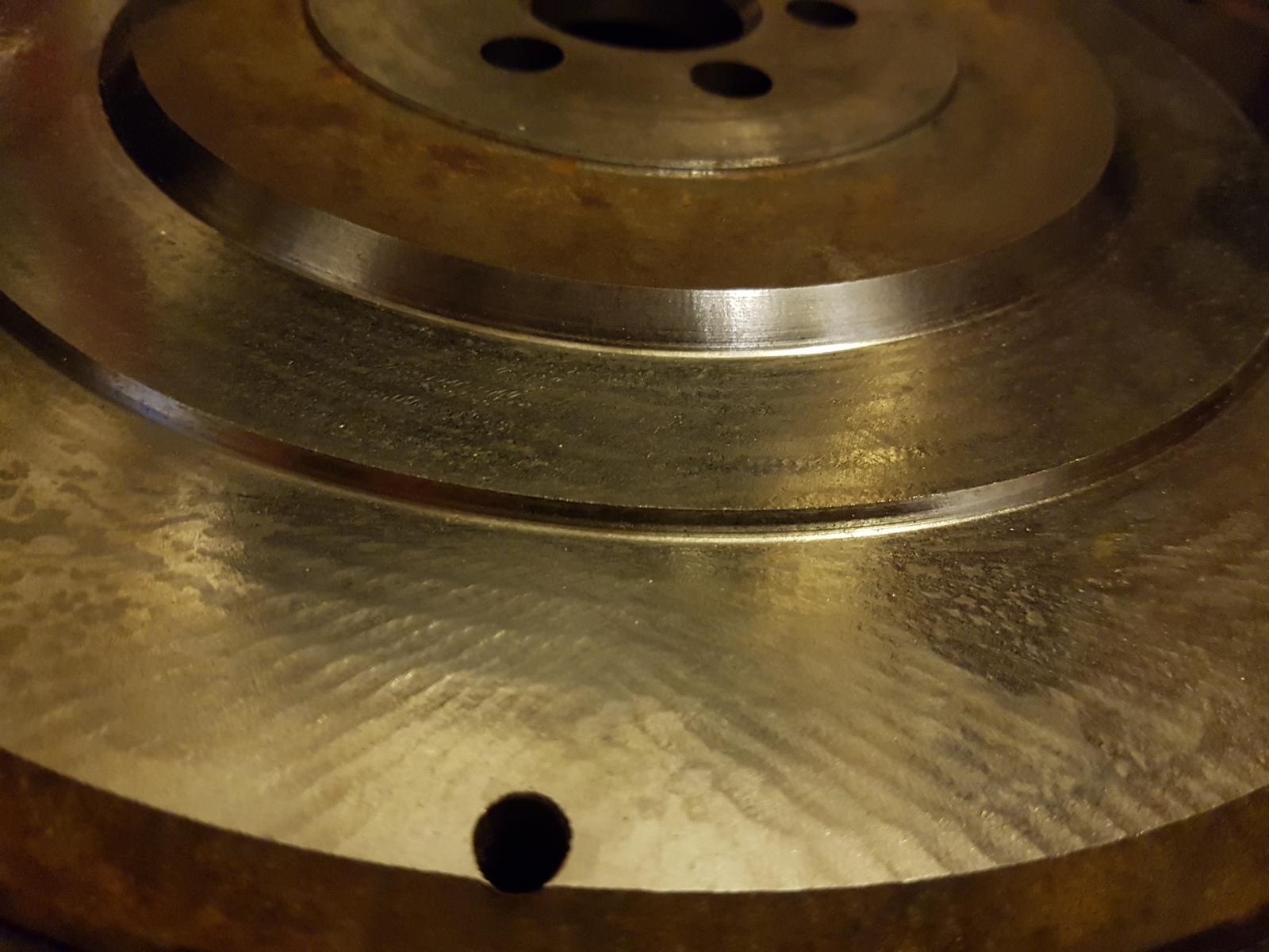

I picked up the flywheel this afternoon, and it's noticeably lighter than before :-)
I didn't weigh it prior to lightening, but it's around 11kg now. Basically the area removed was all at one thickness beforehand, at the same level as the area immediately around the crank pulley.
They said they don't like to take any more off a standard cast iron flywheel which is fine by me, I don't want to go silly with it. Interestingly they noticed that the clutch face has already been skimmed by 1.2mm at some point in its history. That face is in good condition, so no need for another skim.

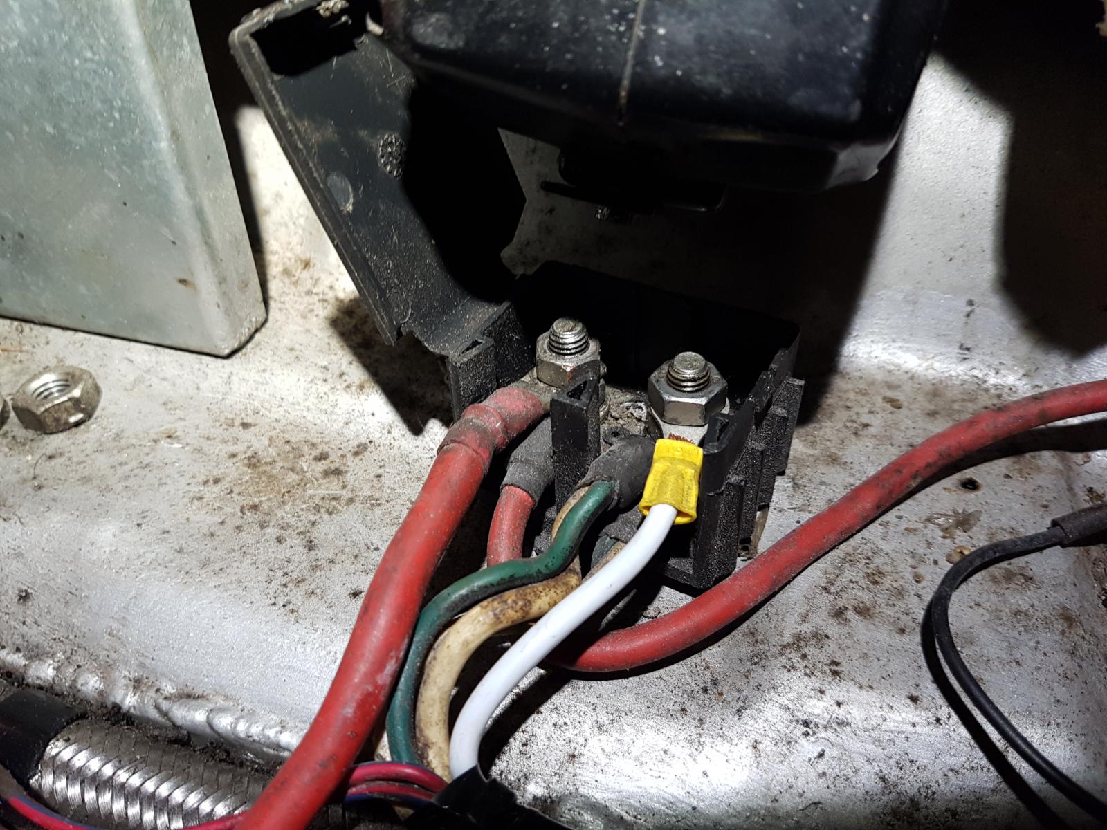

Remember this? The single alternator connection that I don't think was up to the current outputted from the alternator.
As there are two duplicate teminals in the alternator connector, I doubled up on the wiring.
Finally terminating it in the main junction box (which I fitted when I relocated the battery to the boot).

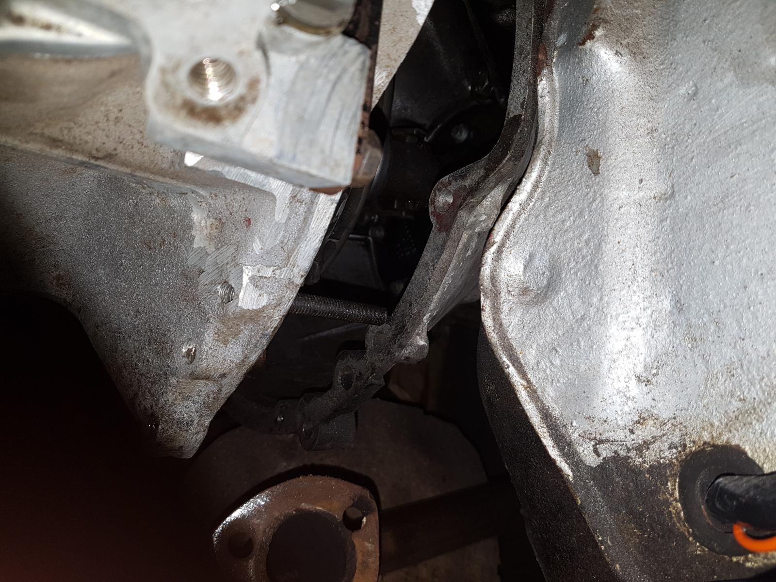

I need to adjust the engine mounts a little, as it seems to be catching on the shell as I can feel a bit of vibration; otherwise the brief test run was a success. Plenty of go although I only used about half throttle.

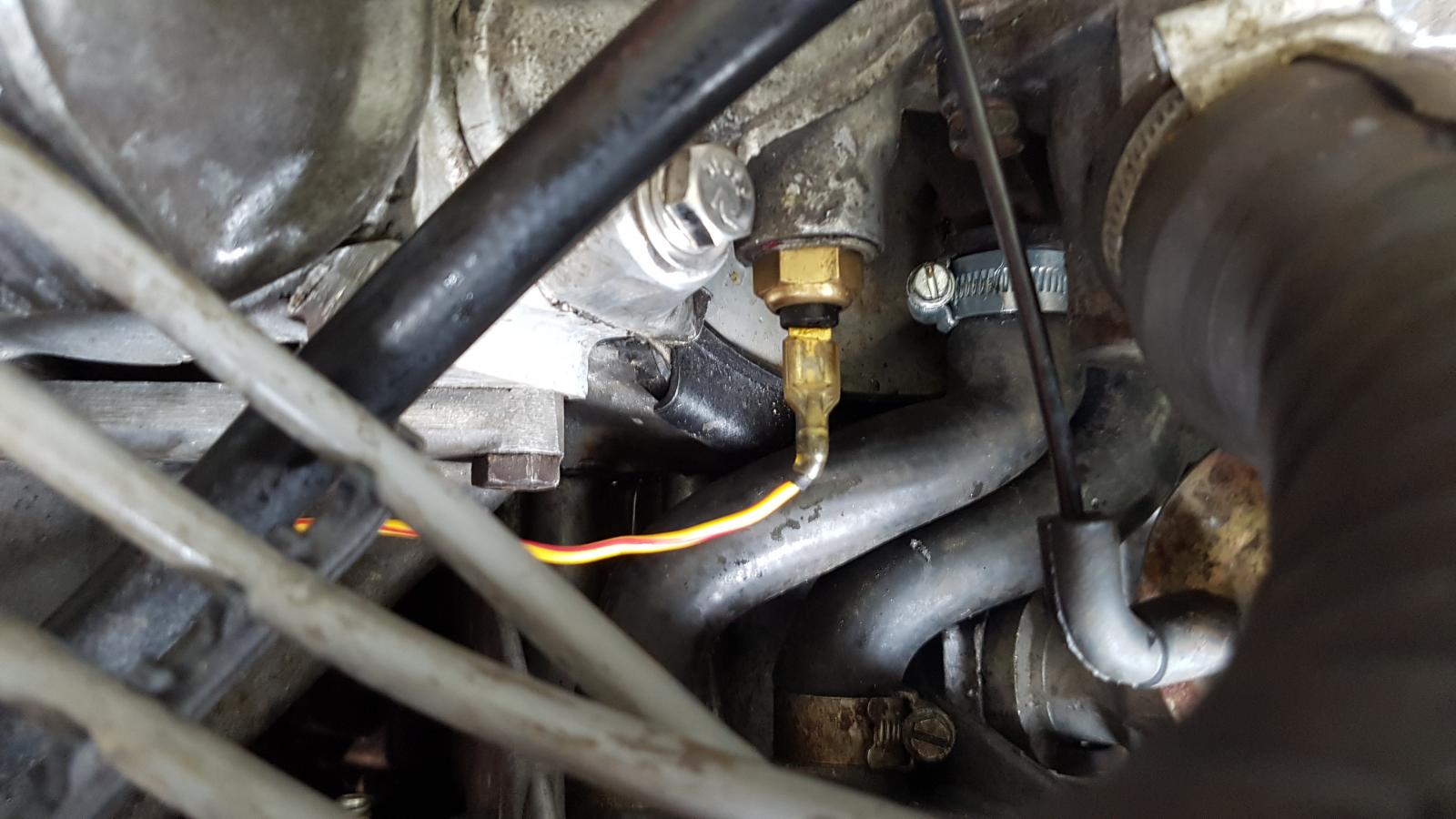

Next task it to sort the 'underheating' problem I have. Pretty sure it's a gauge/sender issue as now the needle is barely moving at all (even when the fans kick in), but the oil temperature is still the same. I've borrowed an infra-red thermometer so will check for sure.
Seeing as the Stellar is now my daily driver, as I've sold the Kangoo and the BX has sprung a leak, it's even more important that I sort out the temperature issue.
I've got an original Hyundai workshop manual, so I could check out what the sender resistance should be at various temperatures.
To prove or disprove the gauge as being at fault I rigged up a few resistors between the sender wire and earth, to simulate 120 degrees C.
Gauge looks OK!
So I ordered a sensor, and after the drive home from work this evening checked the actual temperature of the engine.
At this temperature the resistance of the sender was around 4.5 kohms, well below the 'cold' resistance figure. Fortunately when I got home, the sender had already arrived - wonder how long this has sat on some dusty shelf?!
Luckily the Hyundai sensor (M16 x 1.5 thread) is within 0.1mm of both thread pitch and diameter of the 5/8"-18 UNF threaded hole in the V8 manifold, so it screwed right in  :-)
And looks to be a success!

Super work on this, lovely looking car. Since i did the headgasket on the Reliant and changed the stat mine shows as cool to, might look at getting a new sensor.
It was on one of the hoses behind the water pump - that being the closest thing to an 'ideal' black body infra-red radiation source. I did try it on the head but got between 1-200°C depending on the surface finish! And I didn't know what emissivity to set it to to compensate for the surface.
