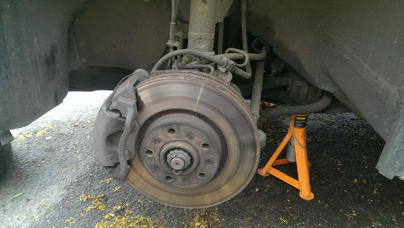

etc etc for fucking too long! I had the parts, my daughter was at nannys for the day and amy fucked off shopping, so I had a gander at the brakes
I've been avoiding the brakes as much as possible as I knew they were low...
It's the most brilliant caliper I've worked on! Bosch the bottom pin out and the whole thing hinges up!
Thats as far as I got. I went to get my claiper rewind tools and had the horrible realisation they were still in my mums garage. Fuck. (beautiful sunny morning here). Look in the haynes book, try using a small piece of bar as it suggests. Fuck my thumb...Call Amy (a friend of ours drove her as he wanted to go shopping too) and get her to run to halfords. either the full kit for £40 or nothing... mate says they will finish shopping and swing past, grab my keys and pop 25 miles to marlow, grab tools and come back. Great.
Had a go at the exhaust whilst I waited and the car was up on stands anyway
It's not a finished job as the sealent still hasnt arrived but the new clamp has almost killed the blow as it is, as it holds the pipes together and keeps the joint straight. Couldnt get the old clamp off so hammered it over a thicker bit of the exhaust for now. I think I need to drop the back of the exhaust to seal it so will try again then!
It's getting cloudy now, I call to see where they are and they've got to the garage. Tools obtained, they hit the motorway, and heavy rain. I sit in the shed and have a few rollies and a beer watching the rain.
They arrive back. I set the rewind tool up, crack off the caliper bleed nipple and 3 minutes later the calipers down, job jobbed.
Heavy cunting rain now.
One side done, I ran round to the drivers side and did the whole thing in 5 minutes. Pain getting the wheel on and off as my thumb hurt like fuck against the breaker bar. Soldiered on and the job was done. No idea if the wear sensors work, the old sensors were worn but no info. I cleaned up the earth point and sprayed the plug with switch cleaner. Dont care anyway, I know their good.
