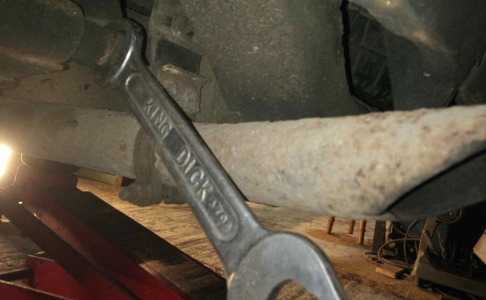

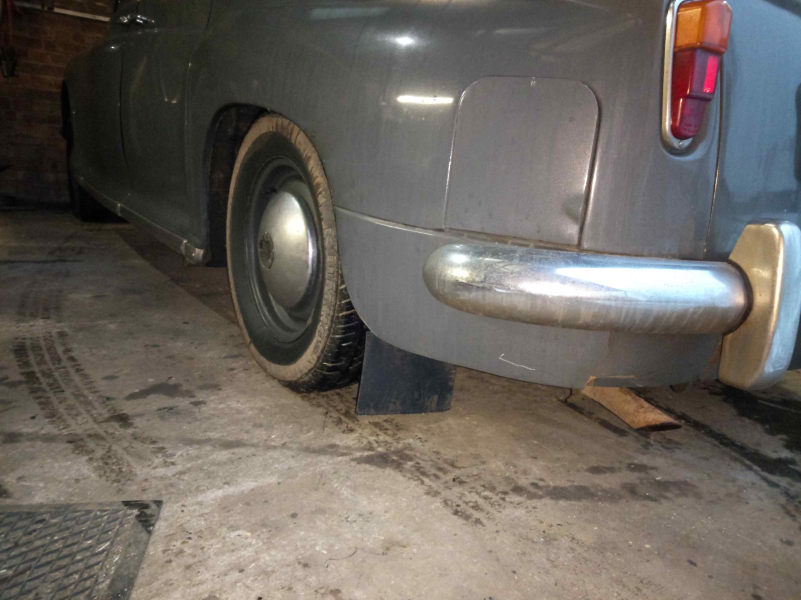

Its time for more spring fun. The Rovers arse has been dragging on the ground so bad something has to be done.post-7547-0-62555500-1520158821_thumb.jpg

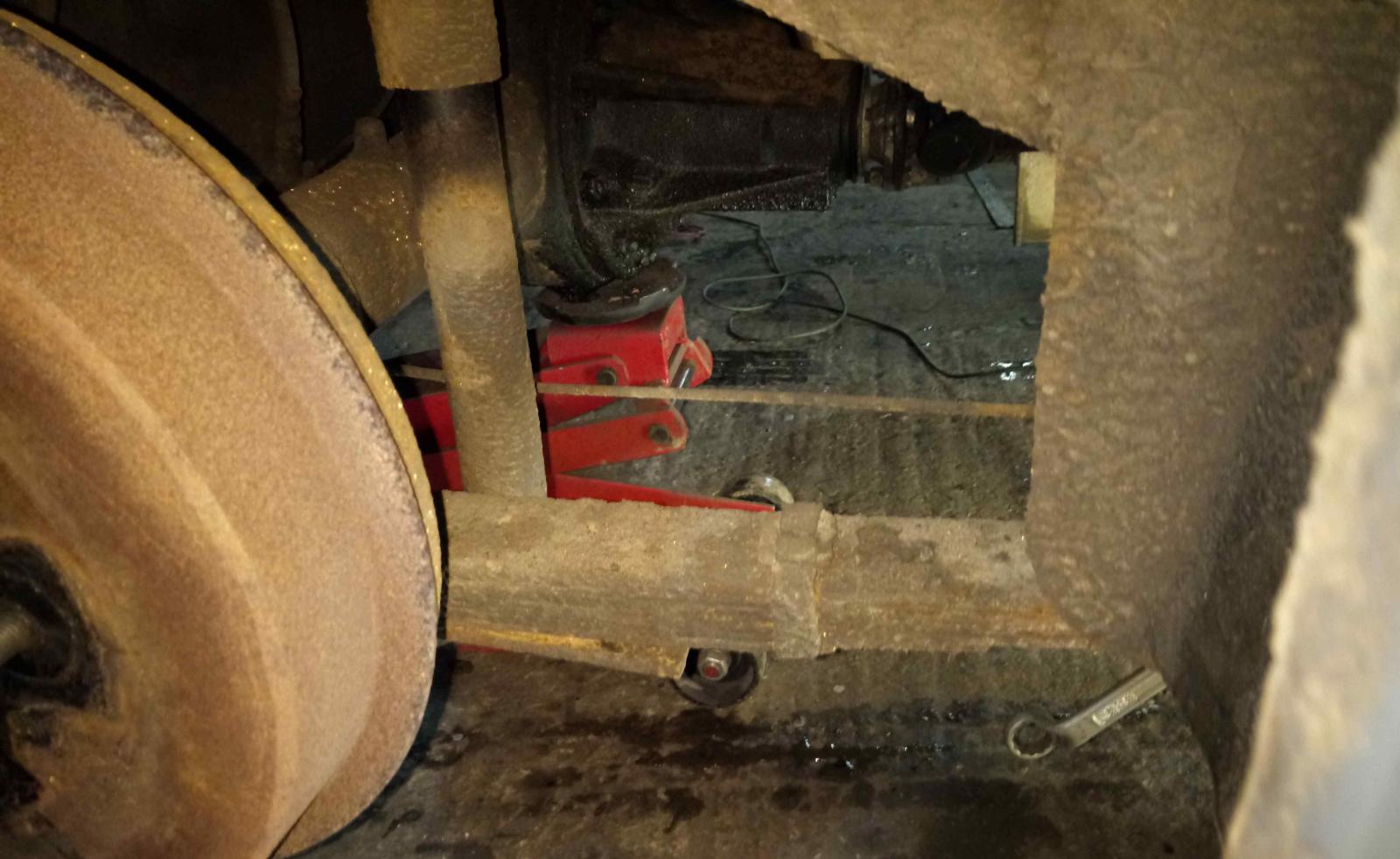

I was expecting difficulties with siezed bolts as the springs look like they've been on for a while, could be anything up to 61 years.
It helps to have the right tools for the job so I've whipped out my King Dick.
That's the nastiest bit done, all bolts came out without recourse to heating siezed bushes, just as well with the LPG tank living a few inches above.

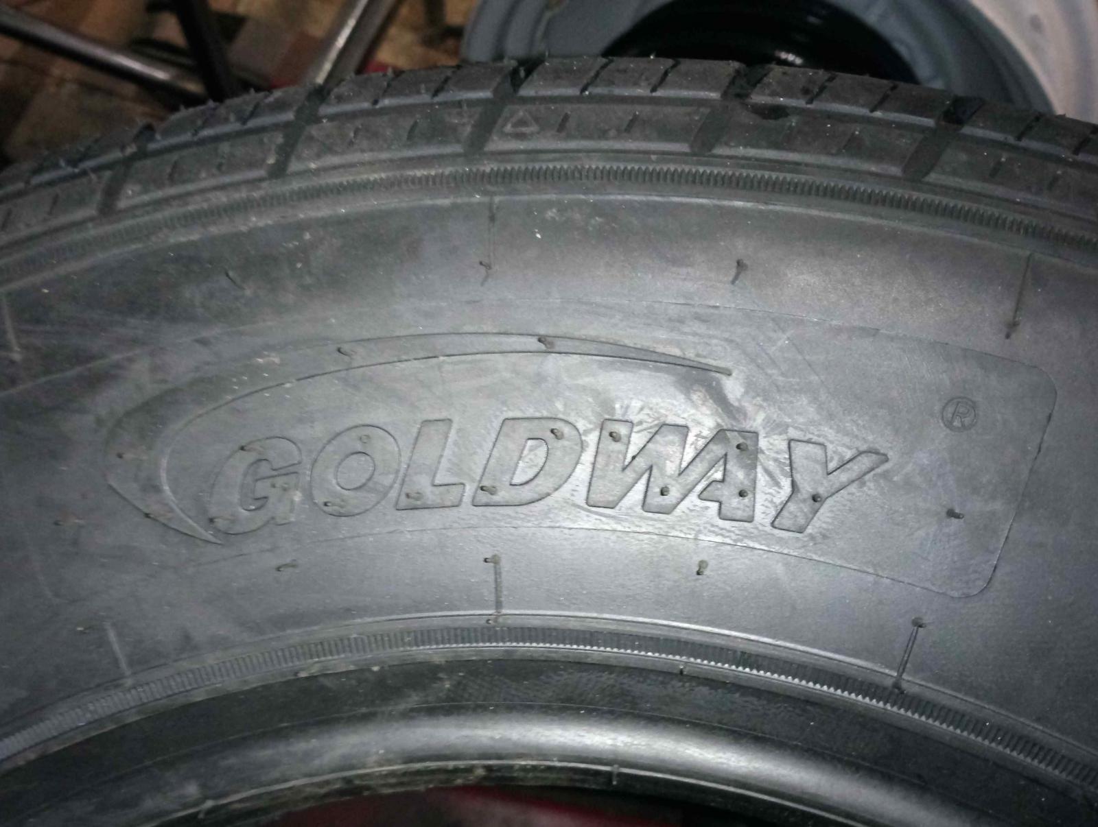

Since I'm indulging myself a couple of new tyres will be going on, I've never heard of this brand before, probably something exotic and new to the fens. They were nearly £39 each, but you can't put a price on quality.

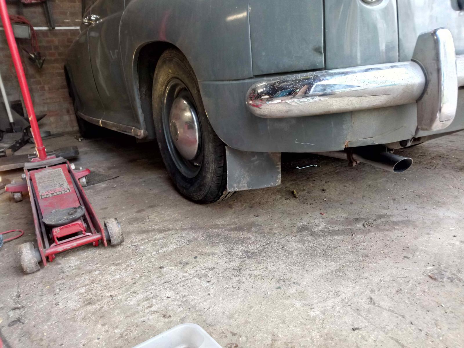

Here's the finished thing with lovely new tailpipe, new springs and tyres. Me backs a bit fucked from putting the tyres on but the ride is better so it's swings and things.

I got a new pair made by Jones Springs. They're on now, what a pleasure it was working under the old sow as the temperature went above zero and ice melted and dripped off the bodywork onto the floor. Sadly the last bit of exhaust has gone holy so I need to get an end section to go from the silencer. Its £30, but the downside is that most pipes for old cars seem to be made worse than moderns- this looked fine when I fitted it a year ago, so I'm guessing that particularly awful steel is used for the classic wanker market as most of the vehicles are never actually driven.
One issue I'd like to address is the silencer, but it will have to wait as I need the car on the road ASAP. These cars only have one box but it looks like something off Titanic. Given that the makers went to great lengths to keep the car quiet, I'm guessing this component is more than a bit restrictive. If the use of rubber mounted wiper boxes is anything to go by it wouldn't surprise me to find there's no route for the exhaust to actually pass through the bloody thing at all, so I shall have to look into it.
^^^have added picture of finished job to the original post as the difference is so disappointingly tiny. However I also renewed all the roll bar bushes so the car is a bit less like a ship on corners. You modern drivers would still be horrified it has to be said....
