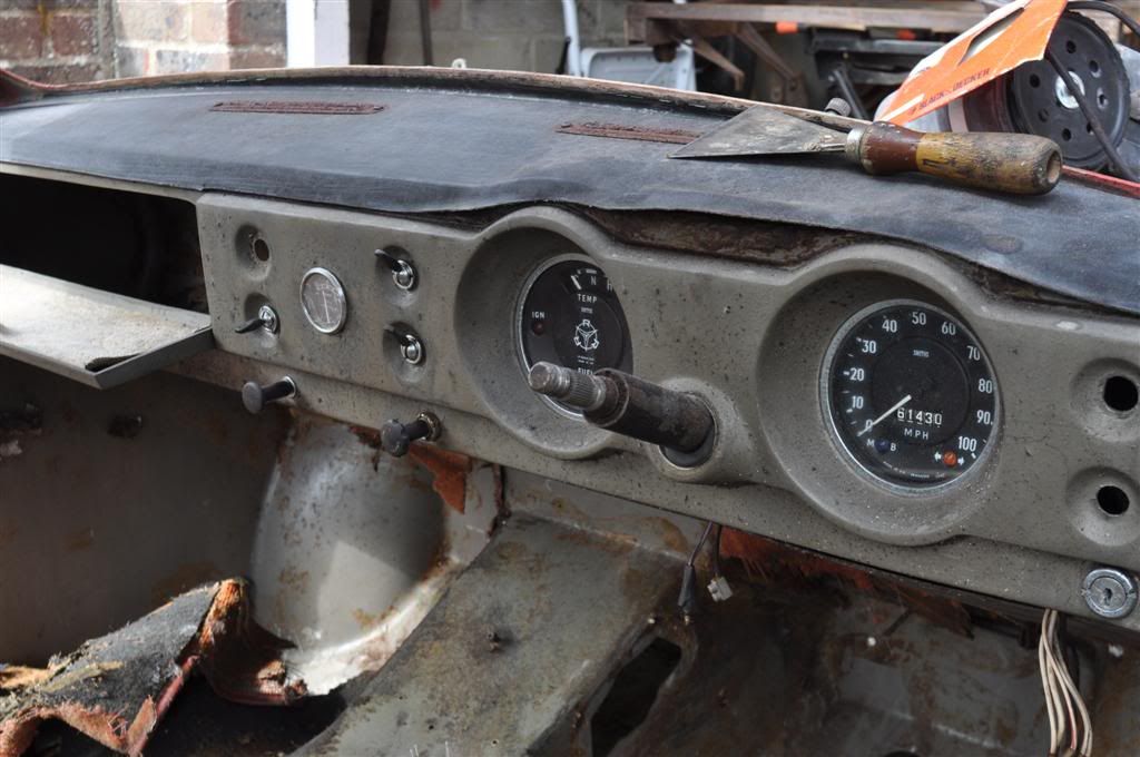

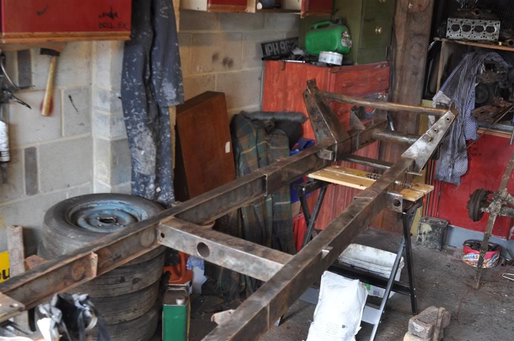

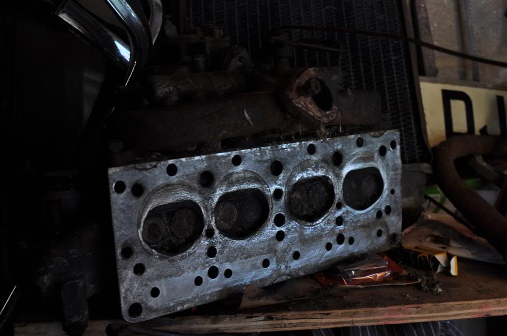

coalnotdole Posted June 24, 2011 Author Posted June 24, 2011 Stripped the rebel today right down to the chassis, so heres a few photos. I will need to get some new steel sections folded so will have a word with the local fabricatior on monday. There are a few holes in the chassis where the battery has leaked and dissolved the underseal and corroded the steel. Its generally in good condition and a bit better than hoped. Theres also some fibreglass work needed to replace seat supports, cracks around mounting holes, and some areas around the door catches Pictures: Stripped the head off the Rebels engine today and the headgasket has corroded and let water into number two cylinder and has seized the piston, Havent dropped the bottom end of yet and removed the piston or liner but what i can see of the bore is pretty badly pitted. Considering changing the Liner and Piston or an engine swap if I cant get hold of those. The cleanup of the chassis will start in the morning! somewhatfoolish 1

autofive Posted June 25, 2011 Posted June 25, 2011 fast work chassis doesnt look too bad galvanising the chassis before reassembly? i may be able help with NOS mechanical bits - get your list sorted
coalnotdole Posted June 25, 2011 Author Posted June 25, 2011 galvanising the chassis before reassembly?/quote] Will try and sort out a Draft parts list today, I'd love to galvanise but theres no one local who can do it and sending it away would probably take too long as I'm trying to turn this car round as quick as possible! I Will Paint up the chassis in zinc rich underseal and give it a couple of coats which is how we did the scimitar. Its protected it quite well for the last 45 years so it will hopefully work well again.

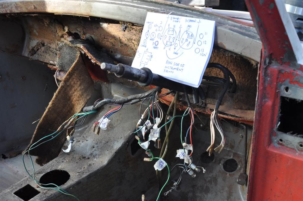

baldrickthecunning Posted June 26, 2011 Posted June 26, 2011 Good to see how much this project has progressed in just a few days, glad to have offered my small amount of help on saving this thing. You and Dave seriously don't hang about! Here are some shots from yesterday My autoshite wiring diagram! somewhatfoolish 1

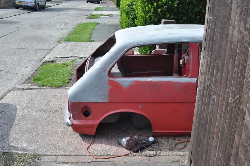

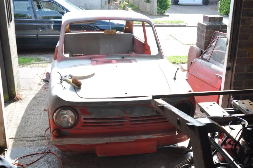

coalnotdole Posted June 27, 2011 Author Posted June 27, 2011 The internets been playing up for a couple of days so firstly sorry I've not got back to anyone who has contacted me about parts, I'll get in touch asap. Still even without the internet there has been progress on the rebel. Chassis Stripped down ready for wire brushing: Saturday afternoon Marlon (baldrickthecunning) dropped round and gave us a hand removing dials and labelling the loom. Cheers! Body has been DA'd back some more though there is still quite a bit more to do. With much of the interior removed It became obvious that there wasn't much reinforcement inside the rebel. We are more used to the scimitar which has a significant amount extra steel support so this came as a bit of a surprise! Essentially on the Rebel the A posts and along the top of the windscreen are the only reinforced sections, Offering roll protection in the same way as a convertible. On a scimitar the bodywork would have A post stiffeners, Sill stiffeners, roof supports and a tubular steel rollbar going down through the B and anchoring to the chassis. B Pillar: C Pillar: We are currently considering how best to add in some safety features that are present in later Reliants. Finally a last picture of the chassis cleaning in progress:

stuboy Posted June 28, 2011 Posted June 28, 2011 blimey theyre scarily weak in the body... good luck with it all
garethj Posted June 28, 2011 Posted June 28, 2011 You can’t go far wrong with a nice sheet of stainless steel, I know someone who had success with a washing machine drum cut up. Whatever you use, lots of holes will help the resin to bond but remember it’s the fibreglass mat that has the strength, not the resin itself. A company called Bighead fasteners do lots of nuts and studs, but if you look at their stuff you’ll get the idea – whatever’s taking the load will be surrounded by a big perforated sheet to allow the fibreglass to bond through it. If you can make the perforated steel into a u-section or top hat section, it’ll be stronger in more directions. Lay the mat on, daub it with resin using a roller to get rid of the air, and when it’s tacky put the next layer of mat on with resin. You can get special rollers made of washers to get the air out. Try and make any corners in the fibreglass a nice big radius rather than sharp, it’ll separate there and leave air bubbles. Keep going, it’s a pleasure to see!

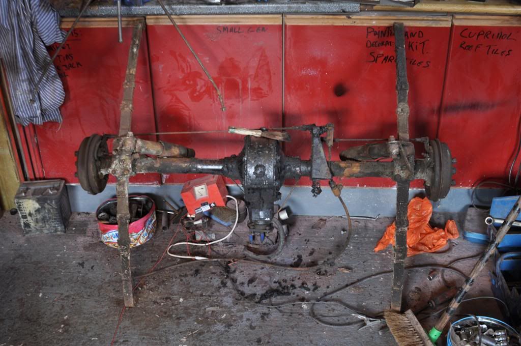

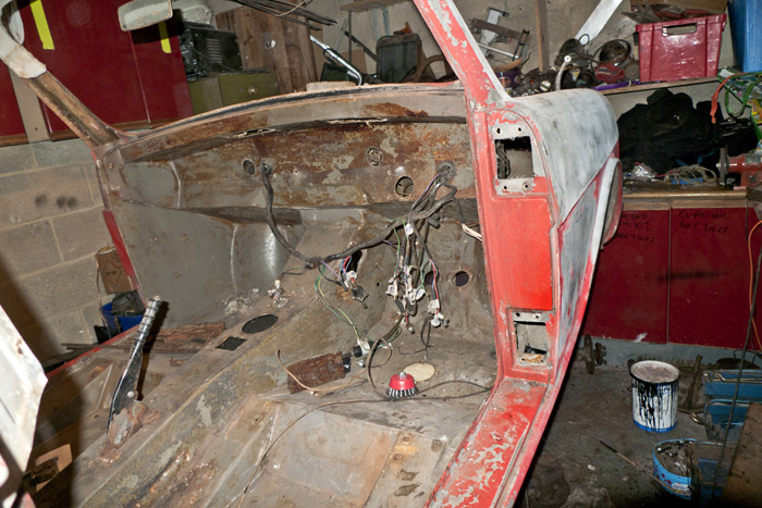

coalnotdole Posted June 28, 2011 Author Posted June 28, 2011 Few more photos as I've got a bit of a backlog of pictures of recent work. Engine Finally unsiezed but in need of valve's replacement pistons and liners Valves Checking the hubs and brakes: Chassis has had a coat of paint on all the sections that don't need repairs. I'll add a better picture later Body up for the fibreglass work to begin: Attachement for original lapbelts: Other seatbelt mount, this is where we intend to tie the new roll bar to the chassis Bits to fix: Seat supports to be replaced Rear view: At some point in the past a previous owner had added in 3 point seatbelts by glassing some thin steel into the wheel arches: Crack in the skirt at the front shows where the car had had a knock in the past. Gave the engine bay a bit of a clean up, I'm still one post behind so will try to bring the thread up to date later this evening,
coalnotdole Posted June 28, 2011 Author Posted June 28, 2011 Probably the last update to this thread for a while as I'm away for 10 days or so. Hpefully going to be cracking on with this again as soon as I'm back. These photos show a better view of the chassis, the start of the fibreglass repairs and removal of the headlining to evaluate fitting a nicely concealed rollbar and roof reinforcement.
Mr_Bo11ox Posted June 28, 2011 Posted June 28, 2011 fuggin wars theres absolutely nothing to that bodyshell at all!!! Wow.
