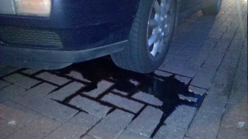

Just went to pull away from a junction, all normal like (seriously, I drive it like a granny for MPG purposes), felt like it jumped out of gear bit it didn't. Horrible noise and there's a massive long trail of oil down the road leading to that puddle in a layby.
I'm hoping gearbox...... cos they're about £40. Dipstick still says engine has oil in it, and the engine oil is new unlike that black mess. I also still get oil pressure, the light goes off after one flash like always.
Only thing is, it now sounds like a bag of nails even in neutral, at idle. Could that still be gearbox, does the input shaft still spin in N?
Sounds like a driveshaft could have popped out, although, I thought they were bolted on on Golfs.
Is the oil gearoil? Should stink to high heaven if it is.
sounds like it spat the diff out the back of the case.. and yeah, input shaft spins in neutral.
Yeah it reeks. Still drives though and both diffs look right.
So a horrible "buggered" sound in neutral could still be box? I can just about do a box myself......
Looks too black for gear oil but as Volksy rightly points out it should stink if so.
What happens if you dip the clutch ?
Still noisy if clutch dipped. Looks too black for my engine oil too though, it's only been in a week and the stuff on the dipstick is still oil-coloured.
?BOTH diffs? 4wd?
Gearoil out of a box that overheated and burnt up its bearings is the blackest, nastiest, stickiest foul smelling shite ever.

Hmmm, don't read too much into that.... it was dripping onto red blockpaving, plus that's a shitty cameraphone at night. If you squint you'll probably make out the face of your chosen religious icon ;)
Anyway, isn't it only ATF that's red?

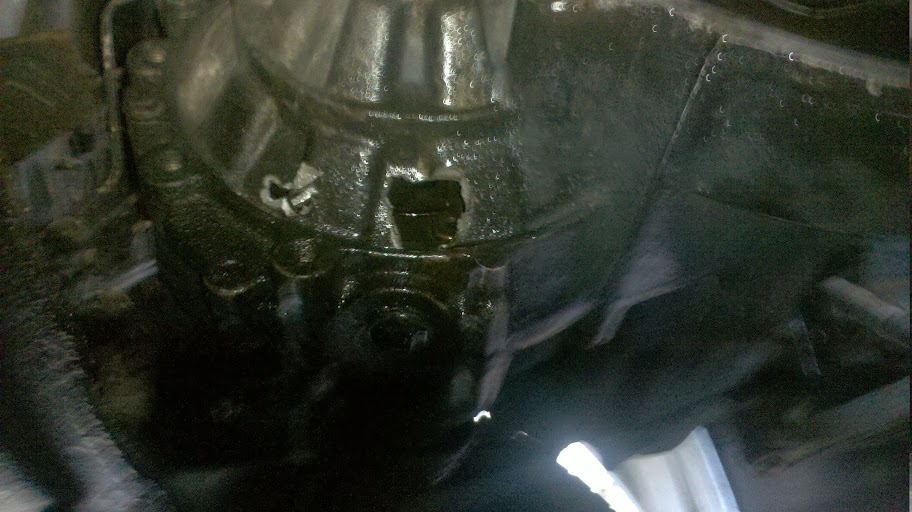

On another note, found out why it lost so much oil so quickly.
I'll add that to the collection of "things that pillock has properly, properly broken"
Aah, the good old VW rivetted on crownwheel?
