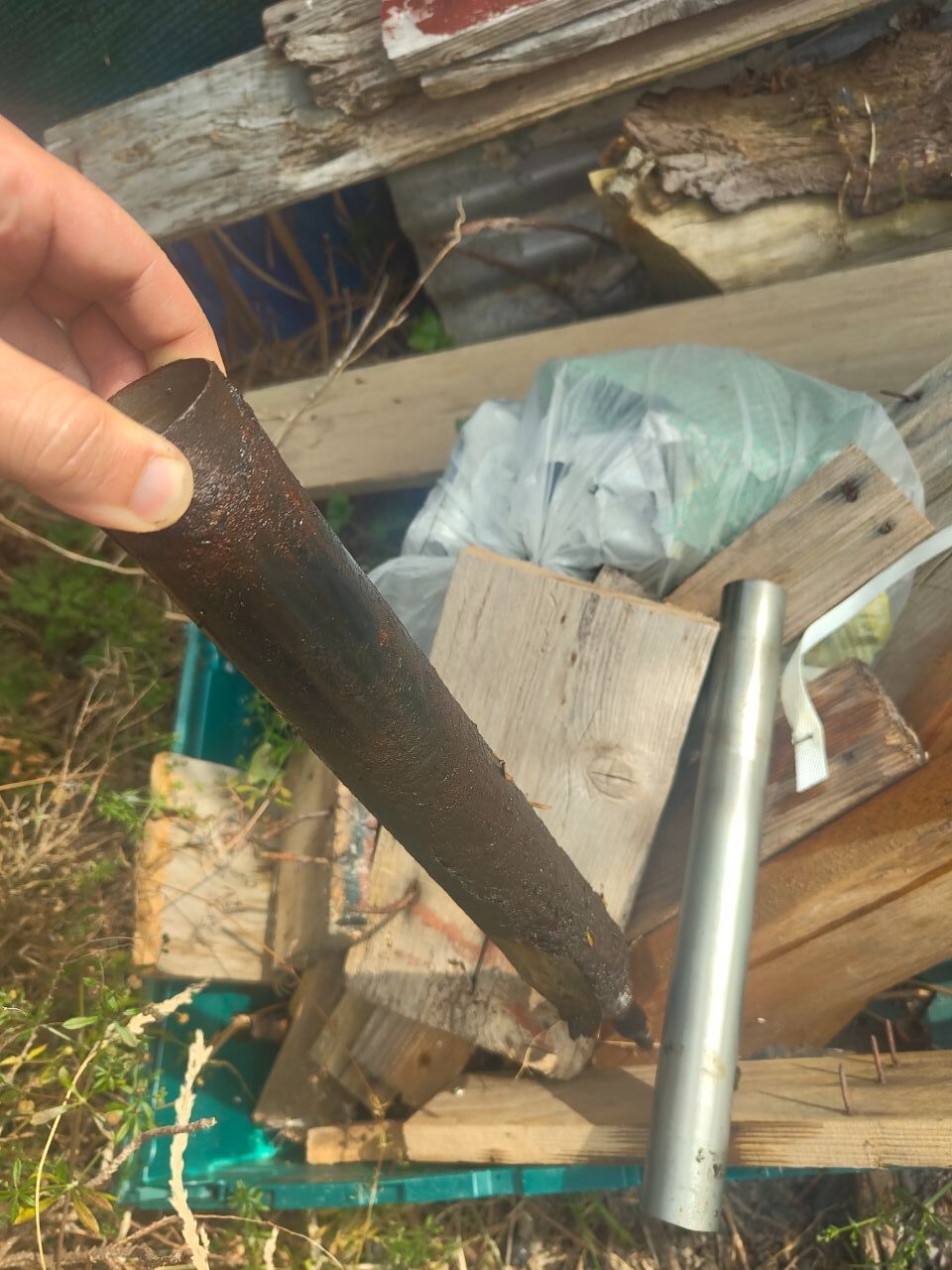

Yesterday I was driving up a B road, up hill, when the back N/S wheel went over a slightly sunken drain cover. It gave me the sensation you get when one wheel slightly looses traction. This was followed be some squeaking and the back of the car suddenly felt like I was driving an old mattress down the road. I pulled over to have a quick check and there was oil leaking around the lower shock mount and around the dust boot.
This all happened less than a mile from home (always seems to be the way) though I'm quite grateful i wasn't miles away.
I've popped her on axle stands today and taken the shock out and well, mind the pun, have been pretty shocked myself on how these OEM shocks are put together. Absolutely FULL of oil. Clearly mine have had it but the dampening abilities are awful. IMG_20260721_142129681.jpg.f24dbfa2017182c09f02dab6059dcd31.jpgIMG_20260721_143536242.jpg.a21282630857cbc849e6c6b90e07b160.jpgIMG_20260721_143810073.jpg.504396080245a47bc5bf788029ec831d.jpgIMG_20260721_143541446.jpg.c61d26223bfadabf98c475cb3c80ed88.jpg

You'd think so wouldn't you?
However, these seem to me to be a piston inside a cylinder that's full of oil. There must be an air (gas) gap there somewhere?
Silver cylinder sits inside rusty AF cylinder
In remaining oil
Piston compresses oil, dampens rear of car. Alongside, spring which goes bouncy bouncy.
Somehow, the torque of the rear wheel under load (uphill at 40mph), with added sudden drop into the drain cover on the road must have been the perfect combination to separate the silver cylinder and the top housing for the piston.
Many dampers are NOT gas-pressurised.
Just a cylinder with a piston that has spring loaded valves in it.  Cylinder completely full of oil. Sometimes the cylinder itself is the damper tube you can see, others have the cylinder within another tube that is also full of oil.

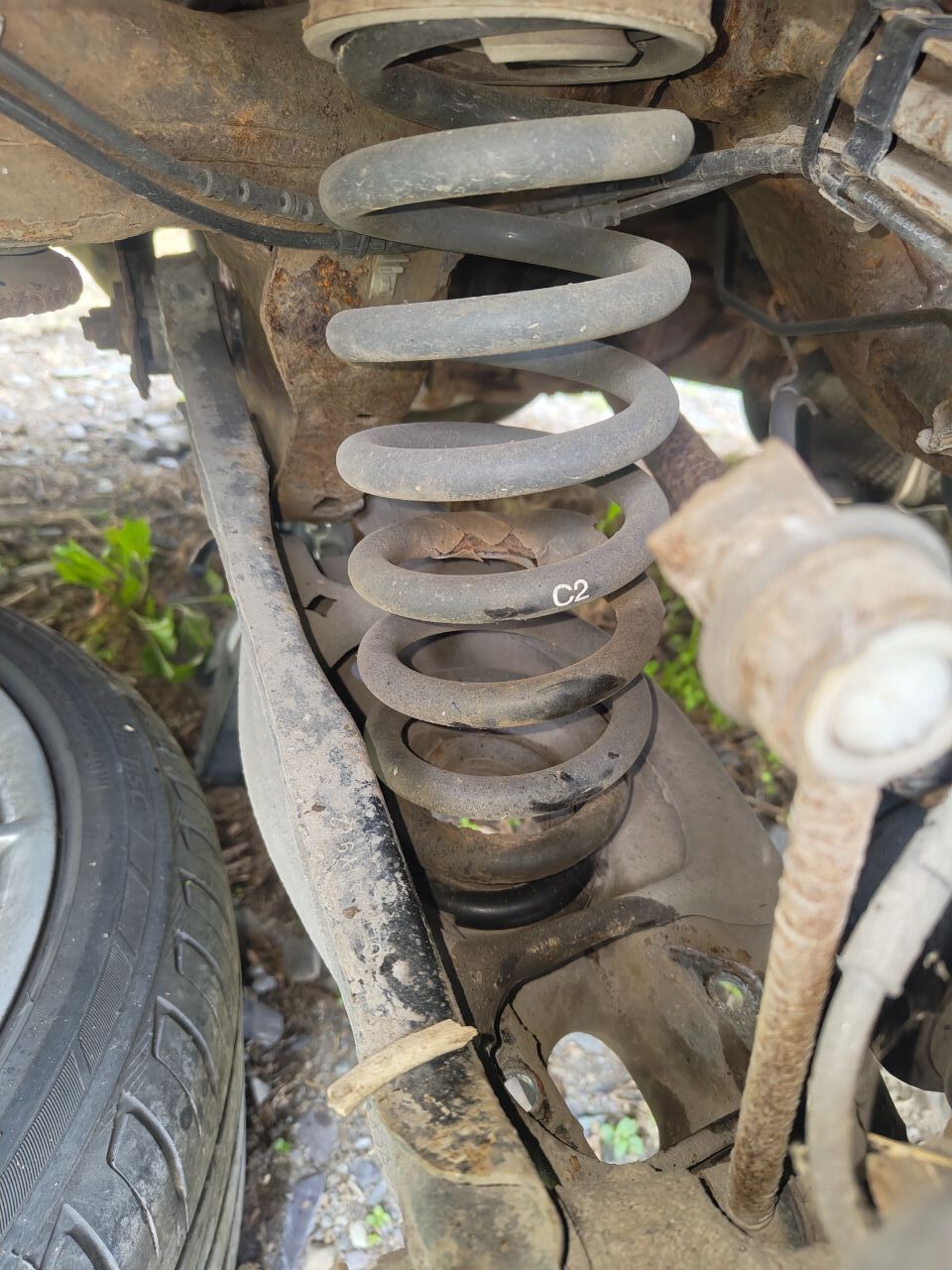

Got the N/S off first, assembled the new damper, lay down on the floor on a large piece of cardboard and thought to myself "jesus the rear axle looks rust". So, yet again the need to change the rear damper turned into yet again another 'whilst I'm here job'.
So I got back up the floor, popped a wire brush attachment on my grinder and set to work. Popped some rust converter on there, waited to dreaded waiting time, popped some underseal on top and lay back down on the floor with damper in hand.

So for now, they're on. BUT, I've ordered new top mounts so they'll be out again by next week haha! Oh ye and also the coil spring on the O/S needs replacing so that was a nice suprise too.
