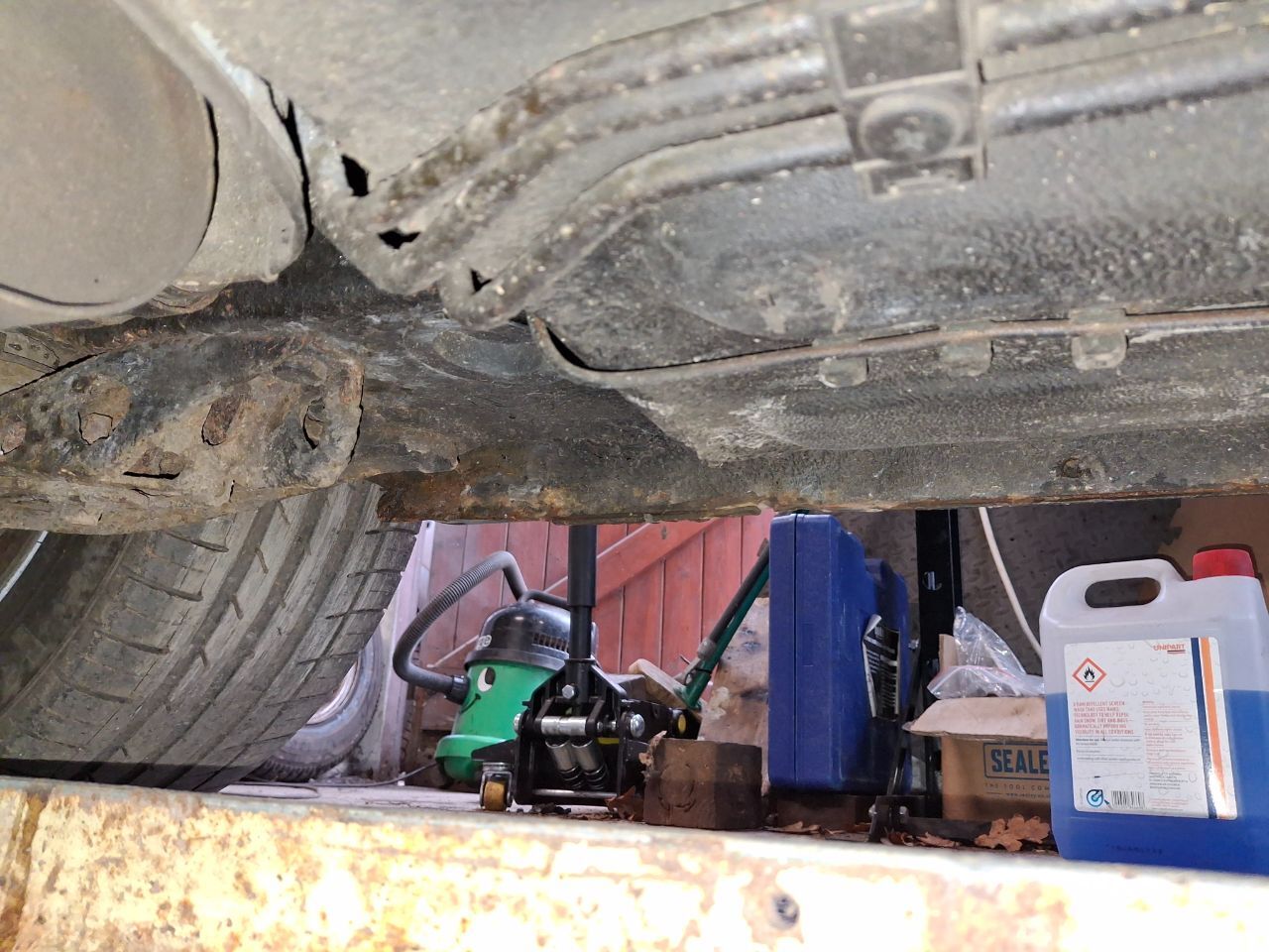

Probably a good point to get under the beasty and have a poke about? Hell why not whats the worst that I will find?
Actually its not too bad, considering its a 30 year old car that was made in England.
A little surface grot but nothing really structural and yes I have poked, prodded and hammered. Worst bit I found was a slightly crushed sill were someone had missed the jacking point but its just bent and still solid, so I think its okay.
The rear wings are still scabby (I haven't touched them) but no sharp edges.
The suspension bushes all seem intact. Although I suspect the front ball joints are a bit worn and are possibly the culprit behind the slight vague front end and brake judder.

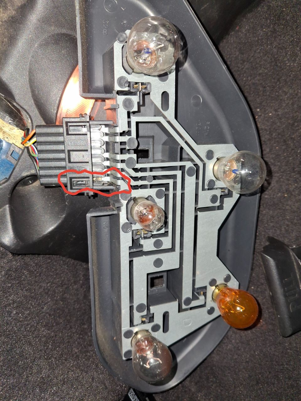

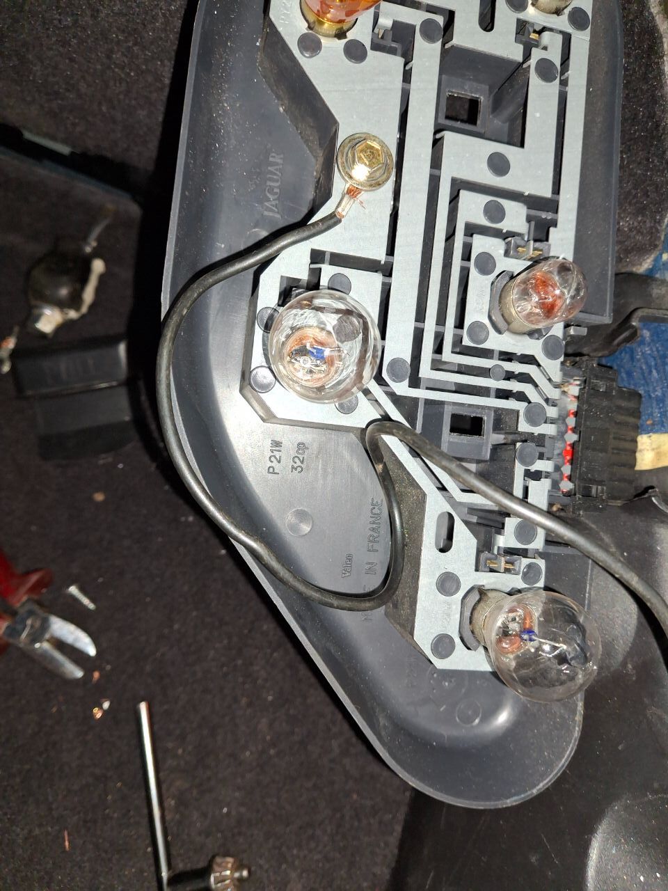

Onto the lights, hmmmm, the headlights are like candles with cataracts which is a concern.  The drivers side tail light appears to have a classic earth issue, the side light flashes in sympathy with indicator, so that needs sorting.
After doing a Google, I found this is a common issue and one way of fixing it is to just add an additional earth lead.
As you can just make out the earth terminal doesn't look great..
So I followed the advice and added a fresh connection.
This is now sorted and working properly!

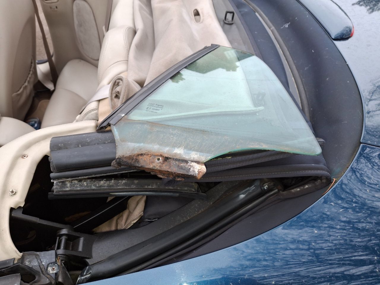

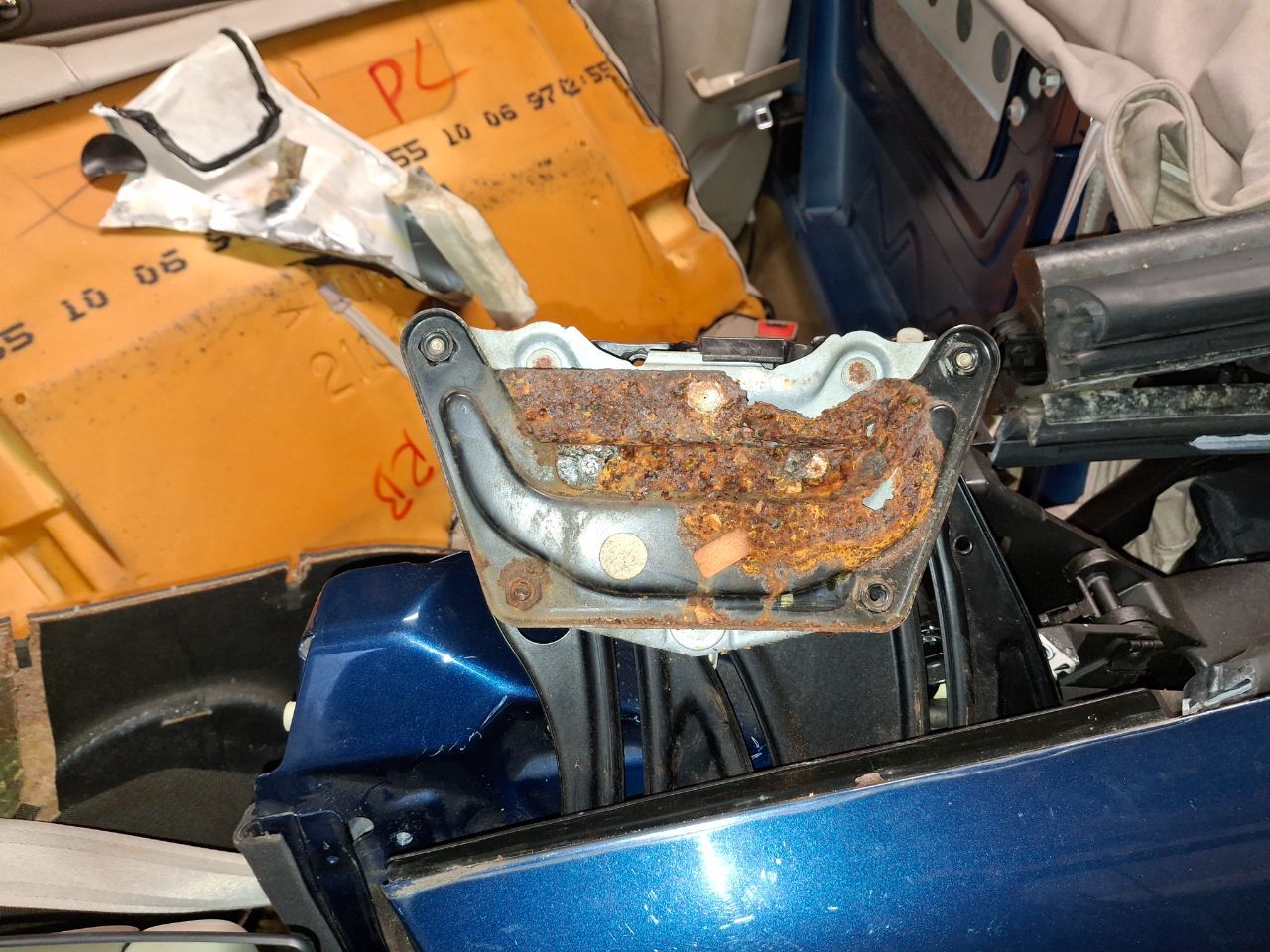

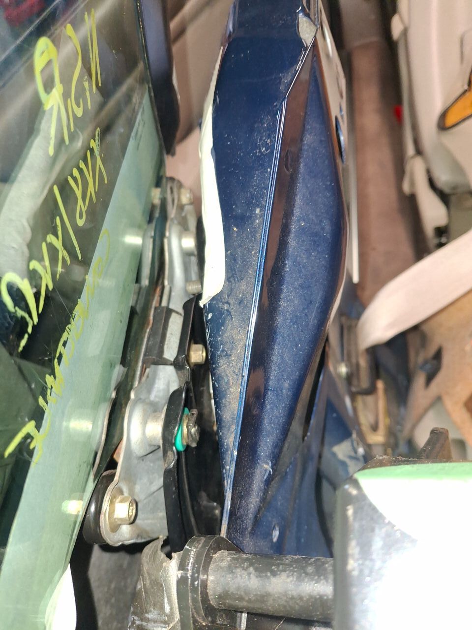

Then I made an error and decided to see if the roof would open on its own, nope it would not but it then developed a new issue. As the little rear windows dropped the passenger side one only went partially down and then sort of flopped. I went to examine it and found it had detached completely from its runner.

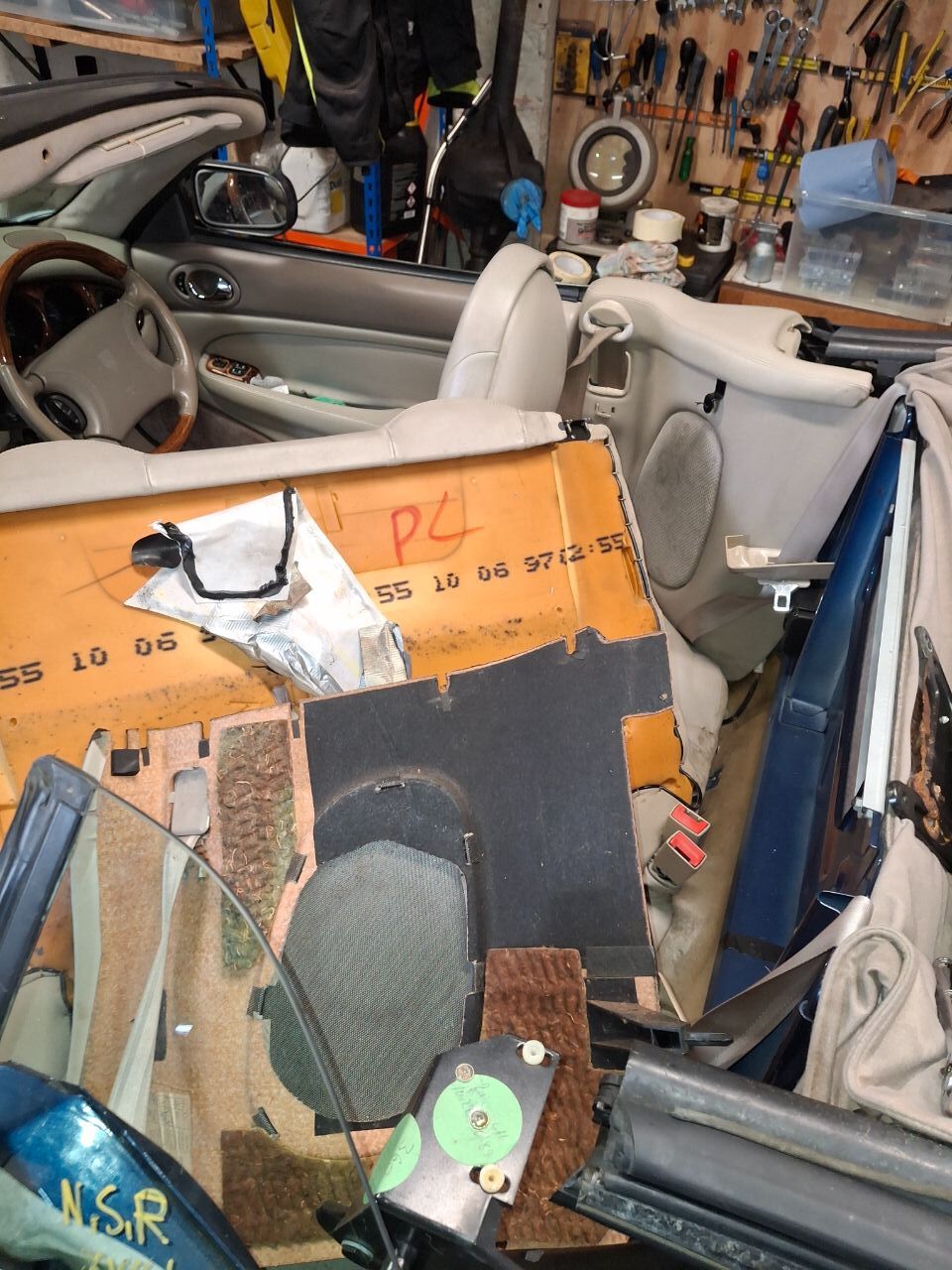

Not ideal! And not really what I was expecting to be dealing with... Anyway so far this Sunday I have stripped out the rear seat and trim panels and got the window mechanism/runner free but not completely out...
You can clearly see were the runner has rusted through and let go of the window. Now I have to do some shopping see if I can get a runner on its own.
The annoying thing about this is that I suspect I will have to repair the other side soonish as that has some play and may well be in a similar condition...

I'm a bit surprised how good it looks underneath. I'm also surprised that a window lifter assembly can rust out. Win some, lose some!
Ha yeah, the runner is I suspect, the bit they forgot to rust proof! Everything else in that location is solid.

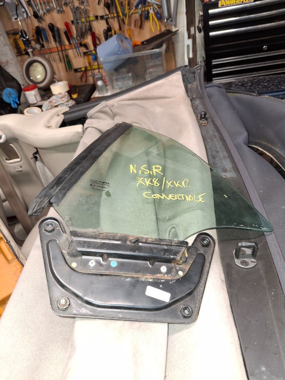

Small but fiddly and awkward update....
This arrived, so time to roll my sleeves up.
This was followed by a good few hours trying to work out what order to put everything back together in, its all a bit tight and awkward.
Its amazing what you need to remove, the rear seat base and back, the side panels, the speaker etc etc

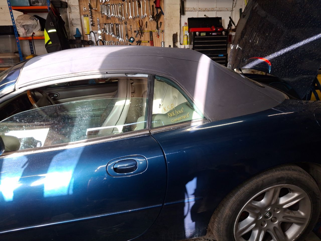

But it all lined up eventually..
And tested with the roof up...
Yes I did clean the writing off...
So that's the Jag back on the road!

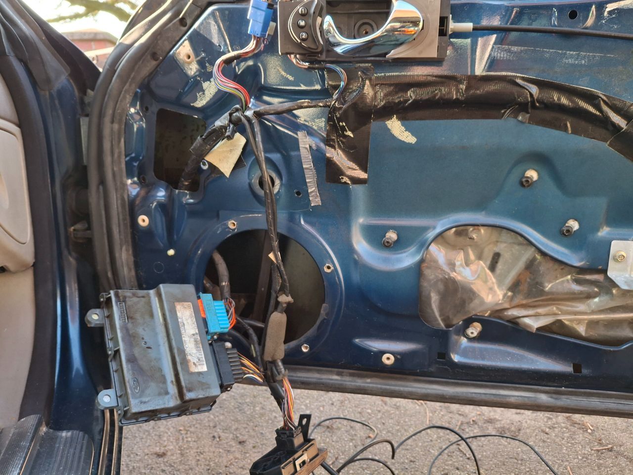

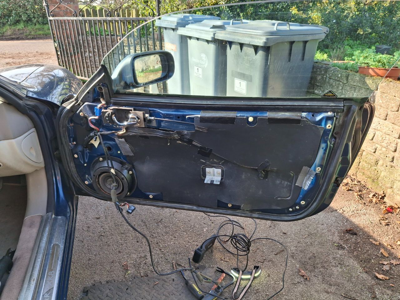

I hate door cards, why can't they be bolted on with nice shiny big bolts? Anyway, after carefully snapping many door card clips I started my investigations.....
I eventually found the door module, checked I still had a fault, I noticed that when you operate the switch you get a relay- esque click but no action on the drivers side. So I swapped the modules from side to side (they both have the same part numbers and according to the Jaaaaaaaag forums can be swapped to test).
The fault staid the same so I am now thinking it may be a more normal fault like a failed window motor, I need to find a way to test the motor. I am not sure if its canbus style system, were you apply a constant 12 volts and instruct it, to do its thing by applying a smaller voltage, the motor does have a multi plug so I I need to find the correct way to test...

On doing a bit more research I have found and downloaded a complete wiring guide. Tomorrow I will be attacking the connections with my multi meter......
Update time..
It turns out the connection to the window motor is simpler than it first appears - you have a couple of permanent lives for sensors (presumably anti pinch etc) and then a 12v up, 12v down and earth. So testing the motor was simple, it was getting all of the volts when you  pressed up or down but it wasn't for doing anything, its buggered.
I have bodged the window back up into a closed-ish position , I have left a tiny gap at the top other wise you cannot open the door or close the roof.  A new/secod hand motor is now on order.
