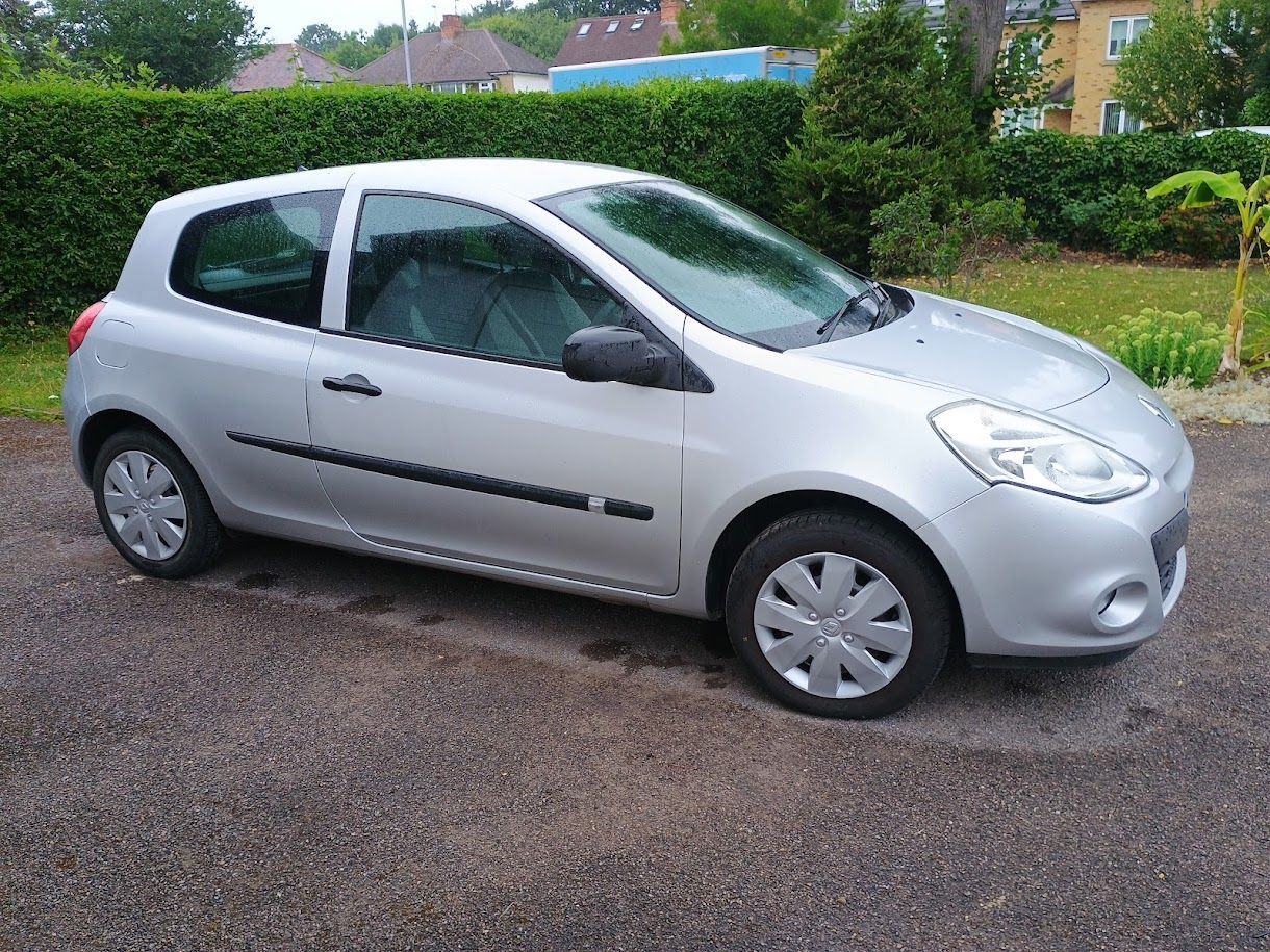

I bought this 3 door Clio as a run about and in a sorry state in need of some tidying up. In addition to exterior scrapes about the corners, it had some well scuffed plastic wheel trims, one had 20% missing, and a musty smell of damp in the interior. Mechanically it was in good condition and only 50k miles after 13 years. Plus it had full length rubber strips down the sides, so ideal for use as a park anywhere car, which my previously daily and just retired Civic had done. By making lots of little improvements I now have perfectably acceptable transport for pan UK trips. It has its own charm, a small smooth engine, not much in the way of mod cons, but includes PAS, central locking, 2 electric windows, a trip computer, ABS and skinny tyres. Having saved it, it is now a keeper.

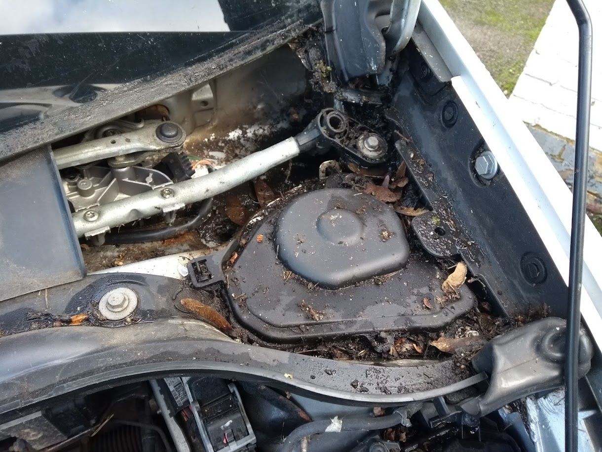

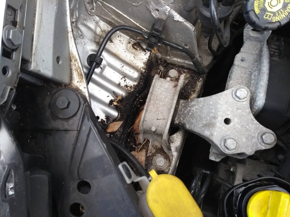

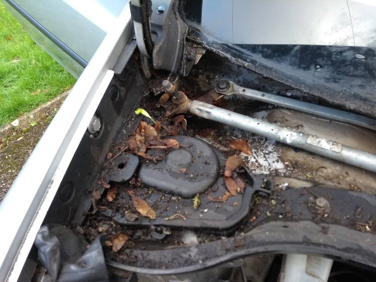

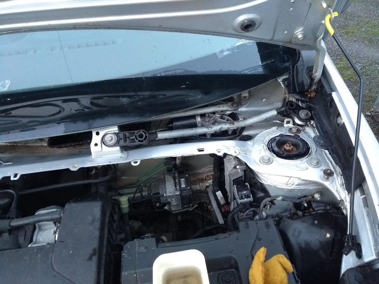

First job was to check the scuttle drains, which revealed plenty of compostable material in the scuttle and fresh green vegetation nicely sprouting - a 'green' Renault.
Once the compost was removed then the drains came into view, and could be cleared.
Looking better, even the scuttle drain is visible.

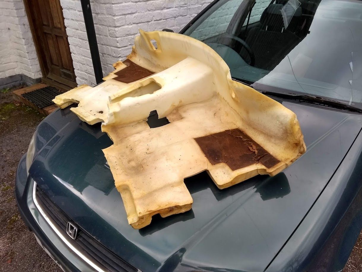

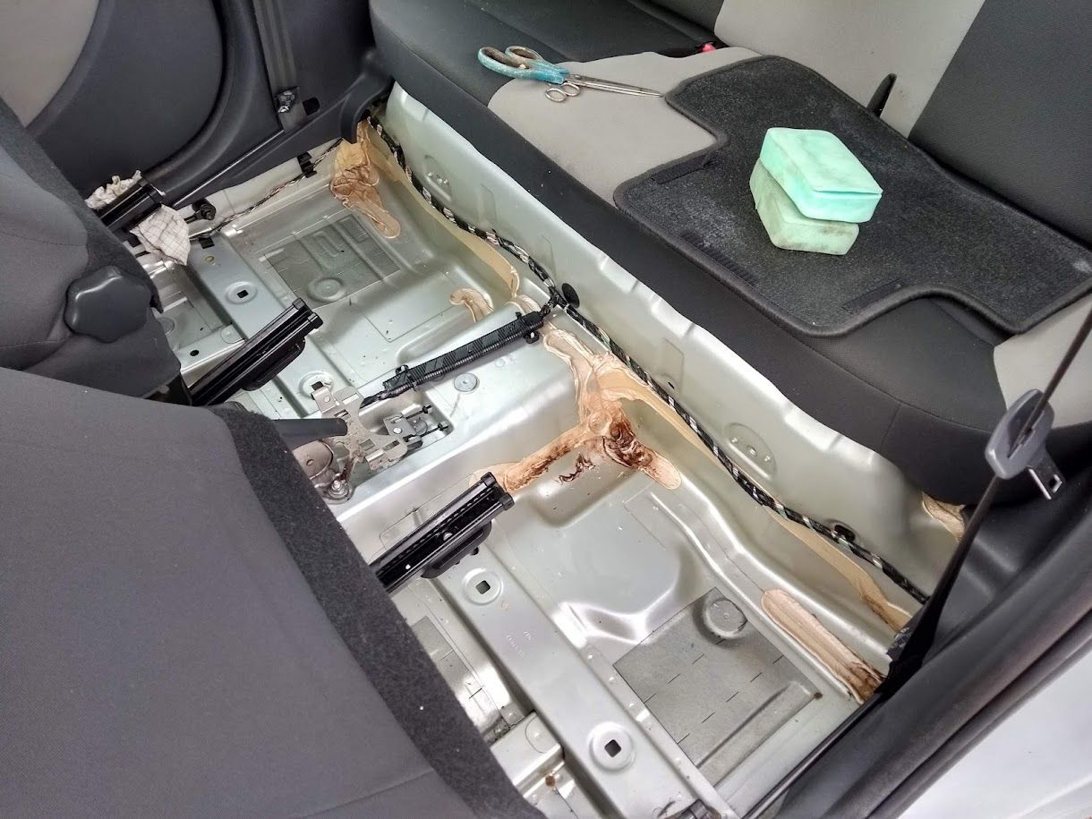

With the drains working, next was removal of the interior carpet and foam insulation underneath. Fortunately the water had collected in the rear, and not where the large electrical connector under the passenger seat is. Once the connector begins corroding, all sorts of electrical gremlins start, so a bit of a lucky result there. Also luckily the foam could be saved and dried out after several days. I used gaffer tape to hold it together, since removing it had caused many tears just by the weight of water in it. The brown cardboard sections, once stiff as a board, were now just wet mush.
No obvious rust on the rear floor despite being flooded for some time.

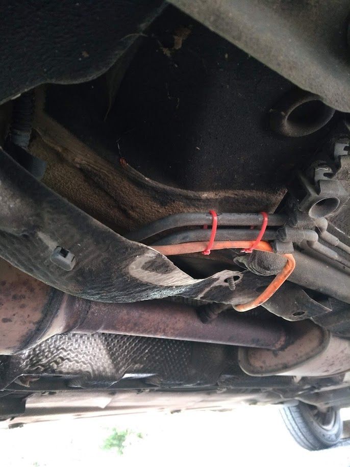

Just before the MOT, whilst poking my head underneath I saw a cable hanging down, so securely cable tied the O2 sensor wire before it got ripped off.

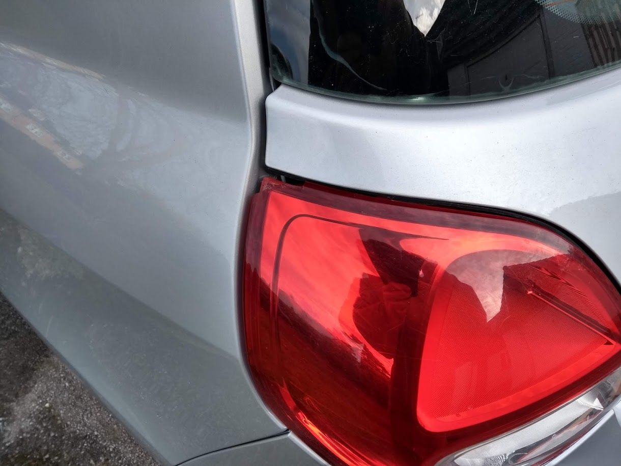

And sealed up the chipped rear light assembly to stop the water.

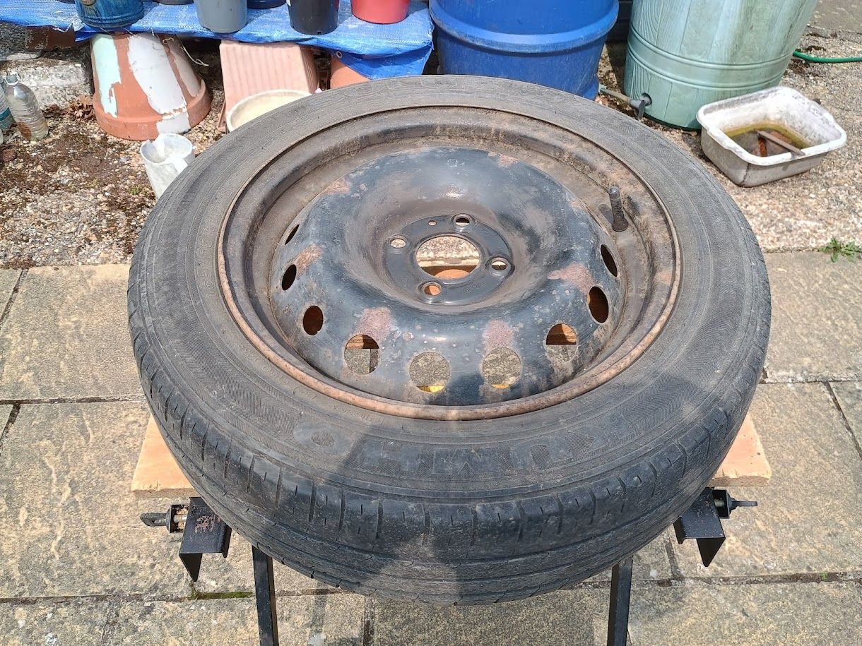

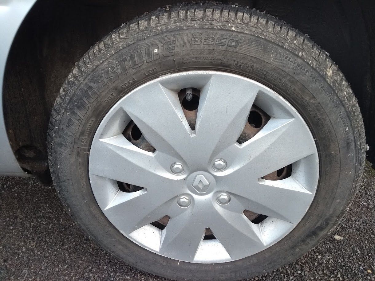

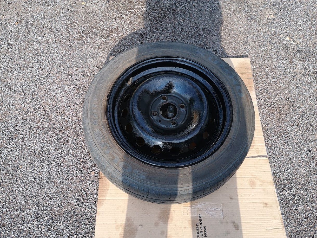

The wheels had a rust clean up and a couple of coats of black Hammerite.

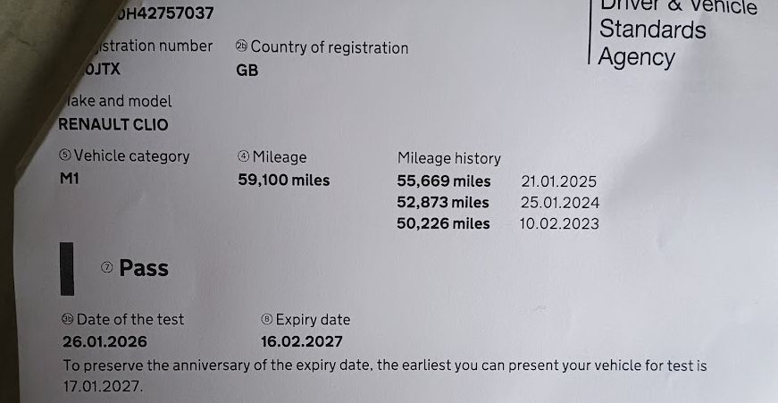

The MOT was passed with 1 advisory, the rear exhaust bracket was broken and the exhaust hanging on by just the back-up grey cable. So I made a temporary bodge by threading plenty of blue wire round the rubber support (indicated by the green arrow) and the exhaust mounting. This bodge stayed in place for the next 9 months whilst waiting for a suitable part to be in stock at Autodoc. The first part to arrive was broken, so had to go back, and then they had no stock!

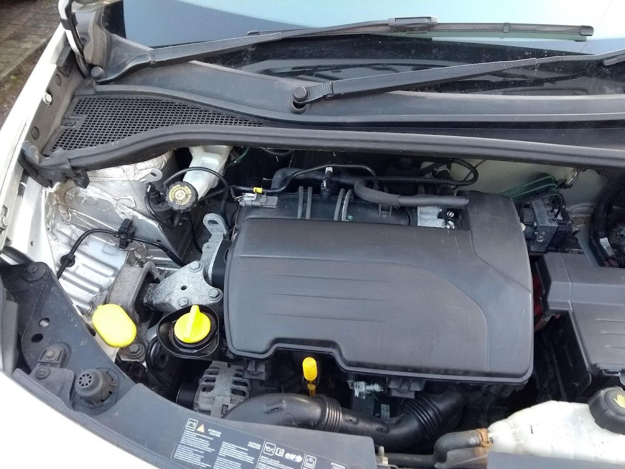

Then it was on to a general clean under the bonnet.
Afterwards

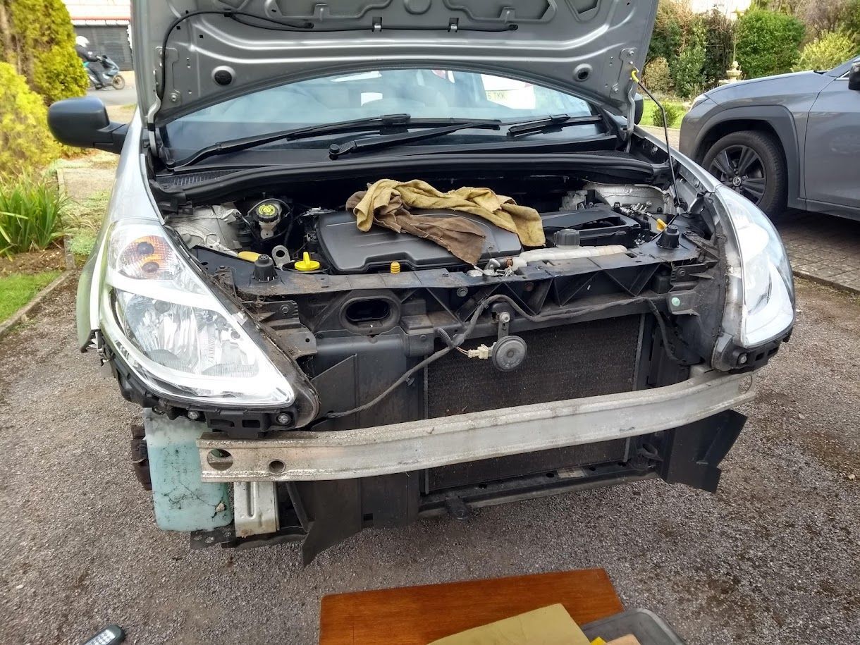

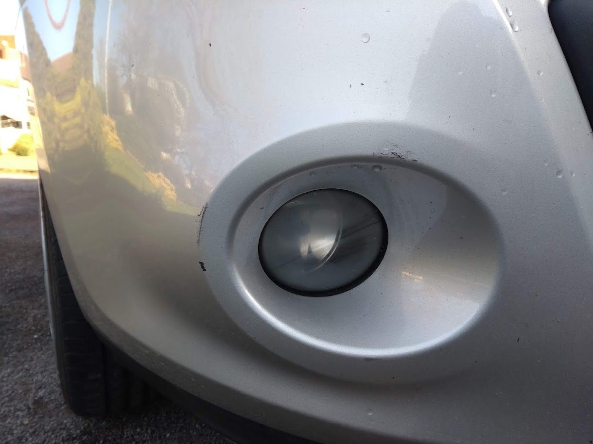

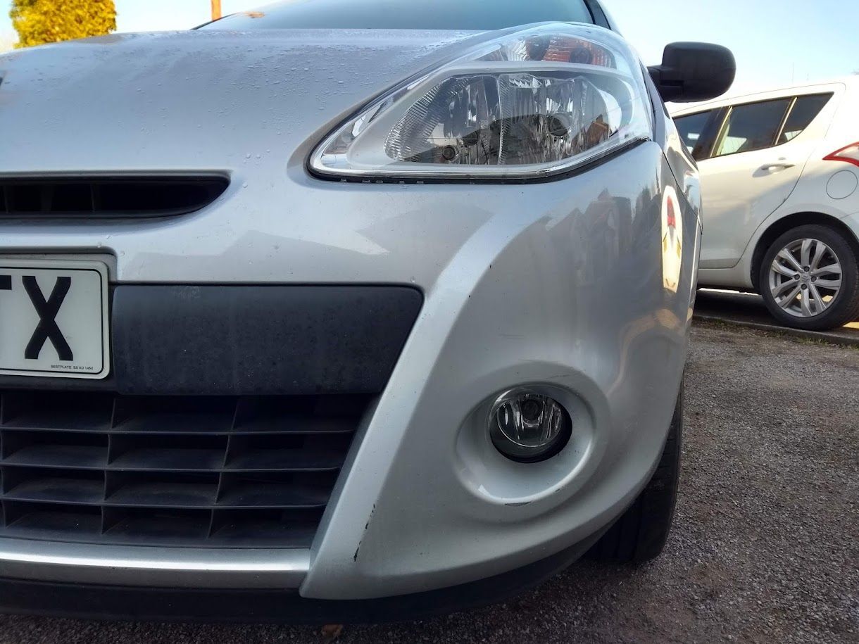

The next job was moving on to cleaning the misty and cloudy fog lights. Straight forward for the near side, front off to do the driver's side.

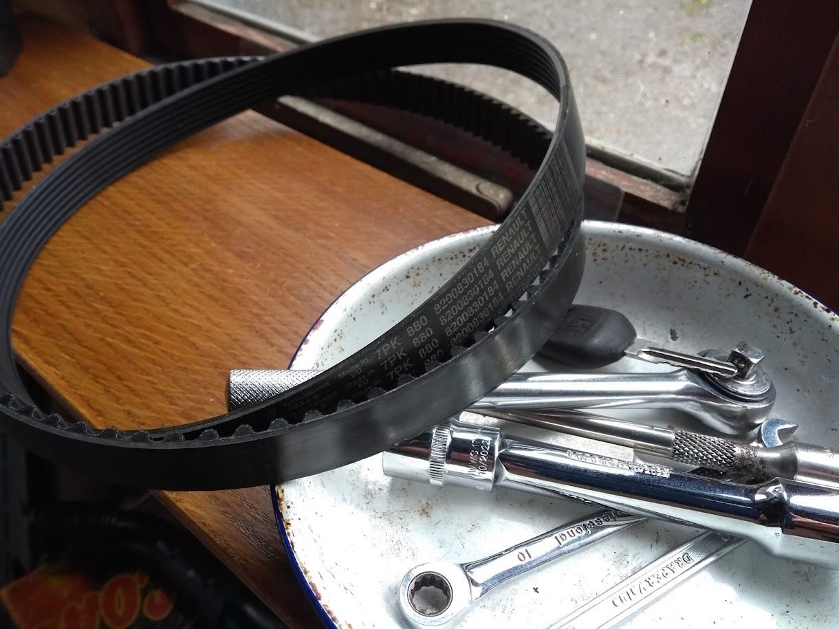

There was no evidence of a cam belt change, so with the probability it was 13 years old, it got changed by my friend/mechanic. New water pump etc, coolant and aux belt too. Afterwards the engine felt much smoother, especially at motorway speeds.

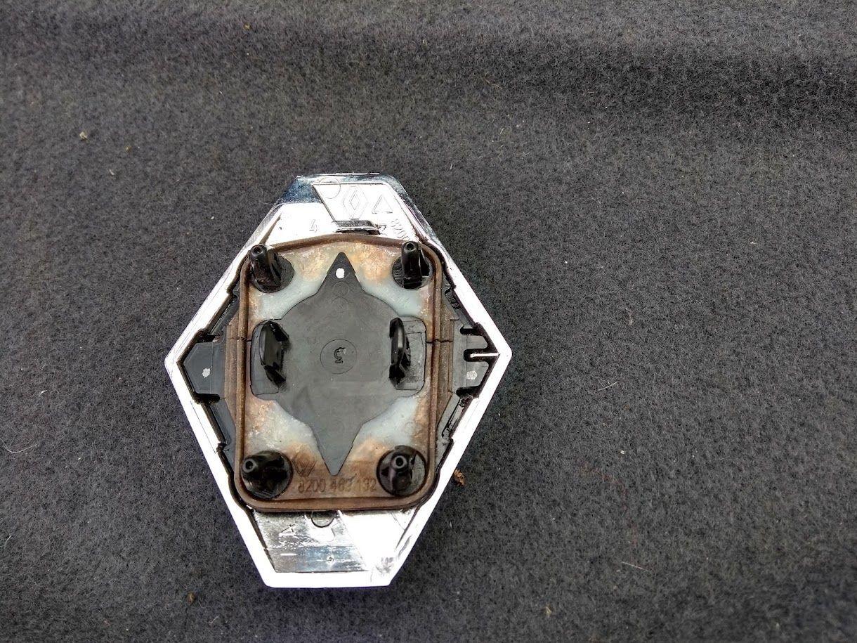

Something I noticed after it rained and the hatch was opened, was drips of water. I removed the plastic trim inside the hatch, and thought it was coming through the Clio badge. The badge could be unclipped/prised out, so I added some sealant around the old rubber seal. This seems to have solved the problem.

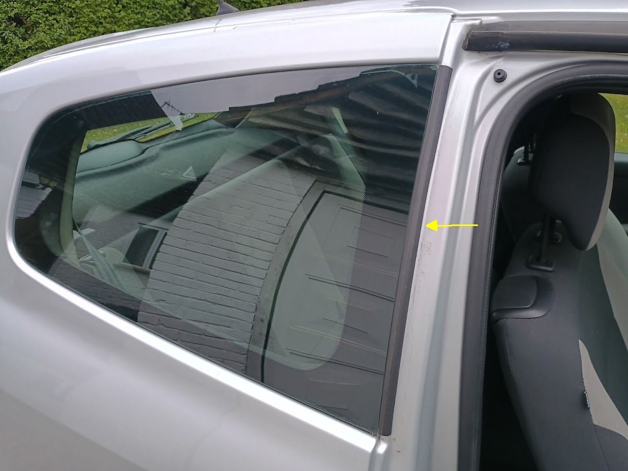

I bought some new rubbers for the rear quarter lights to replace the flaps of torn rubber when I bought it. Making this small upgrade made a big difference to the feeling of ownership.
For the next MOT, the old noisy 7 year old value tyres were replaced with new Falkens. Driving from the tyre garage to the MOT tester, the right front suspension clonked away a treat, the sound was like loose wheelnuts inside an old steel hubcap. However the car passed with no advisories, even with the original Bridgestone on the rear, I'm pleased to say.

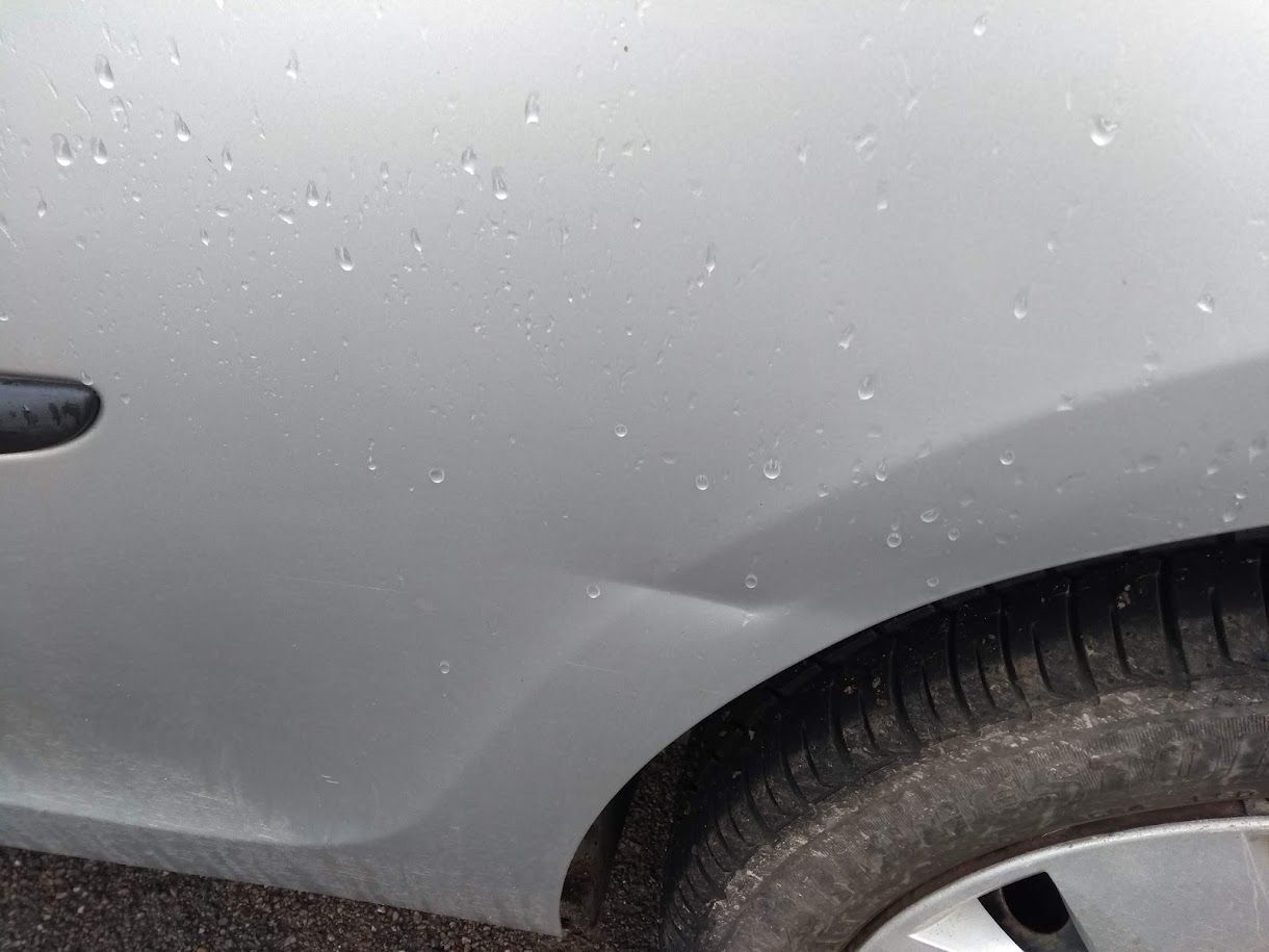

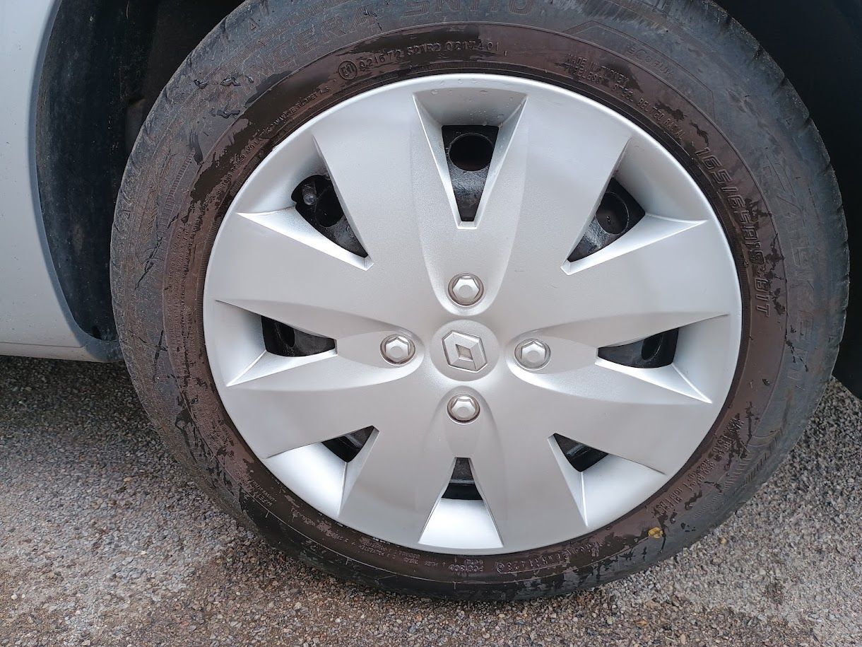

Jobs done recently were to tidy up the plastic wheel trims that had been kerbed. A bit of rubbing down with various grades of wet & dry, and then several coats of Euro Car Parts Aluminium spray, followed by a couple coats of Toolstations clear lacquer. There is a reasonable colour match, and looks OK when walking by, so we'll see how long it lasts. As the trims looked tidier, I refreshed the black Hammerite on the wheels too.
Its not perfect, with a few imperfections, but perfectly adequate for daily duties and parking in any supermarket car park.  Sidedent.jpg.17281b9dbb3cbc0cb371665c97112122.jpg

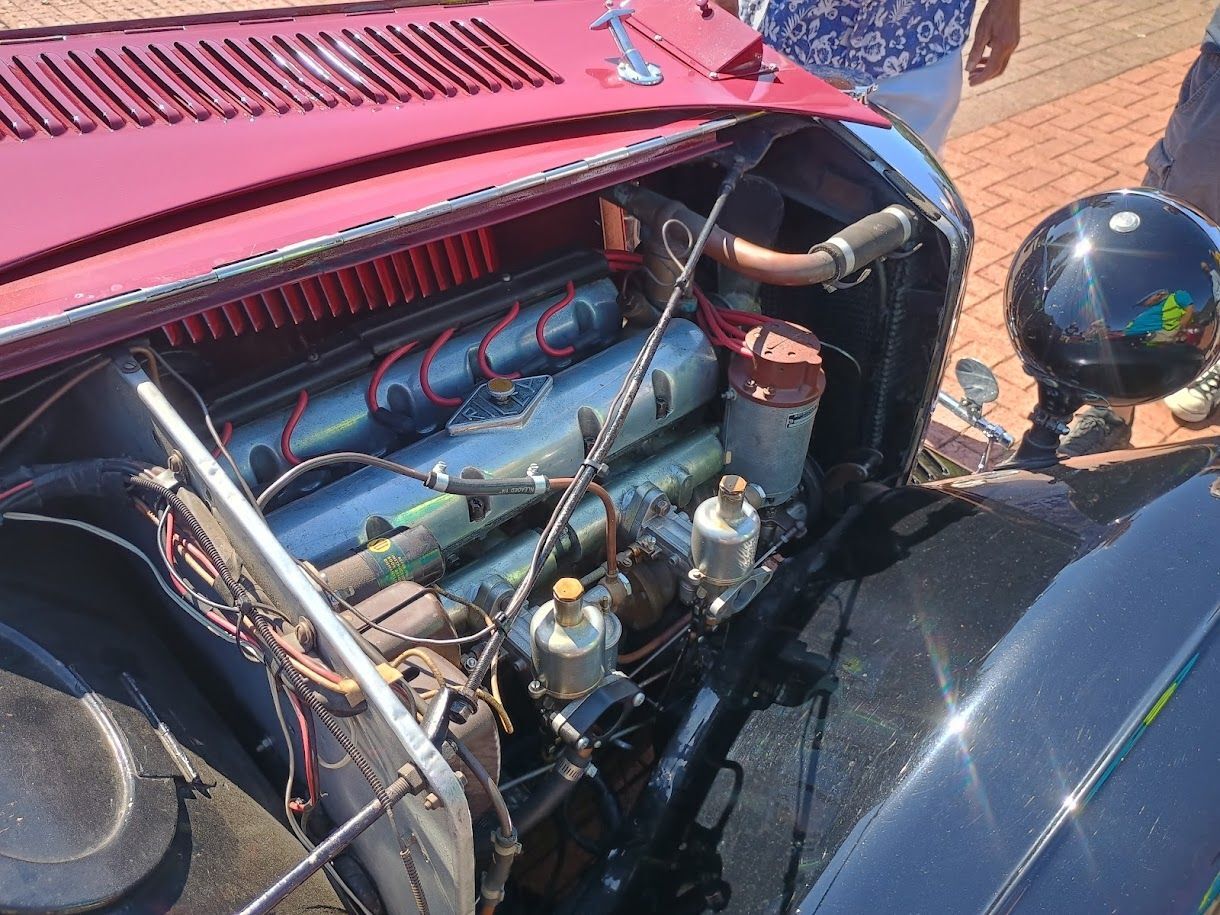

Two 6 cylinder engined beauties caught my and others attention, a Rover 95 and pre-war Riley 15/6

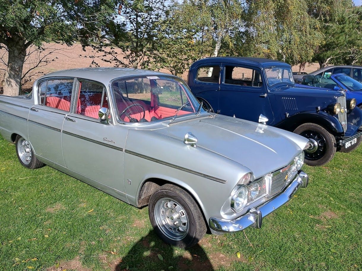

This Sunbeam might have been older ?

  • vtec-e changed the title to vtec-e's base Clio for daily duties - MOT day
A good result, always pleased to get a pass.
