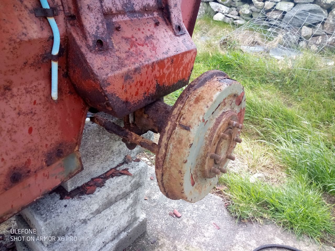

The steering works remarkably well but I've had the rear wheels off to start work on the brakes which will no doubt need a complete overhaul. The brakes were next to useless when new so i don't expect much of anything to happen when i stand on them. All the tractors from that era seem the same my Leyland is useless in low gear but faster in high reverse than any other gear. The brake pedal is useless it would be more effective if you threw a brick under the wheel while it was moving.

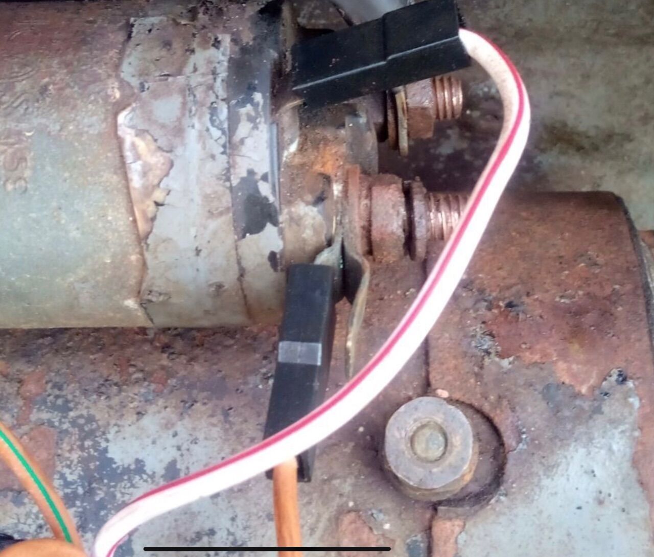

Slighty baffled as to where i am going wrong.... The key turns but no crank i checked the engine was free before fitting the starter so i know its not locked up. The starter was working when tested but I did notice the solenoid on starter was hot i had cranked it a few time but it could be the starter is scrap unless I've wired it up wrong but these looms are fairly simple though so I doubt it.

The link from the solenoid to the motor is missing in this image.
THANK YOU!!!!!   I don't know how i missed that especially as i took a photo of it. I fitted a jumper cable between the two and she's cranking and turning now.

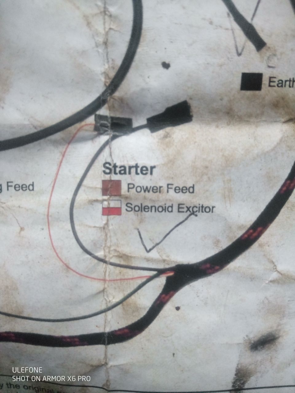

I am having issues with the new starter  the  tractor cranked before with the old knackered starter but now I've fitted the new one and nothing at all on the key.
I tested the new starter off the tractor with jump leads and it works.... If i bridge the terminals when the starter is on the tractor it starts and the engine runs really well so i know the starter isn't the issue.... The tractor simply wont start on the key doesn't even crank as it did with the old starter
I haven't messed with the wiring loom since i fitted the new starter so i am confused as to why it wont work. The new starter is slightly different so perhaps the wiring to the starter needs adjustment
They are two wires coming from the loom for the starter a brown wire (large spade) which is the live feed and a red & white  wire (small spade) which is the solenoid exciter. I have three terminals on the starter the small S terminal (small spade) which the red  & white wire (solenoid exciter) connects too. The other terminal is for the battery cable and the third terminal just below that is were the earth strap from the solenoid attaches to the motor.... That leaves me with live feed brown wire (large spade) shown in the picture below. I don't know were i should connect this on the starter and believe this is why the tractor isn't turning over on the key/Ignition switch.

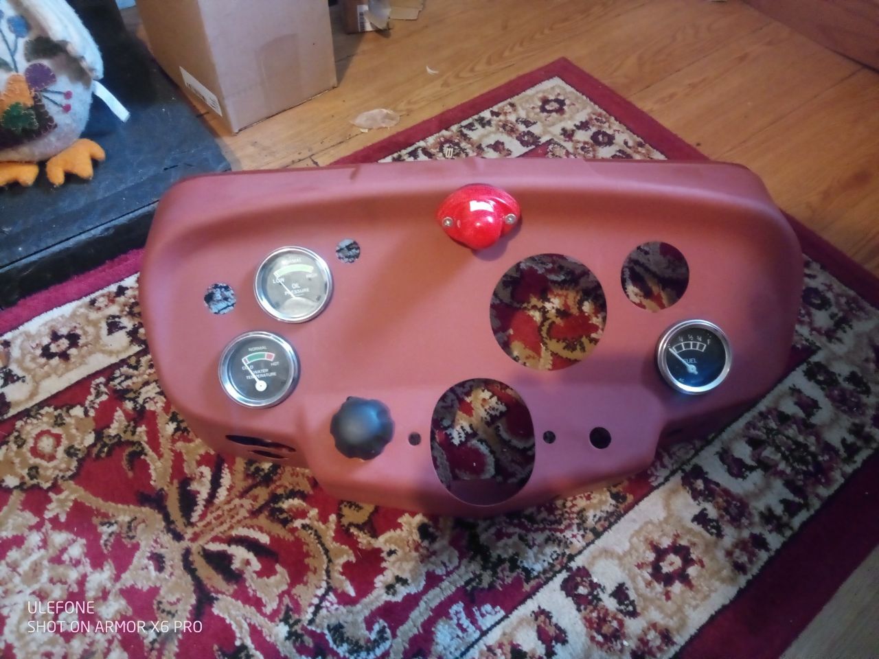

Purchasing bits and pieces were needed.... New dash almost completed non of the the original gauges worked and the dash was rotten so that warranted complete replacement.

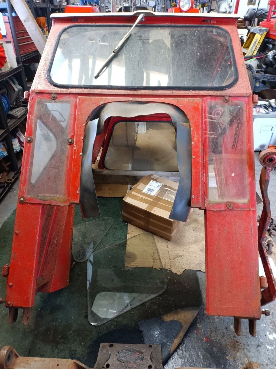

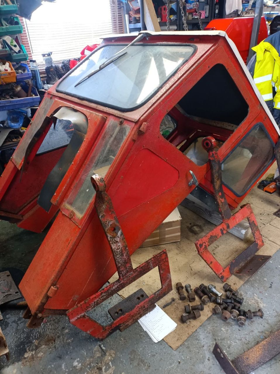

Removed the old rotten cab and cleaned out the fuel tank it was pretty clean to be fair but better to be safe than sorry.
