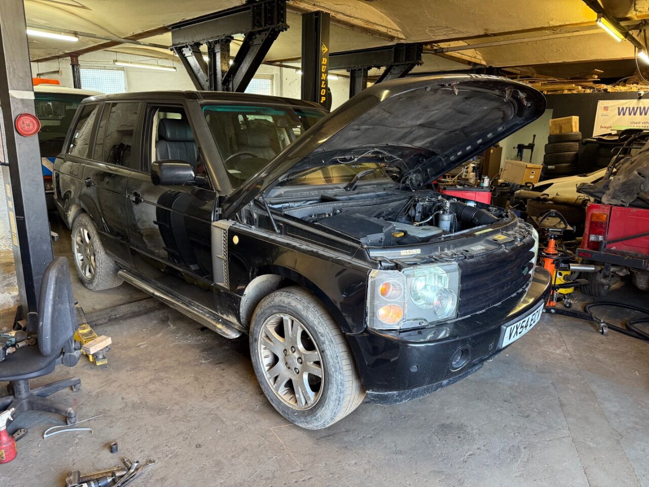

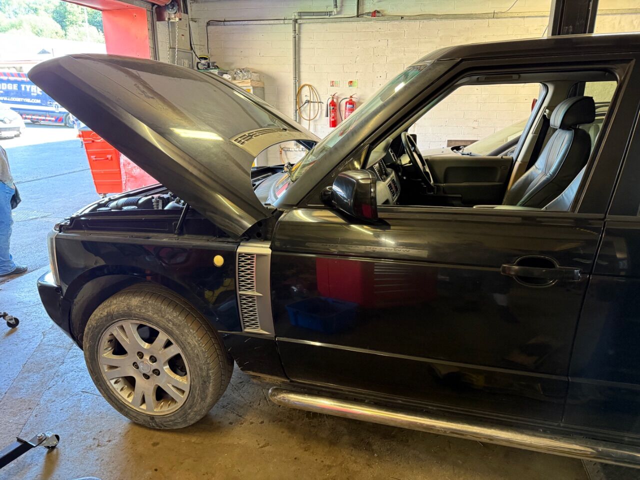

Having had my plans somewhat turned on their head, I decided to spend a hour swapping the front strut to see what I could do with the suspension.
Everything came apart nicely, the brake pads are like new as are the discs and the only issue I could find other than the blown airbag was a split boot on the drop link.
Anyway, the strut from the salvage car was fitted and everything bolted back up. Time to start it up and see if the suspension could figure itself out…
I’m going to call that a win of the highest magnitude. All the suspension lights have gone out and it happily goes up and down on request with no hesitation or weird noises.
An even bigger result is that moving it backwards and forwards now is devoid of the knocking from the back end. Presumably, the rear CV joints were beyond their designed angle with the suspension being so out of kilter and now it’s riding at the same height front and rear, everything is happy.
Whilst I had the bonnet open to replace the strut, I checked the levels and everything is spot on with a recent fuel filter and nice clean oil. Also, the battery is a nearly new Bosch silver thing with the Tayna label still attached so I’ve left that on a trickle charge as I’m away for work now until the weekend.

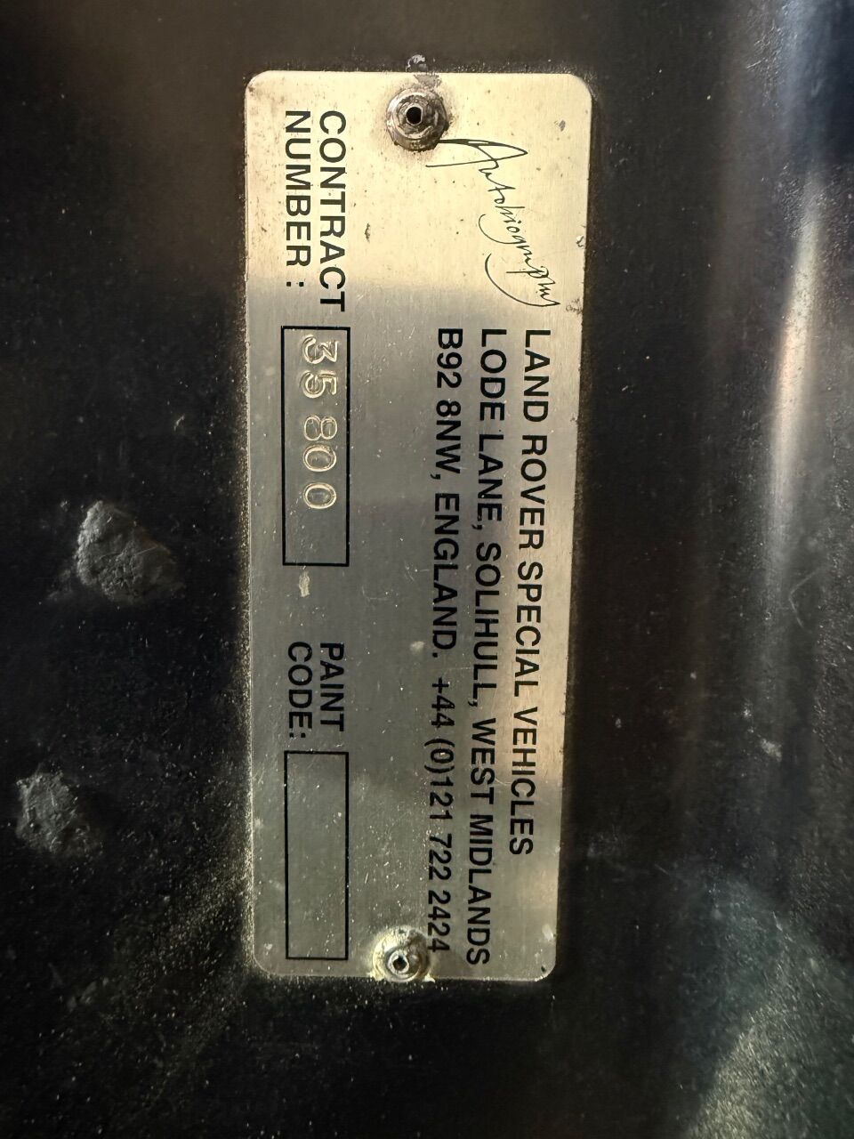

Whilst I was under the bonnet, something else caught my eye…as it’s just listed as a Vogue SE on the logbook, I assumed the Autobiography badge on the tailgate was stuck on by a previous keeper but apparently not?
I’m not sure it means a great deal but it goes some way to explain the Xenon lights which are unusual on a early car such as this.

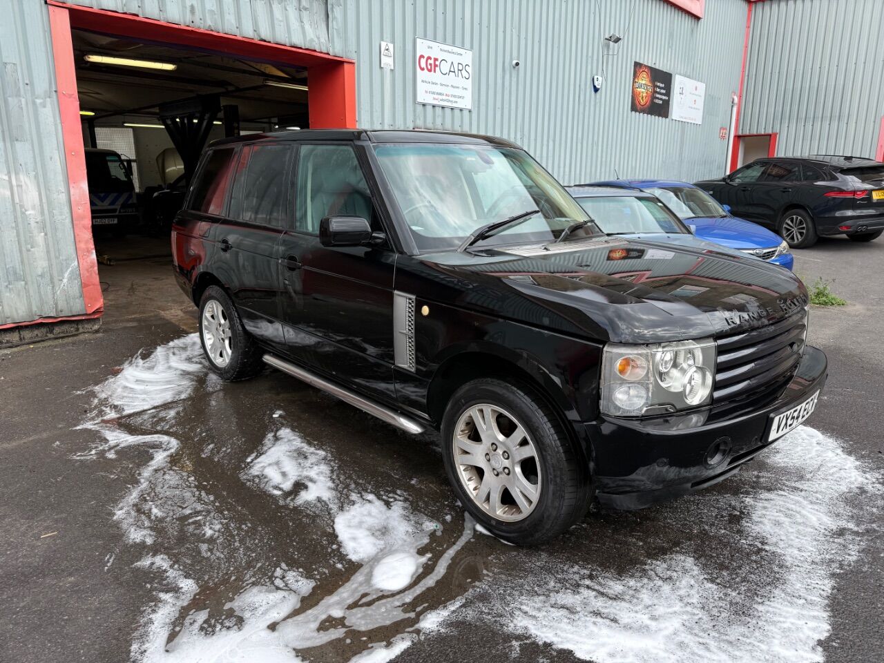

Having been away all week with work, it was with some trepidation that I opened up the workshop this morning, fully expecting the scrap TD6 to be sat on its bump stops with a flat battery…
My fears were completely unfounded, though. Having sat for seven days, it was exactly as I left it last Monday afternoon. The engine fired into life quickly enough, although a new fuel filter and/or glow plugs may be of value as it took a couple of turns.

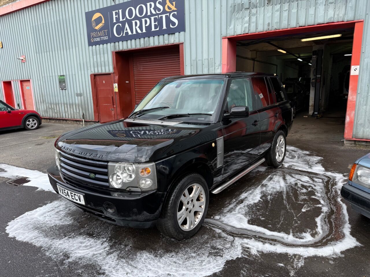

It was then outside for a quick wash…
…which has resulted in pretty presentable paint work, considering it’s lived on a farm for the last few years!
The next job is a quick road test to make sure the gearbox is doing as it should, then it’s going to have to be parked up for a week or two whilst I get a few more pressing jobs completed.
Going forwards, it can go to be tested for the first time in a couple of years then, assuming everything is ok, it’s going to get all the tatty bits replaced with the less tatty bits on the salvage SC and then it can be the winter runaround and towing bitch!

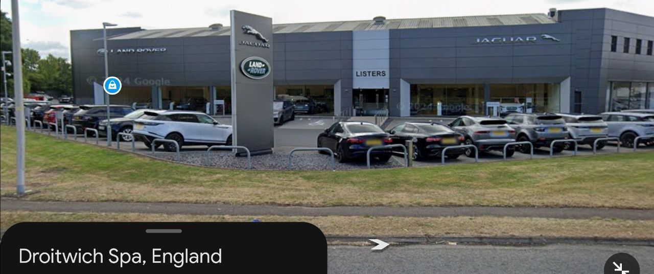

10 hours ago, NorthernMonkey said:
VX54 Indicates that it was registered in Worcestershire. Likely this place:
Which is about 5 mins from my place of work.
It’s still got the dealer plates on it…I’ll have a look on Wednesday when I’m back in the garage!
Scratch that, I’ve just zoomed into the number plate picture…it was Droitwich Land Rover which I presume was an earlier name of that very place 👍
