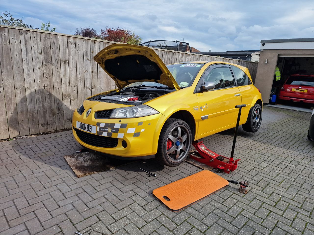

With a Spa Francorchamps trackday coming up in the next few weeks i made an effort to get it jacked up and checked over last week.
Small list to do.
1. Steering rack bush on passenger side. To be fair this had developed a little bit of play before Anglesey, but time was not on my side to change it. Its pretty minor but will do it.
2. Both rear wheel bearings have developed minor play. This pains me as the discs and bearings were changed for quality snr before Anglesey and torqued to the correct spec of 220nm. It could be due to the semi slicks and extra load on the bearings, but this will be the 3rd passenger side and 2nd drivers side rear bearing swap its had in my ownership. Ive fitted tons of bearings with success so its not a technique issue, and stub axles look/measure fine.
I went a bit tighter on rear hub nut torque yesterday which took the play up to a degree but looks like ill be changing them.
Discussed this with people i trust and its apparant that the quality control on snr has slipped/bad batches. As bad as the usual chinese crap.
Apart from the above, everything else seems good. Half days work at worst for the minor jobs.
Whilst on the jack, i changed the oil for fresh valvoline synthpower 5/40 and purflux filter.

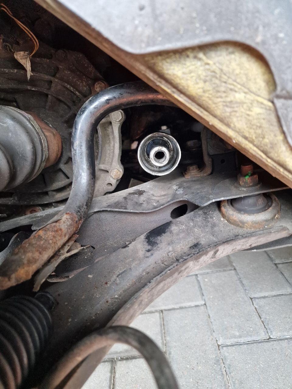

Changed the steering rack bush on the r26 on  Saturday, easy yet fiddly to do. Its not my first go as done the one on the blue 225 several years ago.
All come apart easily. Tierod tool to remove inner.
Inner tie rod was still in great nick with no play, which is a good thing as its only done around 10 thousand miles and now £100 a side from Ren for new.
Old bush in situ.
New bush fitted. 2 person job as its a bit of a nightmare to get back in..needs a bit of persuasion. Loads of silicone grease to lube.
The bit of play in that area is now gone. Steering was a little stiff initially but a good run out lastnight sorted that out.

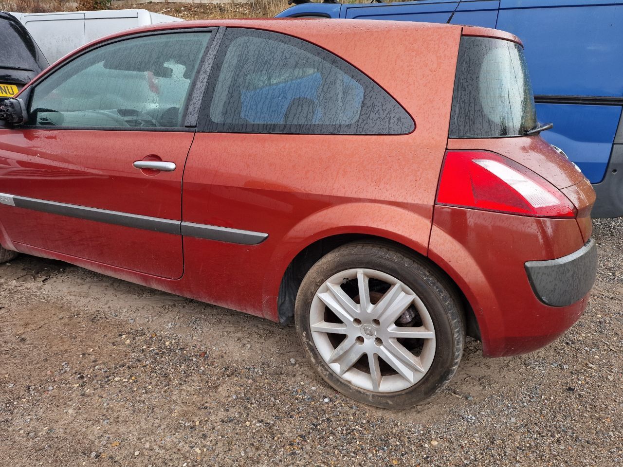

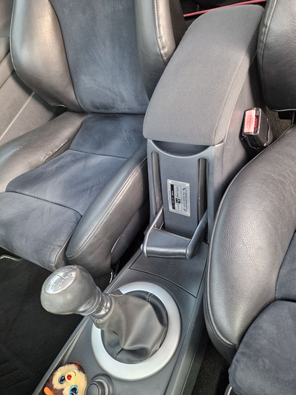

Bought a centre console with cloth armrest a while back to replace the povo r26 centre console.
Unfortunately it was not complete, and was missing the gearstick surround, obd cover etc. I thought the non armrest centre console parts would fit but totally different so put it to one side.
Found the right parts at u pull it a few weeks ago and finally got round to fitting today, and give it a quick hoover out.
20251010_162629.jpg.b52a2488489adc6b7dc94b859175a47f.jpg20251010_162654.jpg.f70cdc8cfc6ea576d6e134a558c0ced3.jpg
Refitted the r26 plaque to the new centre console.
20251010_162635.jpg.a04fed7256081be62880965066609e66.jpg20251010_162512.jpg.c3c5f507f4235ba31a47812ade0e6967.jpg
Small upgrade. Armrest is standard fit on our ph1 225, no idea why ren made the r26 so povo spec.

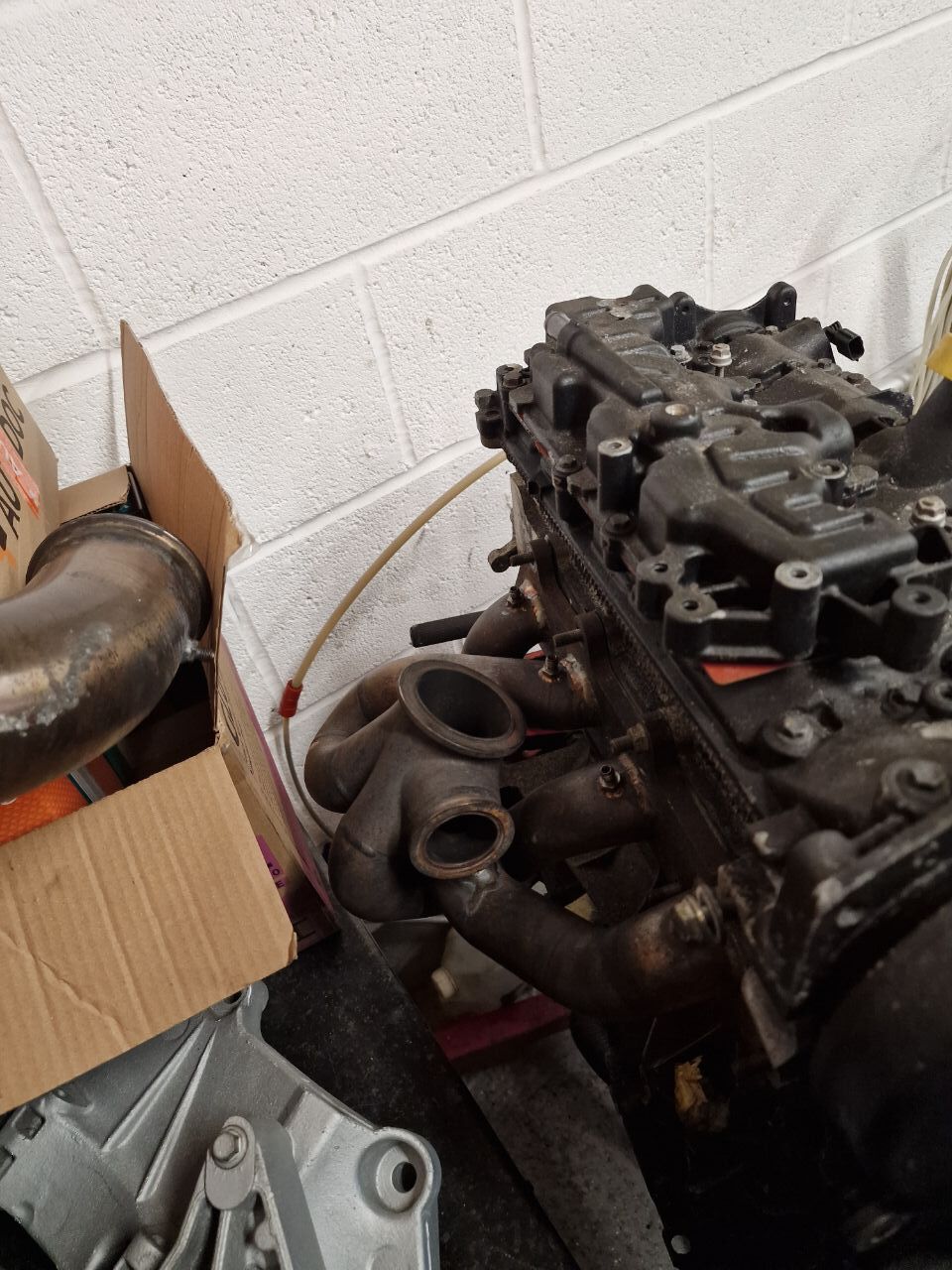

Also been mocking uo my Nortech manifold on my spare engine. After Spa ill start progressing with this as the manifold and g25 550 turbo setup are destined for the kangoo.
Thanks for reading!!

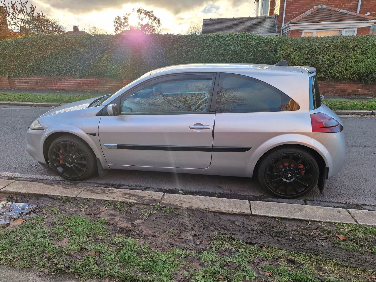

Updates.

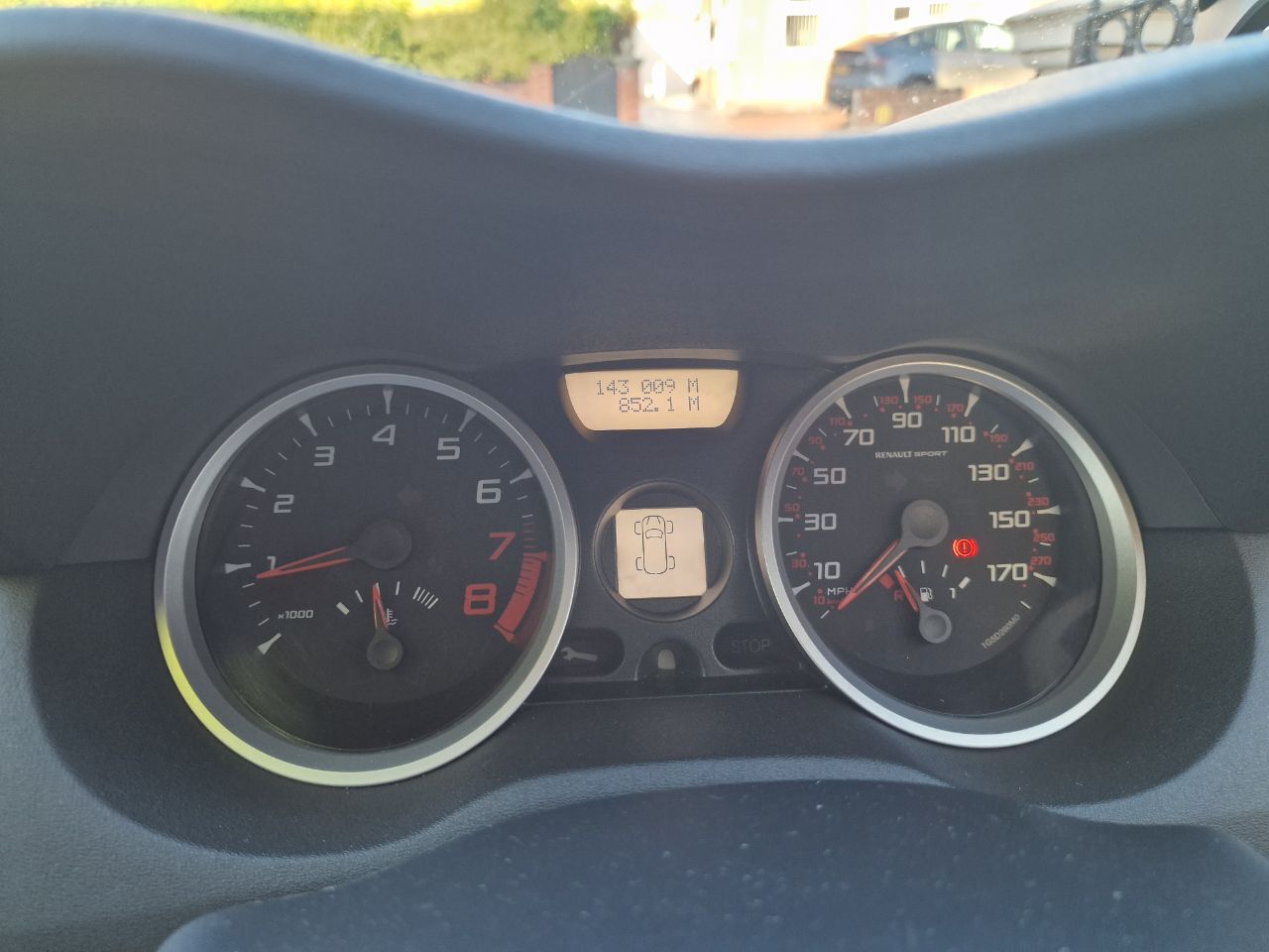

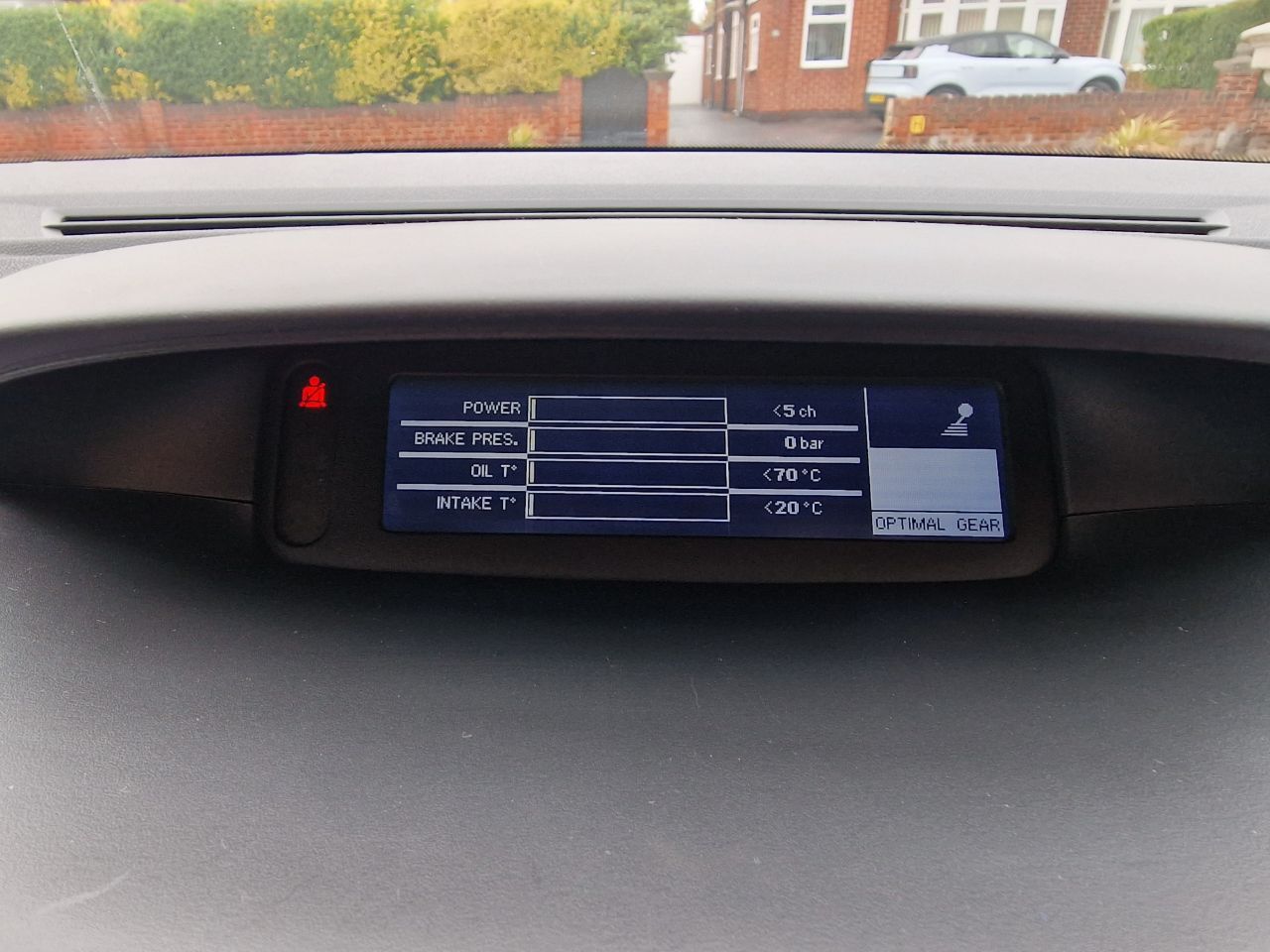

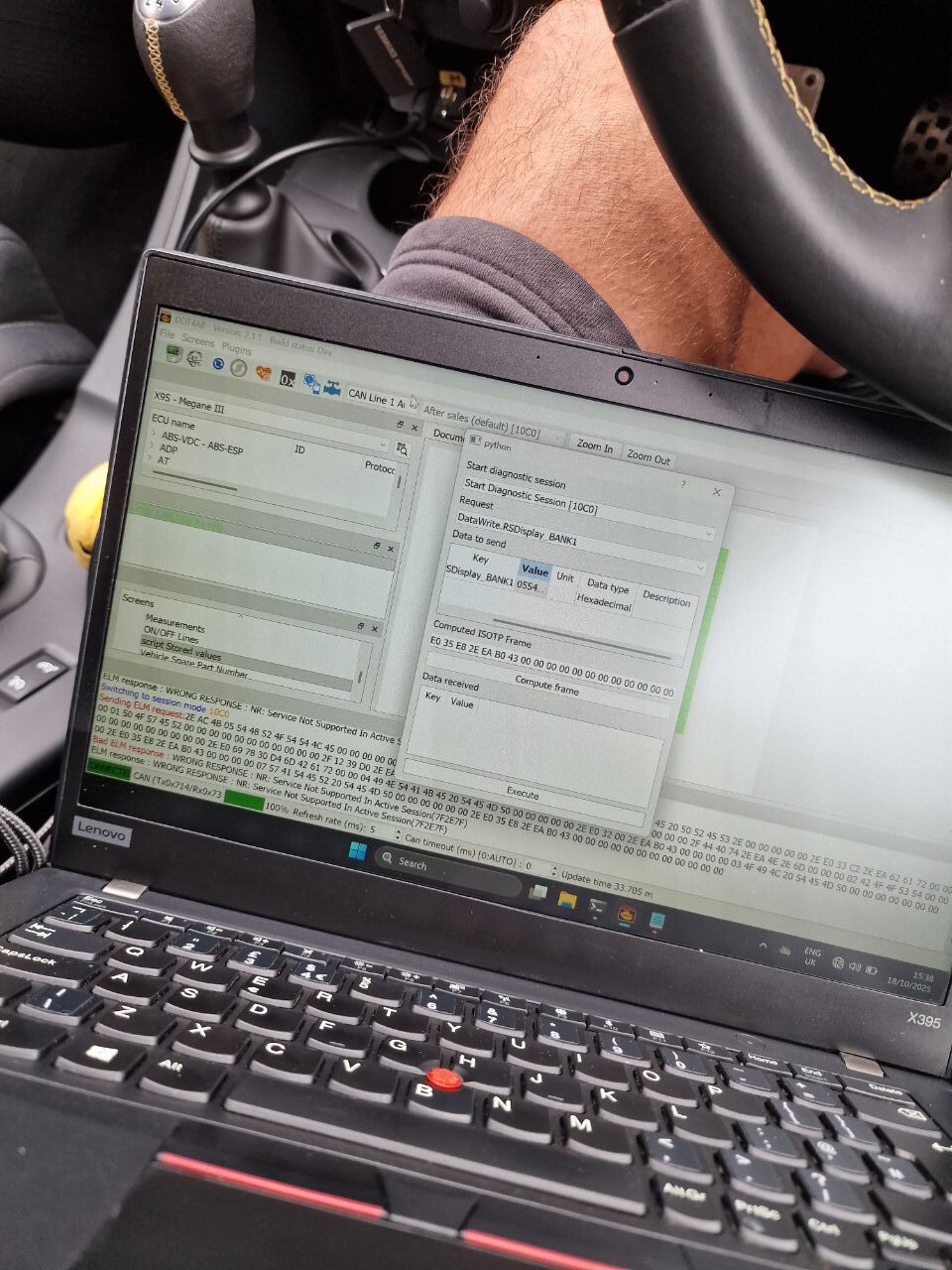

Had the megane 250 out at the weekend to custom code the rs monitor v1. Massive thanks to Turborenault members for doing the research Cossie1 for sharing the information and Mart for doing the business on the custom coding.
I modified a proscan Elm327 cable with switchable can h/can m so i could access the bic module via can multimedia to code.
I then spent all week scratching my head trying to get Ddt4all to work, using the megane r26 to test.
Im no stranger to getting obscure diagnostic programs to work but after installing 4x different versions, none seemed to work right on mk2 meg being honest, very unstable and not confidence inspiring. I even upgraded my diagnostic laptop to a modern lenovo thinkpad which made little difference to how the software ran.
New diag laptop representing.20251018_172935.jpg.e7dc770200304abaf693349ab77288ff.jpg
I was going to use Renolink and modified an obd splitter lead to plug in my obdsx cable, however when i tried Ddt4all on the mk3 250 on sat, it worked absolutely fine which was suprising allowing the script to be written without issue.
Original screens on rs monitor below, this was a factory fitted option from new on ours. Basically a load of crap data apart from boost, ait and oil temp which were spread over 2 different pages.
Wrote the ecu with the custom coding using Ddt4all.
We have filled the first page with the useless info. This is the 'Pub' page. I mean who actually looks at brake pressure?!😅
2nd page has the decent data thats worth looking at. The 'Drivers' page.
All the good data on one page, Boost (recalibrated to 2000mbar allow higher readings to suit current setup), Intake temp (now starts from 0-80deg, Oil temp and Water temp both scaled so optimal running temps in the middle of the gauge. Its actually worth using the rs monitor now to keep an eye on things, like an onboard scangauge. All works great, its a nice update.
Give it a quick run out to test all good. Needs a wash, wheels are pitted. Next weekends job.

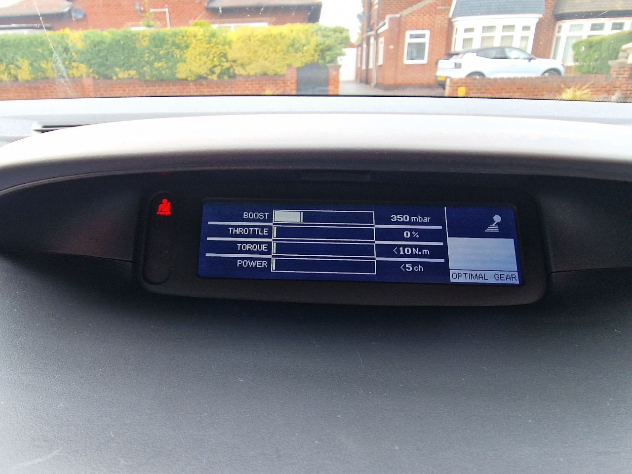

With this done i done some more coding to the rs monitor.
The boost gauge was still going to the top and we had adjusted it to 1800mbar assuming it was using gauge pressure, but all it showed was 1800> on full boost
Note peak reading line maxing out the bar graph.
As i had been logging with Rstuner im used to reading the data in Map absolute instead of gauge pressure. Im quite used to this due to reading standalone ecu map sensor data.
To explain very roughly how this works as it can be confusing after using gauge pressure.
1000mbar on map pressure is "absolute" - its including the vacuum which starts at 0mbar- 1000mbar. You see 1000ish mbar at sea level with engine off (atmospheric)
0mbar of map pressure = full vacuum
1000mbar of map pressure = atmospheric 0psi
2000mbar of map pressure = 15psi of boost
1000mbar gauge pressure is 1000mbar of boost above the atmospheric mark of "0mbar"
-1000mbar of gauge pressure is full vacuum
0mbar of gauge pressure = atmospheric 0mbar.
1000mbar of gauge pressure = 15psi of boost
Some ecu's work in map pressure - some ecu's work in gauge pressure depending on setup. Renaults of this era always use map absolute as above.
Anyway back to the point
My rsmonitor boost gauge seems to read in Map Absolute compared to later ones reading in gauge, there is no minus readings on mine. So it was always exceeding upper range as we needed 3000mbar to show full range of map sensor readings as peak on Rstuner is 2600mbar.
So with this in mind i adjusted the upper limit to 2800mbar to give slight headroom. Using a convertor to work decimal to hex with 1200 ofset (winging it being honest, ive just learned how to reverse engineer the hex code a bit)20251025_142120.jpg.d57a7efc3cbb8ba0aa65c85291515255.jpg
New code uploaded with ddt4all.
Tested and working with readings not maxing out the bar. Note peak line just under full range.
Used Rstuner to confirm readings were good when on the move. All works fine, Rs monitor reading is rounded to nearest 50 (i.e. 2500, 2550 mbar) which i might change to 10 or 1, if refresh/sample is quick enough..i think renault used 50 rounding to keep it clean.
Anyway works great. Pretty pleased with that!

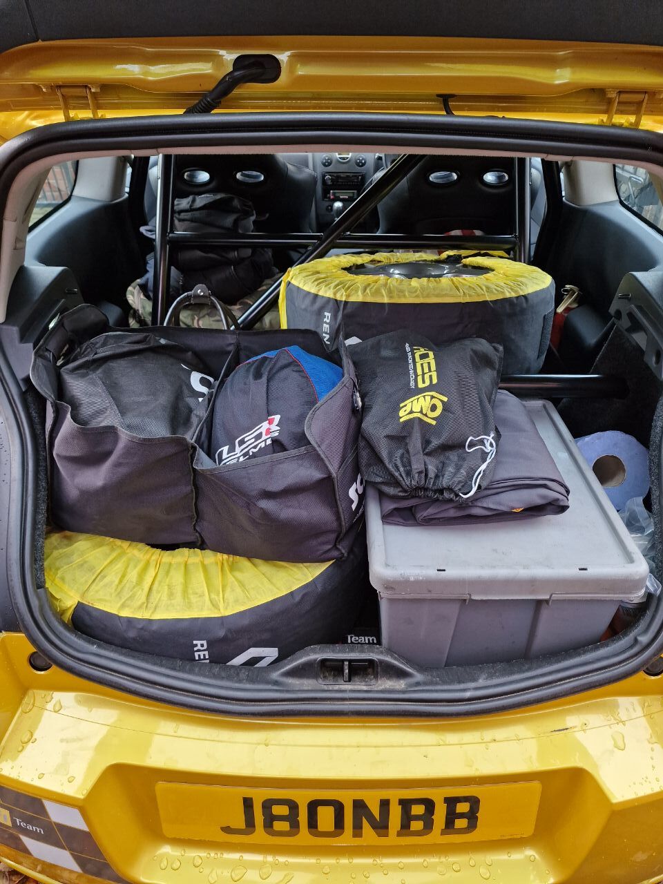

Spa and Nurbugring trip done!
Set off Wed afternoon, short trip to Newcastle for the overnight ferry to Amsterdam.
Pre trip pic.
Looks low as on its arse with tools, 4x track wheels etc.
Arrive at the port.
18 Hour prison.

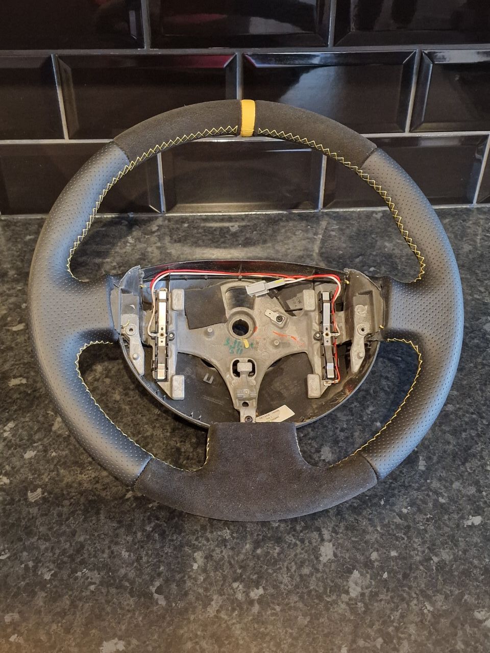

Fitted a freshly retrimmed steering wheel to the megane r26 from Otto Retrims. Ive had this one done in alcantara and perforated nappa with yellow stitching and band. 20251122_093325.jpg.2438d9c742db4b541950bf439fa49124.jpg
Quality is excellent as usual and nice change from the full leather one i had previously.

Hit the switch last week on a turbo for the Kangoo compact, and a nice new Pulsar g25 660 arrived yesterday.
20251125_154533.jpg.10d965f66d07fc9509eda14603de7198.jpg20251125_154903.jpg.0e0ba7b7ed1e58552f2c93b633bd7c58.jpg20251125_154859.jpg.cc2d639040de630cc08b7a0031d3c87a.jpg
Still need to source a couple of small items but almost ready to fit. 500hp or bust.

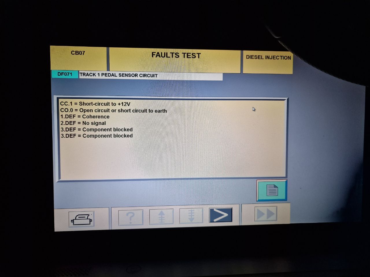

Mrs was out in the blue clio dci on Friday and i needed to go out. Id normally jump in the r26 but its got no gearknob on it as its at the trimmers. Rest are sorn apart from the orange clio dci which is in limp. Best fix it eh!?
Usual fault stored when scanned with clip.
20251128_170826.jpg.fb2af73754ace40fe2a09eba47ea5dfe.jpg20251128_170840.jpg.85eaeee6ef96248a6890c4a7f7b60e59.jpgI bought a new accelerator pedal to fit so had the parts in stock, so should be an easy fix. Could i f**k get the pedal/bar off to swap over, my small puller has went awol so give up before it all broke.
With the defective pedal on the bench, i stripped the cover off to see if repairable. Its 5x posi screws and the cover comes off. The tracks on each potentiometer appeared to be worn but not beyond serviceable. I levered the contacts slightly to add more tension, and cleaned everything up and refitted the cover.
Cycled the pedal through a few presses with ign on and all good. Done 30mile or so yesterday and no limp, appears to be fixed. Simple repair, will see if it lasts.

The blue clio dci seemed a bit slower and black smokey recently, bit intermittent as sometimes fine. Not sure if it was actually slower or felt slow after a week of driving the megane r26 fast as fcuk everywhere at Spa/Germany, but yeah thought it was worth a quick look at.
Stuck torque on it to look at live data and noted it was making boost ok but bit lazy getting there. Basically when i changed the turbo a while back, i noted boost pressure was a little lower but never done anything about it as its no rocketship.
Anyway had a dry morning so got the smoke kit out to leak test, just incase any boost leaks had developed.
The boost circuit on dci65 is super simple with no intercooler. Smoked it up and no leaks at all, air tight with the crankcase smoking up as the rings naturally let a bit by even with good compression.

Some of you might have noticed that the passenger side arch on my yellow megane r26 is rusty. Mk2 meganes dont rust?! They do when they have had a new rear qtr fitted badly in the past and its full of bog.
Ive been looking for a solution for ages. I found a full rear qtr at not alot of fcuking money, but problem is the inner arch panel is also rusty. This will require repair or replacement and its nla from renault as expected.
With the above in mind i thought the easy solution would be buying another bog standard spec megane mk2 3 door to cut a qtr panel off as loads about and cheap, well a lot cheaper than the rs models. Ok'd the repair with a good local bodyshop who are willing to take it on before looking.
Started looking on FB, Gumtree etc for a full car to buy to cut up. I looked at a silver 08 reg one local and it had a dent/scrape across the arch but no rust, rest of the car was scrap. Being fussy i passed on it, regrets as would have been perfect with a bit of work.
I then kept an eye on facebook market place. Mostly overpriced bags of shite with dented to fuck rear qtrs, rust and/or high priced.
Went to Lincoln to view one which looked good initially from pics. 20250902_140538.jpg.cec156ded9bb23acd175d65b53c56b2b.jpgGot underneath the car and rust🫠car was a non runner so with recovery and sale price, i would have been around £600. Not good enough to use.20250902_140550.jpg.2b526ca6f09f4ab66027de0ab43c173b.jpg
From what ive viewed, ive come to the conclusion whatever mk2 megane 3 door base spec that are still on the road are mostly piles of shite, prob due to age.
Also tried breakers. Most are unwilling to let you cut the qtr or take the shell to cut. Been messed about a bit as i had my name on a mint qtr panel on a breakers car but it got weighed in so give up on that one.
3 months worth of looking and nowt had come up which worked. Had the mrs looking for me and she spots a cheap 56reg silver megane 225 on Gumtree. Only down the road, fire the seller a message through the week asking if still up for sale and answer is yes. Price is a bit higher than i wanted to pay, so its got to have a good rear qtr and decent engine and gearbox to claw some money back from breaking it.
Arrange viewing for 12pm today. Get up, bit of food, diagnose blue clio, quick poo and out the door. Its sunny and dry for a change so go in the yellow megane r26.
The car is inHartlepool which is only 35mins or so away from me, and i know the area from working around there previously.
Arrive at the sellers house and the solver 225 is outside. Look at the rear qtr straight away ignoring the rest, looks spot on which im absolutely amazed at so im now interested.
Looked round the rest of the car having a laugh with the seller at a few bits. The advert was honest stating various issues including knackered front arm bushes etc, various electrics not working, handbrake fooked, clicky cv joints etc so i already know that its going to be a knacker. I accidently lock the drivers door on the keyless,  and it wont open from outside.
Note it looks like the car has ran through temu with loads of stick on shite. Open and close boot and numberplate light falls to bits. Open bonnet, engine is typically oily megane rs and it has a forge blow off valve. Try to shut bonnet and bonnet catch bounces so me and the seller have to free it off manually so it will close.
Fire it up, and engine sounds sweet. No warnings on dash or nothing, was expecting check injection or airbag lights at minimum.
Take it for a quick test run round the block. Seller says its been mapped and do note it does go pretty well with one wheel peel on damp roads/shit tyres and the essentials work ok, brakes, goes etc.
Go back and money changes hands, fire some temp insurance on it and set off on home journey. No pez shots as it had qtr of a tank in.
Drive home was rather uneventful. I couldnt be arsed trying to work the chinese spec crap double din stereo so opted for turbo noises. Nothing falls off, temp gauge solid on 1/4 like they all are etc. Brakes derust fast, brake pedal feels fine.
My mrs was following me in the yellow megane r26, so we have a little race down the local dual carriageway near home, megane rs vs megane rs. My yellow meg is 270hp and the seller claimed this was stg 1 with exaggerated 300hp, obviously not but can tell its been mapped as ive driven loads of megane rs over the years. The yellow meg pulled away from me, but not by a massive amount, taking a guess its probably around 250hp.
Anyway your probably thinking less talking bollox and get some pics up..this is what you get for sub £1000 megane 225.
20251130_142216.jpg.972ef560b62e3c6ae06fbe75fb97cbd8.jpg20251130_142208.jpg.a20a499b491b5a747aa82b2a7e216ad5.jpg20251130_142223.jpg.316ccb47e3c5d11729c5efa81bf7093b.jpg20251130_142203.jpg.fd244ab97ae93d520d26f534271b1861.jpg
Doesnt look too bad from a distance eh!? Tat all over and bodges.20251130_143335.jpg.45ae32626da550ec039e42c71b2523b9.jpg20251130_143337.jpg.d4a549aeaf1fcbc7d6e1404592e42060.jpg20251130_170256.jpg.351f86b0a84ad2fb841f23ba9a1d620e.jpg
Decent enough for the money, the engine seems pretty good and its rot free, it does seem a little bit of a shame to chop it up. But realistically, it needs fuck loads of work to make it good. I reckon it wouldneed £1-2k to put it 'right'.
Chop chop soon, engine and box out and a few bits off and the rest is going over the bridge.
