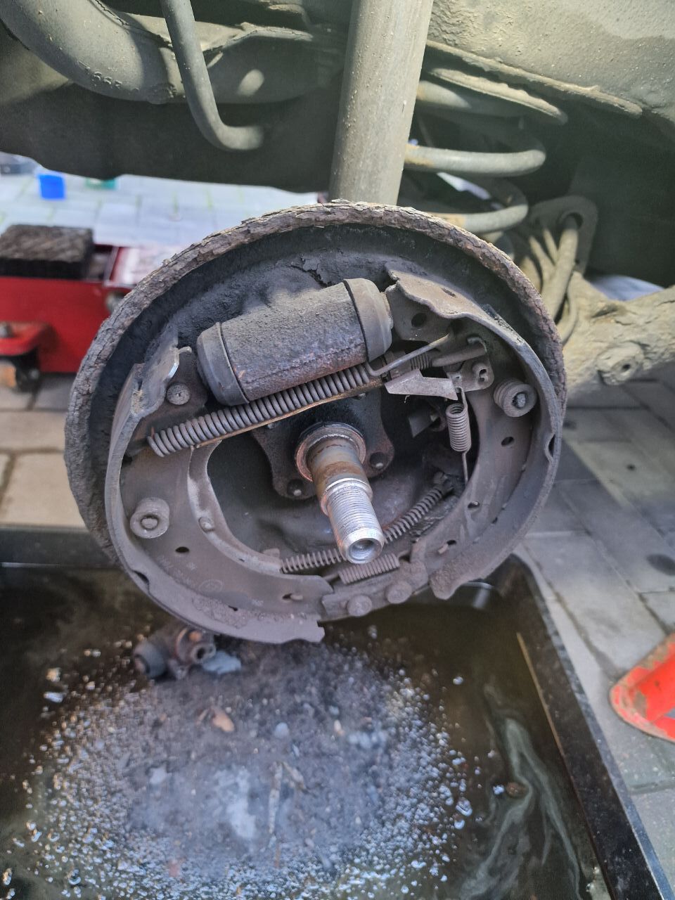

Blue clio dci passenger rear drum brake started making a right squealing the other day. Brake pedal was still ok ish but not as sharp as it had been and handbrake was a bit w**k.
This is usually due to one of the below issues as i have been there before on several different cars over the last 25 years.
Shoes worn out - were thin ish last time i adjusted.
Shoes need adjusting and drum cleaning.
Rear brake cylinder starting to leak, causing dust to clog up, contaminating the shoes and make loads of noise.
With the brake shoes looking thin last time i adjusted them, i had a set in stock which i stuck in a recent autodoc order, with 2x new cylinders and fitting kit. Also ordered 2x new rear drums. Full monty.
Weather not bad this afternoon, stripped down fast. Gear all over.20251206_145622.jpg.38810a97a5106ce5ca16c27dafc60e83.jpg
Passenger side drum examined, shoes indeed low but not on metal. Noise was due to a leaking brake cylinder and adjustment required, noted shoes looked a bit contaminated. On initial inspection brake cylinder looked ok, but pop the dust seal off and it was full of brake fluid. Pulled it off easy, brake pipe undone and new cyl and shoes on.
All new.
Went to fit the new drum and it was tight on the backing plate, rubbing as crap aftermarket. This could have been resolved by removing rust off the backing plate and a small chamfer, but then compared abs rings and 10mm smaller in diameter, so no good.
With this fail i measured the original drum. The drum was just under the max tolerance 203mm recorded vs 204mm max so were ok to reuse once again. They needed a clean up, delipped the drum, give the outer a clean up with grinder on knotted wheel and painted in vht black. This was to try and stop the shoes sticking in wet weather, as i believe the drums let a bit of water in due to porosity in the casting. Hopefully a bit of paint might seal.
Shoes adjusted, drum refitted and onto drivers side. Drivers side was OK and still in adjustment but as per brakes always do in pairs. Stuck a new cylinder in as they usually fail shortly after fitting new shoes to take the piss.
Before
Drum got the same clean and paint treatment as above. Easy yet s**t job, i hate the springs on the shoes.
With that part done, i pressure bled the brakes all round, i dont think its been done for 50k or so, the fluid that came out looked pretty grim.20251206_161333.jpg.e0249739c1f7089503989ba12445c453.jpg
Brake pedal nice and solid/sharp, and handbrake back to 4x clicks again. Normal service resumed.

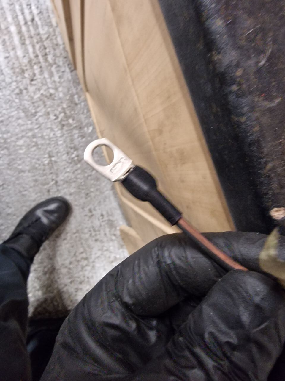

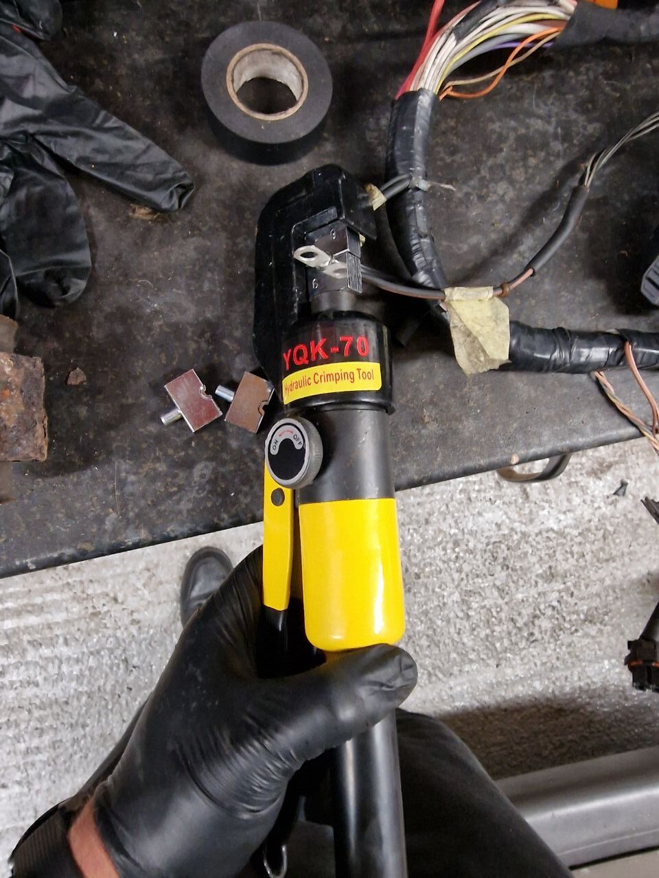

Done a small wiring repair the other day. I needed to renew a ring terminal and dug out my chinese spec hydraulic wire crimp tools. They cost next to nowt around Β£25 from memory and work mega on thicker gauge wiring.
20251215_162456.jpg.eb8402fe0e586c312bdc20a41436d0c7.jpg20251215_161916.jpg.2f93ba21bac4665d1de701ac178ba858.jpg
Bit of dual wall heatshrink and done. From previous testing on old wirinf, the wire breaks before the join. So if you want reliability these are the way forward on uninsulated connectors.20251215_162117.jpg.b9d09bf28898490ee761dbb99e324987.jpg

2 hours ago, bigfella2 said:
Have you got a link to one of those crimpers Jon? Looks great.
Still cheap as chipsΒ https://ebay.us/m/nwJkIx
Also worth investing in a cheap set of cable shears if doing heavy stuff.
They are mega for battery cables and heavy stuff. I done 0 gauge cable on my cliotrophy for the battery relocation in the boot.

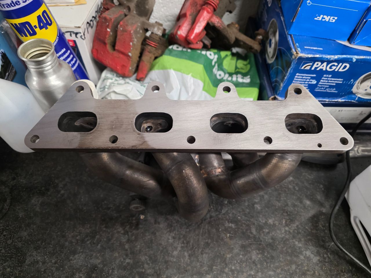

The nortech manifold for the g25 turbo conversion for the Kangoo has been a right fcuk on. I was sold it as repaired/good nick and fairly priced to suit. In the back of my head i knew this would need work but always stay positive eh?
Anyway seller royally f***s me about and it arrives 8 weeks later. As soon as i opened the box i could see the flange was a country mile out with 3mm bow at both ends. Seller obviously oblivious to this.
It was quite obvious that the flange had not been clamped when repaired and its gone on the piss with heat. In hindsight i should have fucked it right off at that point and bought new (still an option) but anyway proceeded to attempt to put it right.
Steps to put it right if anybody has similar issues if interested.
As seen the flange was so far out that if cnc'd or milled flat the flange would be too thin in the centre. With this in mind, it was put it in the press and the flange was supported both ends and the middle was pressed flat. This worked well with it slightly pressed over flat approx 0.5mm so it would pull in. As sods law goes, its never straightforward and welds cracked on runners 1 & 4 at the flange so ended up having that tig welded and added new 1/8 npt bosses for egt probes, as it had unknown ones fitted.
The mainfold at this point was useable but rocked a little when fitted, and when torquing up to the head the bolts were under a bit of tension in the centre to pull it in. I.e. tighten inner nuts and outer need nipping again etc. It was acceptable but needed to be closer.
With this in mind i looked into getting it milled flat. With the manifold shape its not easy to clamp and finding anybody to attempt it is pretty difficult from asking round.
Next option was belt linish the flange flat. This is accepted as close enough for trueing up slightly warped exhaust manifolds after fabrication. Problem is finding a machine shop with a large one, my local fabricators all had ones which were too small for the job. Almost bought a 2nd hand large 3 phase belt linisher for the job but no room for stuff like that for a one off.
Fabricator said spend a couple of hours and hand finish it. I dont have an engineers plate for a flat surface, so going back to my joinery days, i know glass is always flat as fook and available cheap.
I picked up 2x 900 x 300 x 12mm thick toughened pieces of glass off fb marketplace for Β£5. Can of impact adhesive and 80grit sandpaper stuck on.20260117_152252.jpg.0ab899bf9af03b3cdfc54f26e8bf9b3a.jpg
Simply push forwards and backwards. The design of the manifold makes it easy as its like using a smoothing plane which i have loads of experience from my joinery days. After 30 mins or so you could see it was starting to true up nicely.20260117_145622.jpg.862f96521a9d43dff7e8350d34caa0c8.jpg
1 hour later
After 2 hours it was almost fully done. Ran out of time being honest or would have went the full monty.
Prob need another hours worth of sanding to get it all the way. As it is, its flat as fook when checked with steel ruler, and bolts up to the head with no issues. Deemed good enough for farmwork and the crush of the gasket will get the rest.
Ballache but doable. If manifold gives any issues when fitted ill buy new. We will see..
