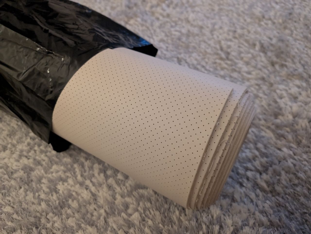

Instead I went with off white perforated vinyl. I had this in my last 1100 and I really liked it. I don't believe that common on British cars but German cars like VW Beetles, 911 and such used it. So in period.
4 metres of the stuff posted with two cans of high temperature glue came in at £115. A fair bit more than I wanted to spend but hoped it would turn out alright. I did have a bit of dread when it arrived that it might be too much.

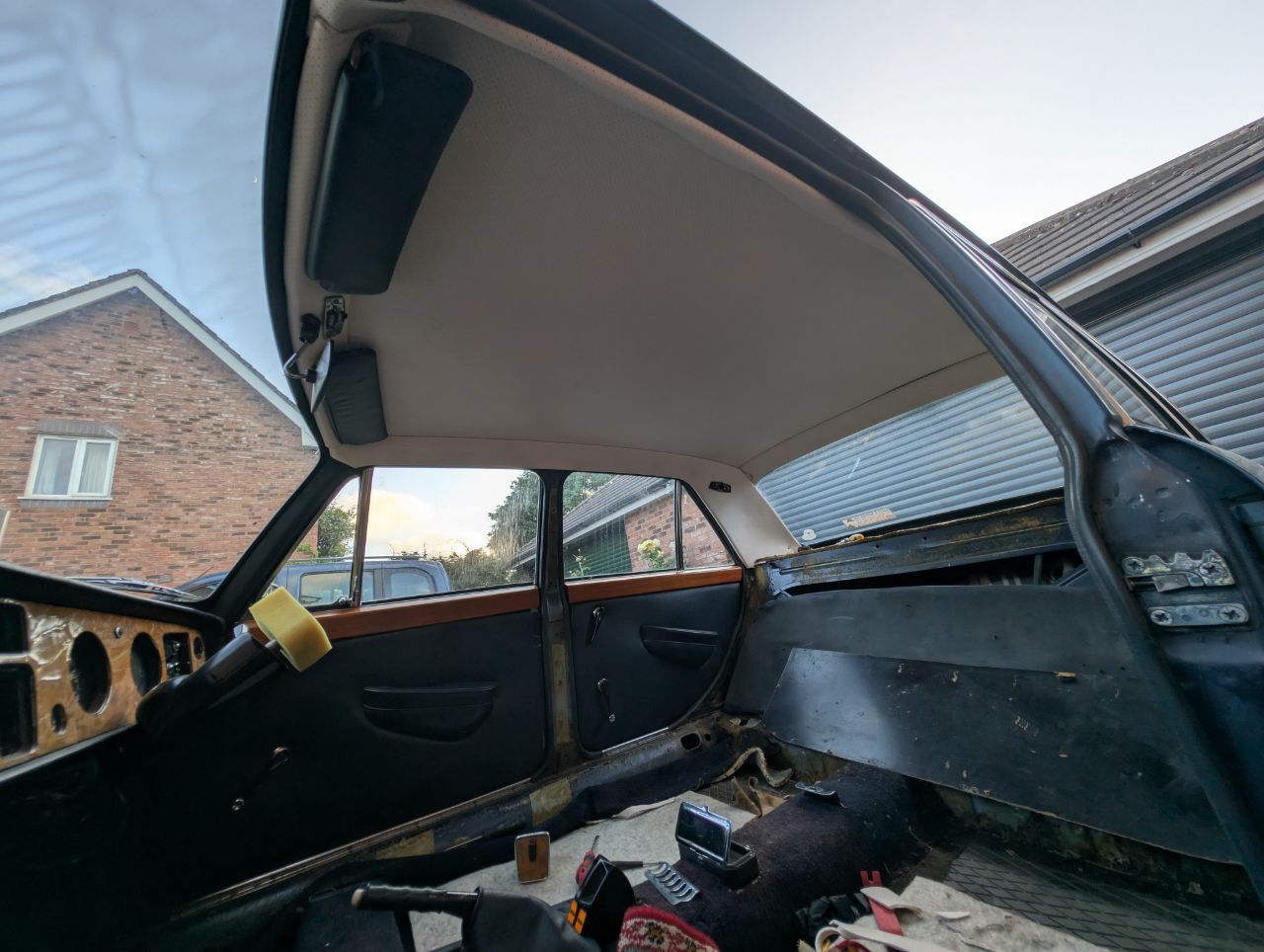

First problem was it was cut too large compared to the old backing piece. I traced it around old onto this (with the fabric on) and cut it smaller. Not ideal as I had to cut some of the fold over but still some left. Plus any edges are hidden by other side trims.
Then once in place, I bent the panel in to fit on the edges and then popped up. It required further tweaking on the back edge with a multi-tool to make it fit.

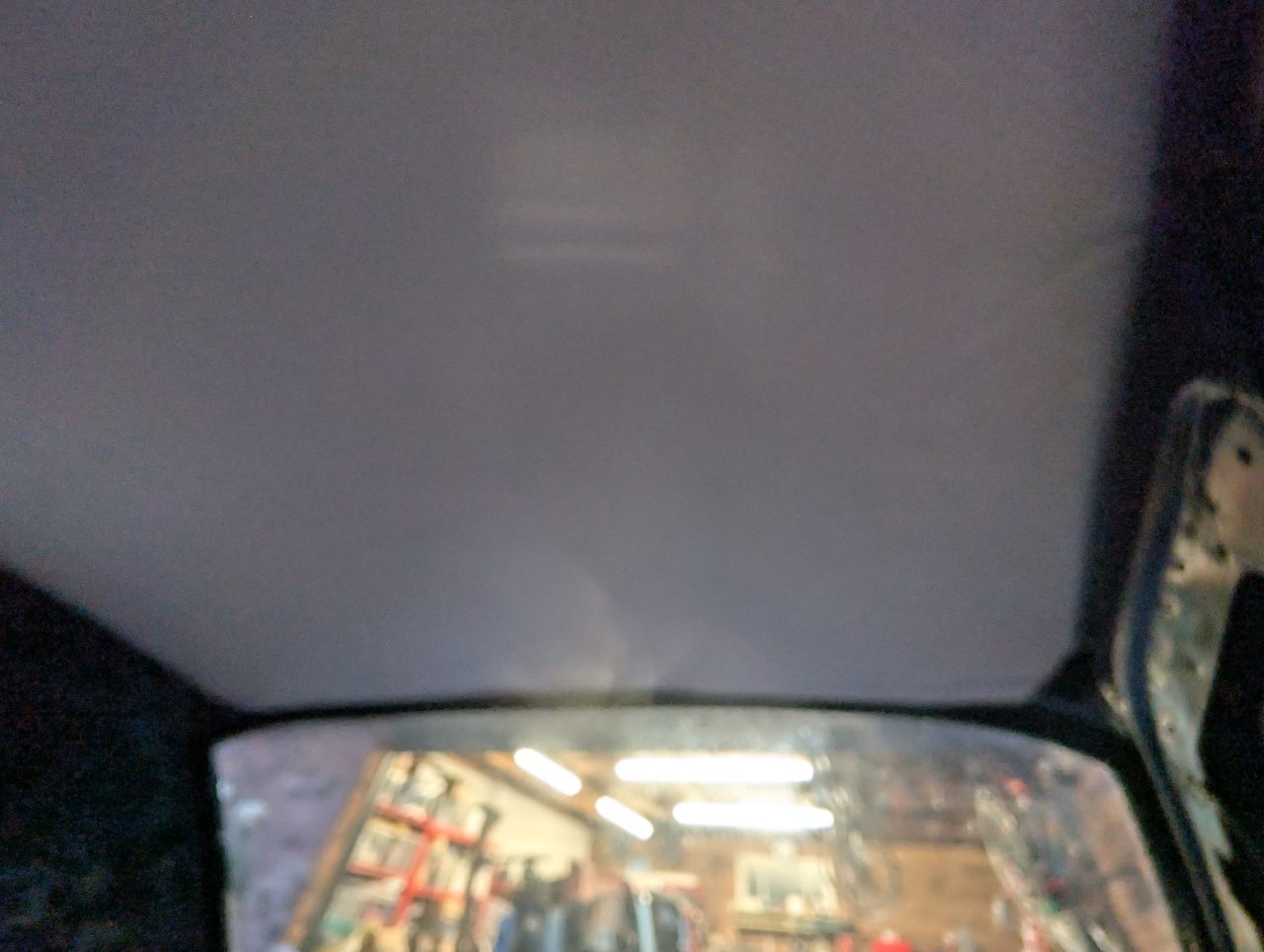

Anyway I got it in. Have a blurred picture that I took late in the evening and was fed up enough to not double check it wasn't looking like it was taken by a potato.
The next day Mrs SiC, having very much proven herself to be far better at this stuff than me, did the other trim pieces.
You can see the concentration on her face as I told her there was no spare material for cockups!

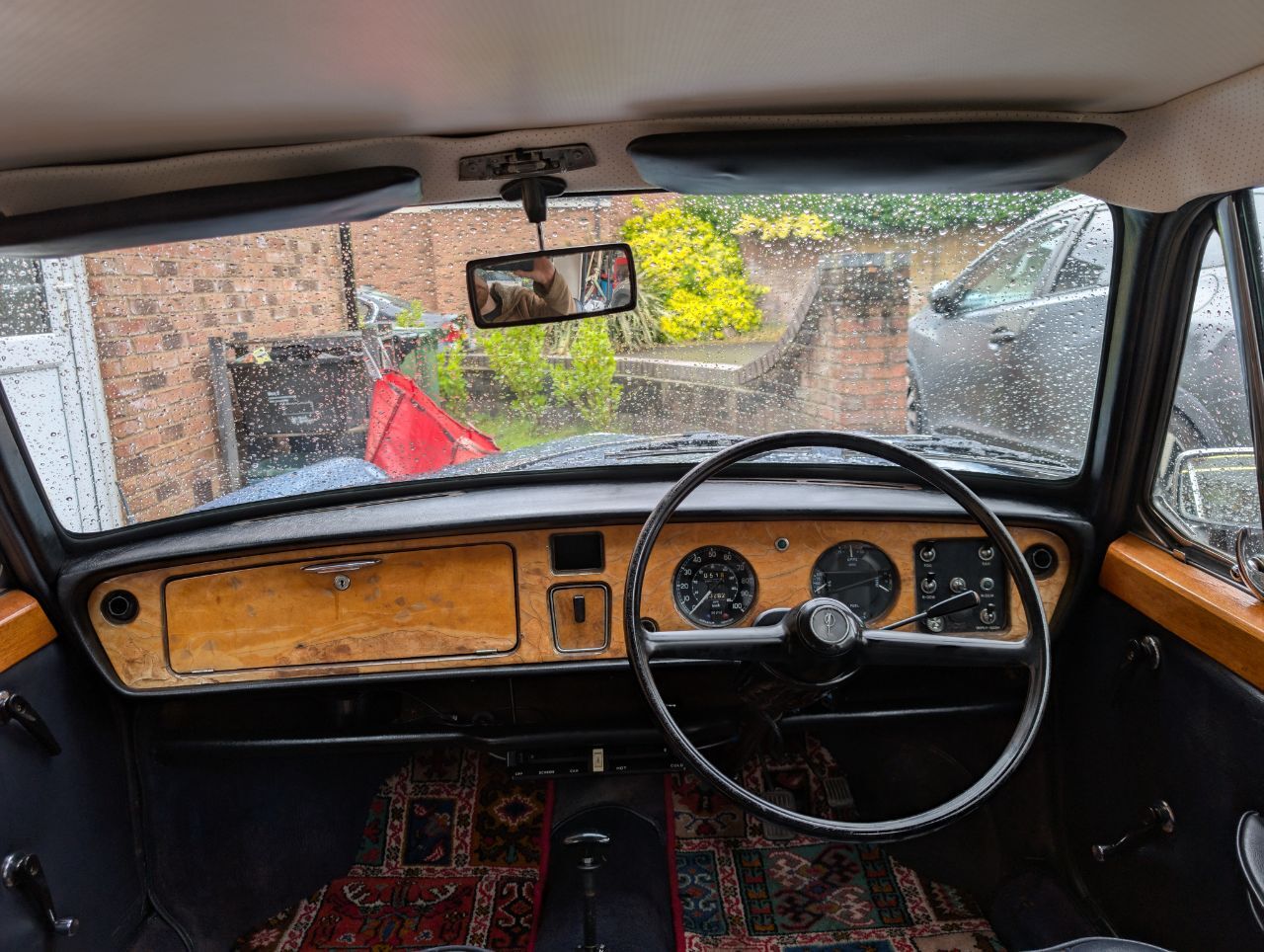

All that was fitted. The finished result!

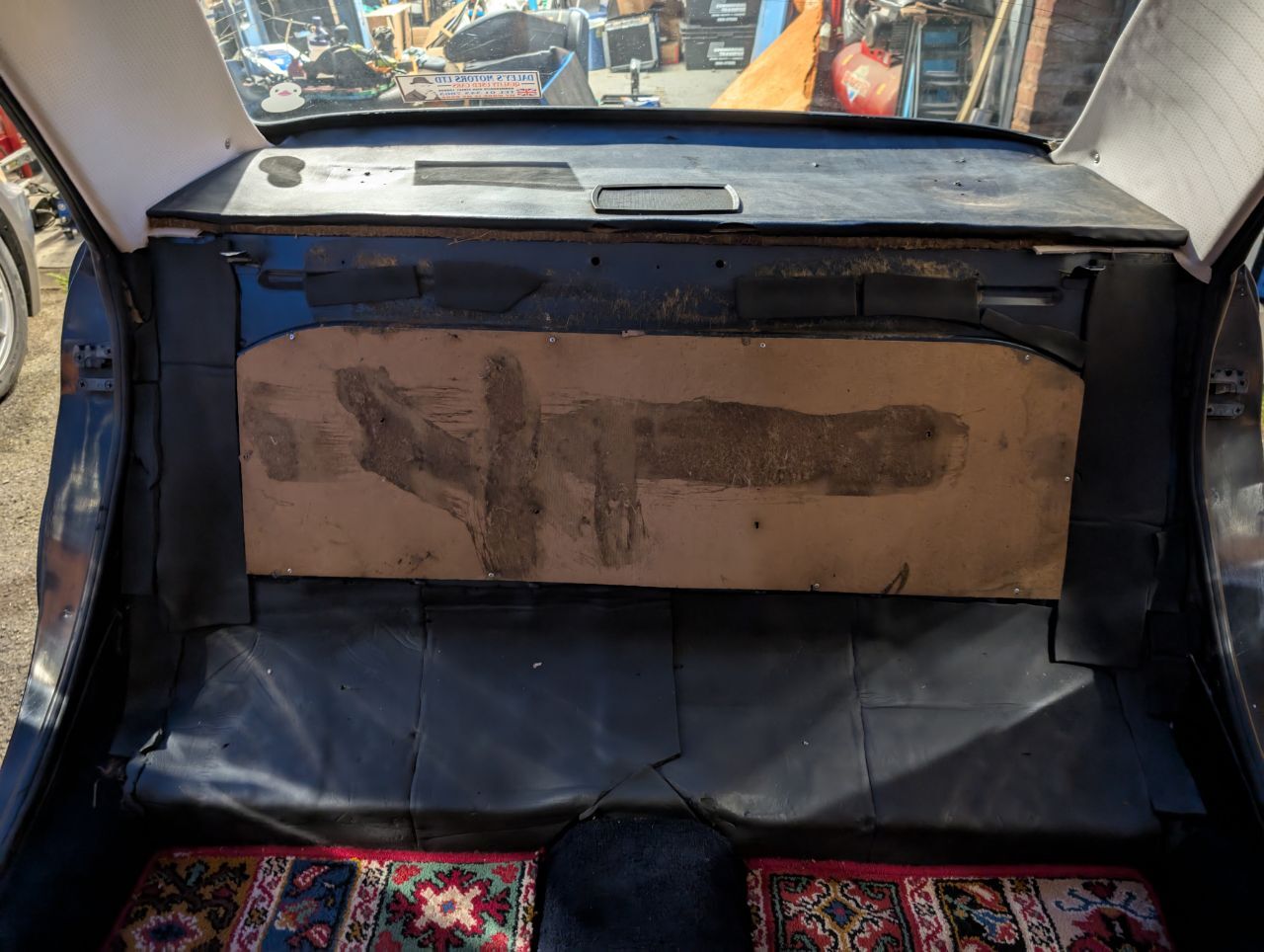

The back area under the rear seats had a Hessian type material presumably for noise absorbing. Likewise this was skanky and went in the bin. Replaced with some cheap sticky backed thick foam.
And then I re-pop riveted the back board back on again.

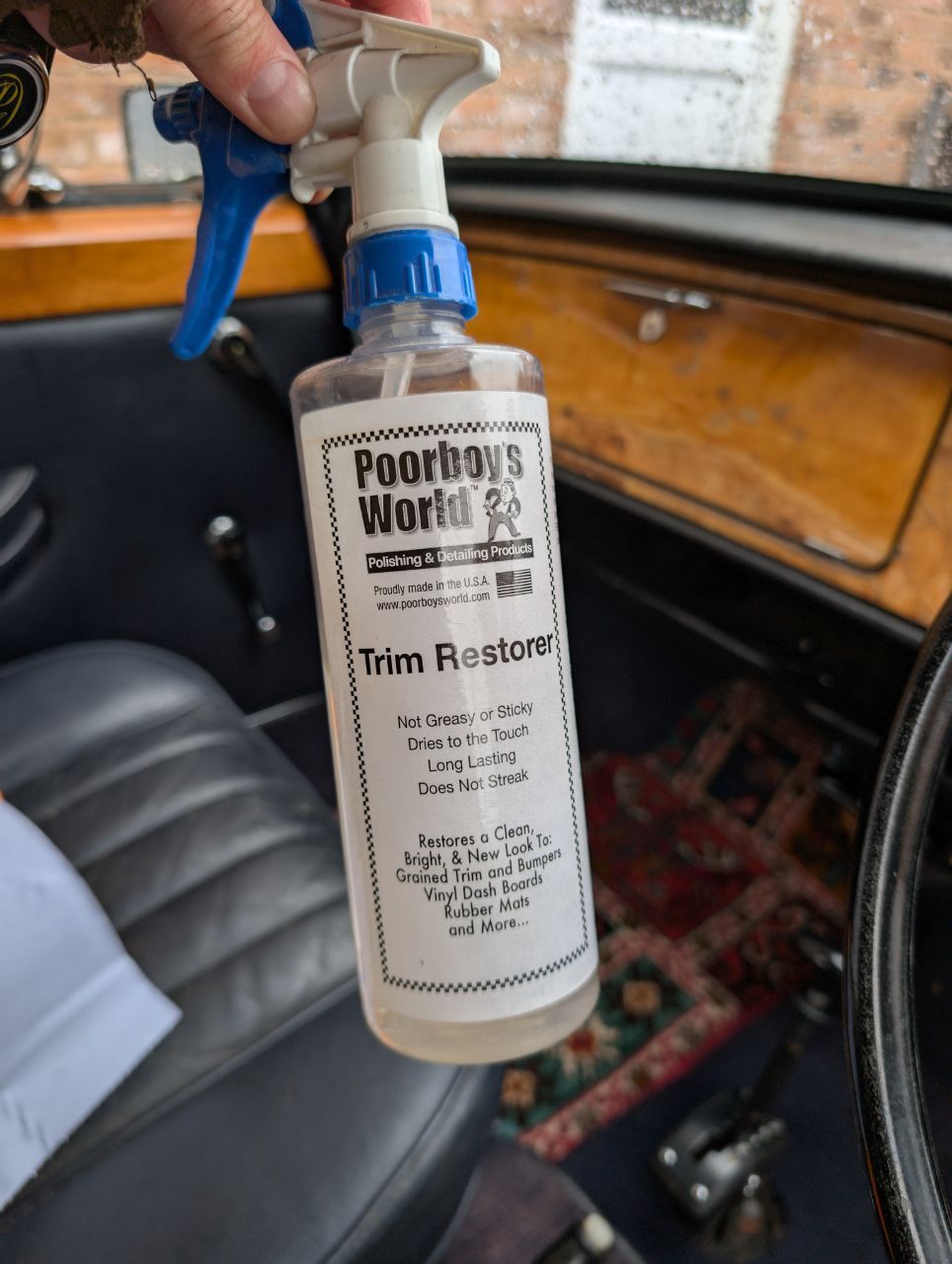

I know some have recommended Poor Boys stuff, so I dug out this.
And gave the dash a good shine.
Even though the dash wood is fucked, the new headlining, replacement seats and cleaned dash + carpets has made a monumental difference to how nice it's to be sat there.

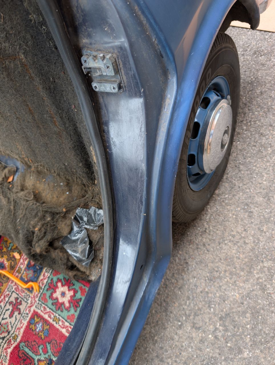

Having a poke around I noticed brush marks on the door jam areas. No idea what paint was used but I'm pretty sure the current coat has been brushed on. Maybe something daft like house paint?
The rear boot lid had some paint loosing adhesion, so I gave it a little chip. Looked to be a very different colour to the rest! Presumably it's had a second hand boot lid in the past and why it not longer has Vanden Plas on the back.

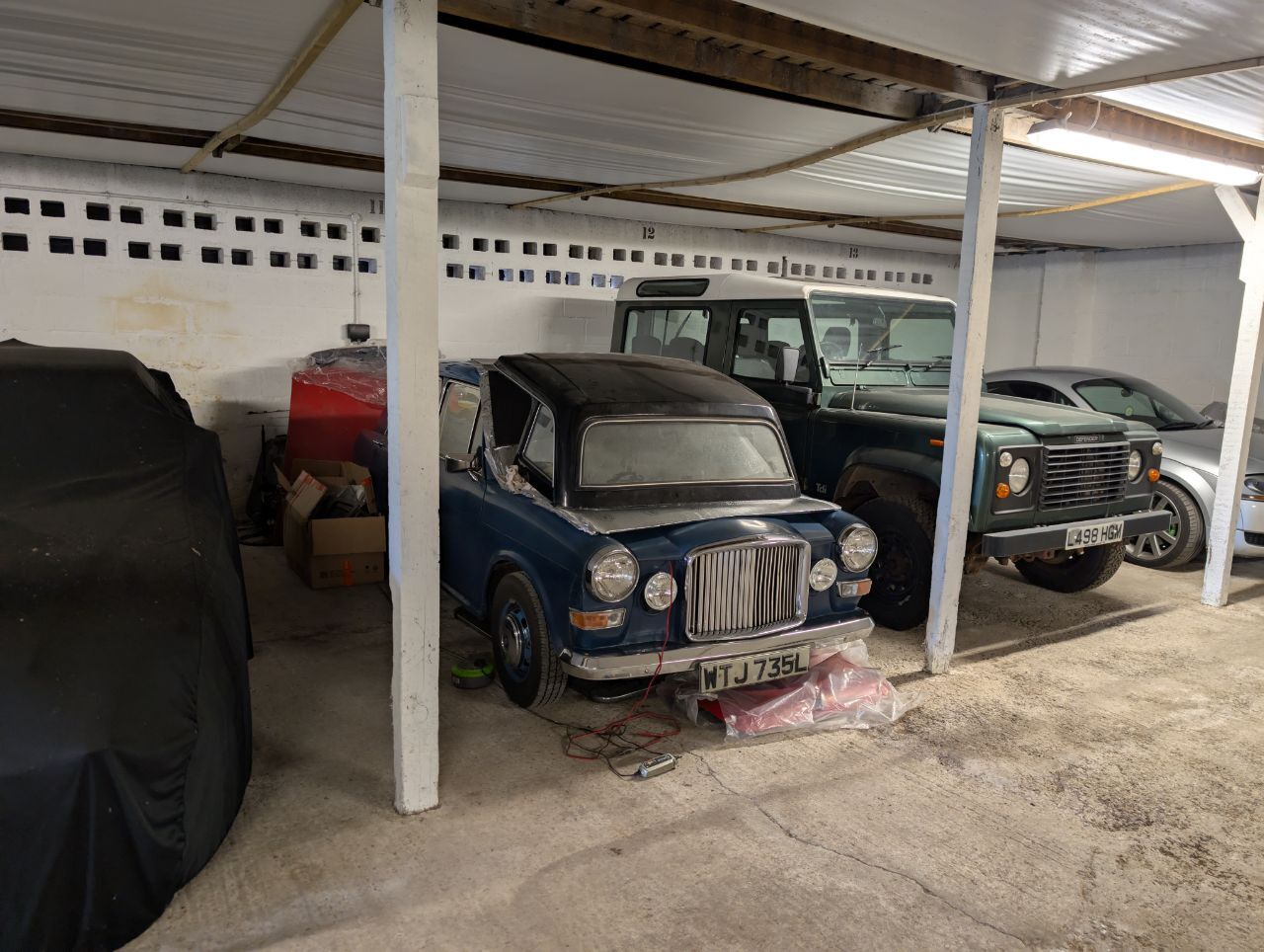

For now it's hiding away from the elements in storage. Couldn't find a place for the Midget hardtop so the VP has a hat for now!
Kinda suits it!
