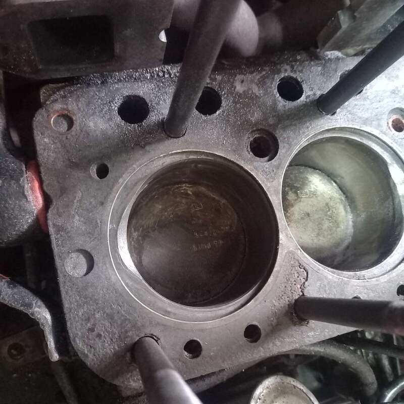

So as I fit the 1275 head I had to file a little bit off the water pump. Fit  a smaller water pump pulley and radiator bracket.
I also had to pocket the block ever so slightly as the valves just glanced the block and I was worried they'd hit  hard when warm and expanded.
It was a lot of messing about but in hindsight I've flushed out the coolant system and tended to some rust behind the radiator. So if it's all in vain at least I've done something productive in that sense.
I know the reliefs are very crude but compression is fine and the top rings don't catch or are exposed. So I'm happy.
I certainly wouldn't have done it if I didn't have a spare block. 😂

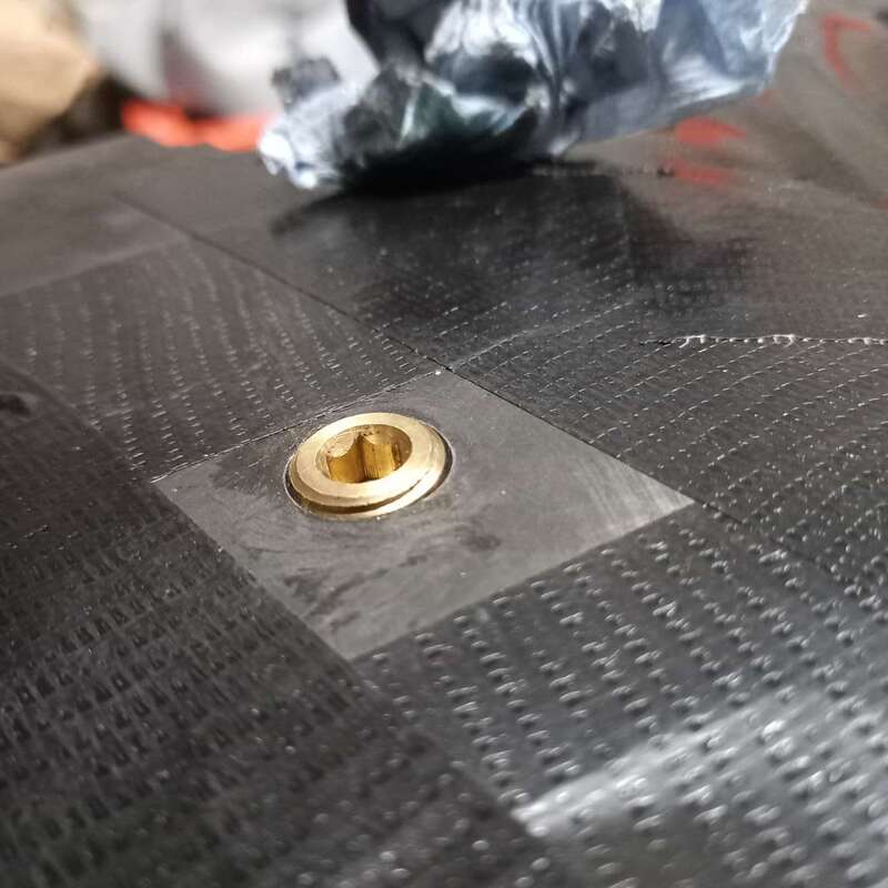

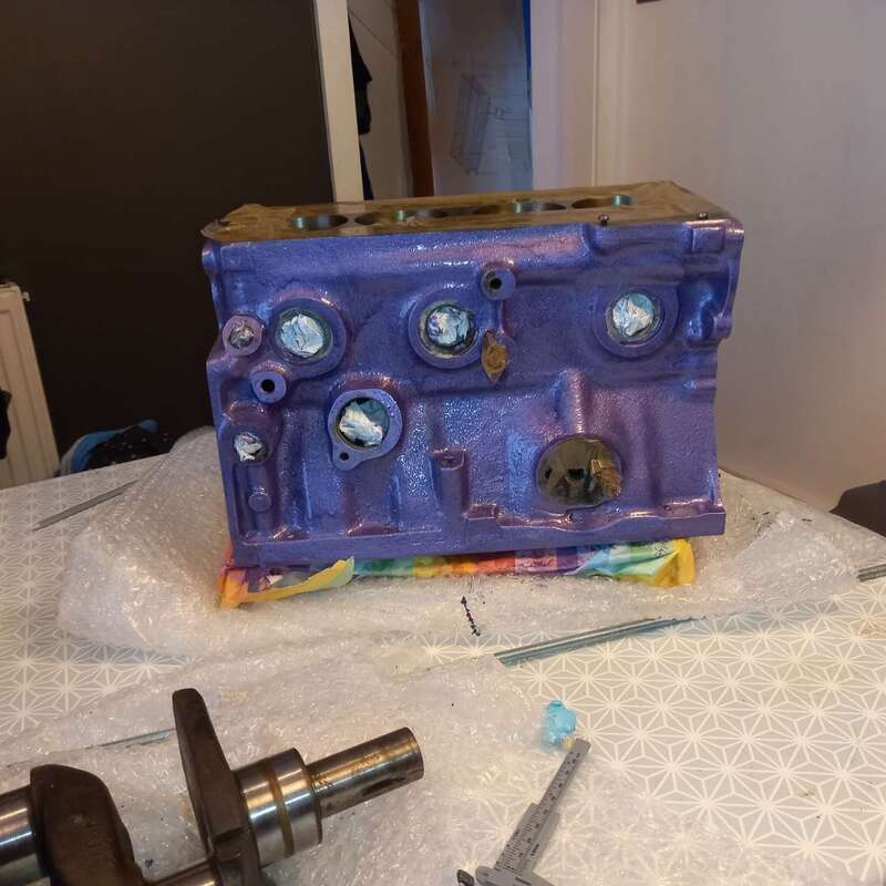

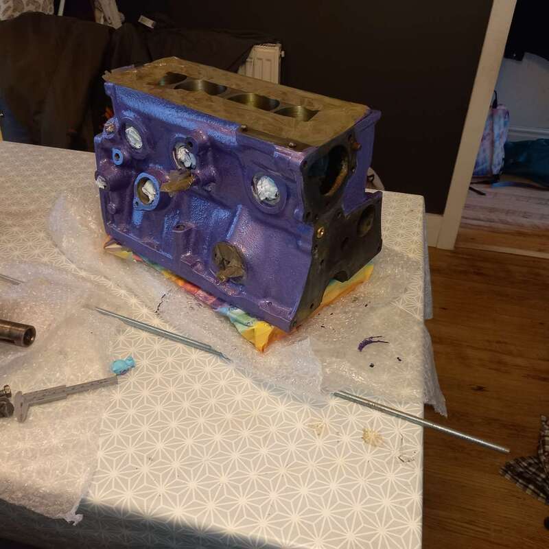

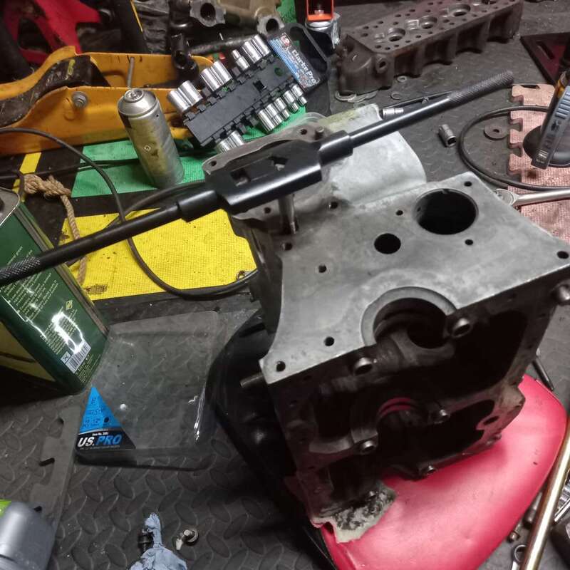

In other news I removed the oil core plugs on the 1098, something I neglected to do. Drilled an m8 hole then pushed a rod through to knock the other one out.
I've got some cloth roll I will push through on a threaded rod like a "pull through" similar to how we clean a rifle barrels.

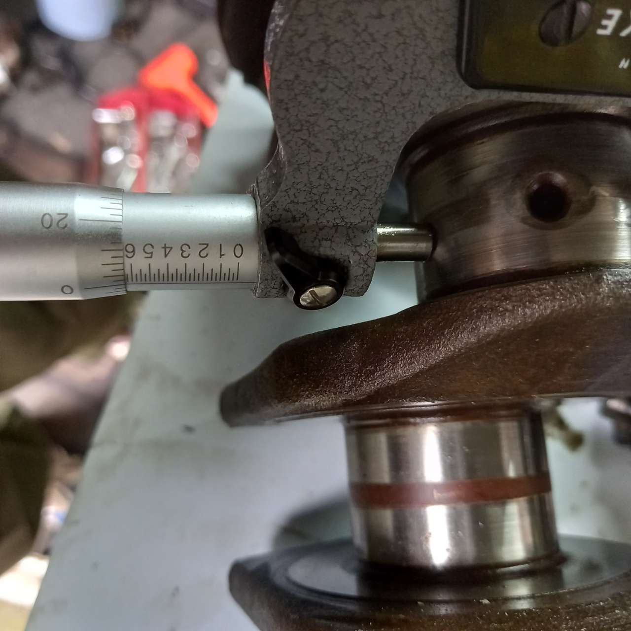

Measured the crank journals and they're within the tolerances and not needing a grind. With advice from theminiforum. Which is nearly £200 saved.

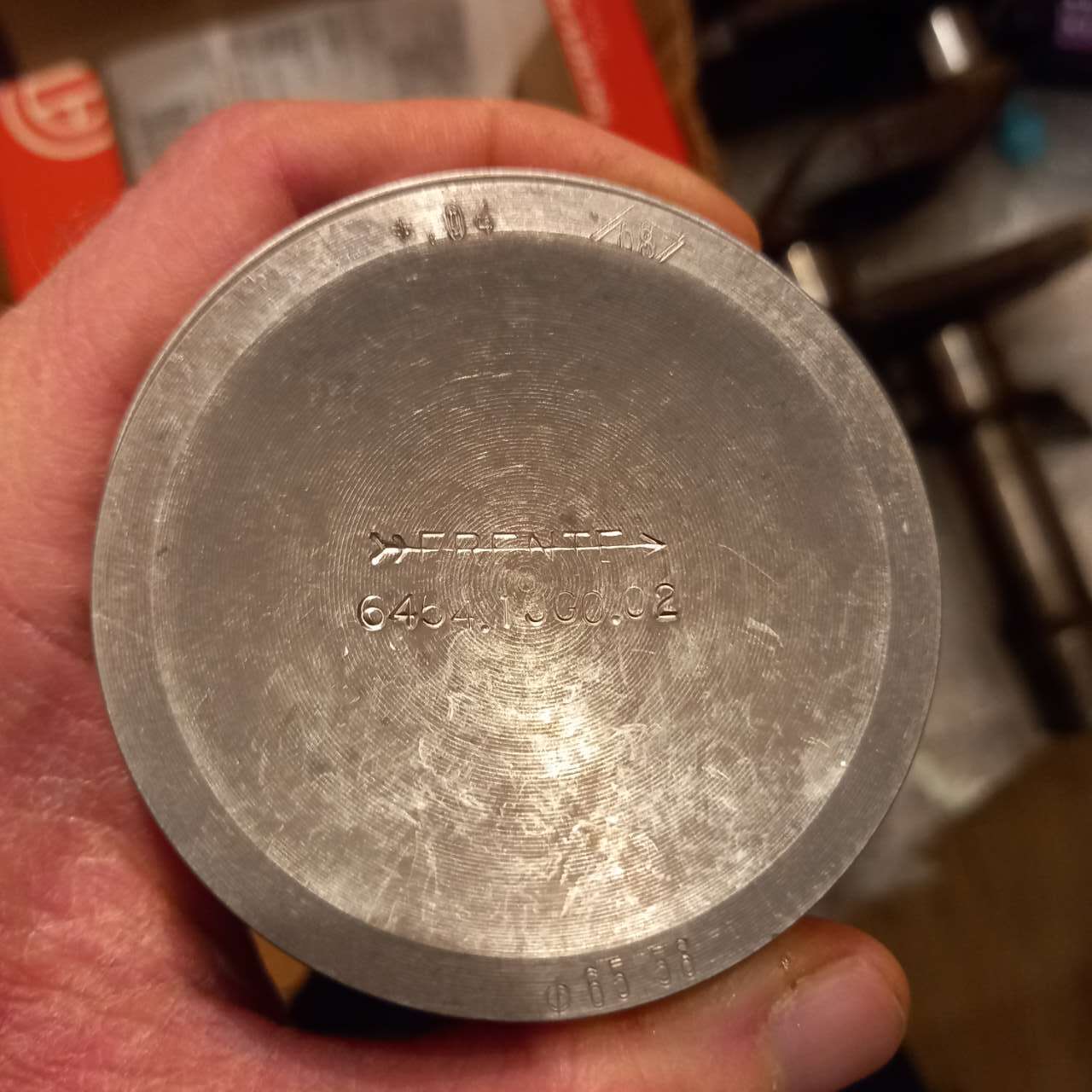

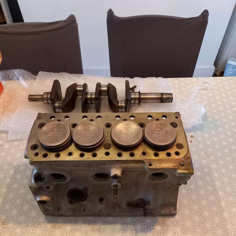

Pistons arrived from Greece today.
Spoke to the machine shop and they've now said as it's +0.0040" rebore, it will be £25+  VAT per cylinder and then a bit more on top of that because they will have to do a second cut.
I'll drop the block off tomorrow and work out the price worst case scenario because I'm not keen on just guessing what the end price will be.

so I had the bores done to 40thou. I was really impressed with the service for £120 all in. He dipped it in the hot bath and also blew the oil galleries out which was a bonus.
I also took my crank to get ground today which will be ground 10thou smaller than standard .

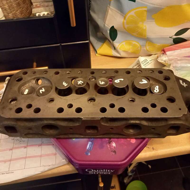

while I was there I saw an old dusty cylinder head on the shelf. Turns out it was a 12g295 cylinder head used on the mini 997, 998 (i think) cooper and other austin 1098 motors.
he said i could have it for £100 as it had been sat there years. I eagerly seperated with £100 but in hindsight it might have been a daft move. These were fitted to the cooper that had domed pistons.  And mine are the big 8cc dished ones.
on my 1098 it will need a big skim to bring the compression back up. Ive measured it and its 20thou smaller than stock height. But having messured the cc of the chambers theyre a tad shy of 28cc.
I have have stupidly one of every stock head produced for the mini haha.
I also drilled and tapped the oil gallery's.  That way they won't mushroom when knocking new ones in and leave swarf in there.
Also with them being threaded in, hopefully they won't blow out under oil pressure.
Here's the 12g295 head I picked up. Ignore my noddy way of numbering valves its just the way I find it easy to remember haha. Although it looks I'm good fettle. Some surface rust has gathered so it will have a light going over and the valves lapping in.
