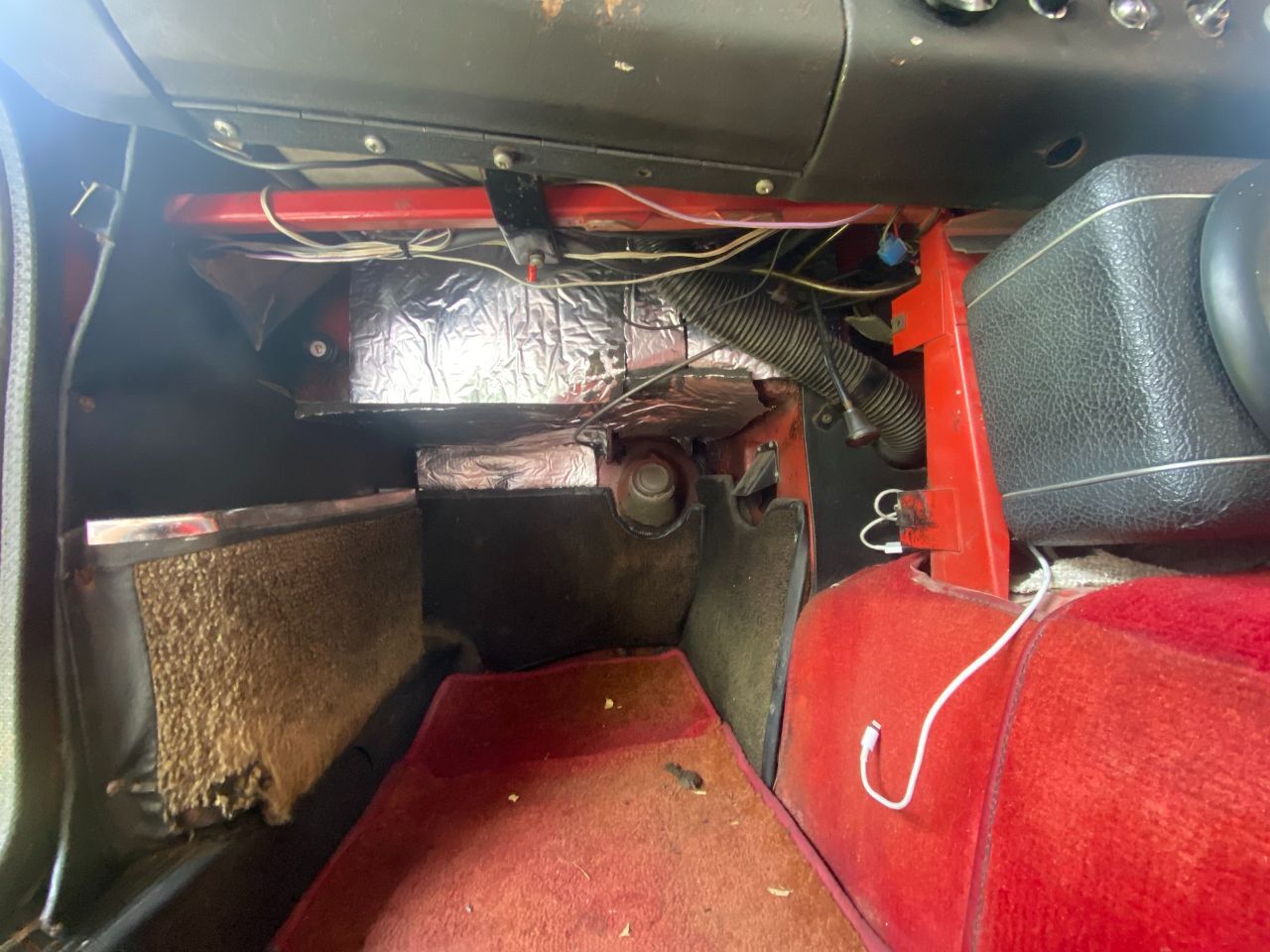

I fitted some self-adhesive sound deadening to the underside of the dashboard. The bulkhead is a single skin panel that doesn't have any insulation, which allows too much engine noise into the cabin.
Most of the material is in invisible places or hidden behind trim. Where it was visible, I covered it with black gaffer tape.

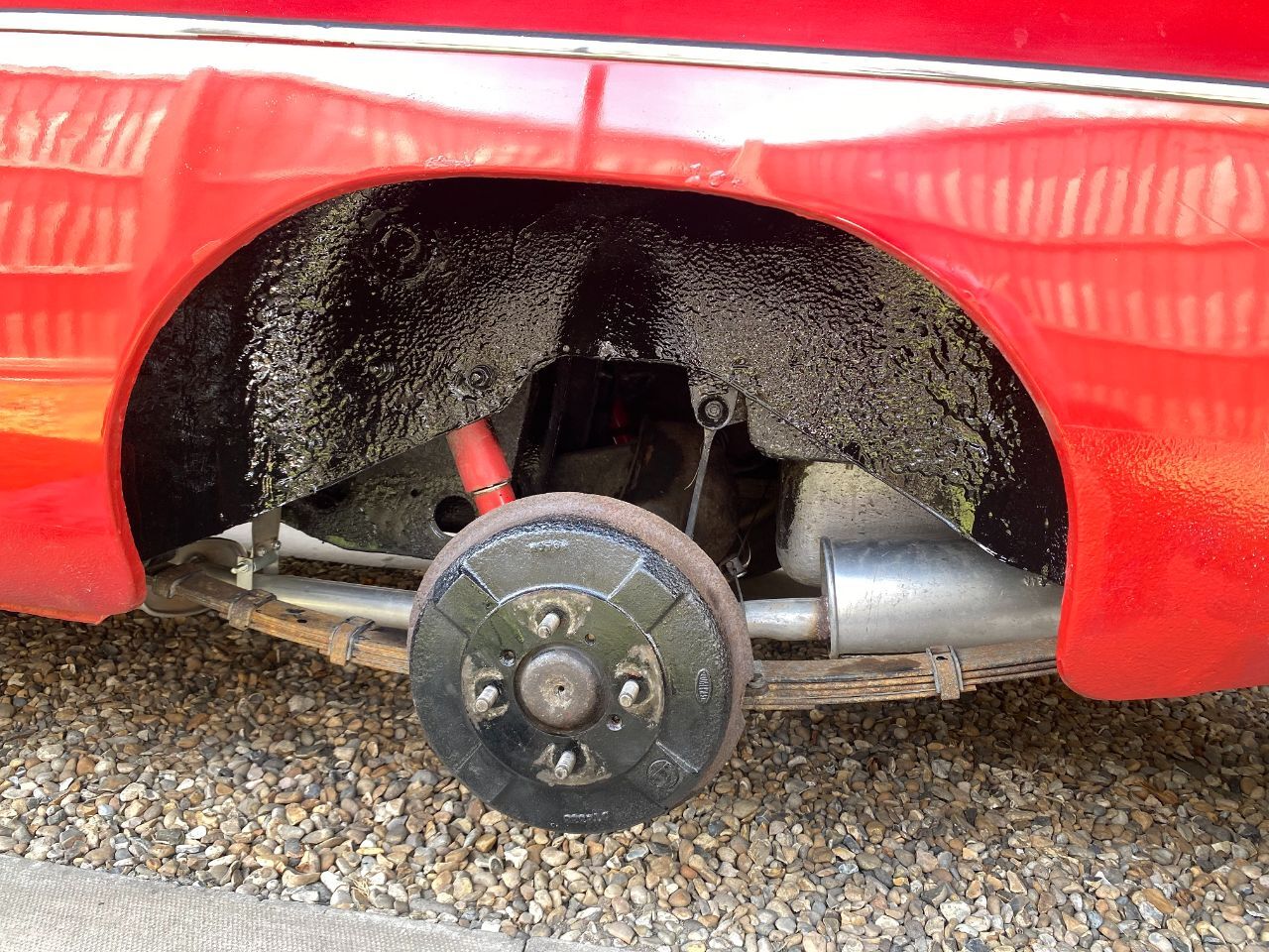

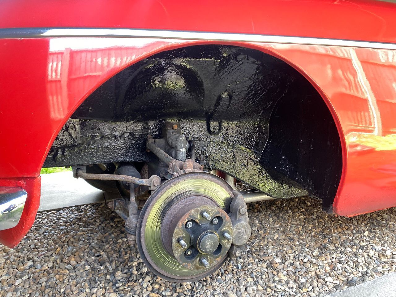

I spent the rest of the afternoon tidying up the arches and floorpans. When I took the MGB to get the clutch replaced, the weather was awful and to get to the mechanic's workshop, I had to drive past an HS2 work site, where the road surface was covered with mud, which got splattered all over my freshly painted arches and floorpans. I tried washing the mud off but most of it wouldn't shift.
I repainted the underside with another coat of Rust-Oleum black paint. I love that stuff.
Apologies, I forgot to take photographs of the repainted offside arches.

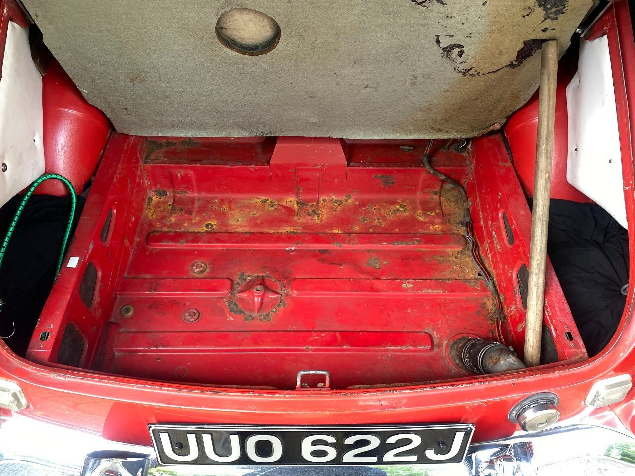

We all know that MGBs like to corrode just about everywhere and I've seen some project cars for sale that would be perfect for Fred Flintstone - rusty floors!
My MGBs floors are generally solid but looked tatty.
I tidied up the surface corrosion and gave the floors a lick of Flame Red Rust-Oleum paint.
Boot floor before and after.
Nearside front footwell floor before and after.
Offside front footwell floor before and after.
Much better.

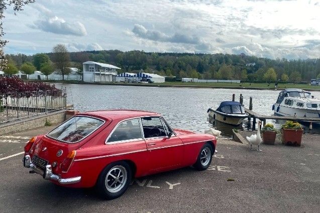

I got through Marlow without any problems and headed towards Henley-on-Thames, where I stopped off for a photo opportunity.
On route towards Maidenhead, I stopped off again in Hurley village for a few more photos.
According to a plaque on the front elevation, this building was constructed in 1135, which makes it significantly older than the MGB.
I would have taken a better photo if the Ford Focus hadn't parked behind the MGB.
Instead I had a cup of tea.

Your excellent Thameside shot is reminiscent of MG advertising in general - which often featured some waterside activity. The cars were aimed by BLMC's marketing department at active outdoorsy folk.
I applied a filter to my photo to make it look more period.
