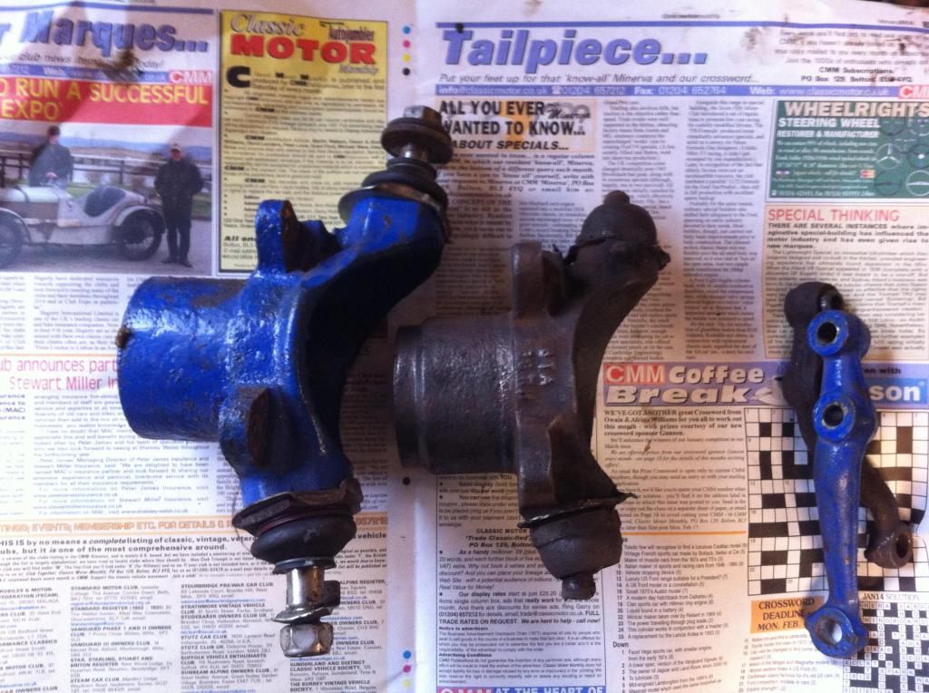

Are the steering control arms anything to do with the issue with camber and is it wise to fit mini ones to help this?
Have a look on the mini forum, specifically @Ben_O has some threads that go into fantastic detail. He takes loads of photos that you'll be able to reference to get an idea of how things will need to go together.
On the heads you've got there should be casting numbers, they'll be on the top face, and are sometimes a bit difficult to read. Some of the castings go for silly money as they can be bolted onto a 998 to give it the larger valves without modification.
This picture highlights the differences (Metro in blue). Top ball joint sits at a very different angle which will mess with camber and caster. The steering arm is straight for a Metro vs. kinked on the Mini. That can mess with steering angles and cause scrubbing. The whole setup is a recipe for bump steer, messing with scrub radii and having to deal with weird cambers and casters.
Theyre not impossible to get over but to be honest for the work to offset vs. the gain from 4 pots its not really worth it in my opinion. It used to be when Metros were readily available and breakers were cheap but now theyre rare and parts are harder to get for a Metro than a Mini. A Mini isnt heavy enough to justify the overly powerful brakes anyway and if you really want it to show off you can just buy vented 4 pot calipers that fit Mini hubs nowadays anyway.

Looks like I’m in luck, hopefully the pics below show it has mini hubs and steering arms
Thats a Metro hub. Fitted with Mini steering arms. The ball joint is a big giveaway. Its a sealed unit on the Metro. Nothing is adjustable there so youre going to suffer the caster and camber issues mentioned. Also they didnt put the locking tab on the bolts for the steering arm.
Ahhh sod it. You know i was looking at that arm thinking it should have locking tabs.
