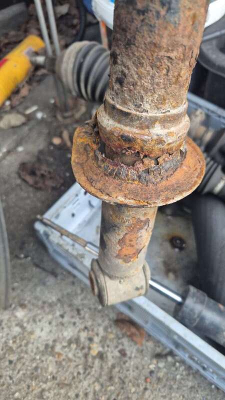

Have a rusty shock absorber.

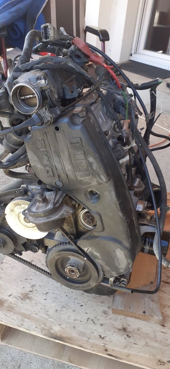

The last time I saw both Yugo engines, they were on the back of tame Zastava mechanic's Fiat Stilo estate, and on the way to become one engine. Not before they get a full check, so I end up with a properly sorted engine, not something that goes pop in 3000 kilometers.
Just got a call they're disassembled, and it's all fucking fucked m9. There's scoring on the cylinders of the engine block that needs to stay, so depending on parts availability it will either be re-bored or re-lined. Camshaft, that is, of course, EFI-specific is missing lobes.

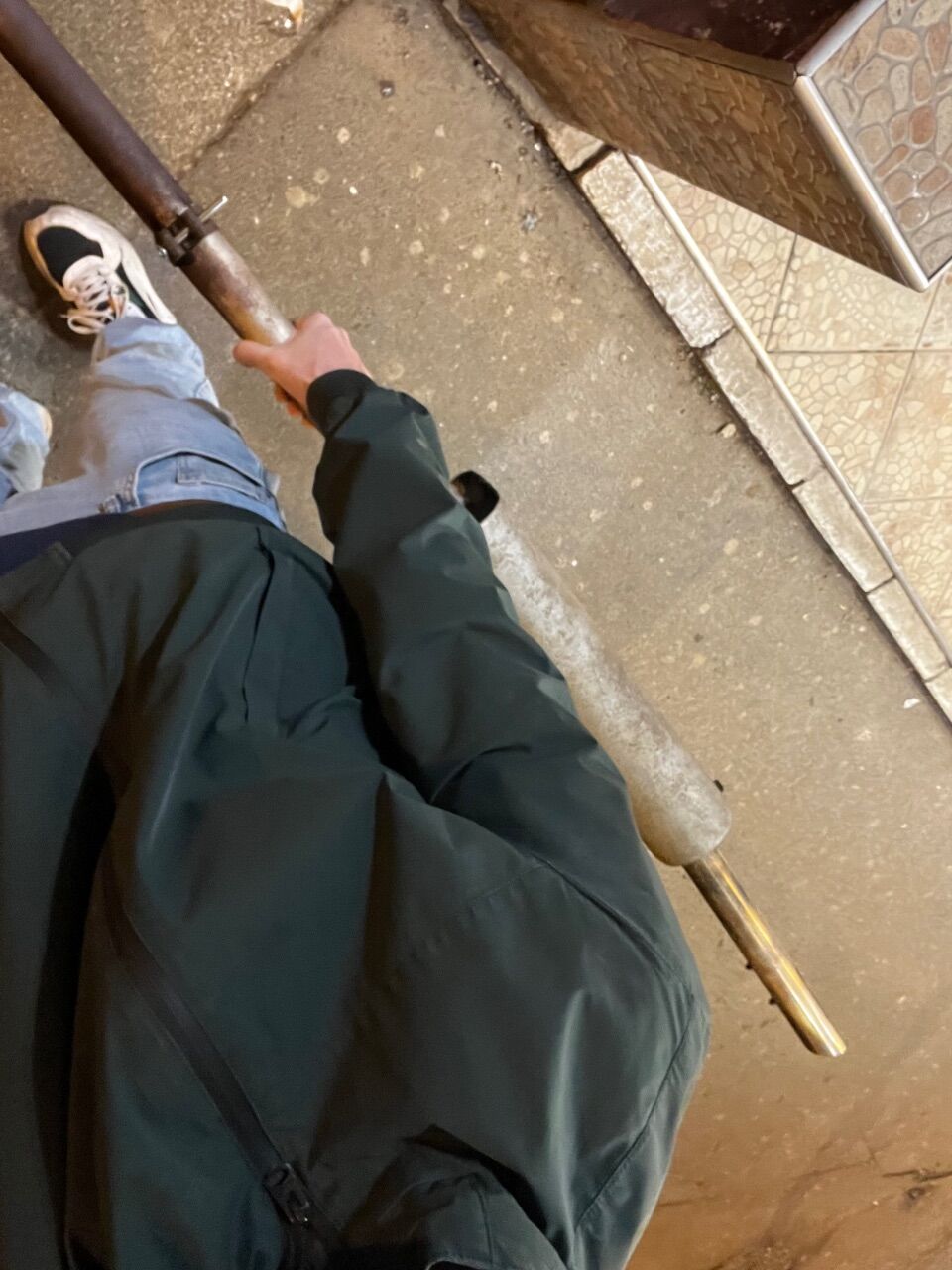

Detached from the manifold. Thankfully I had 13 spanner to gracefully remove it from the singular mount, and it detached some 500m from the garage.
When I said I wanted a new exhaust, I didn’t mean I want to drop this one in the middle of the road FFS. 🤦‍♂️

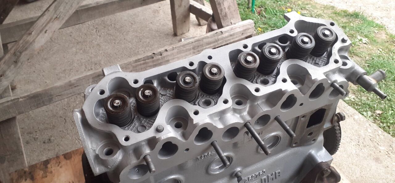

Remember the two engines that went away to become one and turned out to be shit? Well, it’s finally done and back together!
IMG_6546.jpeg.332bf9f2b59223436913cba7a7c5763d.jpegIMG_6547.jpeg.610b444f064da1d695a035fc29712b8f.jpegIMG_6548.jpeg.204155704e042aaeb9260809b8c496c2.jpegIMG_6549.jpeg.7baf5ea33c8d043e272bb95827508c3e.jpegIMG_6550.jpeg.aae4f2bbcaf388f1fd78e038b157241e.jpegIMG_6551.jpeg.c42dffb3a05dbf160027f064960095ab.jpegIMG_6552.jpeg.aed2525bf3c83a91cde7ed3e40ab0c24.jpeg
Brand new or machined next to everything. 🤦‍♂️ Oh and a new clutch kit, because why not while we’re at it. Price? I refuse to add it up.

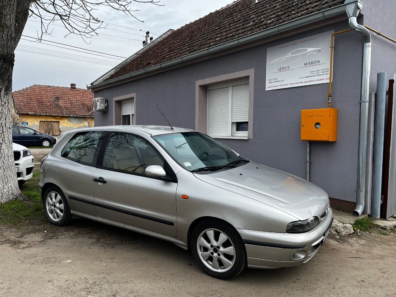

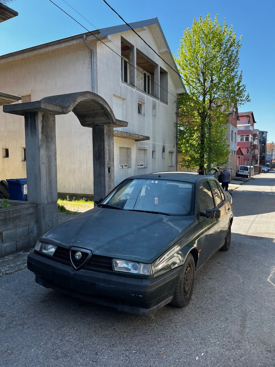

Today was the day to send off Saxo to the bodyshop, and look at what’s going on with Bravo.
Called my brother’s friend that runs the local techncical inspection station to ask for recommendations for a tow and book an inspection. Tow truck booked for 10ish AM. Plugged the spare battery in last night to top it up for Bravo. Jumped in the car, and drove away.
Saxo wants to live. Reconnected the baterry,  turned the key, fuel pump went bzzzzzz and it fired right up. It’s absolutely filthy on the outside, but tires were still inflated and it happily drove onto a truck. 1 car down, one to do.
Onto the Bravo next. Let me get the bat…oh….no. No. I forgot the battery in the garage home. I am not fucking driving for two and half hours over a fucking battery. I’ll just buy another one. Surely everything else will be right, it was last time I saw it?
All the tires held air for ages, so it’s…oh, that’s fucking flat. Out comes the compressor! Battery in, ignition to acc, compressor works and…it’s not taking air. Fucksticks. Work the valve a bit maybe? Still no. How old is this tyre anyway? DOT 2905! Old enough to vote then, no fucking wonder it’s not taking air. I’ll just pop the spare on and take it down to the village to get this pumped up and back on. Spare is…a fucking spacesaver. Unscrew the wheel, try to take it off, and it just went and fucking welded itself to the hub. Cue a lot of swearing and wiggling:
Let’s try that tyre one more time now it’s off the car, in case it was just VERY unhappy squished flat. Compressor on, and…well fuck me, air is going in. Well ok, refitting it is reverse of putting the space saver on. Amongst the other shit that was in the trunk there is a bottle of DOT4 brake fluid. I noted this but ignored it and charted under “there’s some other spares in here as well”.
Let’s see that HID that’s not working. It’s usually the ballast, and I have another one in 159. Switch the ballast, and…nope, bulb is dead. Yes, you guessed it, not availible in the village. Meh, I’ll just put back halogens in to pass the inspection.
Turn the key, and it’s on! It’s VERY unhappy with stale fuel but works, and brake discs are completely corroded, but it just needs to drive for 2 kilometers to get some fresh petrol and I’ll brake hard a few times to clear up the corrosion. Reverse, stall, combination of shit aftermarket clutch cable and stale fuel. Took me a few attempts but I got it out of the gate.
Next up - brake corrosion. Mash the gas, brake. Mash the gas, brak…HOLY FUCK IT’S NOT STOPPING AND THE PEDAL IS ON THE FLOOR! Thankfully I didn’t hit anything while handbrake stopping it. Pop the back, I’ll just add some more brake fluid and…oh that’s empty. Of course it is. This is an existing issue and the brake hose has probably just rotten through completely whilst sat up.
I managed to limp it down to the village gas station for some fuel and brake fluid. Pour it in, mash the brake and….that puddle in front of driver side rear wheel wasn’t there seconds ago. Cue another call to brother’s friend to cancel the inspection and ask for a shop to fix this. Turns out the guy that towed Saxo also runs a car repair shop, so all I had to do is drop it off with him once he comes deliveres Saxo and comes back.
Even gave it a wash whilst waiting for the guy. This good deed was greeted by the interior mirror falling off.
I left it with this guy to get it roadworthy, do a onceover, and take it to the inspection once it’s done. I was quite happy to see the back of it. Judging by the amount of smoke belching from passenger side front wheel that caliper probably needs a rebuild as well. His eta is 2nd half of the next week.

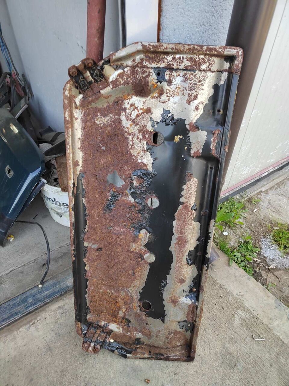

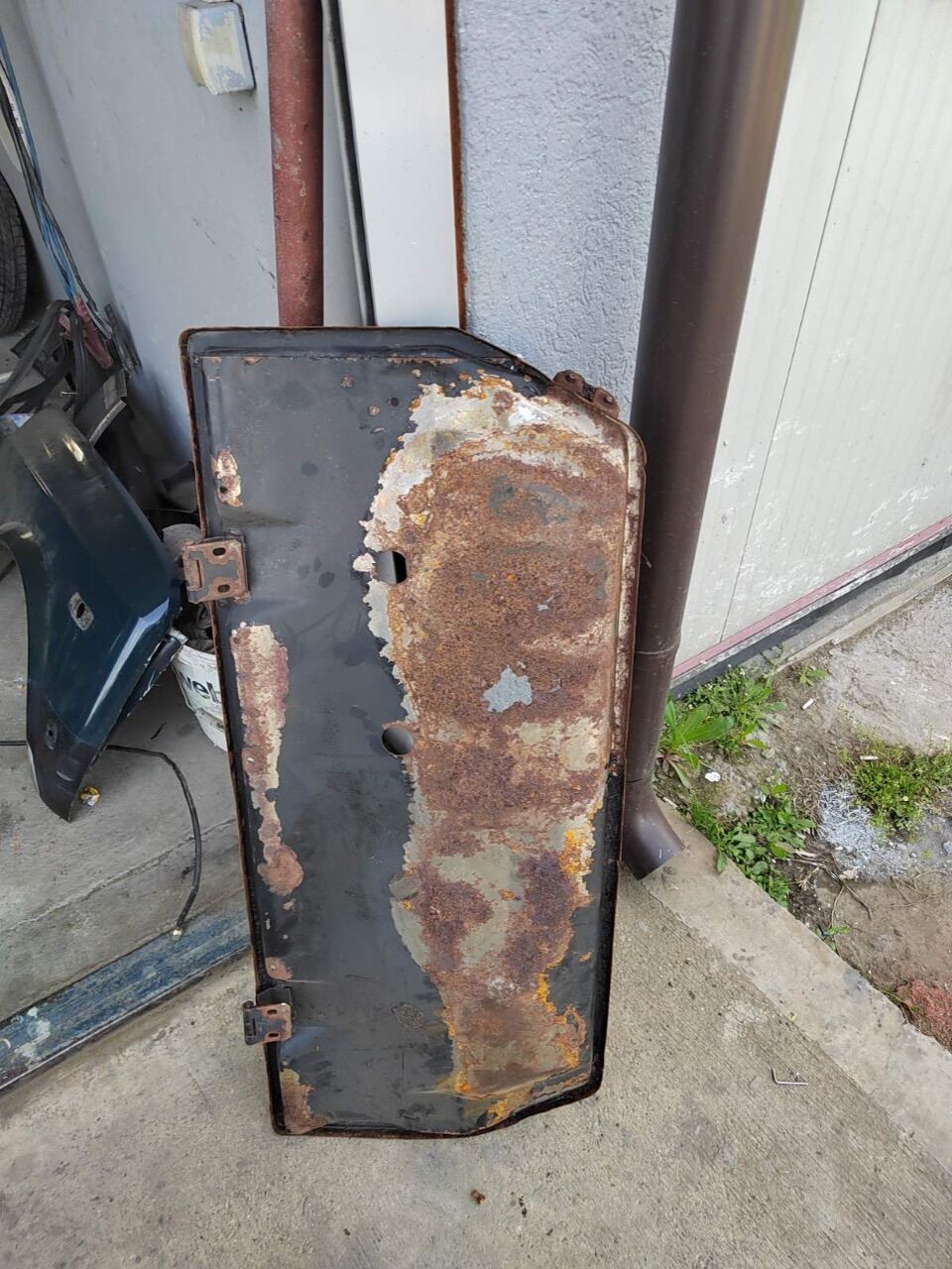

Have you ever seen rear seat base that wasn’t left outside exposed to the elements but rusted out?
IMG_6827.jpeg.dbcef4df30152e40664d66a62a0ac1e4.jpegIMG_6828.jpeg.d1663e75efa3a15ceb99f831a4d0bb63.jpeg
Me neither.
You guessed it, Cabrio specific, so needs to be saved. It’s off to get sandblasted.

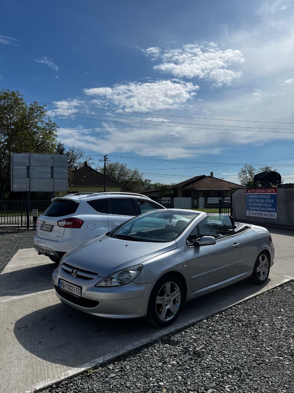

As reported in the news thread, Easter started with a big screw in RR tyre of the 307CC. After musing on new tyre options, I ordered my go-to reasonably priced rubber - Sava Intensa UHP2. I got a delivery today!
They could’ve put them in those tyre bags so I don’t dirty up my car. Nevermind, it’s leather, it’ll clean up.
and back on brand new matching rubber.
Today was also a glorious day - the day where Serbian tax authority finally decided, after 16 days (and self imposed deadline of 7) to produce a paper that I needed to get the Bravo registered. Turns out, to no one’s surprise, that there’s no outstanding tax on inheritance. 🙄
So into the 307CC I went to give the new rubber a test drive. It is much, much, much more sure-footed than on what was there previously - a mix of completely worn and dated Firestone Roadhawks and completely worn down Uniroyal RainSport. Looking at the remaining thread on them, I got every penny out of them. 😄 Wouldn’t recommend running them for this long though, as I nearly rear-ended Audi A4 when the car skidded at 20km/h.
Insurance policy with the start date of 20 days ago swapped out for a one starting today, and after driving back to Belgrade and waiting in a queue for 2 hours (and explaining my paperwork for another 5 minutes) I was finally granted a pair of these:
A friend of mine was going in the same direction as me, so I hopped into his car, and back to Titel where Bravo was resting in front of brother’s friend’s place. Take the key from him, turn it….that’s fucking dead then. Booster pack connected, turn the key, it starts, but stalls as soon as you take it off the booster. That’s THOROUGHLY flat then. Lovely, I bought that battery when this Bravo endeavor started s bit over a month ago. All the rest of my appointments today canceled as well. Thankfully, he had a fast battery charger, so as we chatted for an hour battery charged up to a state where it actually starts the car.
Say thanks and goodbye, jump in the car, the windscreen is filthy, pull the sprayer, wiper completely delaminates. What about demister? Oh, that’s doesn’t seem to be working, and why did my lights get dim? Lovely start, but I can just wipe it with a handkerchief. Stop by the village shop and that’s not sounding good oh it stalled. Bonnet up, positive terminal doesn’t look properly tightened. That’s it right, it’ll be fine no…oh. Booster pack, starts up. Nevermind, it’ll charge up by the time I get back home.
10 kilometers down the road, the car starts misfiring. Symptoms match what the guy working on it said he saw, but solved with reconnecting the sparkplug cables. Should’ve swapped them for a new set as I told him after all. Magically, it clears up after a couple kilometers. I revved the tits out of it  aiming to charge up the battery. 40 kilometers in, there was a new thumping noise. I think it’s one of the rear brakes, as it disappeared when I pressed on the brakes. File under ignore, let’s just get it home. One of the tyres looked suspiciously deflated, so I pulled into the services. Rolling down the window to ask where the compressor is, the car stalls. And won’t start again under its own power. Ah, so that’s the alternator not alternating anymore then! Explains why it wouldn’t keep running after it got jump started. Hello booster pack again!

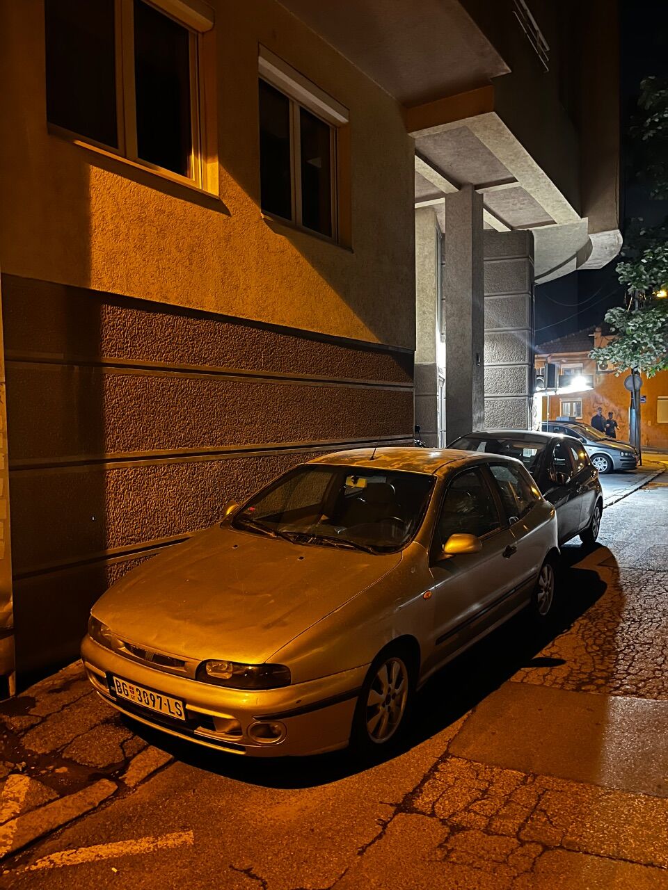

By this point , the battery was getting really really flat again with errors popping on the dash under 2000rpm. But. I was back in Belgrade, and as the street lights are bright and omnipresent, I decided that running on parking lights as opposed to full lights is a better idea in terms of getting me home. So on I soldered! There was also this weird hissing sound in the background that I kinda ignored, and charted down to a vacuum leak.
I was very lucky with the night traffic , as there were no queues anywhere, and worst thing I encountered was a few sets of red lights. After what seemed like way too long, finally, I was home. Before I set off, I left 307CC in front of my flat to keep the parking spot. I get out of Bravo to move the Peugeot and…what’s that smoke in front of the headlights? I can’t see it anywhere else? There’s also a sweet smell of something wrong with the cooling system. The temperature was stable 90 all the way though?

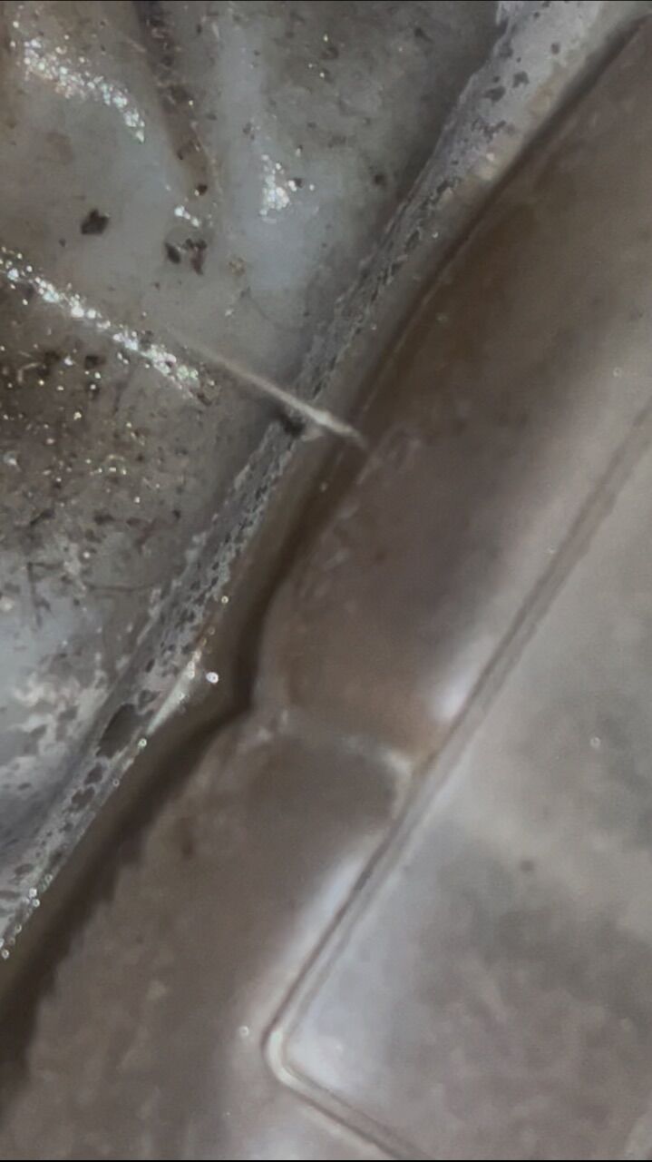

Swap the cars, turn it off, why is it still hissing? Pop the hood and…
Yeah, that does it. Coolant expansion tank has pinholed, and is now seeping steam and water in turns.
Anyhow, the Itialian Joy Machine has been successfully limped home. Both battery and the booster pack are now on charge, and I’ll be calling my trusty mechanic first thing in the morning to get everything checked over and fixed.
Impressions?
Despite alternator playing up, pattern clutch cable being absolutely shit, misfiring fits, pinholed expansion tank, tyres old enough to vote and buy alcohol, and probably umpteen other things - It’s an absolute hoot to drive! There’s something about small Italian cars that no one else seems to get quite right. What an absolute joy of the machine! A quintessential proof that you don’t need a lot of money, horsepower or top speed to have spectacular amounts of fun while driving. An absolutely brilliant car, completely underrated and unfairly disregarded. Umpteen times more fun than contemporary Golf IMO.
Its appearance is significantly tarnished by the peeling lacquer on the roof and dented bonnet , and I’m looking forward to sorting that out, although it’s not on top of the list.
Can’t wait to have it fully functional again.

So, with Bravo against all odds being limped home last night, I now had a bit of time to have a thinker after work.
I went and bought some fresh wiper blades while the shops were still open.
As per the Italian tradition, rear wiper is not a normal wiper blade, but part of a wiper arm, and instead of being able to buy it anywhere and swap it, you need a part made for the car. Thankfully, it's still a wiper with normal wiper rubber and metal bits holding them in place, so an Alca blade was taken apart to donate the rubber.
Random rant, not directly related to this car per se, but - why do people cheap out on wiper blades and don't replace them when they're worn? keep seeing cars with completely destroyed wiper blades, especially on the rear. Shit plastic chinesium ones are still being sold, so someone is buying those as well - Florida came with something branded Skycar and it was predictably terrible. It costs less than a tenner for all 3 in decent quality, and unless you have a car that demands something stupid, it's highly unlikely to cost more. It's the bit that removes water from your windscreen so you can see where you're going, why on earth would you skimp on that, especially as it's stupidly cheap to get decent quality?
But I digress. This car was sitting for ages, it's entirely possible they were still good when it was parked up. Rubber bits perish fast.

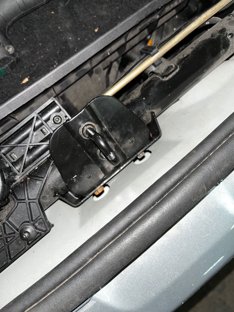

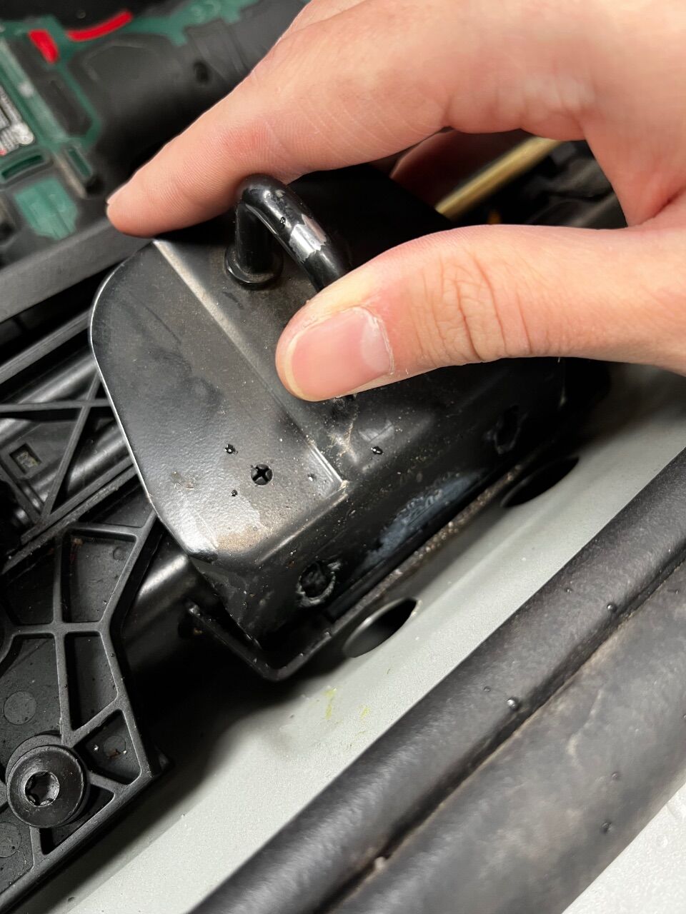

Tonight I went to rearrange the bits in the boot, as I got a bag of small goodies for the car - bag for the stuff you keep in the trunk, air fresheners, new HID lights, phone mount, first aid, that sort of thing. See if I can sort out the power window switches, maybe put the HIDs back on, replace the broken air filter housing, and throw out the trash.
Switches first - in the finest FIAT's fashion, in an act that British Leyland would be proud of, power window switches off a Brava don't fit on Bravo. Connectors fit, plastic shrouds click, but the switch itself is a tiny bit different and doesn't work when you put it back into the mount. Switches off a Bravo needed then.
As I started sorting out the trunk, it started raining in bucktefulls, so I ran into the car to wait it out. While I was in, why not do a bit of archaeology around the car? What does a car, that's been off the road since 2021 and not particularly cared for in the last few years of it being on the road hold? For starters, there's an old clutch kit and a defective clutch cable. Not sure why they are still there, but they are, and should be thrown out unless the clutch is somehow still good. I did a first pass of throwing out the trash a month ago, but it was now time for a pass #2 as it was raining and I didn't want to get wet.

The mechanic couldn't take it in tonight, so we pushed that back to tomorrow. I need to pick some decent tyres as well, but that's a job for after it gets back from the mechanic. Hopefully, it will be back on the road in full glory soon - watch this space.
Also, if anyone has a period-correct //// FIAT logo keychain they'd be willing to part ways with for some beer tokens, do let me know.
Forgot to take photos because I was too excited but - ENGINE IS IN THE ENGINE BAY OF THE YUGO! 🎉 🎉🎉
Not that fast with celebrations though. It’s cranking over, but check engine light is not lighting up as it should when on ACC and there’s no spark. They couldn’t figure it out so sparky that wired up entirety of the car is called back in to check what’s wrong. Probably something dull and stupid. I sent over the diagrams of Motronic 3.1 I have to help them out. He’ll probably drop by tomorrow. It certainly did work and run before it got removed from the donor car, so, errr 🤷‍♂️
Air filter housing is completely mangled so I need to find another one. Insulation that goes onto the firewall from the cabin side was also completely rotten, so a new one was promptly sourced from the scrappy which miraculously had one intact.

Today was Alfa 155 LPG-free certification day!
I woke up way too early for me to go pick up the car from the shop, and drive it get it towed to another shop nearby that had folks from the certification body over to inspect a bunch of cars.  We needed to remove a shedload of car parts from the car, and after cleaning that up, it started first turn of the key.  A+ effort.
It's looking rather sorry for itself, and is absolutely filthy, but seems to be working right.
First speed bump  loading it onto the truck revealed that something's not right with the driver's side front suspension. Felt very crashy and completely unsprung. I spoke to the chap who worked on it before I headed off, and he said that shocks were bone dry, so it must have failed ages ago. Nevermind, failed shock has nothing to do with the fuel car runs on, so meh.
Delivered it to the shop, and a bit under 2 hours and 80 euros later, I was presented with a certificate stating the obvious - LPG was removed from the car.
In the meantime, shop managed to book a technical inspection some 500m away from where I was. Now, importantly, I wanted to buy an Eibach Pro Kit for this car. In the same way I wanted new tyres for 307CC. In the same way I wanted new exhaust for the Mini.
Jumped back in, and there was a very loud BANG on one of the speed bumps next to the technical inspection center as the car was unloaded in front of the technical inspection center. The front right was looking very sorry for itself and completely collapsed. Guys from the inspection center confirmed what we all knew happened - the coil snapped. That's 3/3 times this year my hand was forced to buy bits I wanted for my cars.

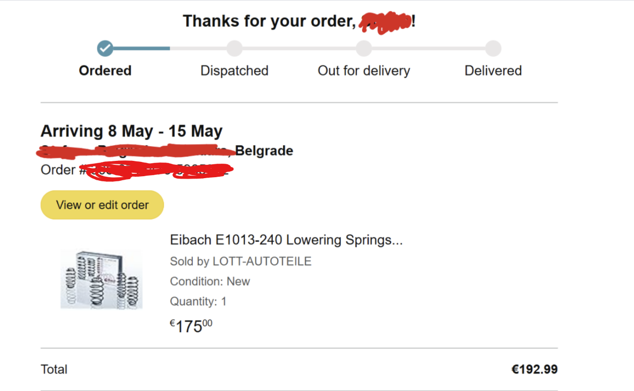

So this got ordered
I also told the guys from the shop to order new shocks as well, because if I'm doing this, might as well do a full refresh. They are all probably ancient anyway.
Filing this endeavor under task failed successfully. At least I now have the paperwork stating LPG is removed.
