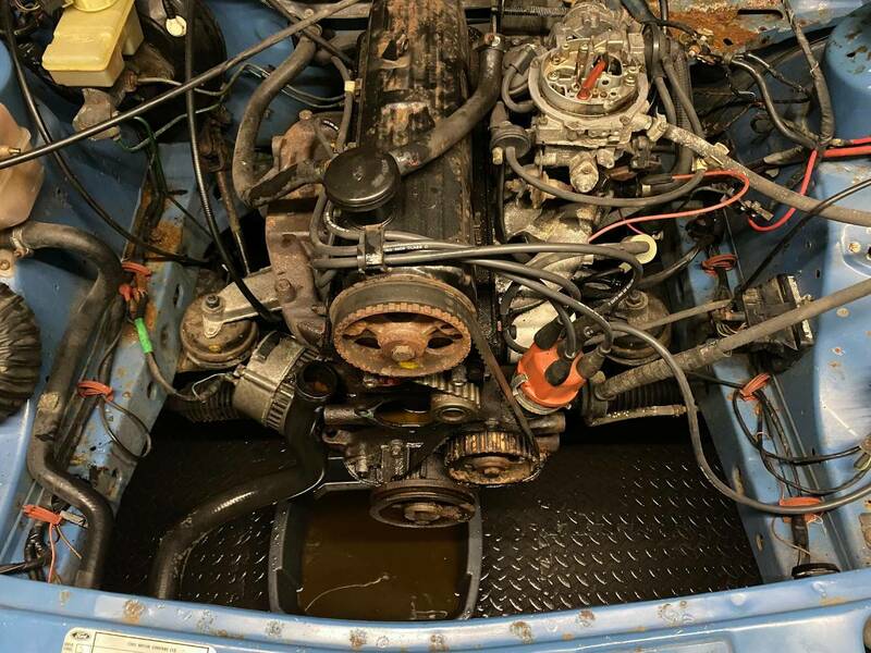

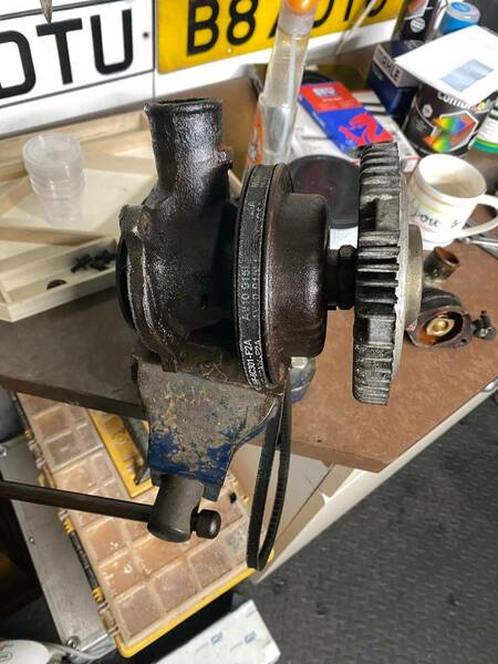

Peter C Posted February 21, 2024 Author Posted February 21, 2024 Now that I have the bodywork situation under control, I wanted to spend a bit of special mid-week time in the garage and take a look at the engine side of things. I removed the fan shroud, fan, thermostat and housing and water pump. All very easy, as you can imagine. I want to replace the thermostat and water pump, mostly because the coolant that I drained today is old and smelly. I don't know what condition they are in but I figured that if I am doing the cam belt, I might as well do the other bits. One problem. I can't separate the fan clutch from the water pump shaft. I've locked the pulley in a vice, by wrapping an old fan belt around the pulley and squeezing it tight in the vice but no matter how much effort I put in, I can't get the locking nut to budge. I don't even know which way it should turn to undo. I'm now in two minds whether to put the water pump back in as it is, with a new gasket and hope for the best. Any ideas how to loosen the nut? juular and warren t claim 2

Peter C Posted February 21, 2024 Author Posted February 21, 2024 10 minutes ago, Low ontime said: Well locked in Locking mole grips and a sharp hammer blow works if you don’t have the large spanner size req… The gap between the back of the clutch and the pulley is quite narrow. I used an adjustable spanner as I don’t have the correct size one. I don’t even know what size it is.

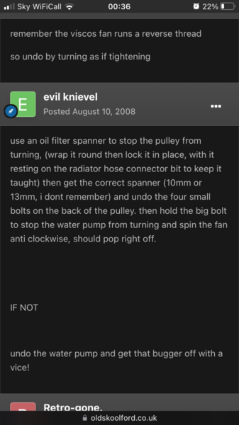

Low ontime Posted February 22, 2024 Posted February 22, 2024 Found this to assist… tooSavvy and Peter C 1 1

Mr Pastry Posted February 22, 2024 Posted February 22, 2024 25 minutes ago, Peter C said: And if I don’t succeed in getting the clutch bolt off, I might end up with a knackered water pump! Surely there is no reason to take the fan clutch off unless you are going to replace the water pump? Looking at the pumps on ebay, the shaft does appear to have a left hand thread.
Peter C Posted February 22, 2024 Author Posted February 22, 2024 12 minutes ago, Mr Pastry said: Surely there is no reason to take the fan clutch off unless you are going to replace the water pump? My point precisely! 12 minutes ago, Mr Pastry said: Looking at the pumps on ebay, the shaft does appear to have a left hand thread. Left hand thread = turn clockwise to undo?
Rightnider Posted February 22, 2024 Posted February 22, 2024 It was many years since I last replaced a Pinto water pump, but I’m fairly sure the viscous coupling is to be loosened anti clockwise. I think I have a special tool for it, was readily available, at least back in the day. Peter C 1
Rightnider Posted February 22, 2024 Posted February 22, 2024 Can’t remember if it was 32 or 36 mm, but here’s one. https://www.micksgarage.com/d/thermo-viscus-wrenches/products/525075/draper-bmw-and-ford-32mm-thermo-viscous-fan-nut-wrench?loc=se&gad_source=1&gclid=CjwKCAiA29auBhBxEiwAnKcSqtGZhmhVEYwbM5uibIg9b_b-p_wQ5aLGmLYv9p3mH4JJzk0ukbdxIRoCZ1sQAvD_BwE Peter C 1
Mr Pastry Posted February 22, 2024 Posted February 22, 2024 24 minutes ago, Peter C said: My point precisely! Left hand thread = turn clockwise to undo? Is it a separate locknut, or it is a hex formed on the clutch hub? If it is all one piece, then with a left hand thread the hub would undo clockwise. A locknut would have to be backed off anticlockwise. But if it doesn't need to come off, don't. Peter C 1

Peter C Posted February 22, 2024 Author Posted February 22, 2024 1 hour ago, Rightnider said: It was many years since I last replaced a Pinto water pump, but I’m fairly sure the viscous coupling is to be loosened anti clockwise. I think I have a special tool for it, was readily available, at least back in the day. If @lisbon_road doesn’t find his tool, could I borrow yours please?
lisbon_road Posted February 22, 2024 Posted February 22, 2024 7 minutes ago, Peter C said: If @lisbon_road doesn’t find his tool, could I borrow yours please? My tool is a bit of lasered out steel that grips on the M6 screws on the front of the hub. It stops the hub rotating and you put a thin spanner in on the left hand thread of the coupling. It is a home made modified tool, though it definitely worked. I really don't want it now. I also have a Pinto tappet adjusting spanner which I suspect has spread a little, so if I send a parcel, we can put that in too. But if someone else has a better tool, get it, that's fine. tooSavvy 1
