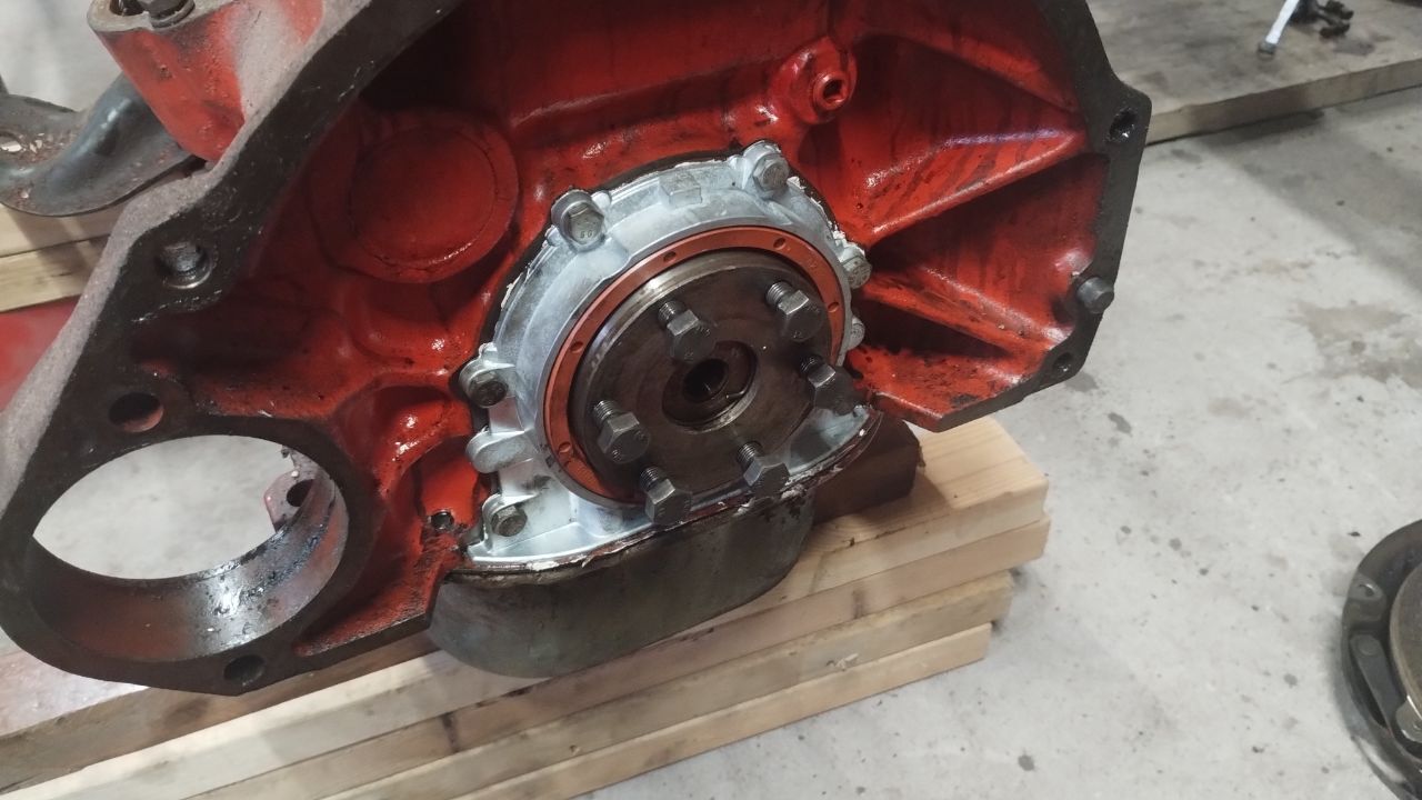

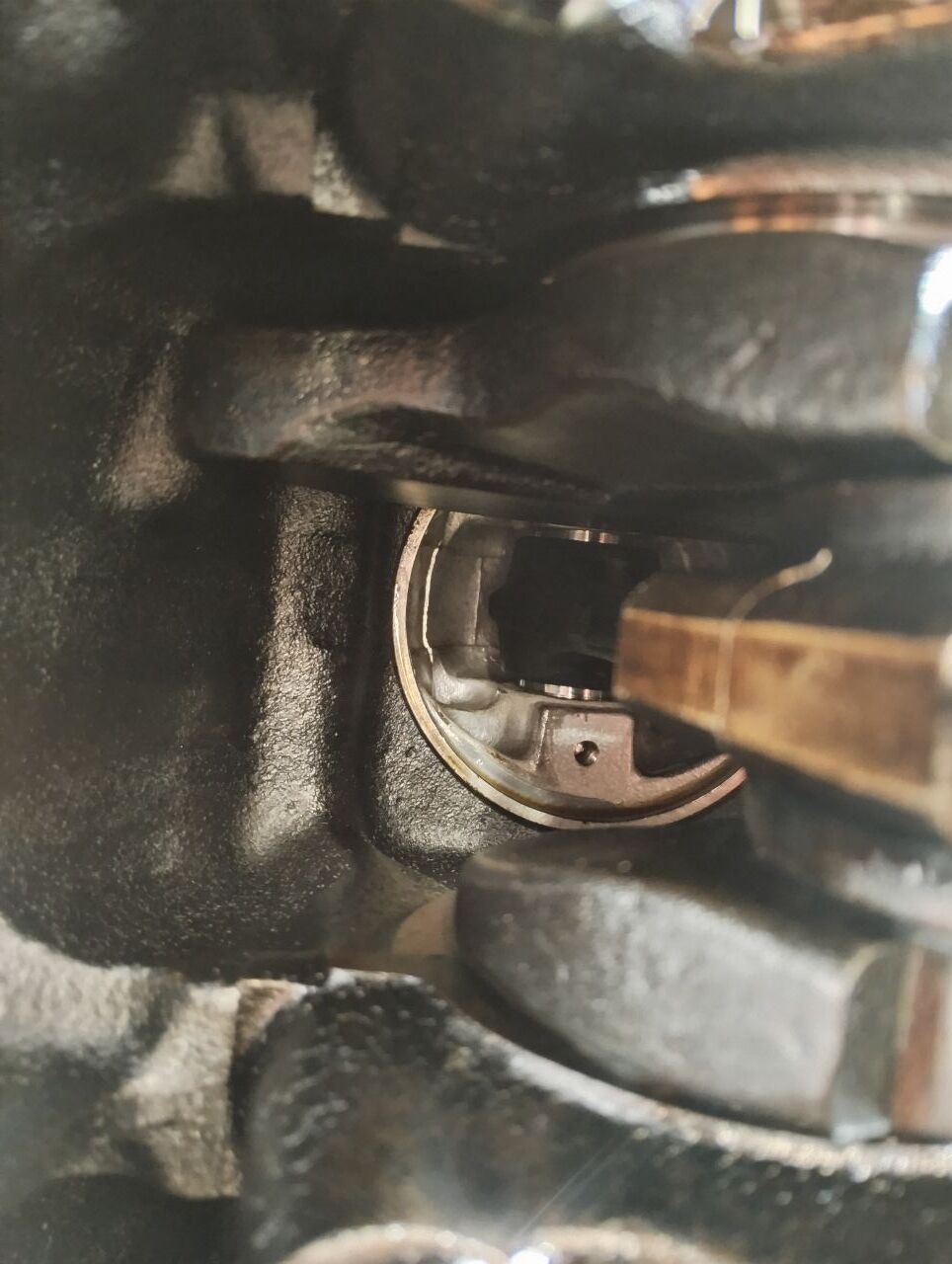

I got greeted by this:
And I didn't clean any of this! @juular , @warninglight and other amazon sniffers- what do you make of this? Is that a standard rear seal? Looks very advanced for 60yrs old.
Expand
That's an upgraded housing with a neoprene seal. Good news in my opinion as the original felt seals tended to slowly drip.
Yes that seal is good news, I expect you have the same type behind the crank pulley too - I had my timing cover machined to take the neoprene seal when I had my B18 in bits a few years ago.
Expand
Good point and worth doing at this stage if not there already.
Between the two scrap engines I had, one had a neoprene timing cover and one had the neoprene rear main housing.  It made sense to yoink them both for the final engine.

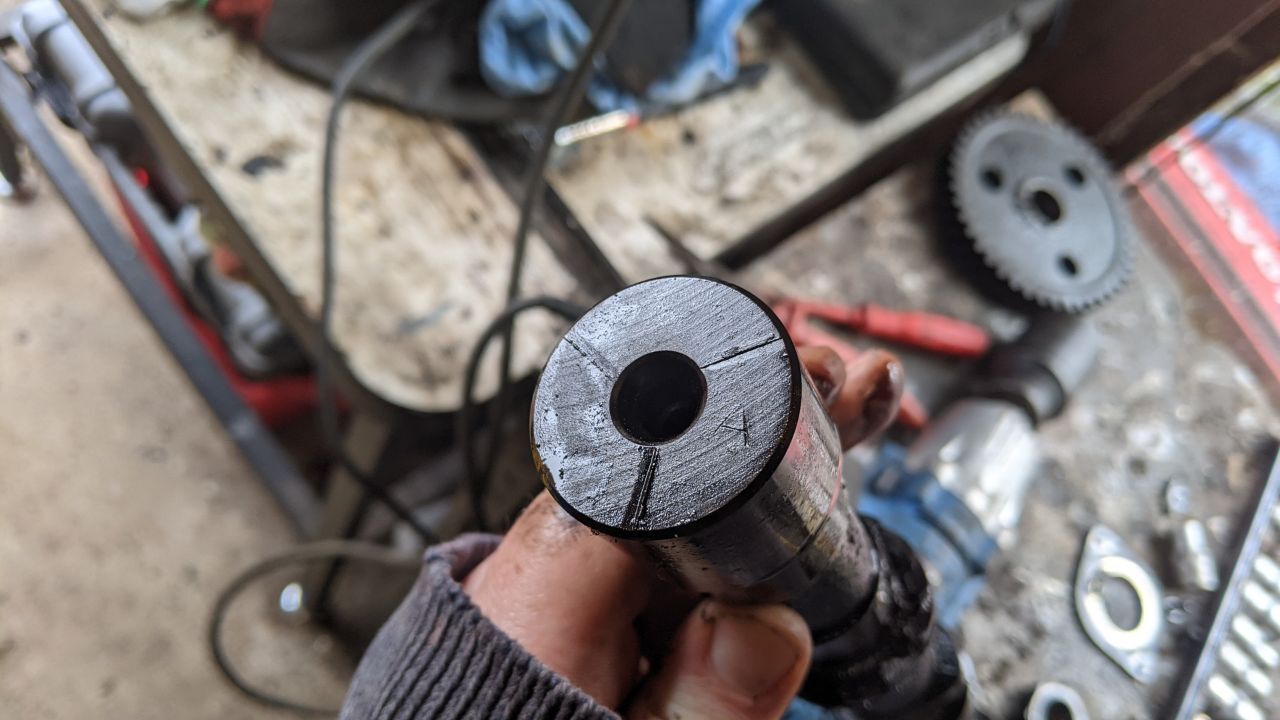

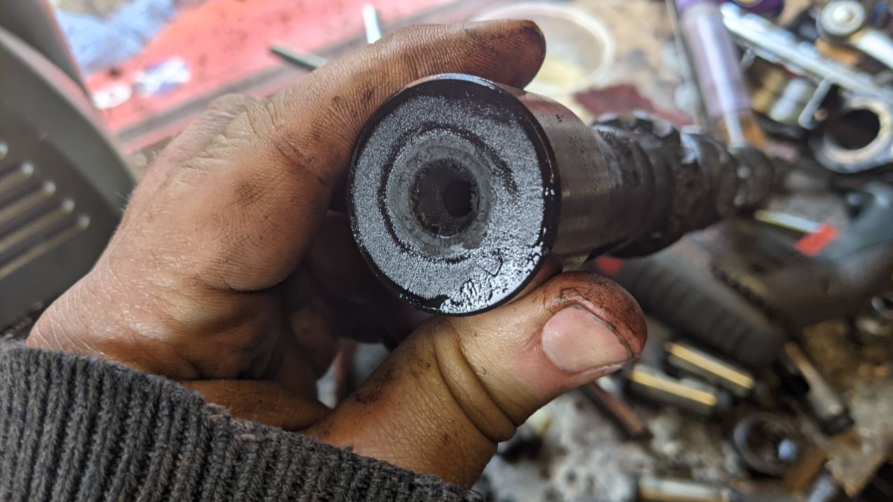

Also - how do I find out what camshaft I have?
Expand
Short of taking it out, a dial gauge on a tappet will give you the lift, and a degree disc/protractor on the crank will let you work out the duration.
Expand
If you do take it out, the revision is stamped on the end of the shaft. It will probably need a clean for you to be able to see it.
I rejoiced at having a 'D' cam below, but later after blowing the engine up I took it out and clearly saw it was a 'B'
@Mr Pastry, @juular, @warninglight, @PhilA, @M'coli - thanks for the replies. On it and will report back.
