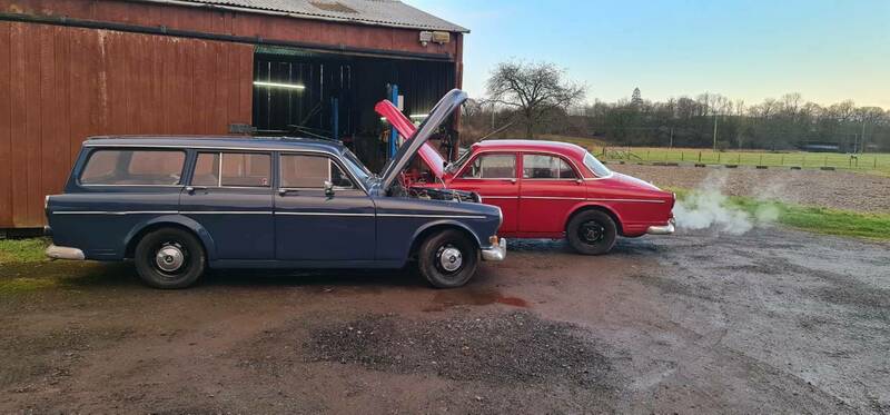

Any interest in another Amazonian rescue? Head off
Now this was fun. Don't worry: I haven't set fire to it. Yet. The sound deadening was not for moving heat wasn't working so I thought I try cold from a CO2 fire extinguisher. It worked a treat!!

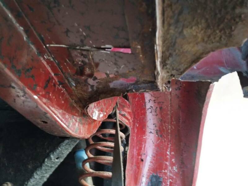

This corner of the car is in by far the best condition. Which means it needs loads of welding. Lip to bottom of rear wing was shot, but only where out of sight. That means the rest is salvageable. The rear of the outer wing and the inner look manky, but nowhere near as bad as the other side. See for yourselves:
On bit of luck: a lower valance repair panel had been spot welded on as a past repair. Wonder if it will clean up?
Nice. After this photo was taken I attacked it with the phosphoric acid and a wire brush. Looked nearly new.
New lip welded on and ground back. I hate welding upside down and it doesn't matter how well you protect yourself there is always a bit of splatter that find bare skin and leaves a crater.

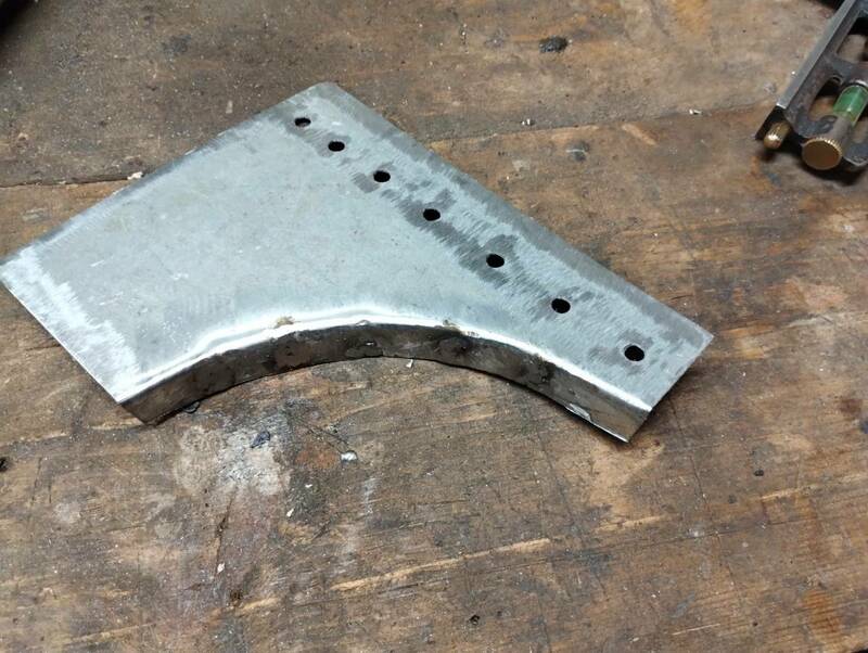

Well happy with this little fabrication. It is part of the boot floor and has a vertical curve in it with a lip. I cut the lip to suit and welded it back together to get this:
And now with it in the car. That'll do.

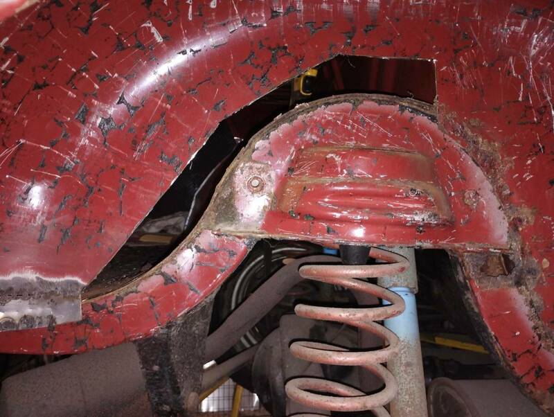

Started chopping out the inner wing and boot floor to repair that nightmare lip.
Tell me to keep going: is there any end to the welding on this thing??

Inner arch now reconnected to the rest of the car: that feels like a massive milestone achieved. I made the lip continuous on floor repair by putting some copper behind and filling the gaps with mig wire and then grinding back. Gives a neat result.
Getting nearer to the oily bits with every hour now :-)
